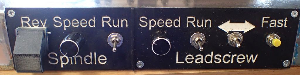

                    Peter Cook 6
                      @petercook6
                      I made a switch panel in the same way. After printing I filled the trenches with enamel paint. After the paint dried hard (48 hours) I used fine wet and dry to sand the top surface smooth. That removed the fine lines of the printing, and any paint that had spread.
                      Enamel paints go harder than acrylics, so give a better edge.

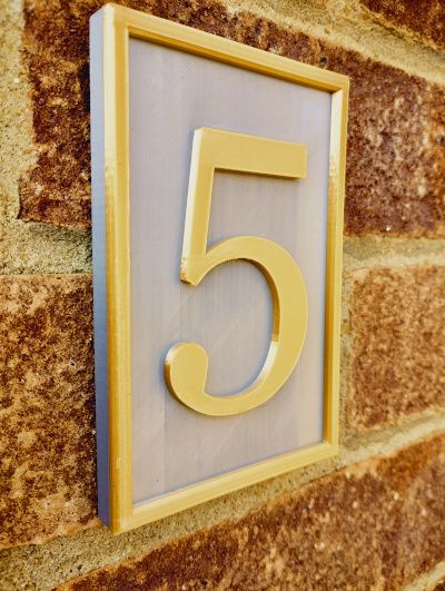

                                  Journeyman
                                    @journeyman
                                    I have had some success with multi colour printing for numbers, probably a bit larger than you require but this house number was printed in grey and gold PLA simply stopping the printer at the required height to change the filament.
                                    The printer software allows for the stop and you set it it at the required height (number of layers) this was done using the Prusa Slicer software. Fading a bit now will need re-doing.

                                      Peter Cook 6
                                        @petercook6
                                        Posted by John Doe 2 on 31/05/2023 00:30:34:
                                        Ah, OK, what grit wet & dry? And did it give a nice crisp edge to your graphics?
                                        I think I used 600 grit to start, then finished with 1200. I think I smoothed of the surface to get rid of the print lines before filling with paint, then after the paint went hard repeated the smoothing.
                                        Graphics were more than adequate for my purposes, but nothing like exhibition standard.
