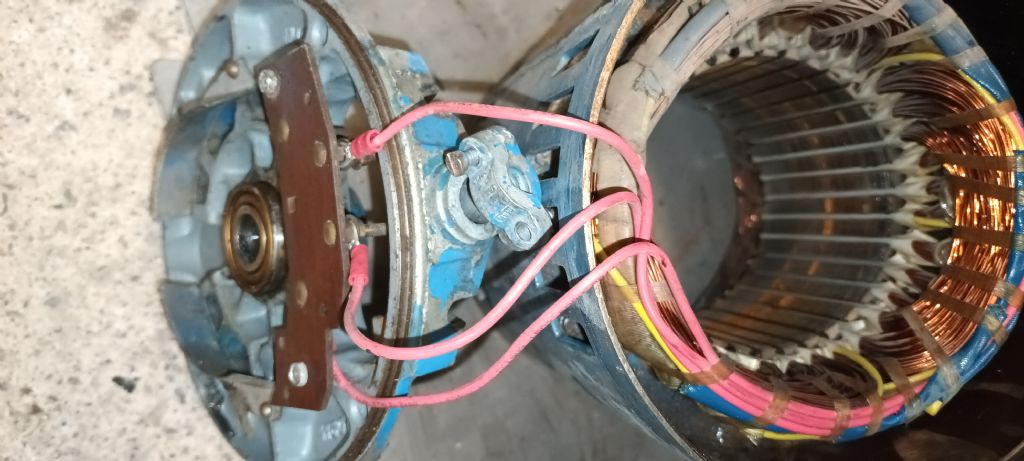

                Robert thanks for the tip on resistance checking. This will be my first job at the weekend. Can you all please make yourselves available on Saturday morning for a raft of blurry photos and poorly constructed questions😀😀

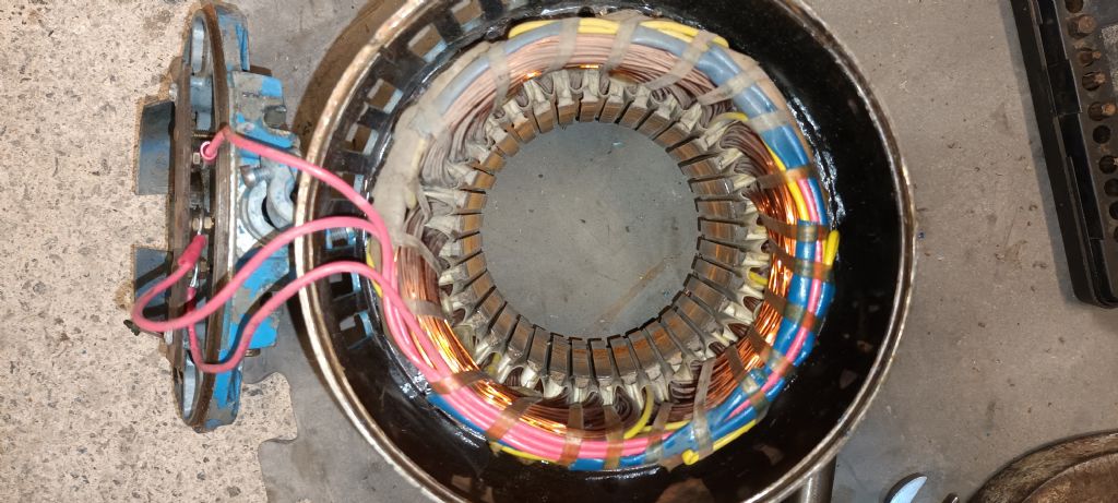

                        So I definately dont have the option of reconfiguring the motor. There are only 3 wires. I'm going to try running it as is, perhaps trying to fool it as per the referenced blog post. If that's no good I think I will swap the motor out and perhaps take the opportunity to up the power to 2hp.
                        #582572
                        noel shelley
                          @noelshelley55608
                          Isn't star point opposite the wires bound up ? It will be there somewhere ! Noel.

                            I think I can see 6 tails from the windings sleeved in yellow. Three, will be combined to form the star point but will have no other connection. The other ends will be connected to each of the red wires.
                            The down side is that to convert you have to cut the tie threads find the start point and connect a wire to each of the wires and then retie. You can use soft solder for the joins but it is better to use crimps as these won't let go if the motor or wire get overheated on overload. Just copy how the current joints are made and extra insulation sleeving is applied.
                            Clive S

                                Blimey,
                                So I need to go deeper. Can I just confirm what I'm going to have a go at.
                                Release the wires bound onto the top of the stator.
                                Find three wires connected together (potentially the yellow ones).
                                Separate the three wires and assume them to be the finish end of the three windings.
                                Select each of the three (yellow) wires in turn and using continuity find its matching red wire. Mark up the wires so I know what's what.
                                Bring all 6 wires back up top and reconnect them for delta
                                Is that it?

                                            Your list of steps to take is correct. Probably the most difficult task will be doing the retying to hold the wires in place as threading through a cord can be tricky. However if you just snip the original loops but initially leave them in place and you may be able to use them to pull new thread through. However you can use small thin cable ties instead.
                                            From what I can see from your pictures you will probably find three wires, sleeved in yellow, emerging from the coils on the outer rim of the windings. Another three wires will emerge from their respective windings nearer the centre.
                                            It doesn't really matter what are start and finishes of the windings provided you can identify each of the three individual windings so you can connect them in true delta configuration. The marking is only required to ensure the motor will rotate in the right direction when connected to a 3 phase supply but if it doesn't swapping any two phase wires will make it rotate in the opposite direction.
                                            If you'd like to PM me I'll give you my phone number and I can talk you through the process as you do it. If you can make a FaceTime or Zoom call I can watch you do it and comment.

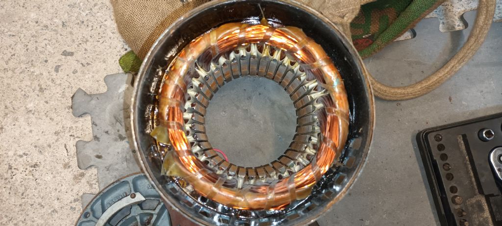

                                                On all the motors I've done shellac, varnish or similar protective coatings had been applied after tying. So things still stayed in place after snipping the string.
                                                Adhesion wasn't high. More than post it note, less than sellotape. So some careful pulling and prising with non-metallic tools got the bits I needed to work on up and out into free space with minimal disturbance to the rest.
                                                I left most of the old string behind as it clearly wasn't going to come out easily. Just snipped the trailing ends neatly close to the wiring. The coating soaked string was approaching MIG wire stiffness. Re-tied with some nice cotton string 'cos I had some.
                                                Dunno what the modern advice is on re-coating. I "obtained" a small bottle of the then proper stuff about 40 years ago. Behaves like shellac in that it separates out of the carrier liaquid quite quickly and needs regular stirring up.
                                                Clive

                                                  What is the purpose of the shellac? Is it simply to stiffen up the ties to ensure they don't come undone? I was planning to replace with zip ties.
                                                  #582756
                                                  Mike Poole
                                                    @mikepoole82104
                                                    I think the purpose of the shellac was to stabilise the windings so that the wires could not fret and compromise the insulation, these days it seems to be a liquid epoxy. We used to use a flat cotton tape like the motor in the pictures and the shellac would be absorbed to deny any possibility of moisture being absorbed. We would use an off cut of the winding wire as a needle to thread the tape through the windings, bent to form a blunt end to avoid damaging the windings. The interconnections were made by twisting the ends and flashing them with an oxy-acetylene torch to fuse the connection into a neat ball. To solder the ends to the tails it is easy to burn the insulating varnish off the wire and scrape clean, just scraping is not so easy as the coating used Is extremely tough, if you use a flame use a small one and keep an eye on where you point it.

                                                      I don't know if the stuff I have or that on the motors I did actually is shellac but it clearly builds thin layer of insulation over everything.
                                                      I imagine the idea is to stop the string moving around due to vibration so it doesn't eventually work its way through the insulation coating on the wire causing turn to turn shorts. Clearly a bad thing. As I understand it the wire in the coils have vibrational forces on them when the motor is running, think transformer hum, so some sort of restraint is needed.
