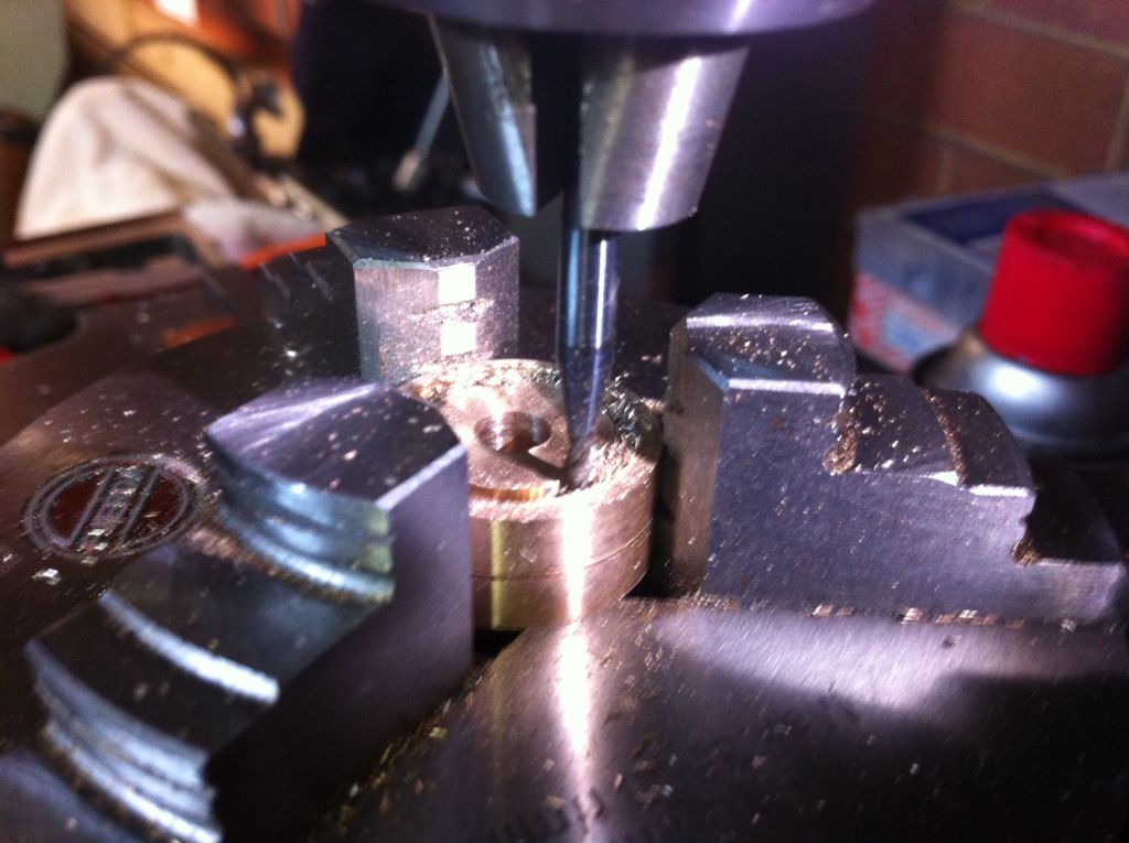

      Posted by Danny M2Z on 09/11/2015 06:47:00:
      My last set of soft jaws (to hold a Cox engine backpate) went like this.
      I don't understand this description – any pictures / web pages / previous threads that might help me please ?
      Bill
      Bill, I only just spotted your query so replied in another thread – Small Soft Jaws.

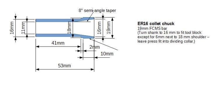

            I have three things still to do. One is to set up a grinder with a CBN wheel, on its own base board that the Acute can mount on. I'll need to make some raising blocks for my 6" Elu grinder to give enough height. I also want to make it so the Acute can mount at each end.
            One of my main jobs for the system will be to sharpen mills for my Novamill which has ER16 collets. As I have a set of these I want to make an ER16 holder, and I'm going to try to make a 12-sided dividing collar 25mm a/f which will fit just behind the chuck so I can use the same thing for 2, 3 and 4 flute cutters.

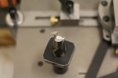

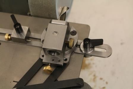

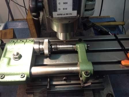

              Here is the unit set up temporarily on my grinding bench. I've bought a CBN wheel and fitted it to my ELU grinder (much easier than I expected, though I need to extend the guard to cover the wider wheel). Note that I have replaced the lever screw that clamps the cutter holder with a brass thumb screw – this is easier to use as the lever I found didn't give enough rotation to clamp the holder without fouling the tool block, so you had to take the tool block out of its slide. Also I found that the square end on the holder, which indexes the cutter, fouled on the bottom of the slot in the tool block and prevented the latter sitting snugly in the slot. The tool block is made 25mm square but the square flange on the holder was 25.4mm, 1", as shown in the drawing. This doesn't seem right to me so I milled a shade off each face of the square down to 25mm and it now fits much better.

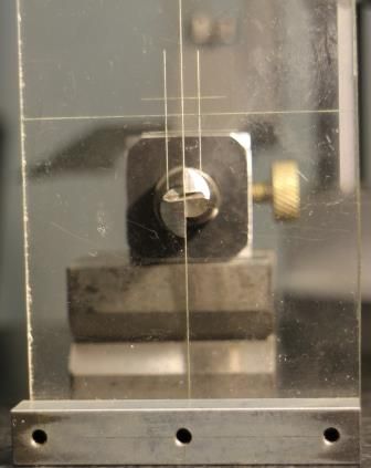

              In order to align the cutter to the sides of the square holder I used a simple optical aid I made years ago.
              This is a scrap of perspex screwed onto a bit of square bar sitting on my surface plate. The tool block perches on a Vee-block (just for height). There's a vertical line scribed on the perspex and you just align the cutter edges to this as in the photo. I'll get around to making a dedicated version for the Acute later (when a get a "tuit" I expect).

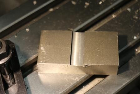

              I've had a go at 2 cutters so far. The first was a 1/2" end mill, which I now realise had been sharpened quite a lot before I got it (very surplus). This tirned out to really need re-gashing so the sharpening didn't go well – back into the "too sharpen" box with it! So then I tried a 1/2" slot drill, shown mounted in the photo. This went fine, here is the result.
              Mounted this on the mill and took a trial cut on a block of mild steel, feeding the cutter straight down as shown in Gary's example video, about 2.5mm, then elongated the hole into a slot. The mill cut very nicely, making a nice "chuffing" sound and freely generating chips. Obviously it sharpened well – here is the end result –

                  Very slow progress over the last week. One thing I have clarified with Gary is that I shouldn't have milled down the "dividing square" on the tool holder to 25mm – the idea is that the holder and block sit on the front end of the holder and back edge of the block to ensure the holder is in its exact position – Gary points out that if the 25mm square is not quite concentric with the holder shank there could be a small error in one or two positions. I see what he means – I took great care to ensure the square was concentric, but I'll think twice before modifying another one.
                  I've made a start on the ER16 collet holder, so far just making sure I can screw cut the M19x1mm thread for the mini clamp nut – previously I haven't had much success CNC threading on my converted S7. Worked on a scrap of 3/4 FCMS bar, with a bit of fiddling and editing the g-code generated by the Mach 3 Simple Threading wizard to stop the tool crashing into the chuck (!) I managed to form a nice well-fitting thread second try. Then drilled the bar out 11 mm and tried making the taper – this was a bit more fiddly as I need to find a satisfactory way to reference a boring tool, but eventually able to make a well fitting ER16 socket as well. So much for the practice – now to put it into action "in anger". I'll take some photos as I'm making the "proper" component – hopefully this coming week.

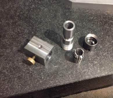

                            Hi Simon, actually there isn't that much work, compared with say a Quorn! It has probably taken me less than 10 days solid work spread out over a few weeks so far, don't despair! If you meet any problems Gary is very helpful by email and I'll be glad to try to help.

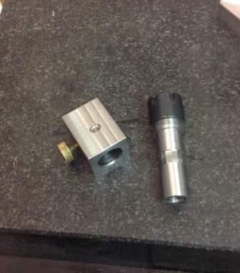

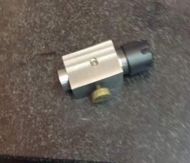

                            OK, so this is the ER16 holder alongside the tool block (my own design). It is turned from (I think) EN1a or something similar, 3/4" diameter. I spent quite a while working out and testing the g-code for my CNC S7 to cut the taper for the collet, and the thread – time well spent as these were a doddle.  Here's a drawing of the item.
                            Originally I was going to make a collar around the shank with 12 sides and fixed by a set screw, but then I realised that it could be done more neatly by making 12 flats around the shank that the locking screw can bear on.
                            This is the holder set up on the dividing head.  I clamped a 10 mm bar in an ER16 collet in the holder, with the other end of the bar in a Myford collet in the DH, and supporting the tail of the holder using the DH tailstock.  I intended to make the faces 14mm a/f but had a bit of a wobble so they ended up ~13.5 mm a/f.  They double as a dividing gadget and also to take a wrench to tighten the collet.  Note that the collet nut has to be a "mini" type to clear the tool slide, not the standard ER16 type.
                            Holder in tool block.
                            All the parts and a 10mm collet.

                                                    I have started my kit and am up to the first image of John's thread. I find turning radial grooves difficult so I used a 2 mm carbide end mill and set up drilled and parted discs of LG2 on the rotary table on the mill. I first attempted this with the laser cut discs provided but they raised huge burrs which made it difficult to see, and impossible to test fit the o-ring. My long M6 screws are too long but about 3 mm so I will either cut them down or use spacers. It would be much better if all the laser cut steel discs in the kit were CNC machined instead, but I suppose Garry does what is most economical to keep prices down.mill ring.jpg
                                                    #219334
                                                    John Haine
                                                      @johnhaine32865
                                                      Yes, the burring is a problem with the steel plate used, whatever the machining method. Like you I parted my discs off a bit of bar, but turned the grooves – can't remember what tool I used though!
