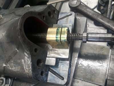

      I have a tom senior e type and it seems to have had very little use, but it has 20 thou  backlash on both axis would this have left the factory like this and is it acceptable ?   By the look of the machine I am sure it is not wear as it looks to have been well cared for and as I said little used. Thank you David

              All lathes have some clearance in the leadscrew (unless it is fitted with ball nuts with anti backlash as used on CNC machines), otherwise they would be difficult to turn. Many have a split leadscrew nut that can be adjusted.
              Slop in the leadscrew is only an annoyance and precision work can still be done if you only set the distance by turning the dial in one direction. If you overshoot the mark, retract the slide and advance again.
              backlash

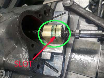

                  It wouldn’t have left the factory like that – new machines are adjusted by the maker to minimise backlash.  But they don’t stay perfectly adjusted for long because the usual anti-backlash mechanism isn’t perfect.  Rather a compromise that does the job cheaply, with an easily replaced nut when it wears out.   (Assuming a spare can be found for a machine long out of production! If you need to make one, ask – several alternatives.   Replacing a lead-screw is more difficult.)
                  Paul’s picture shows a typical anti-backlash arrangement.  A slot is cut part way through a brass or bronze nut, and a screw, not visible, is used to open or close the slot.   Bending the nut at the slot causes its thread to grip the lead-screw more tightly.
                  backlash
                  Sadly, nut squeezing causes severe wear, even if the lead-screw is well oiled. Therefore, avoid obsessively minimising backlash as it can take years off the life of the nut and the lead-screw.
