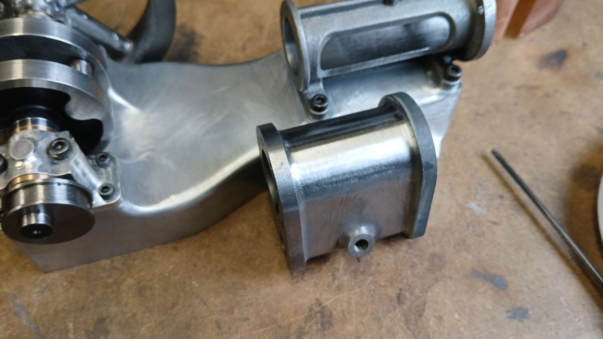

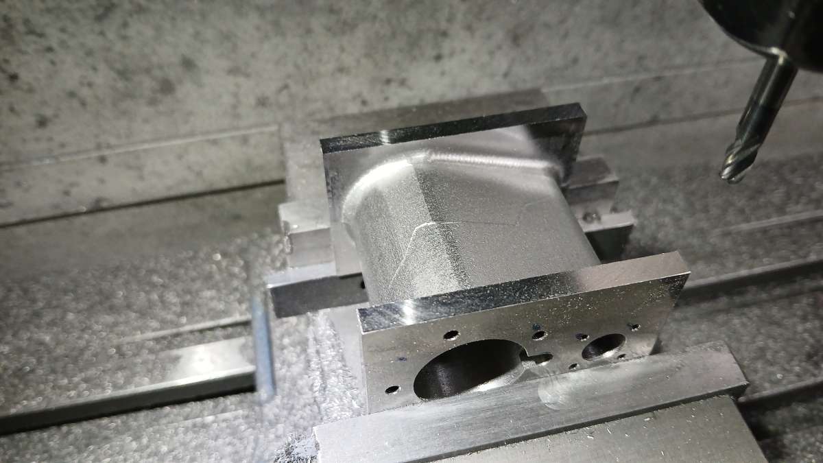

                        Although I don’t often finish casting so smoothly I do finish CNC machined parts where the finishing cuts can leave a series of scallops.
                        I start with fine files and then needle files for tighter spots. Then onto abrasive, 240 is a bit fine to start with if you want to get the job done in a reasonable time then start with 120 and work through 180 and 240 which is where I tend to stop for painte dsurfaces, if it is say a bright flywheel rin or a crankcase that is going to get bead blasted then I’ll go 320 and 400.
                        This was cast iron off the machine
                        20250327_163547
                        Filed and taken to 240
                        20250415_101725
                        20250415_101749
                        The aluminium was also taken to 240 from a similar starting point, both will be painted so no need for more but Garyflex blocks are also quite good when you run out of grits on cloth.
                        20250415_101900

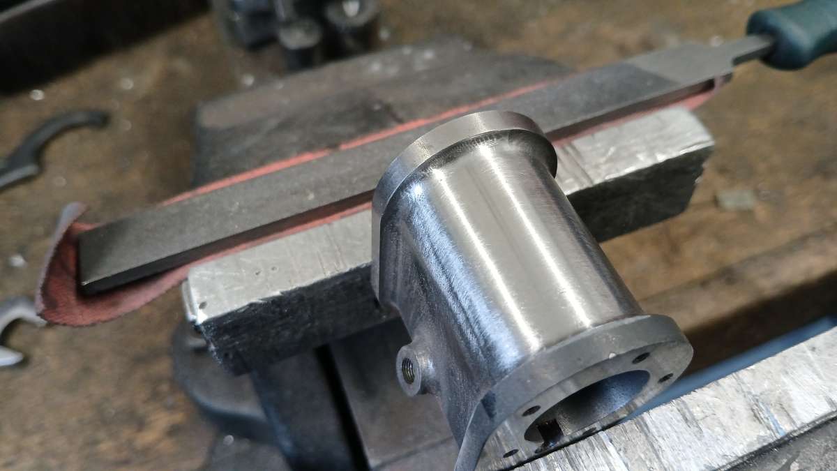

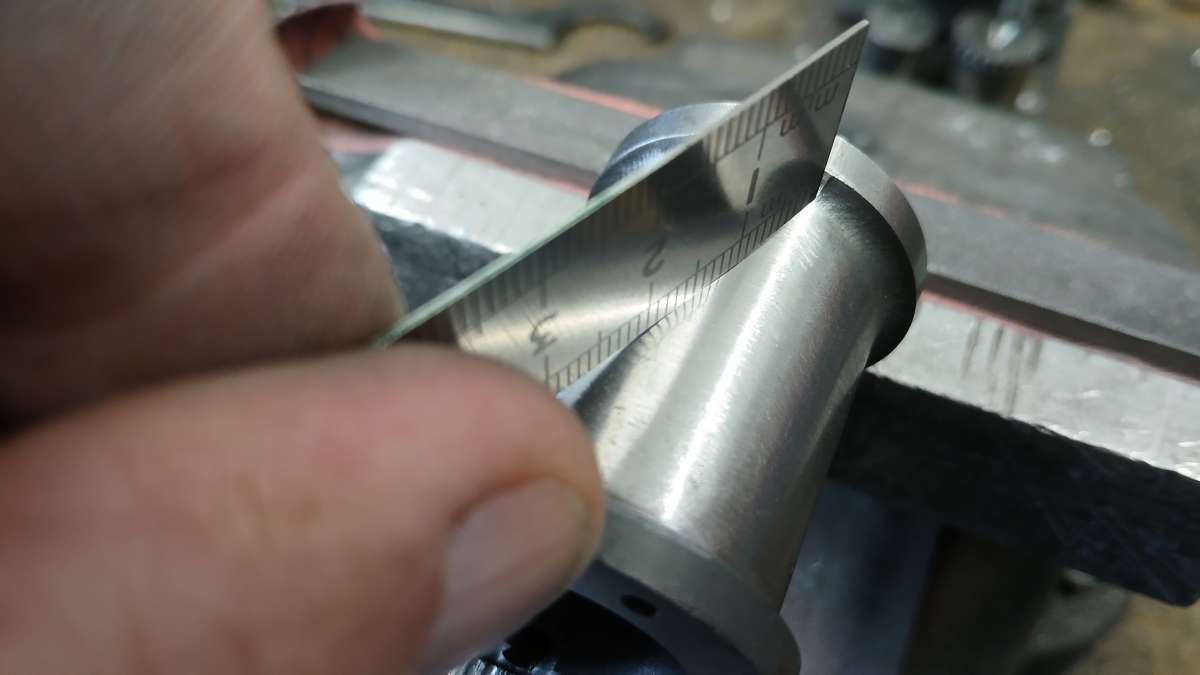

                        I quite like the Hermes “JFLEX” as it is not too stiff and the abrasive stay stuck to the cloth where as the cheapstuff it just drops off. For flat areas I tend to hold a strip along the length of a 6″ file and more curved work a longer strip use in “shoeshine” fashion works well.
