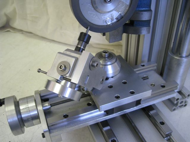

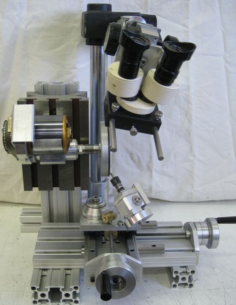

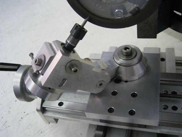

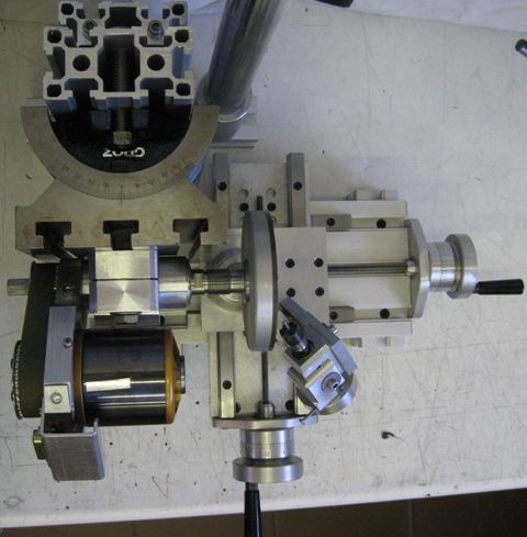

      A Basic Small T&C grinder, chiefly to sharpen small carbide drills and engraving D Bits.
      #268637
      Joseph Noci 1
        @josephnoci1
        Since I was asked to tell more about this small grinder, Here goes:
        Post Character Count requires extreme brevity….
        A small grinder to sharpen small Carbide drill bits and V -D-engraving bits. (See a little in my 'new-member' intro).
        Aluminium extrusions for the main structure, machine slider rails and blocks for the 3 axes. 1mm pitch M6 Stainless steel threaded leadscrews with split brass nuts. Handwheel graduations giving 0.02mm per graduation. EN8 Spindle, ER16 collet fits on the end and a drawbar for the wheels. Bearings – 10mm ID, 22mm OD, ZZ . Brushless motor, 280kV ( 380RPM/Volt) – 3amps at 8000 RPM. Variable 12-36v DC power supply. A PWM generator for the PWM signal to the RC motor driver (ESC) unit. Speed range at the wheel of 800 RPM to 12000 RPM.
        The motor and drive pulley was dynamically balanced.

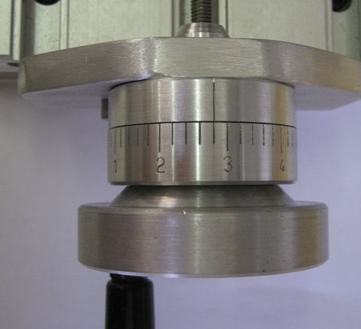

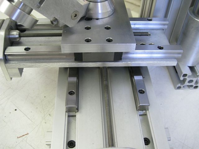

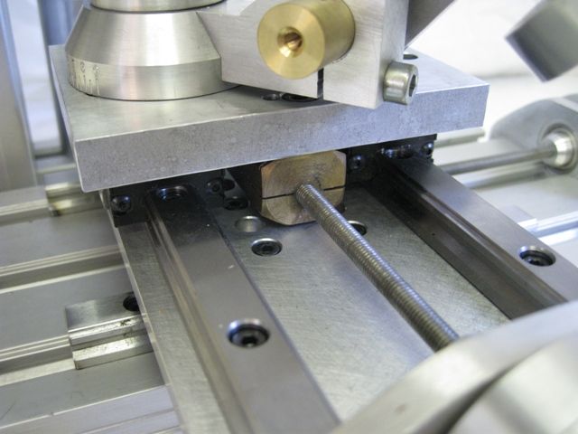

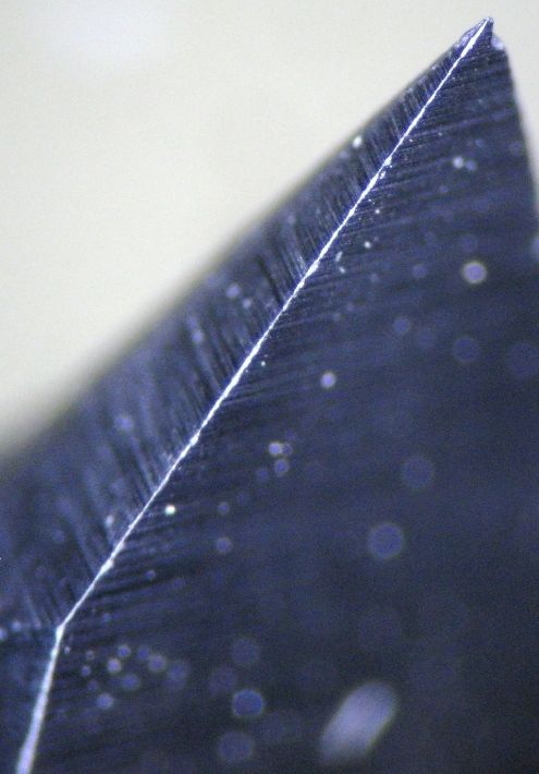

        Engraver tip through Microscope

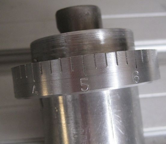

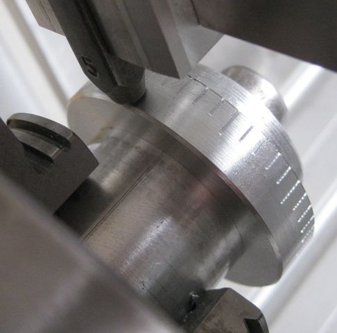

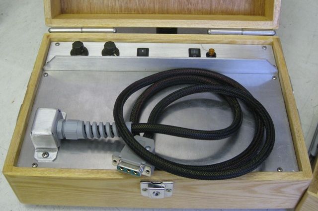

        The Power supply

          That's very sensible use of the alloy extrusions, and the tilting table yes
          … Lovely job all round.
          A few words about the motor and its drive would be appreciated.

            I am always very interested to see other blokes take on T&C machines and this one is fascinating for me as it is capable of doing the "small" stuff. It has certainly given me ideas on making more mods to my machine. Thanks Joe for a great set of detailed photos. yes

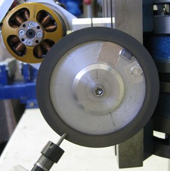

              Ok Michael, some info on the motor and Drive..
              The Motor is an AXI ( East European) brushless 3 phase Model aircraft motor – 280 RPM/Volt. It is capable of 2.5KW output in an aircraft, sort of 40V in at 100 amps…But not in this application! The max speed of the Grinder results in no more than 4 amps drawn from the DC supply.
              The motor is about 52mm diameter and 60mm long, and is of the 'outrunner' type, ie, the outer casing, containing the magnets, rotates. This gives high torque capability.
              The DC supply, run from the 220VAC mains, can give 8 amps at voltage from 10 volts up to 36volts. This is fed to a brushless motor electronic speed controller (ESC). This connects to the three phases of the motor. Since the ESC requires a Pulse Width Modulated input to control the motor speed, this is provided by a simple 555 timer, generating a pulse every 20 milliseconds, the pulse width being variable between 1 milliseconds and 2 milliseconds ( max speed). The motor has best performance when the PWM value is at 2 milliseconds, so normally I just set it to 2ms, and vary the motor speed using the variable voltage supply. Actually, its the ESC that works best, least losses, when the PWM value is max, so better to give max and vary the DC voltage supply.
              This PWM signal is the signal that in a model plane would normally come from the radio control receiver module.
              At 36volts the motor RPM is around 10000 RPM. The pulley ratio between motor and spindle is 1.25, giving a spindle RPM of around 12600 RPM, more than enough!
              That all there is to it. These motors make very attractive drive units – they are inexpensive, the larger ones have very good torque capability, and the ESC is likewise inexpensive. A source of PWM signal, if you are not up to fiddling with 555's or the like, is, from the same model Shop, a model servo tester – a little box, with a control knob on it, giving said pulse out.
              I have used the same concept on the toolpost grinders, the Hi-speed spindle of my CNC PCB engraver, and on the Sensitive Hi-Speed drill. The one variable power supply / PWM signal generator is used on each machine when required.
              Will try make a post of these as well…
              Regards
              Joe

                Sorry, meant to comment on the use of the tilting table..
                Although the table does allow the Wheel to be angled, I have never needed to do so. The greater benefit of the Table was, in fact, its weight..
                Originally the vertical column was just the extrusion, and even after dynamic balancing the rotating parts, the micro-vibrations was still a problem. The 'chipped' edge of the engraving cutters , as seen in the microscope images, shows this. The minute resonance was a problem. Adding the Table provided a 'massive' inertial mass that stilled all the resonances totally. There is a good reason that the Pro-grinders are all heavy…No more chipped cutters now.
                The chipped cutter would still shave the hair from my arm no problem, but since the cutter is typically at a 10 to 15deg included angle, the tip is very fine indeed. The tip needs the usual relief, and only penetrates the PCB surface by between 40 and 45um – we only want to engrave or isolate the copper layer, around 35um thick. So any chipping of the edge results in burrs on the copper edge, which causes the CNC Engraver floating head to lift minutely, and the cutter lifts, etc. Generally , getting a really good cutting edge take 2 or 3 grinds..
                The grade of Diamond grit plays a big role – a very fine grit is best for the final polish, but bad for tip-regrinds after breakage. And swapping wheels must be done carefully. All my wheels are balanced in situ, and their mounting position on the spindle carefully marked so they go back in the same rotation. And, strangely, I have a CBN wheel which gives me the best results ever when doing these bits – an equivalent diamond wheel, with the same bonding resin, does not do as good – Yes, I know, CBN and Diamond, all dissolving, etc…The temperatures are kept very low, very small, shallow grinds, NEVER a red tip, and so far the CBN wheel has done maybe 60 cutters, each with 2 or 3 grind sessions, with little sign of wear.
                Joe..
                  Many thanks, Joe … that 4 amp draw is the bit that makes it all do-able star
                  I always had a fear that these motors would need to be driven from LiPo sources.
                  P.S. … Just seen your follow-up note … This all makes good sense.

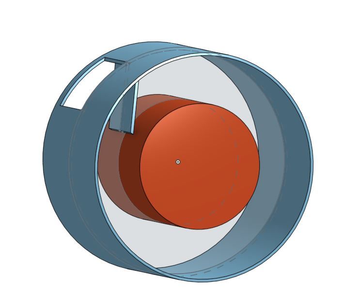

                                        Posted by Joseph Noci 1 on 28/11/2016 15:38:38:
                                        The pic does not show the air inlet slots and on the underside periphery of the cover, nor the outlets behind the drive pulley. But it does not work! The air wants to enter at the rear,ie, the backend of the outrunner, so anywhere else, there is no airflow, And then the thing get unbelievably hot in an instant! there is about 3mm clearance tween motor and inner of the cover, and the air friction there rapidly heats the air – the case outer reaches 90degC within 20 seconds! So, the only way is to fit some sort of filter on the rear ofthe cover itself, or fit a fan on the unenclosed motor, blowing the other way..Noise, unbalance again…
                                        Still scheming..
                                        Regards
                                        Joe
                                        Joe,
                                        Really impressed with this as well as your other use of brushless motors – I did something similar as a high speed spindle but I used an inrunner and added a water cooling jacket – which was not ideal (It was written up in a ME a couple of years ago)
                                        Regarding the airflow – or lack of it – are you having an issue with the proximity of the outrunner body and the casing leading to a boundary layer being permanently attached to the motor?
                                        I might be tempted to try a) a larger diameter cover and b) a 'scraper blade almost touching the rotating body and directly in front of a slot which forms the exit path. A corresponding slot or set of tiny holes greater in cross section than the slot to allow air to enter
                                        this quick sketch might make my point clearer (the red is the motor assuming it is turning clockwise, the blue is the casing):
                                        capture.jpgSimon

                                          Great Idea Simon! Sort of a tubular Tesla Turbine!
                                          However, there are just too many issues still – The motor wants to suck air in from the rear, and if it is in a cup, with the rear covered then the air has to come around the side to the rear somehow, and I do not see how it will get there – there is maybe a 2 to 2.5mm clearance between the cup inside and the motor outside and it is exactly the boundary layer that is the problem. And if I make holes in the rear then the dust gets in there again, and then I must fit a filter of sorts. I can't easily fit a larger cup – this one is an off-the shell goody from the baking shop, and i have not found others close yet. Also, a larger cup means hacking a mounting for it – I made such a nice recess for the current one..
                                          So, I use the thing, and blow it out when done! Not a long term option, esp when using the grinder as a toolpost grinder doing magnetic steels..

                                            Perhaps feeding in air from your compressor is the answer. With suitable design the air would be expansion cooled too. Ditching the cover but a cowl for the air feed would get close to the as designed for use in aeroplanes situation.
