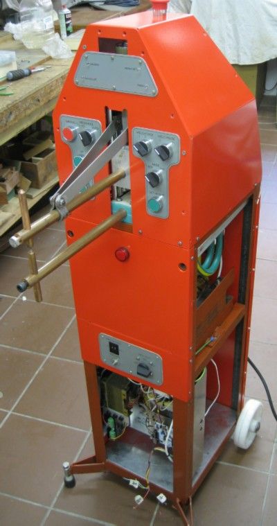

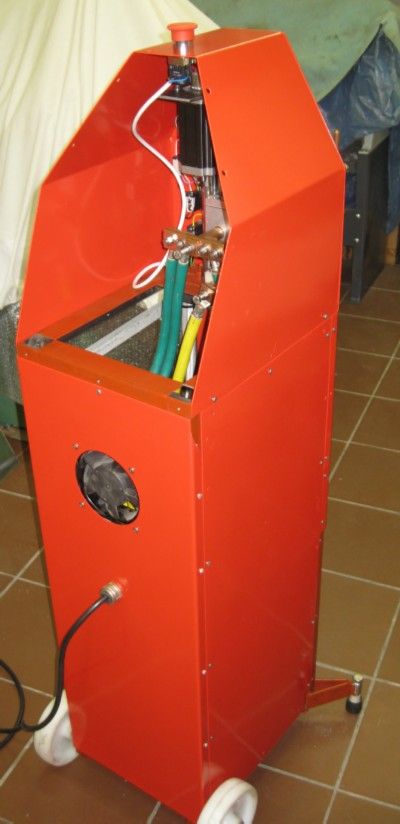

      Finally put the finishing touches to my DIY Spot welder. I did post on this a while ago, and since then was waiting for the local powder coaters to reopen – which they only did this week! So, all assembled and done, and tested. Works very well indeed.
      Uses a Nucleo ( STM based uP) Arduino type processor module.
      Stepper driven upper pincer arm, with three pincer pressure ranges – 280kg/sq.cm, 350kg/sq.cm, 450kg/sq.cm.
      Auto-Weld Modes:
      1 or 2 weld pulses per 'pinch', spaced 0.5sec apart. Pincers contact area is 3.2mm diameter
      0.2sec up to 5.9sec weld timer.
      1500amp, 2500amp, 3200amp and 4500amp settings ( on 2+2mm stainless)
      Foot pedal control.
      Manual Weld mode by pushbutton as well.
      Welds 2mm+2mm Stainless and mild steel with ease at 4000amp / 0.8sec timer setting
      Uses 40 amp 220V mains circuit – single phase – I have 3phase /60amp in the shop, so no problem…

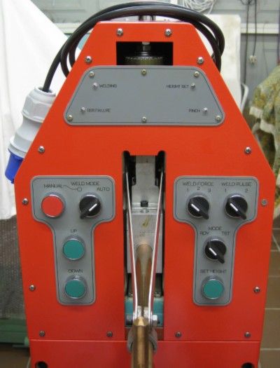

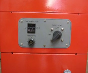

      Front main panel controls
      Sub panel controls

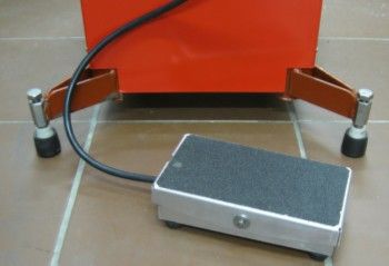

      Foot Pedal control

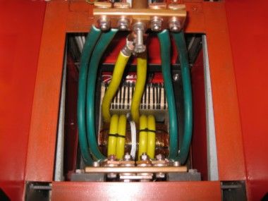

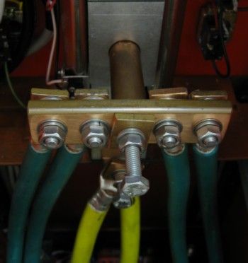

      Moving Pincer Bus bar
      Heavy Wiring

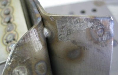

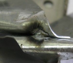

      2+2mm stainless Nugget
      0.8+0.8MM Galvanised steel Nugget. The split is the nugget tearing a hole in the lower sheet.

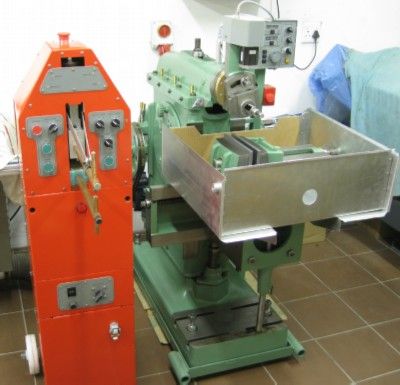

      Only Space left in the Shop – Next to My NC Shaper..
