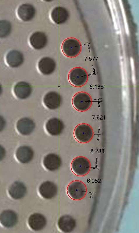

      This is a stainless steel disk … haven’t checked current availability
      It appears to have come from B&M but I got it even cheaper at Barnardo’s Charity Shop !
      I will put it on the scanner sometime, to check the hole-counts and accuracy
      … looks like there is plenty of  ‘meat’ to tweak things a little with a milling cutter if required

        The hole spacings are all over the place Michael. Even if the counts were suitable the irregular spacings would kill the idea flat.

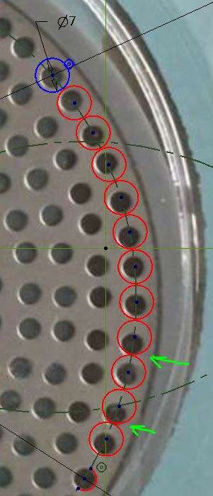

                          My CADsuggests the cunning plan of using it for dividing is holed! Even plunging with a cutter to even things up is likely to need a fair size cutter and you wouldrun the risk of one hole over lapping the next
                          holed 2
                          Still not fully opening up the arrowed holes and enlarged diameter is just about touching
