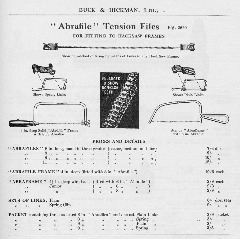

                          Nicholas Farr
                            @nicholasfarr14254
                            Hi Paul, I have never known anything but 6" junior hacksaw blades myself, but like Nick Clarke 3 have been thinking that it maybe for Abrafiles (AKA as tension files)
                            Regards Nick.

                            Paul Relf-Davies
                              @paulrelf-davies37806
                              good call..I'll see what I can find

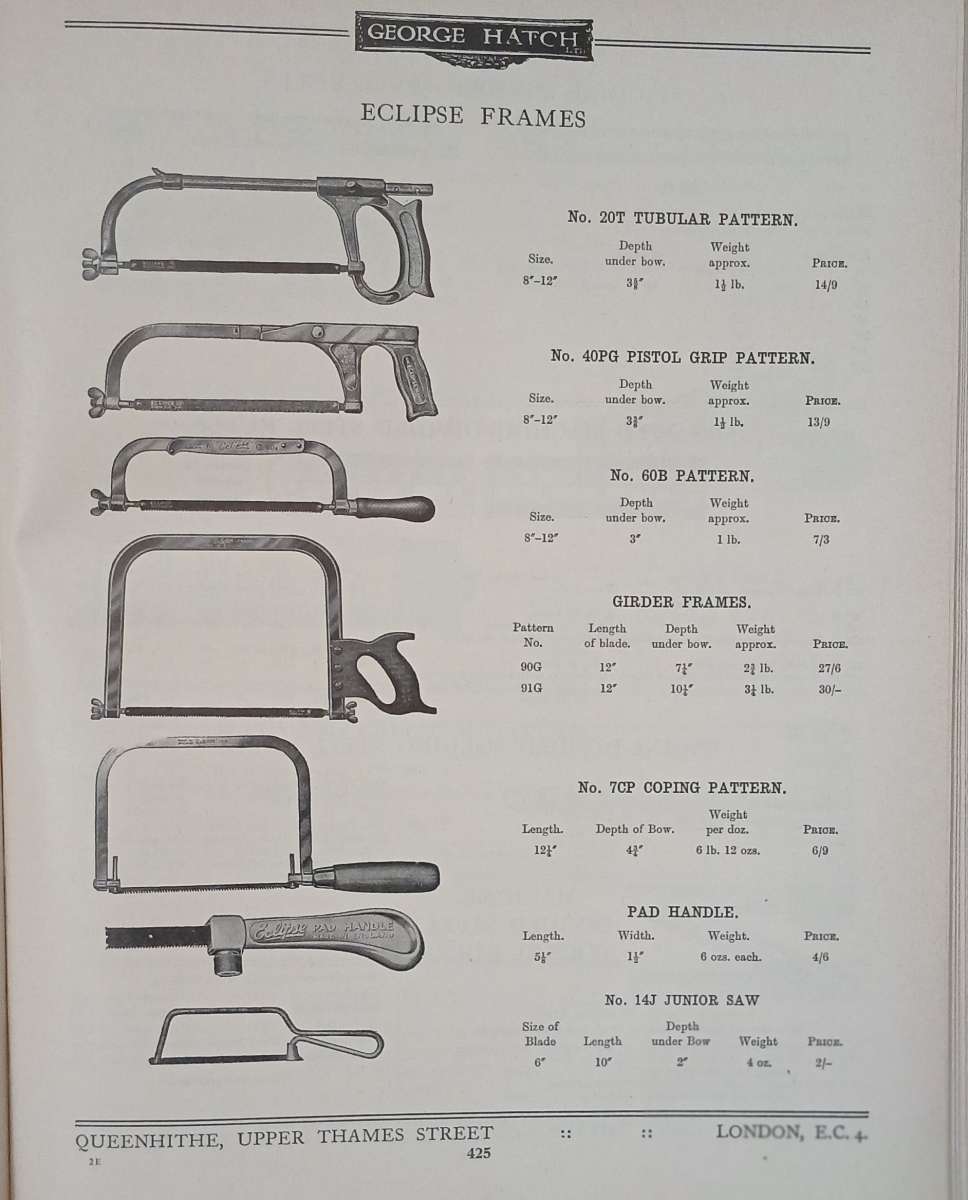

                                  Nicholas Farr
                                    @nicholasfarr14254
                                    Hi, Some adjustable hacksaw frames would allow the use of 9″ blades, but both 9″ blades were a non preferable size.
                                    20260525_135729
                                    Regards Nick.
