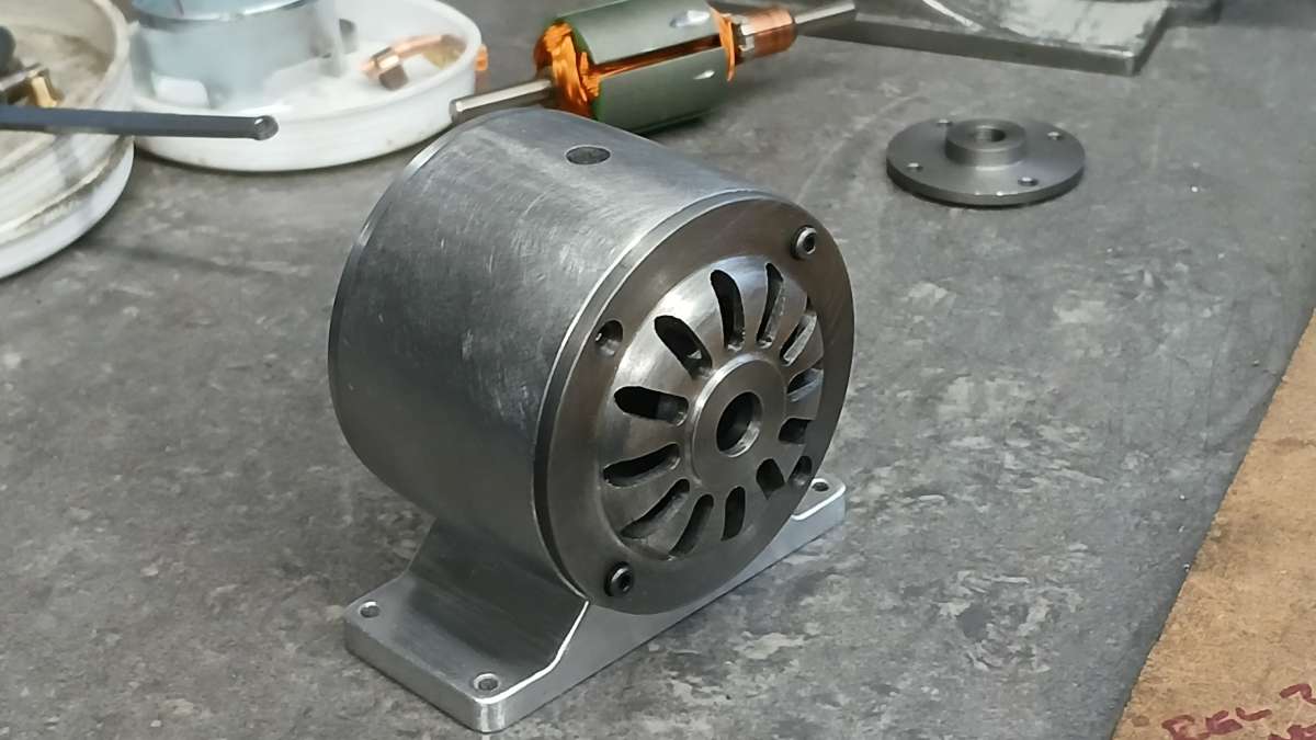

                        #769861
                          Well I don’t suppose thinking like that is going to find and encourage new blood into the hobby as that is where they hang out.
                          In the mean time the body of mine now has a barrel shape and feet.

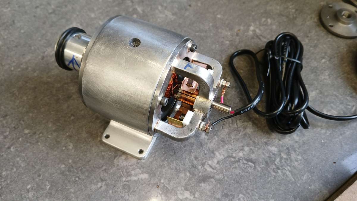

                                    #770452
                                      Thank’s Michael, good to see the general arrangement.
                                      Well I got enough work done on the business end over the last couple of days to give things a try this afternoon. Still needs a few finishing touches and some brass nuts and thumb nuts for the connections but it works. The ratio is about 4.4 :1 so dyno is going at 2500-3000 rpm which is just what I wanted as it will be similar to a Stuart so you could run it direct off a high speed engine like a BB or belt it to a slower 10V or H.
                                      I was able to use the existing spherical or is it just self aligning bearing as well as the brushes from the motor which just needed the wire tabs cutting off.
                                      20241215_142443

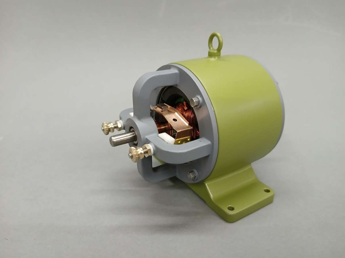

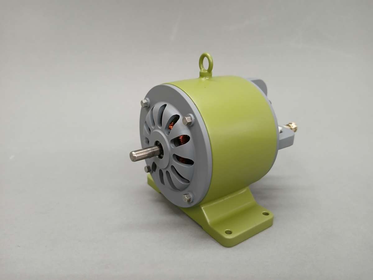

                                                Well the paint is dry, the dynamo put back together and I’ve been having a play seriously testing things.
                                                The old Stuart 10V was used as most people can relate to that. Air at around 30psi. I used the same old bit of scrap with a couple of O rings stretched over it as the pulley and ran that against the 10V’s flywheel and a couple of calculations show the dynamo is running around the 3000rpm mark for the light, probably a bit less on the other items and you can certainly hear the engine working under load when it is driving the smaller DC motor. It would be better set up with a belt at say 1:5 reduction then the 10V could be run a bit slower.
                                                It will still run as a DC motor so could be used to drive other period accessorioes and would not look bad driving the Stuart or PMR model machinery.
