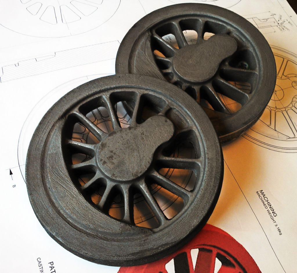

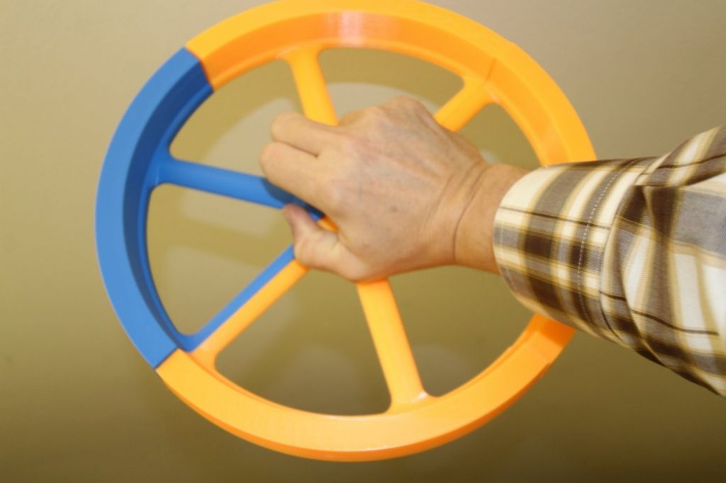

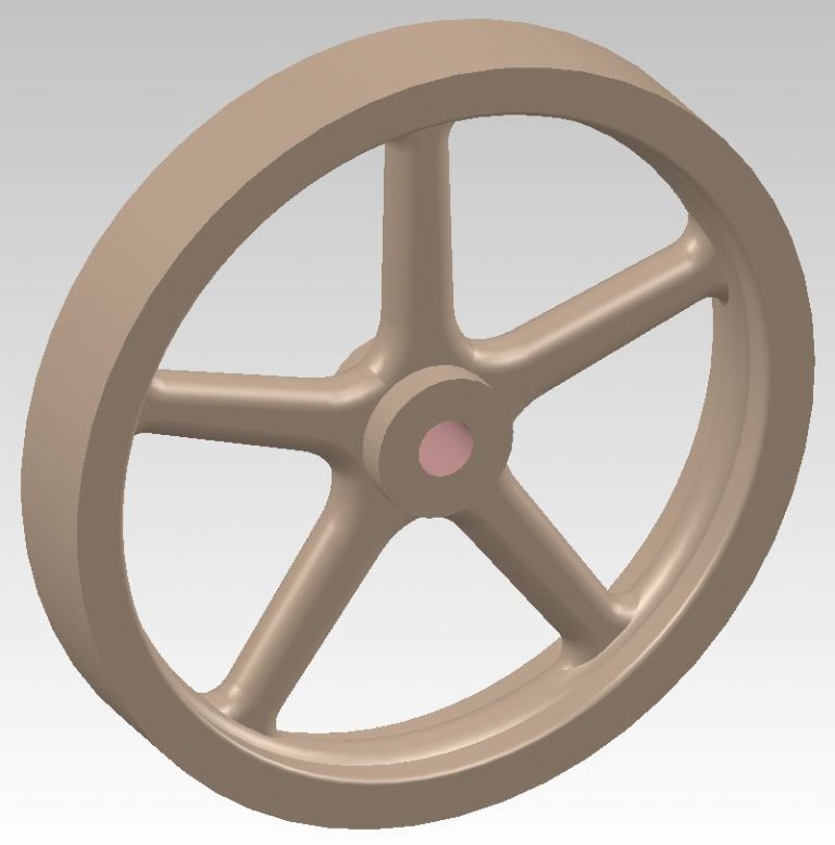

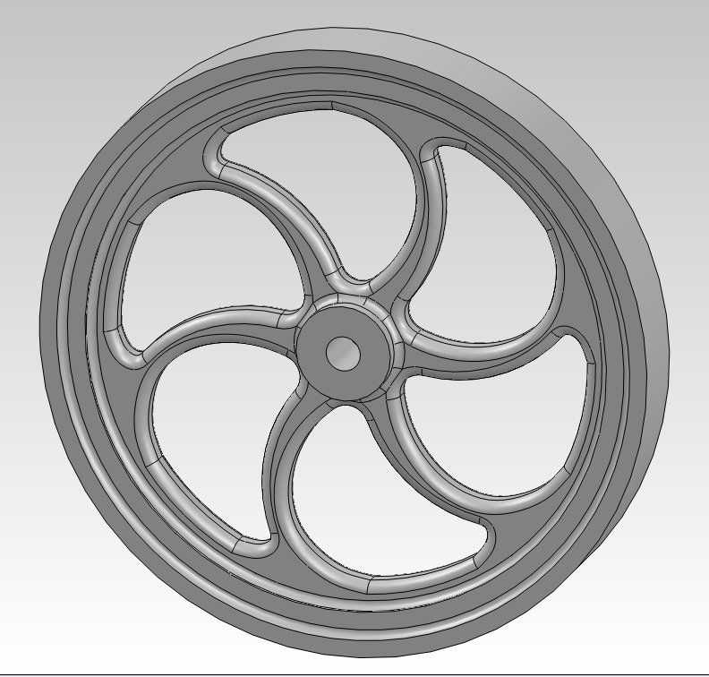

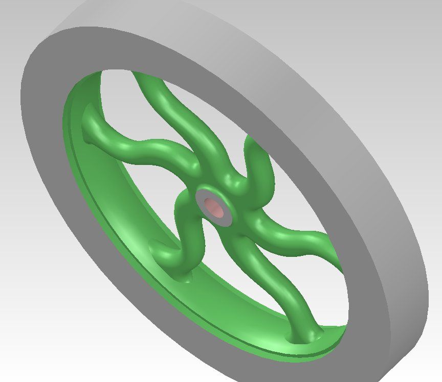

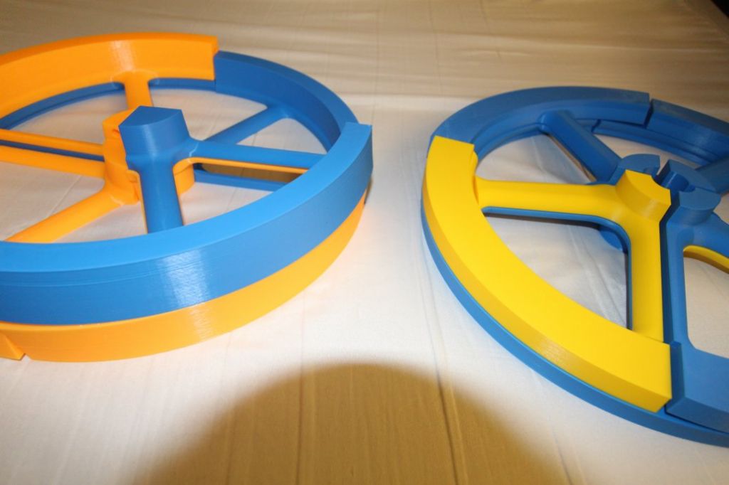

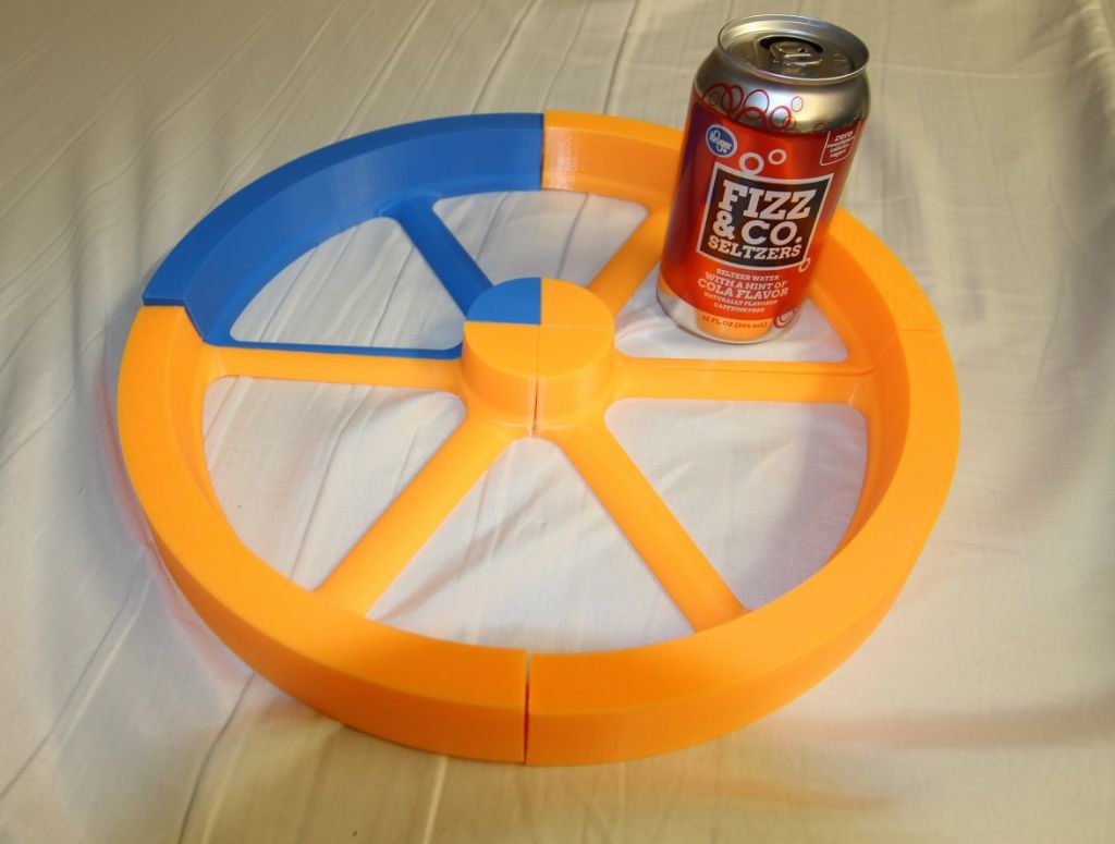

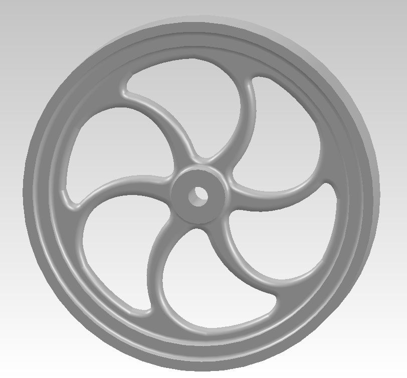

                        It is mostly about economics. At present it is cheaper to use 3D printing to produce patterns for small items and also has the advantage of being able to get more detail by investment casting. Here is an example that was investment cast starting from a 3D printed pattern from which a latex mould was made and finally the waxes: cover plate casting
                        For larger items it is still cheaper to produce patterns by CNC machining. A recent example is these castings produced from a High density polyurethane CNC machined patterns The finished tread sizes are in this case 7 7/8 inches:
                        In both these cases a 3D CAD model was required and that is where the skill lies.
