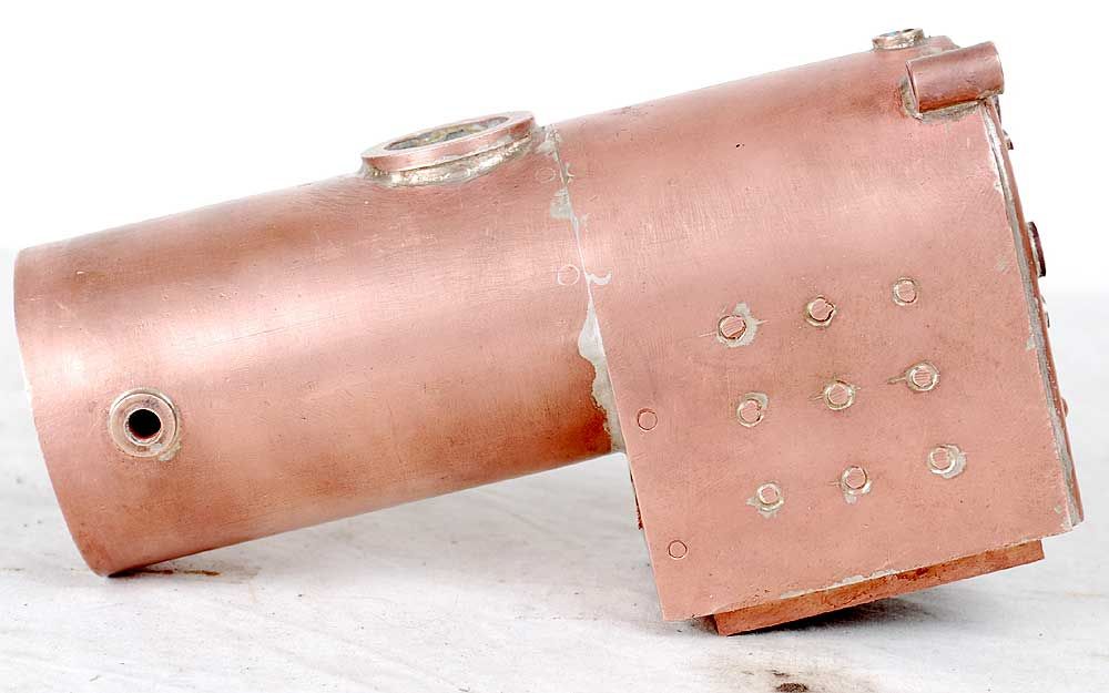

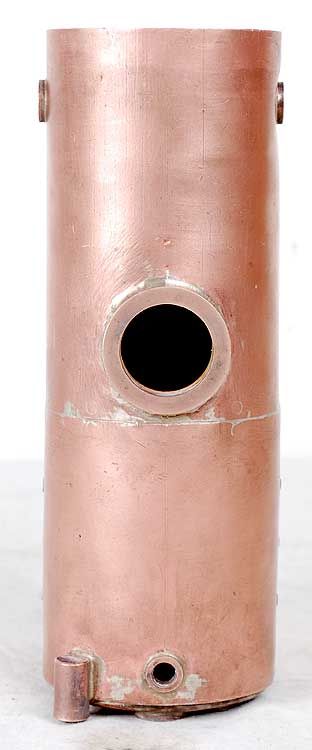

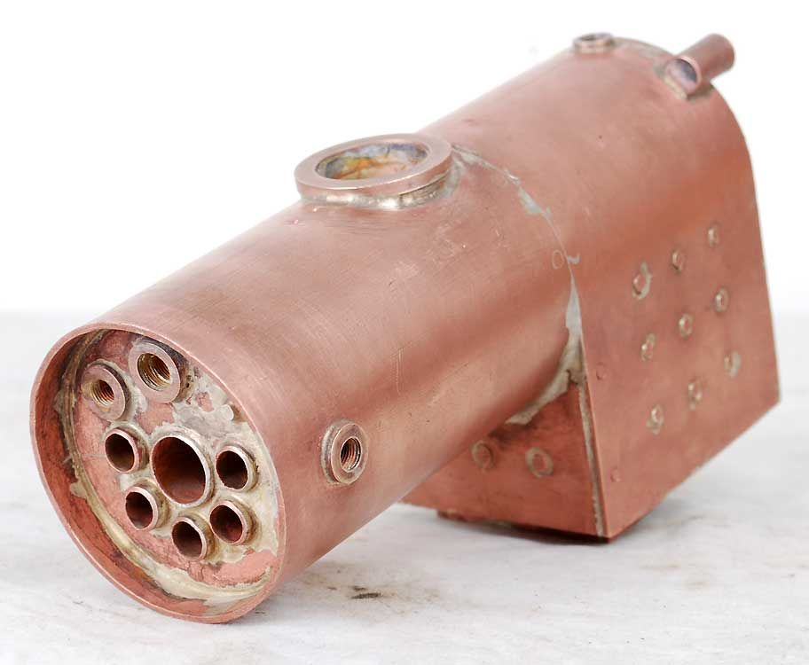

      Hi Julian
      This is something I have considered and thus far ignored for the time being. wink
      With that said, I will be bushing all areas that require threaded connections, including the safety valve spring piston linkage.

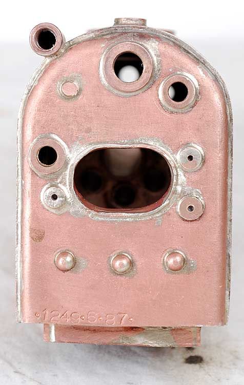

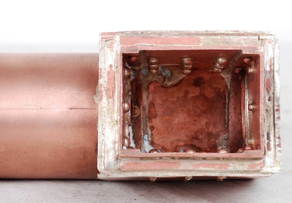

      The boiler will be constructed similar to the one shown below.
      I do also think that the top gauge glass fitting will be silver soldered as well, similar to above but more along the lines of the original and screwed to the boiler before soldering.

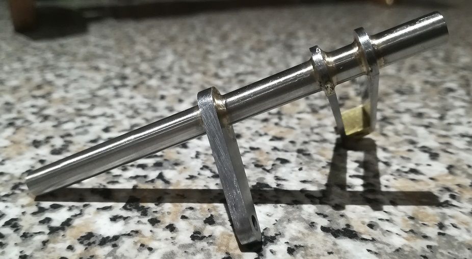

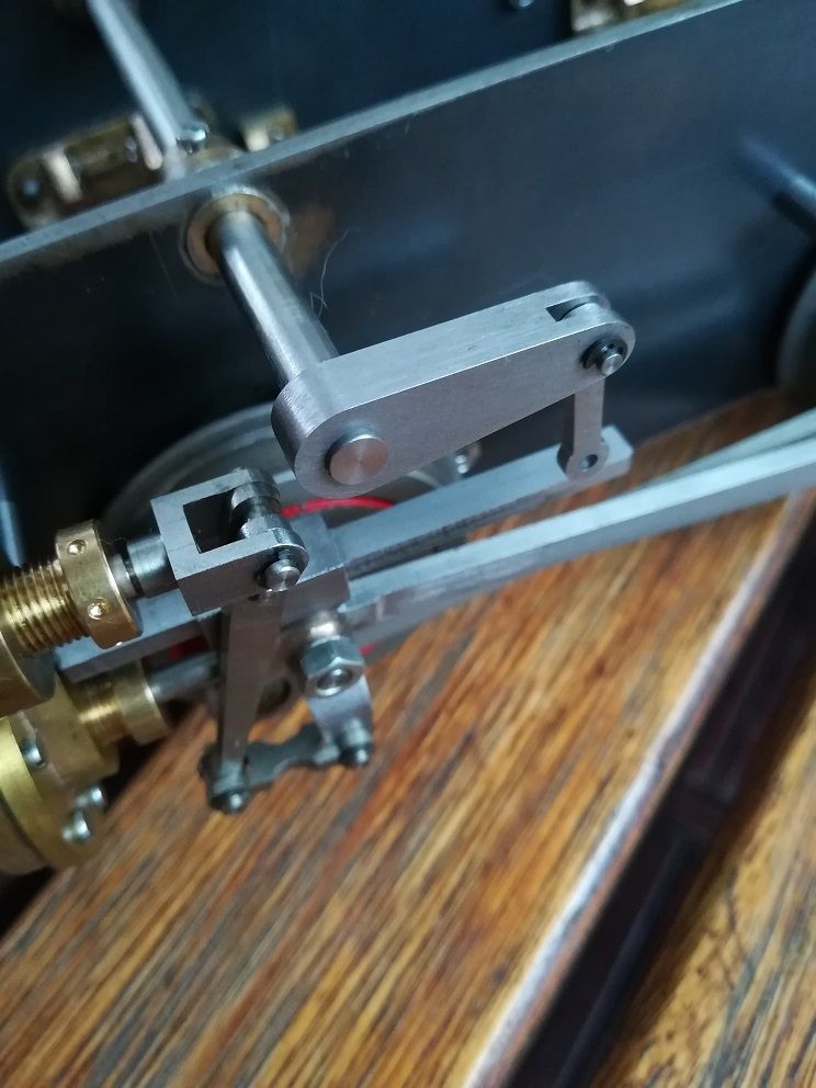

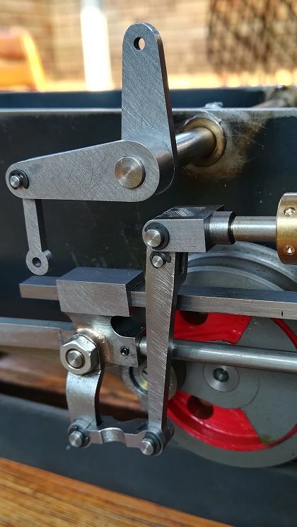

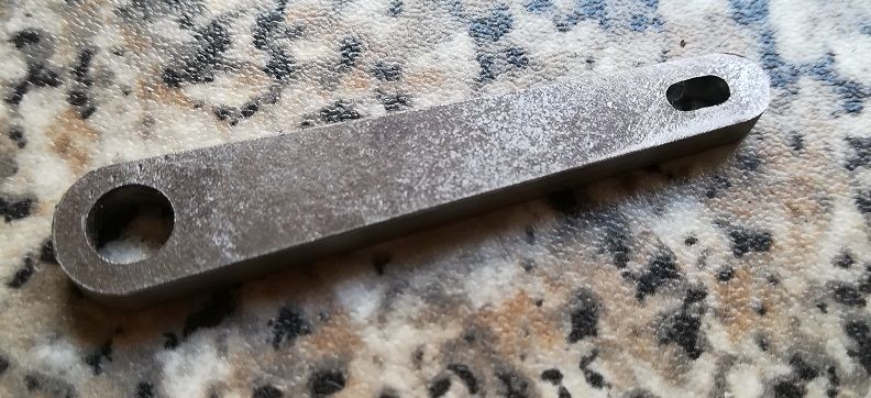

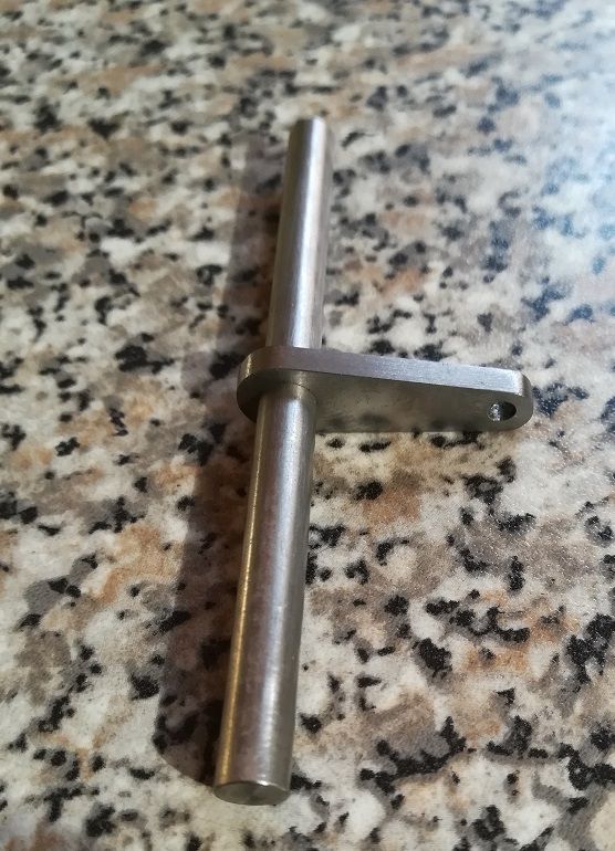

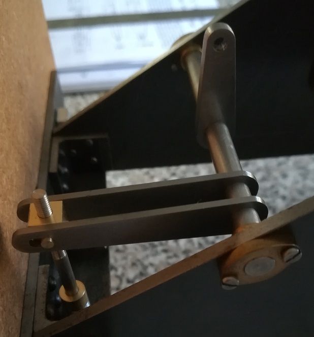

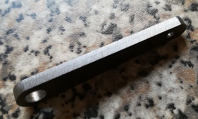

                      I have done some more work on Tich, this time on the brake gear.
                      I'm sure you would have all seen the naked brake shaft in some of my previous pictures of the full locomotive.
                      The first item made was the drop arm, this was marked out, drilled, cut out and then filed to final size.
                      Next, the two actuating arms were made. As these needed to be exactly the same in every respect, two plates were soft-soldered together and the operations were performed on both arms at the same time.
                      Above you can see the fine line where the soft solder is.
                      The shape was then rough cut with a hacksaw.
                      Filed with a bastard file.
                      Then filed with a second-cut file.
                      Finally finished to shape with a smooth file and the edges draw-filed.

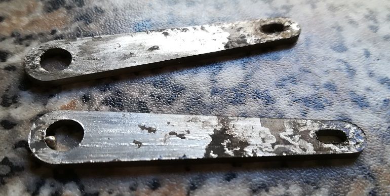

                      The small hole at the small end was lengthened into a slot to accommodate the changes in radial length as the nut is screwed up and down.
                      Finally the two pieces were separated with a bit of heat.
                      Cleaned up.
                      and then test fitted to the shaft and locomotive.
                      The whole lot was then silver-soldered, remembering the square nut between the arms before soldering.
                      Edited By Ryan Norton on 06/02/2018 15:59:24

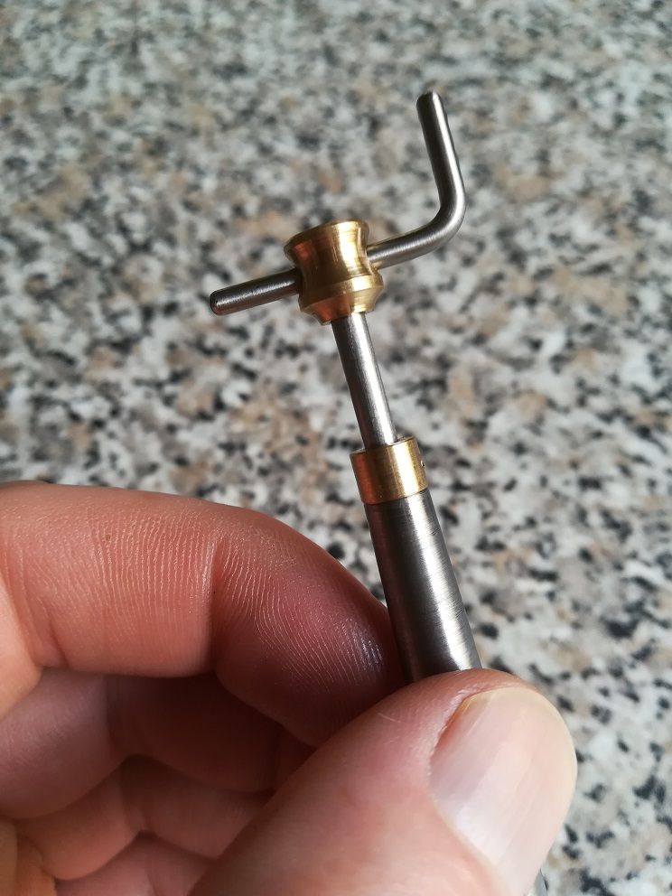

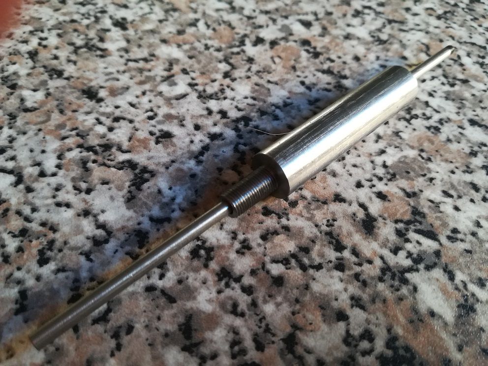

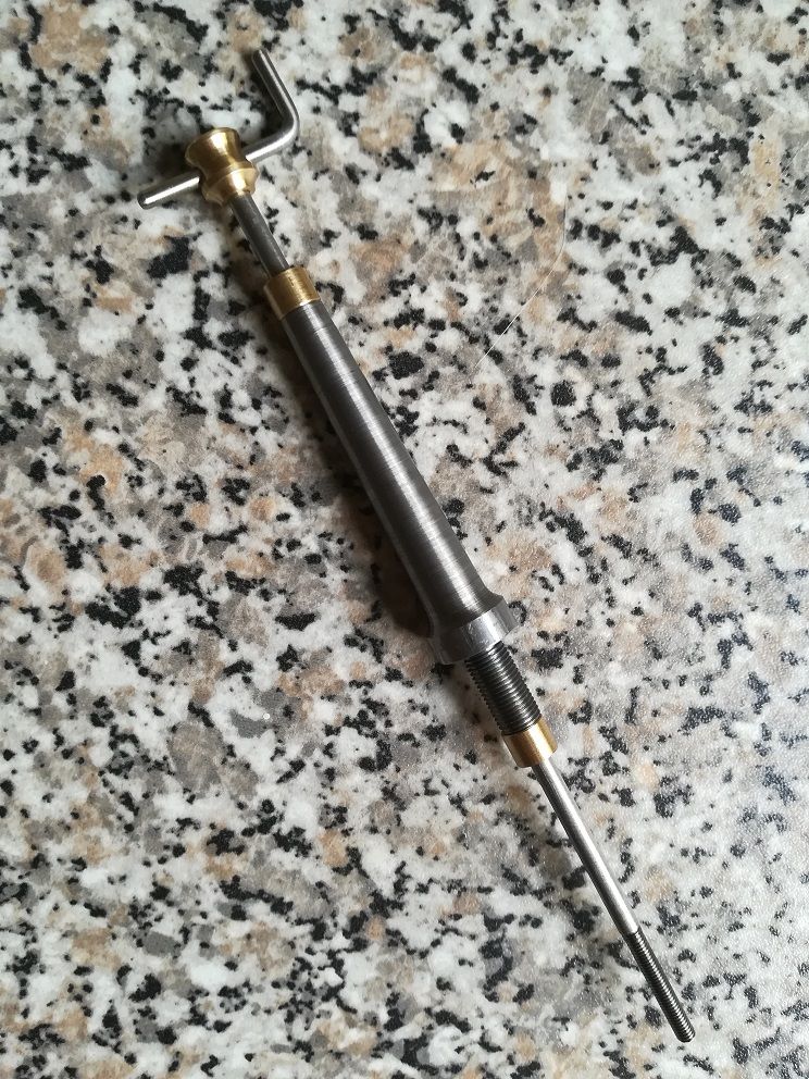

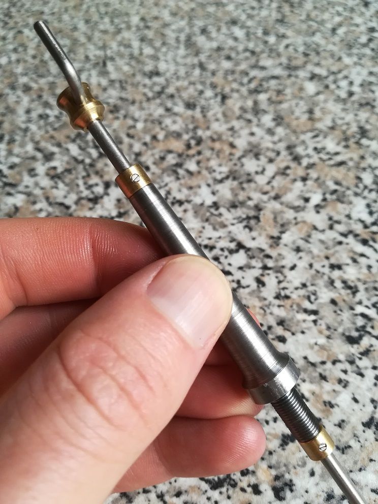

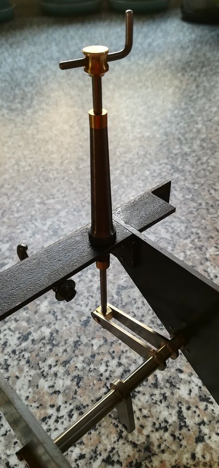

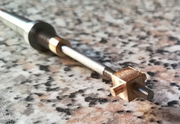

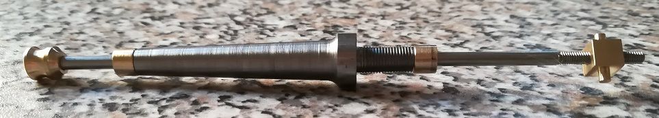

                        At the same time I fabricated the the brake column and spindle with all the various components.
                        See the pictures below of the various stages of work.
                        Instead of pinning the brass collars to the shaft I made M2 x 1mm long grub screws which hold the collars to the shaft.

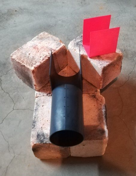

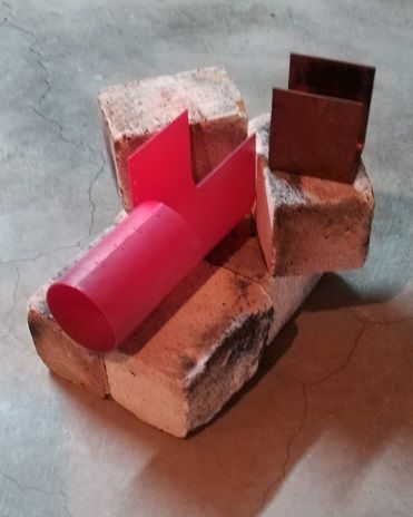

                            First, a test of the new propane torch by doing some final annealing of the outer boiler wrapper and firebox wrapper.

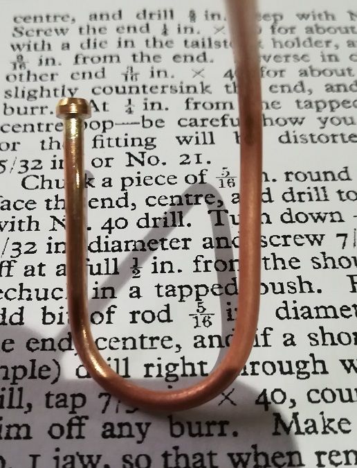

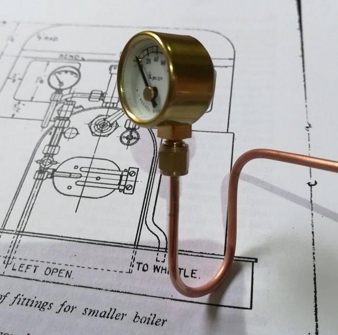

                            Lastly, I tried my hand at some copper tube bending and cone fabrication for the pressure gauge.

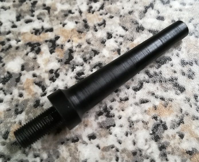

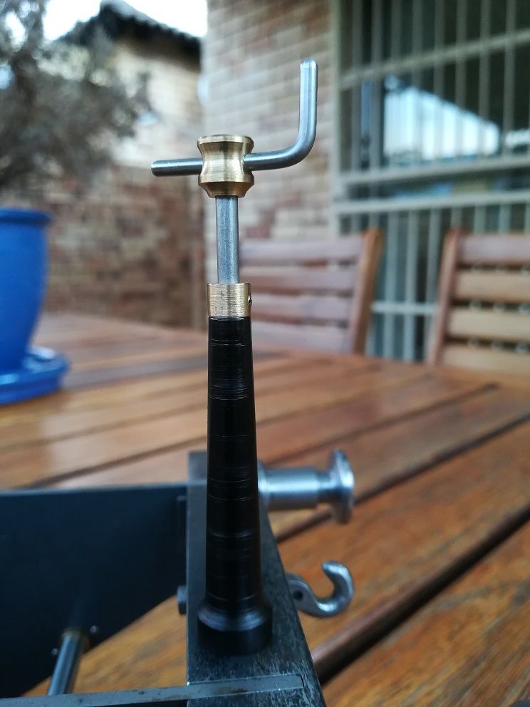

                                  I have been working again on Tich, with emphasis on the brake gear and valve gear.
                                  I blackened the brake column with some used motor oil which worked wonderfully.
                                  I am happy with this result. At least it is protected from corrosion and will not chip.

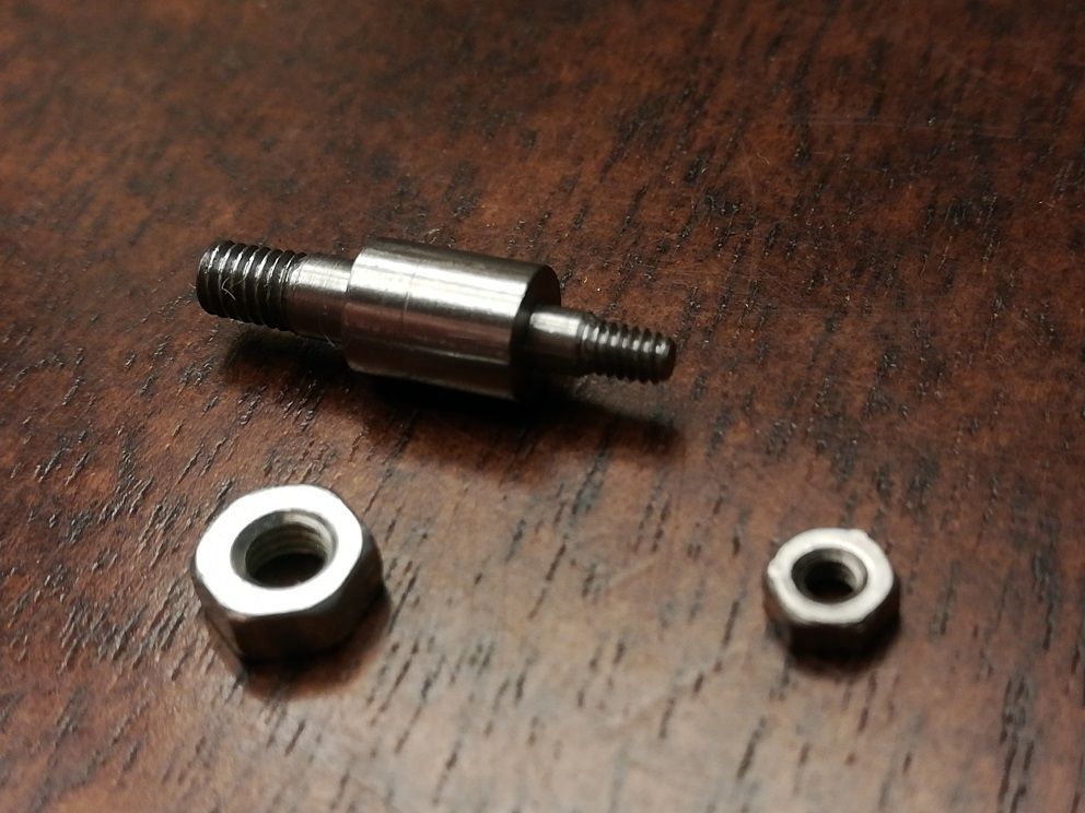

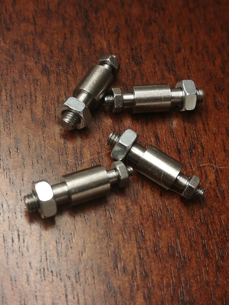

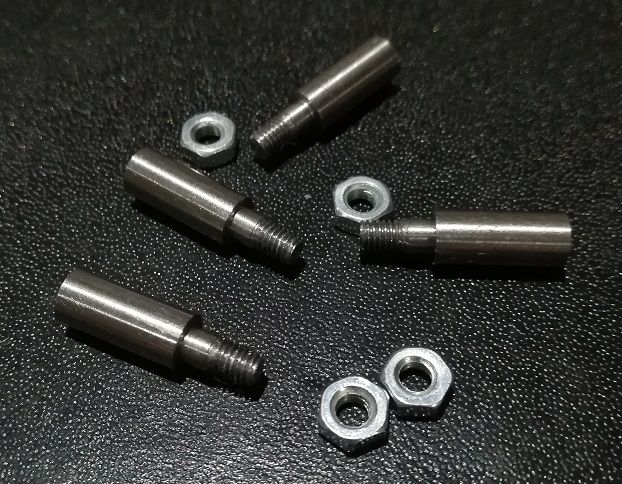

                                    I then moved onto the hanger pins which were fun to turn and thread. This was a straightforward job requiring no further explanation. The one side is M3 and the other M2.

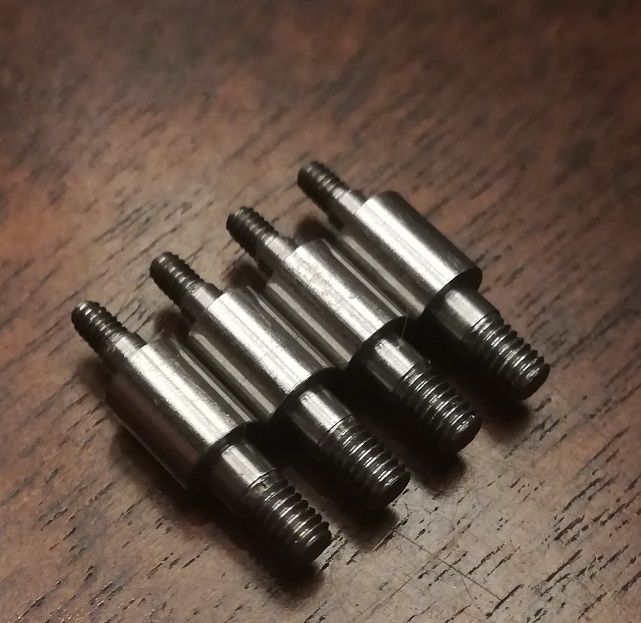

                                    #376590
                                    Ryan Norton
                                      @ryannorton40317

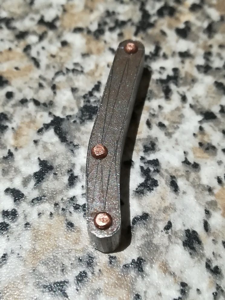

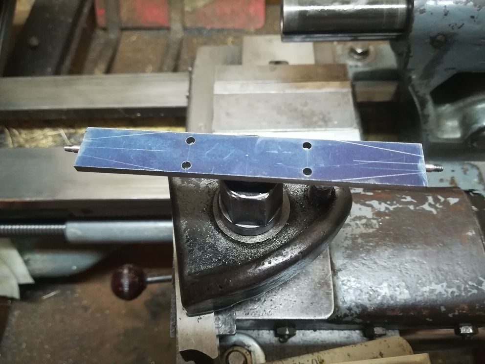

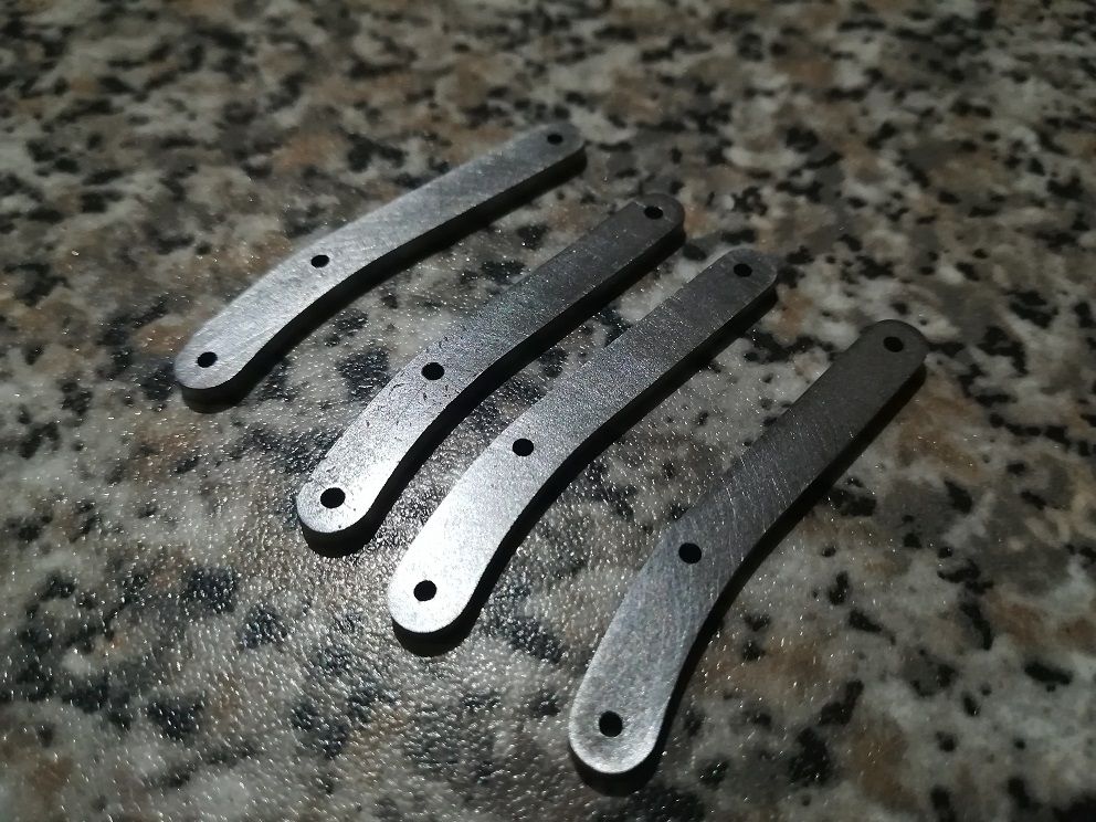

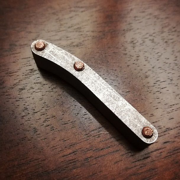

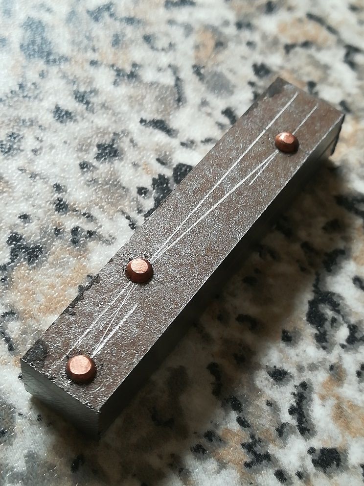

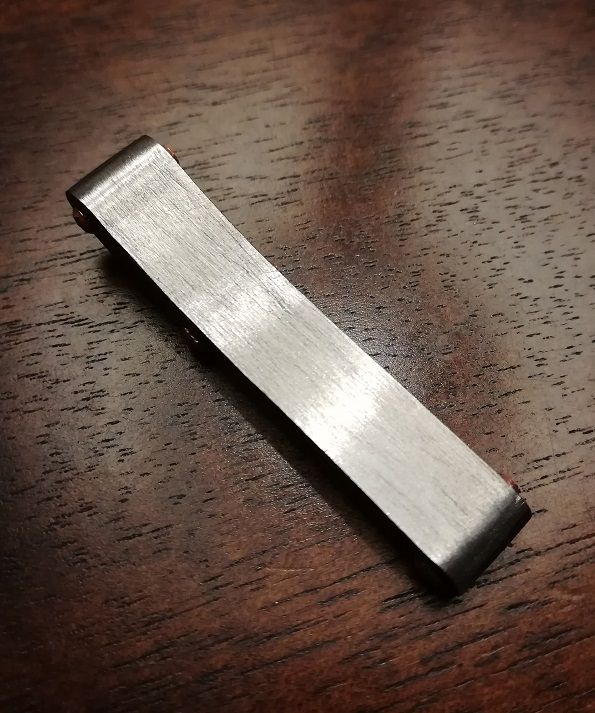

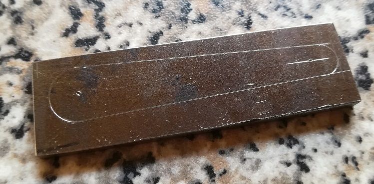

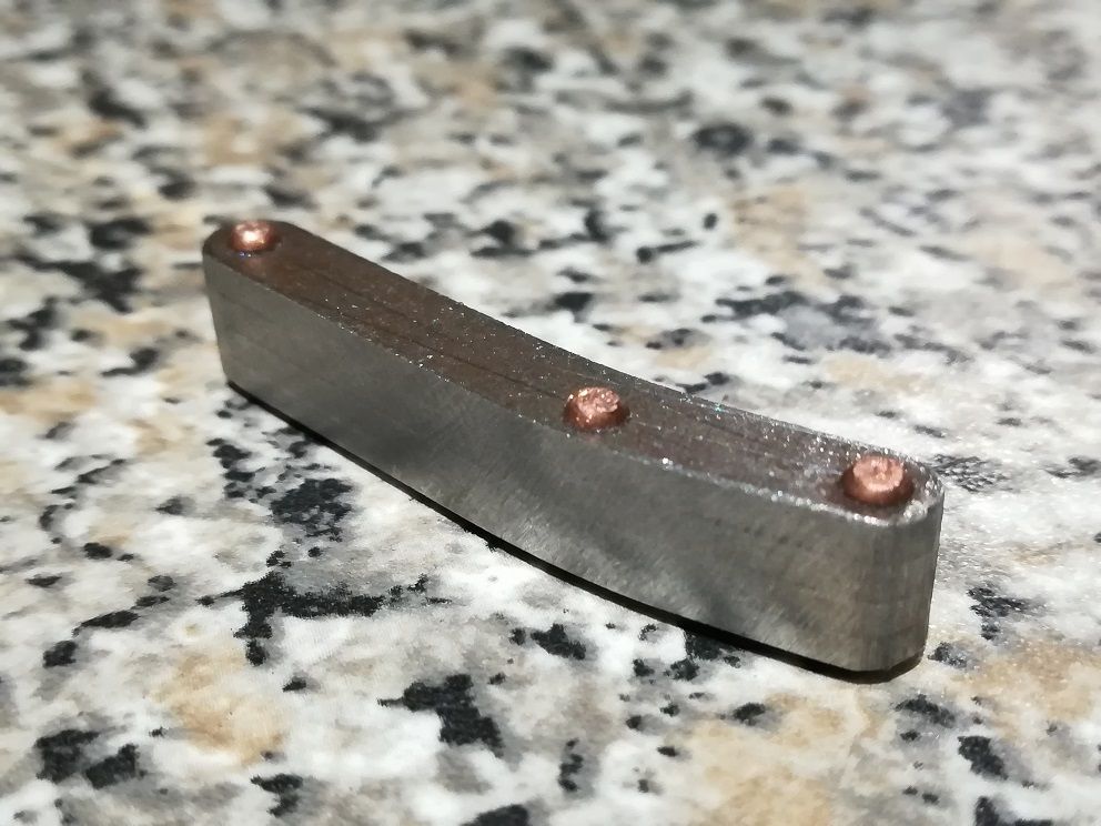

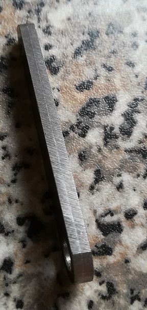

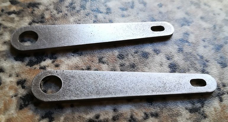

                                      Next up were the brake hangers which were all made at once.
                                      Four slices of 2 mm thick steel plate were cut and using the first marked up piece, drilled accordingly with a 1.6 mm drill.
                                      The pieces were then riveted together with three copper rivets and shaped using files.
                                      Finally the rivets were filed flush and using a pin punch, removed. The edges were filed smooth and the lot oiled lightly.
                                      They are all the same. wink

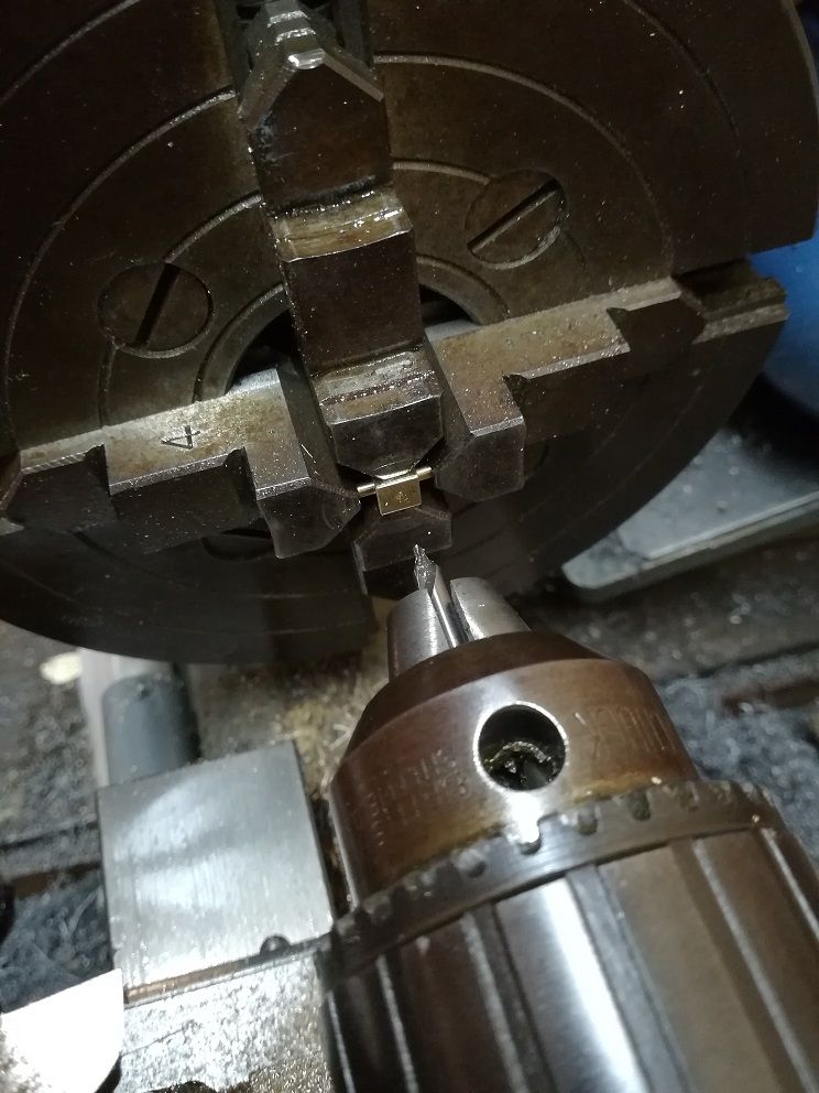

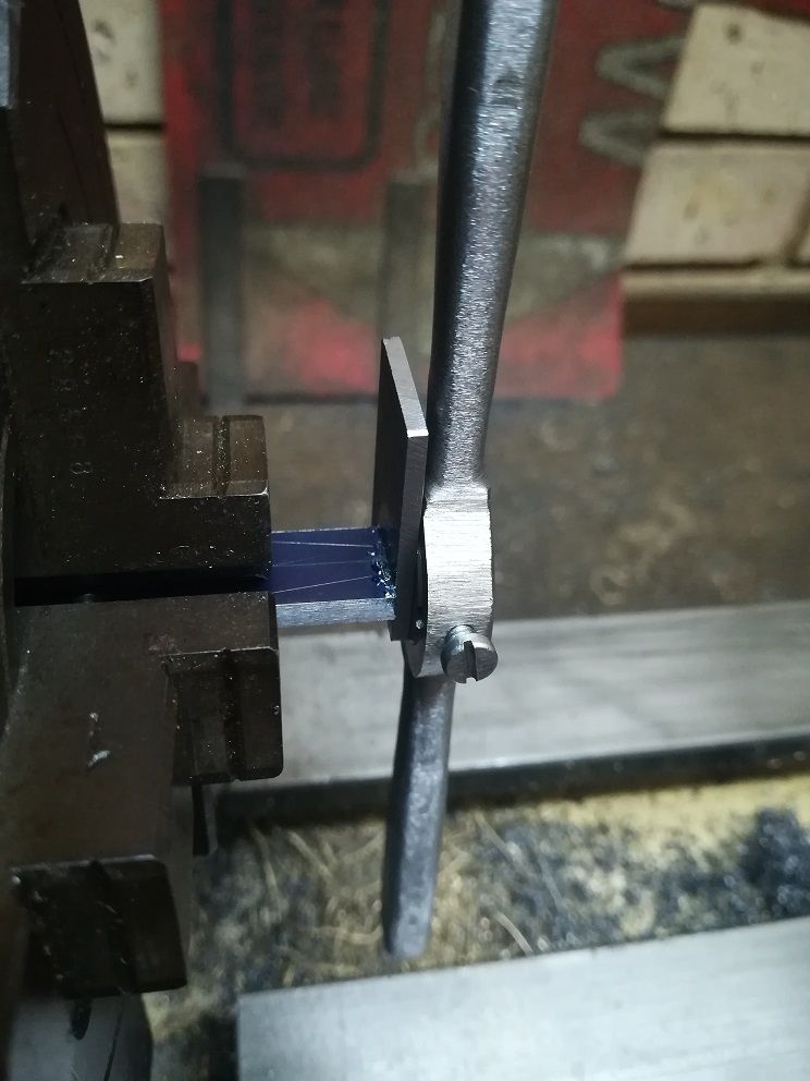

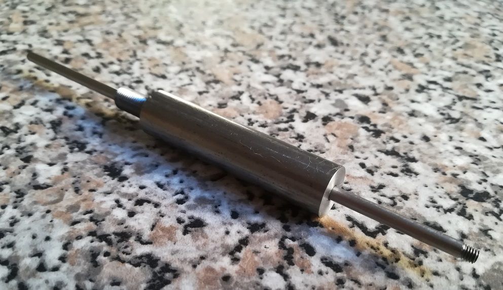

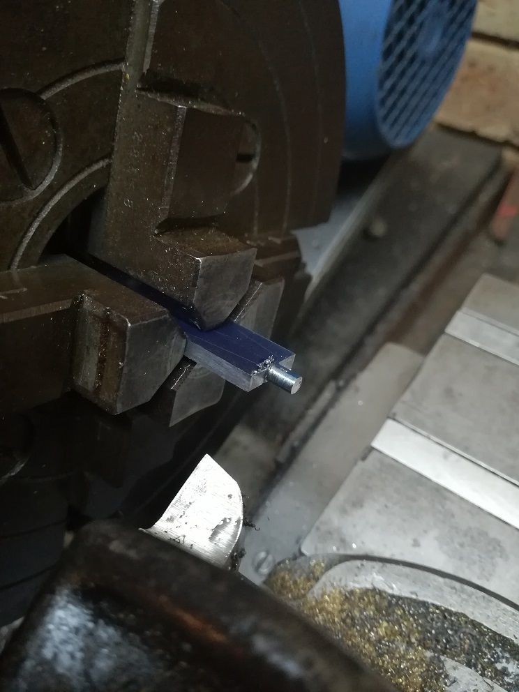

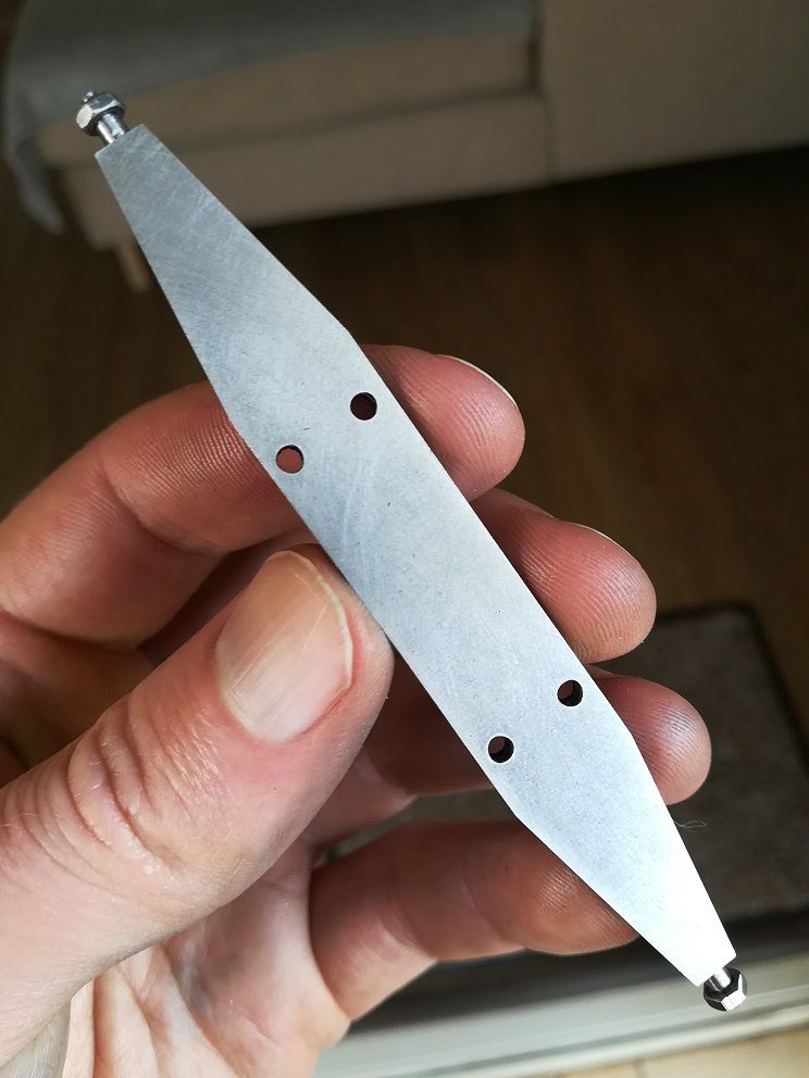

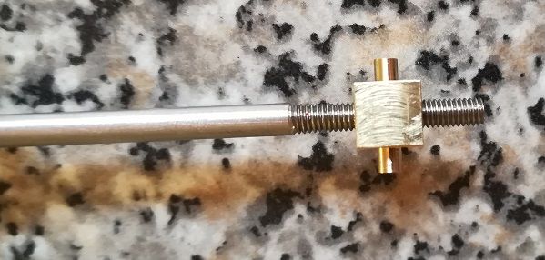

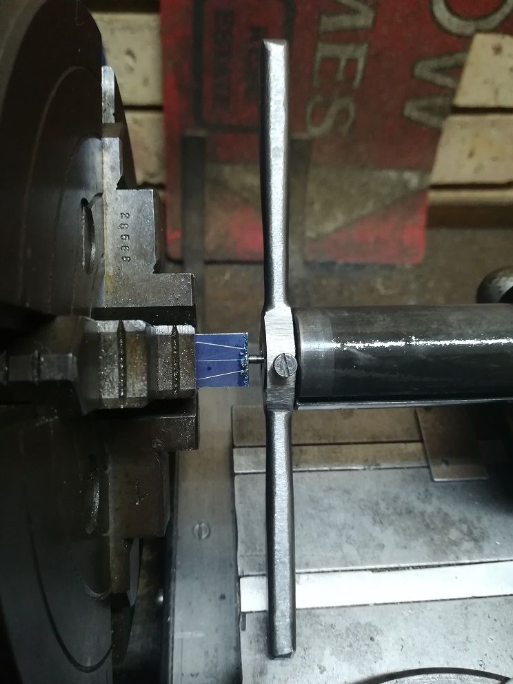

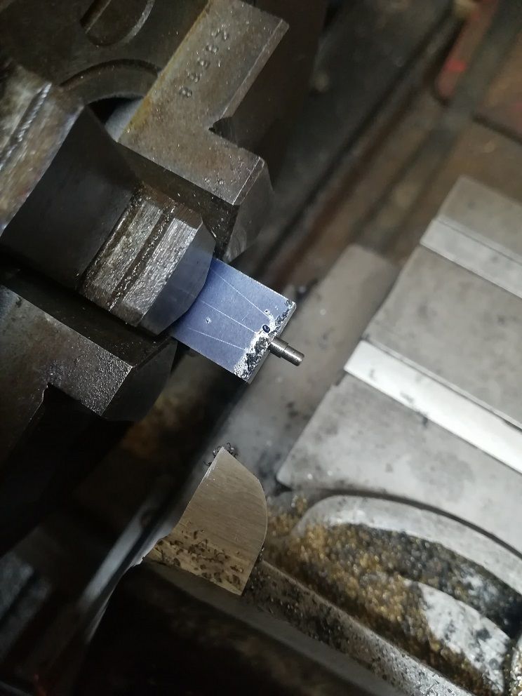

                                        The brake beams were next, starting with the rear brake beam. If you remember a while back I posted some photos of the embryo beams, scribed and partially cut out.
                                        These were placed in the four jaw and the ends turned and threaded M2.
                                        Here I was checking the fit of the larger turned part using a piece of scrap drilled with the same hole as used on the hangers.
                                        The thread was started using the lathe tail stock barrel resting on the die holder.
                                        Finally the thread was finished with the piece of scrap in place to ensure that when a nut is screwed on it does not hinder the movement of the hanger.
                                        Now I just need to file to shape and give it a bit of surface sanding.

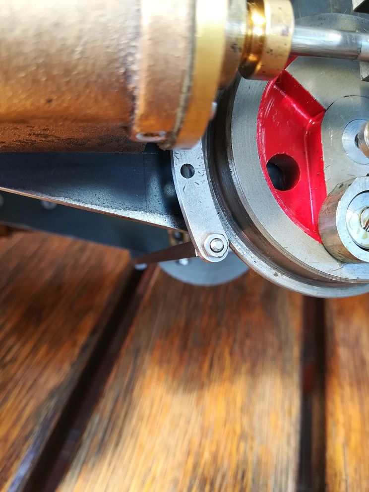

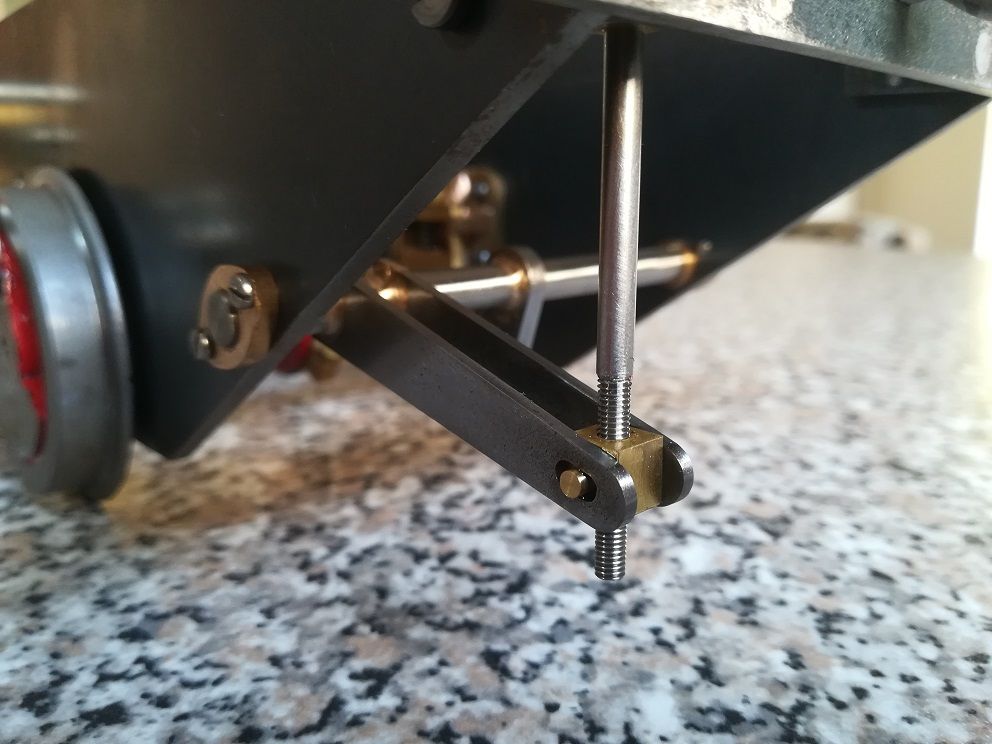

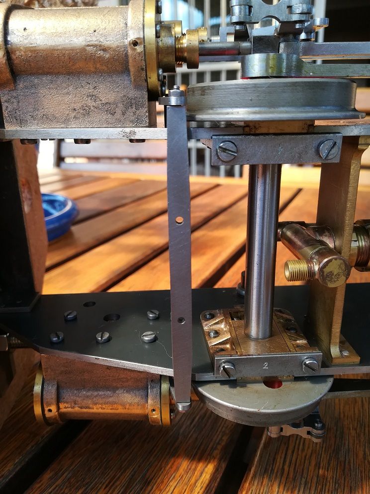

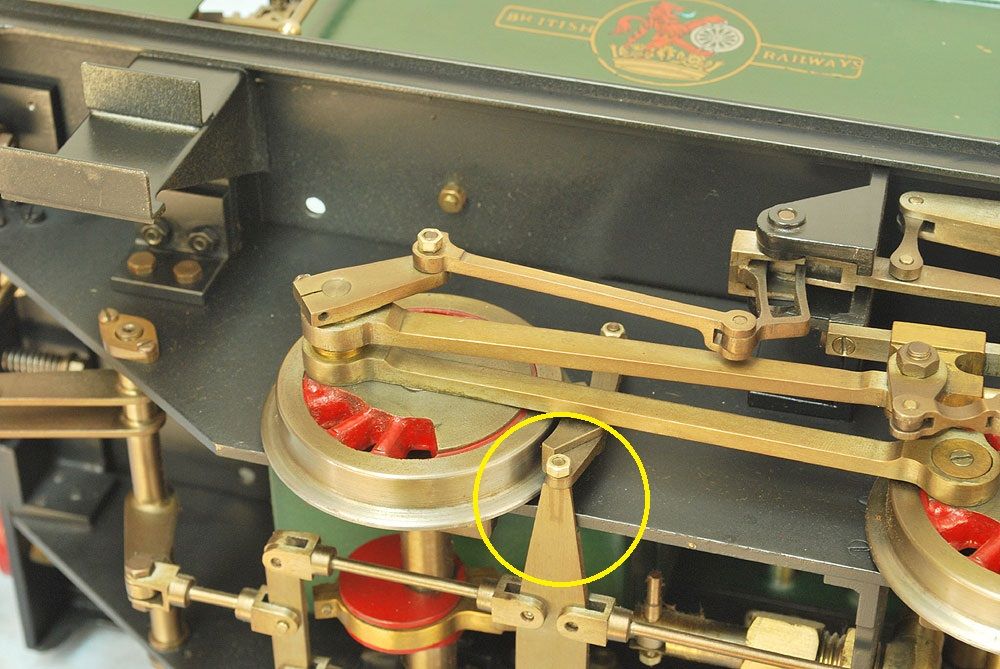

                                        One thing I have noticed is that the space for the front hangers is very tight between the wheels and the cylinder covers. I know this has been mentioned by others on the forum and elsewhere. I am lucky they JUST fit.
                                        A bigger issue I have noticed is that when the rear hangers are in place, the bottom holes are directly in line with the bottom of the frame which means the rear beam cannot fit in between them…? I have double checked the dimensions on both the hangers and the position of the hanger pin hole and they are correct to LBSC's description.
                                        The two possible solutions are to re-make the hangers, slightly longer to clear the frames or to mill recesses in the tops of the beams where they will conflict with the frames ( I have seen this on some Tich models). Has anyone else come across this issue?

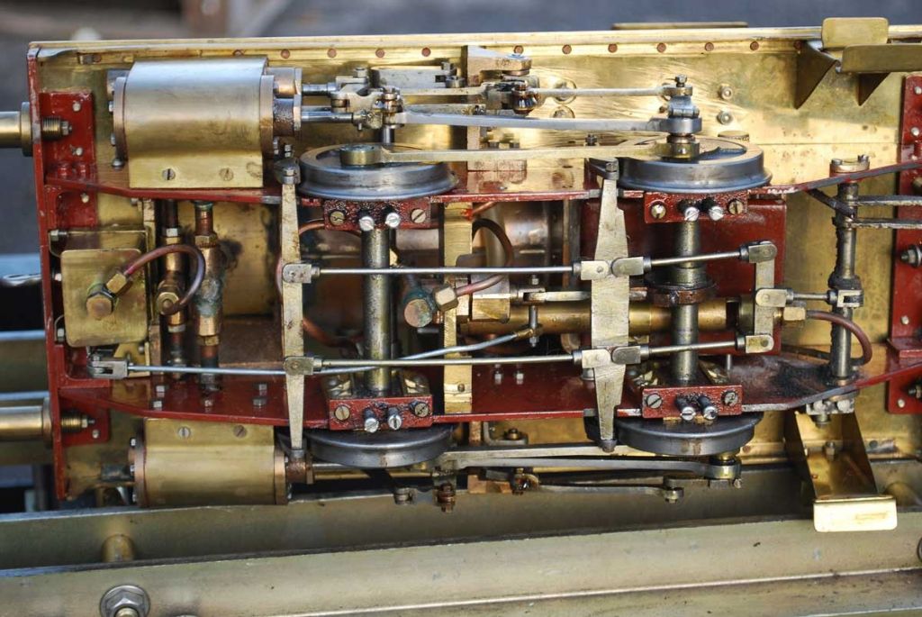

                                          Here is a pic of an existing Tich loco with the rear beams adjusted as per my previous post.

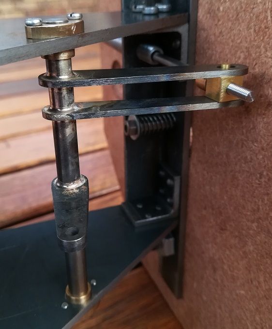

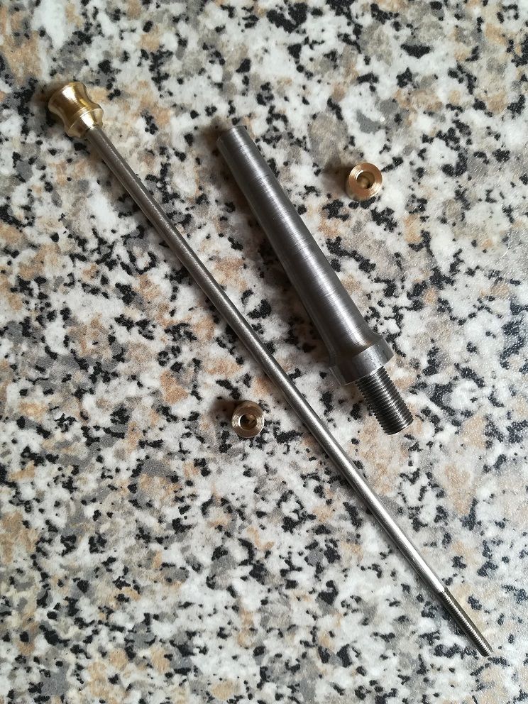

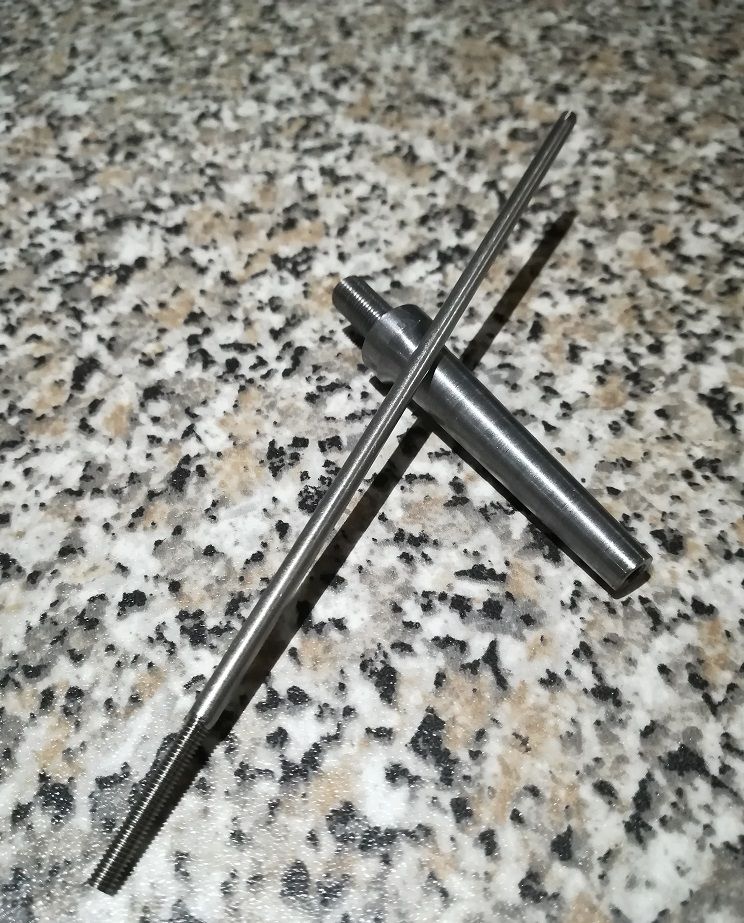

                                              Brake gear aside and onto the valve gear.
                                              The reversing shaft was turned down on both ends to a tight fit for the lifting and reverse arms. The side with the lifting and reverse arm will be brazed and the side with the single lifting arm will be drilled and pinned one the valve timing is sorted.

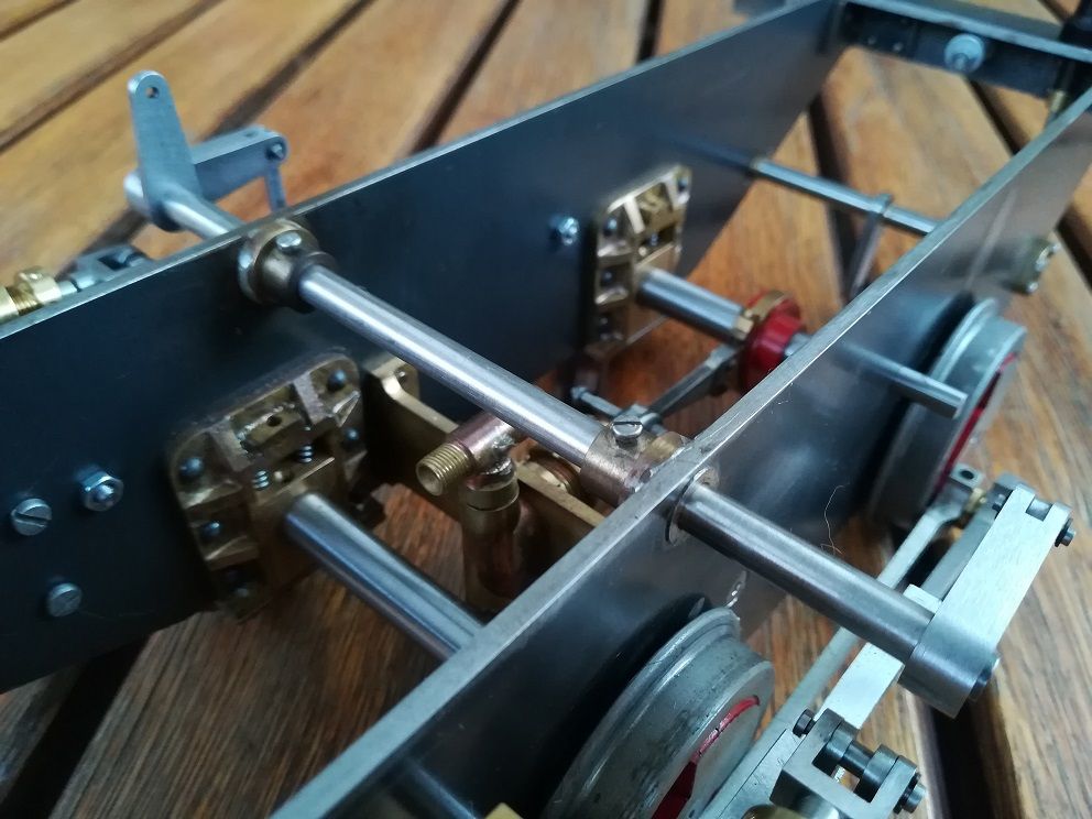

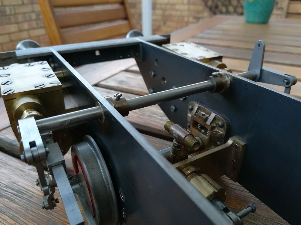

                                                This weekend I managed to get a bit more done.
                                                I took some photos of the front brake beam in situ as well as the brake hangers showing the clearance issues.
                                                As you can see, it is a very tight fit in front of the cylinder cover.
                                                I will need to make the new hangers narrower as well to give some more movement forward and back.

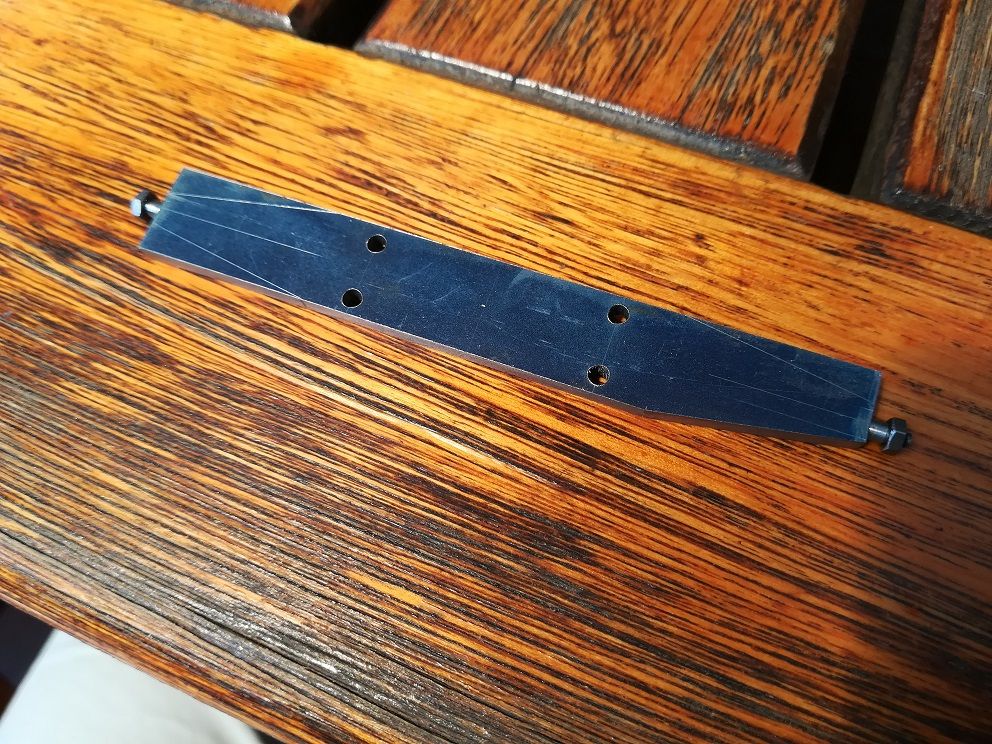

                                                Here is the finished rear brake beam.

                                                  Here is a picture of the rear brake hanger showing the clearance issue with the rear brake beam.
                                                  I am going to make these a bit longer.

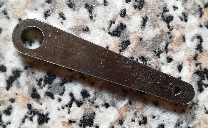

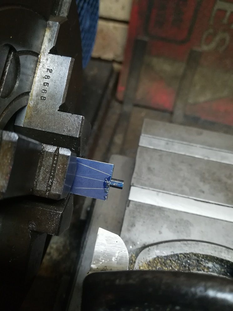

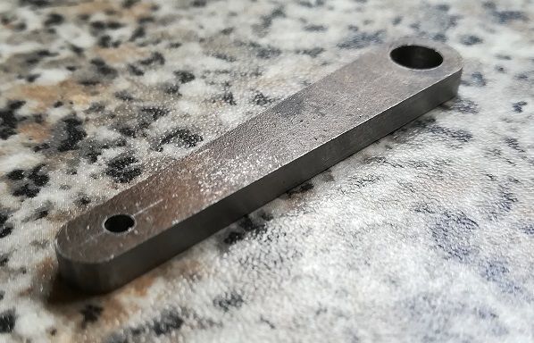

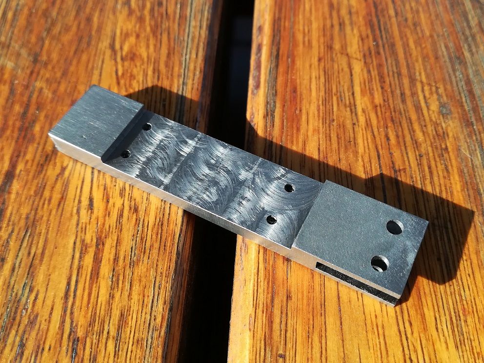

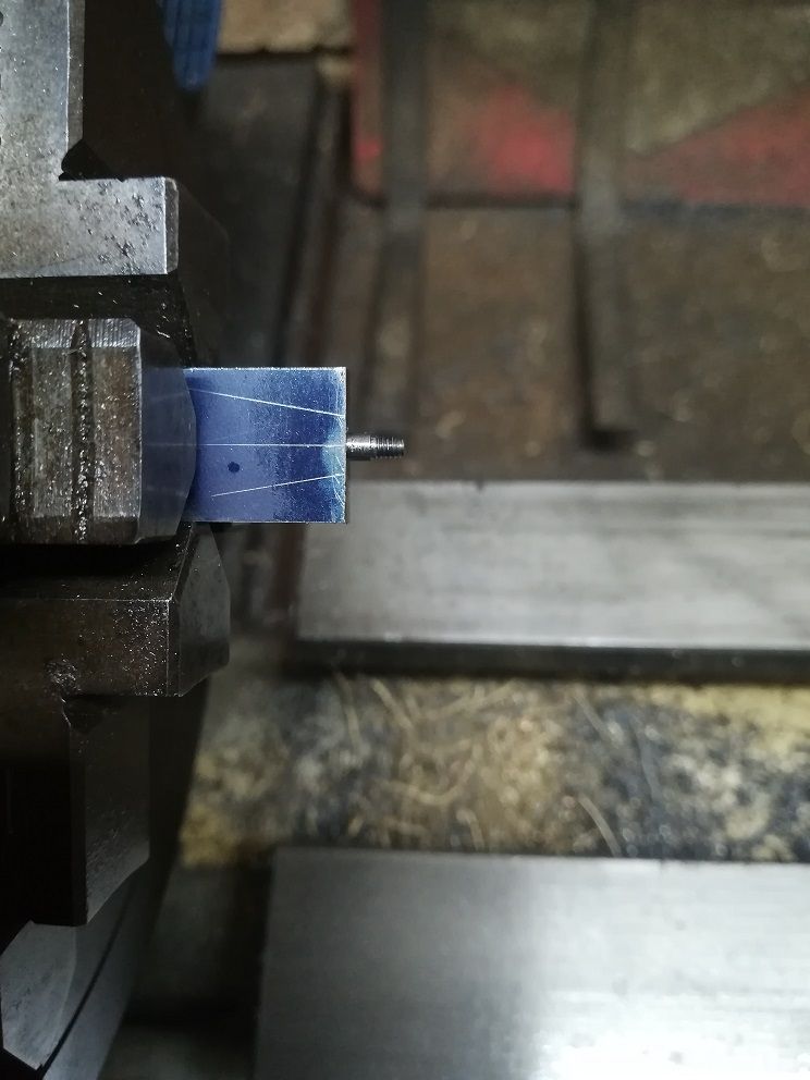

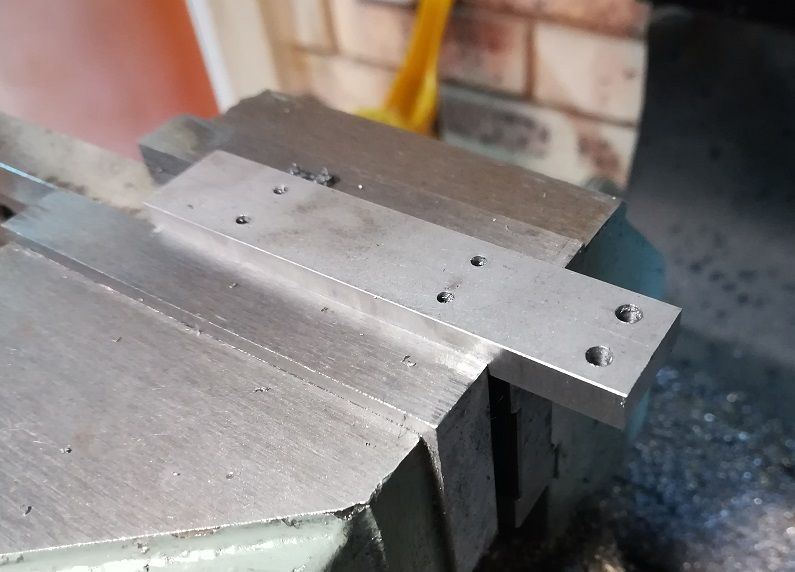

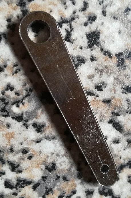

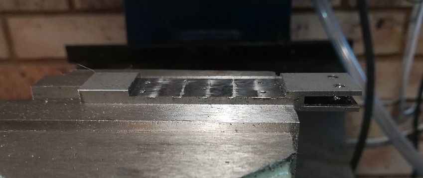

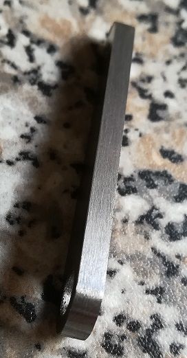

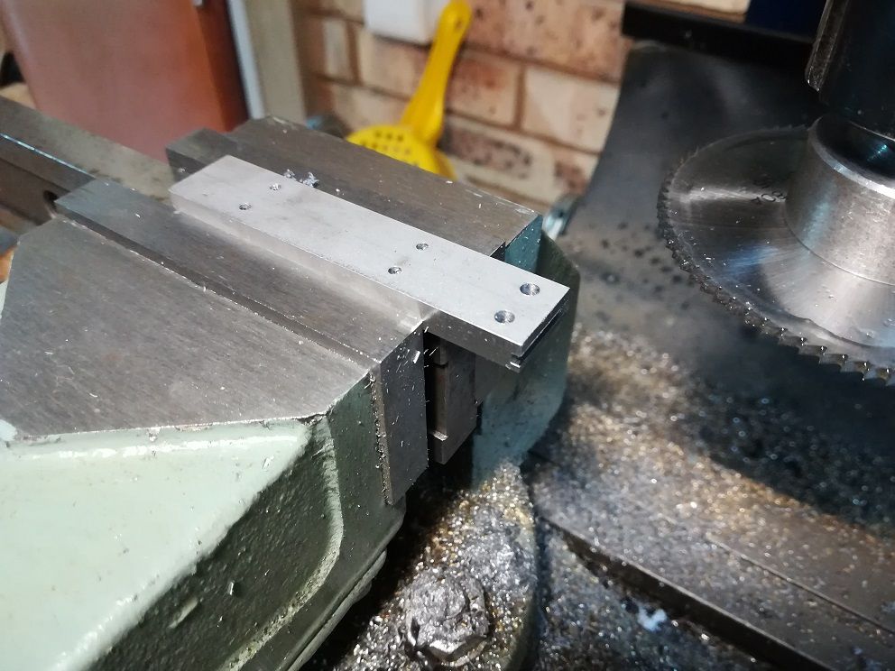

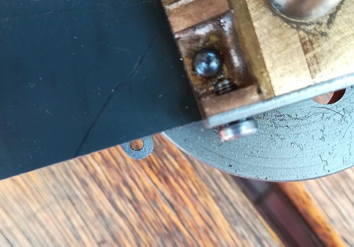

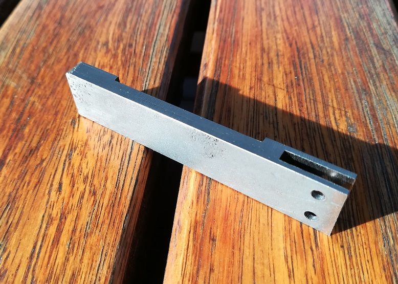

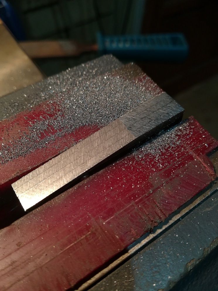

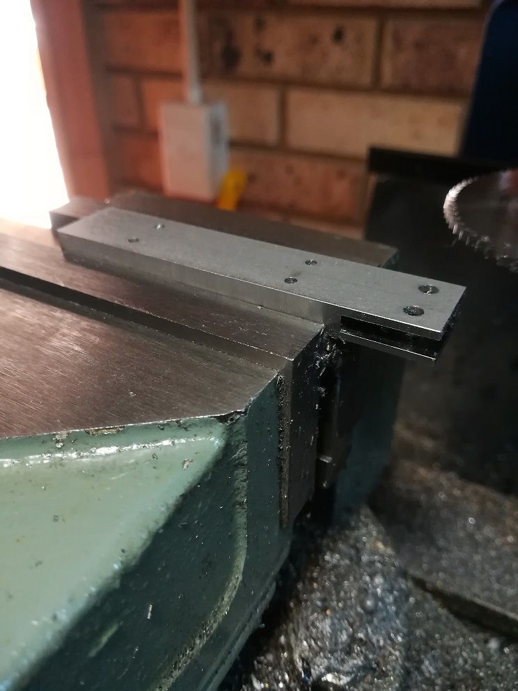

                                                    I made a start on the radius rods as well.

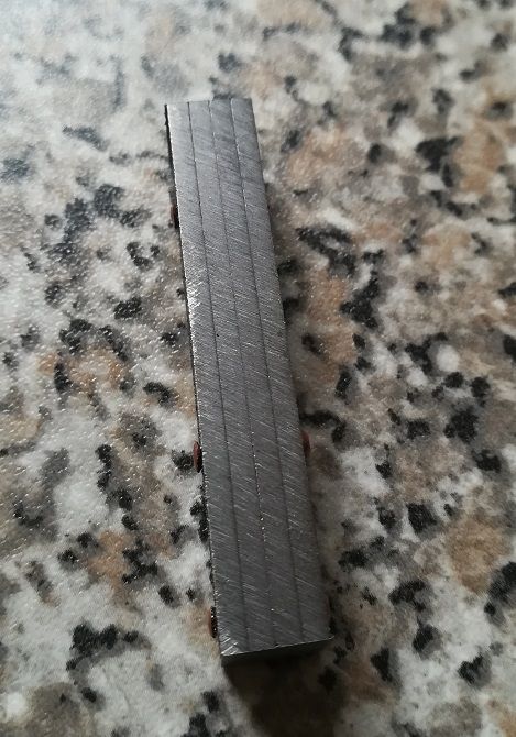

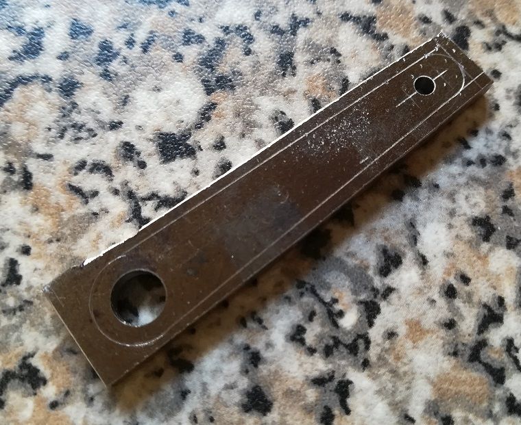

                                                    A piece of 6 mm steel plate was cut and then placed in a pickle to remove the hard mill scale.
                                                    This was then squared up in the mill and finally the holes were drilled and reamed in the block.
                                                    *Note the block was placed in the vice to allow for all successive steps without removing it.
                                                    The 3 mm slot was then cut with a 2 mm slitting saw.

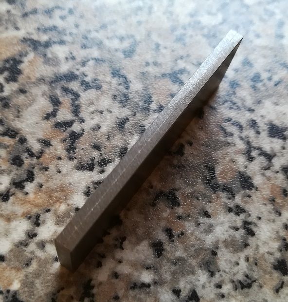

                                                    The one side of the rod was then milled down.
                                                    The embryo radius rods were then removed and all of the edges were slightly chamfered with a needle file.
                                                    The other side will be milled down, the piece split down the middle and the final shape of the radius rod filed.
