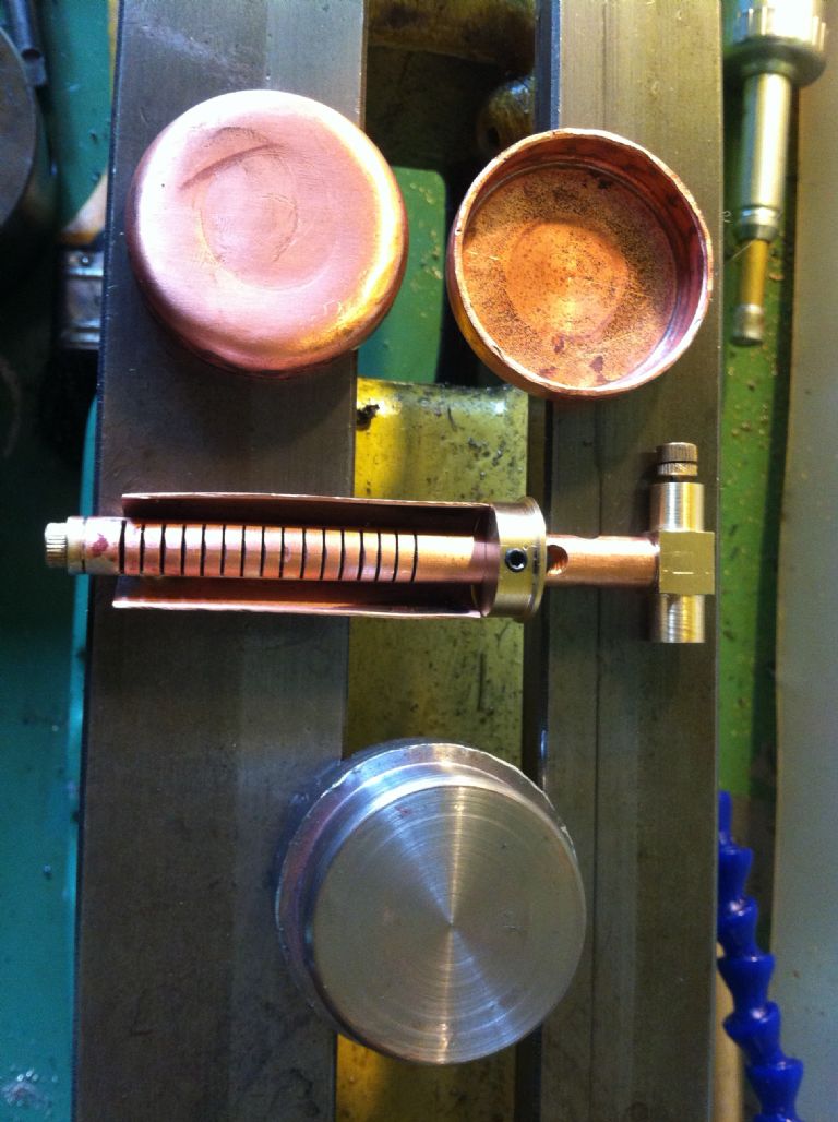

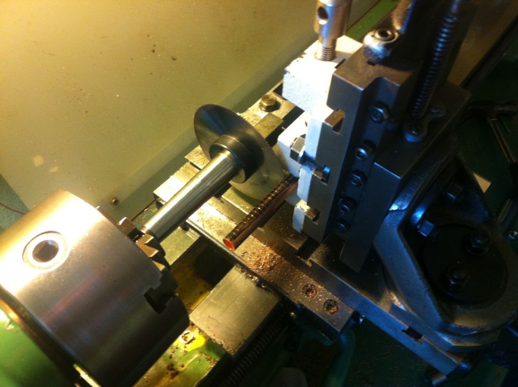

                                Hi All. Got a little more workshop time today.
                                Made the Burner tube.
                                My Myford Lathe made this very easy. (8 TPI Lead Screw)
                                I used a 0.5 mm Slitting saw mounted in the lathe chuck to make the cuts.
                                3/8 Copper Tube in my vertical slide with a small milling vice.
                                Set the Lead screw dial to zero, Engage the lead screw and take up the lash.
                                Line up the first mark, make a 3.5mm cut.
                                1 full turn on the lead screw and make the 2nd cut. Rinse and repeat until you have all 16 slots.
                                Deburred the inside with a suitable size drill.

                                    Making good progress Alex.
                                    Just for future reference its better to remove the chuck and put the tapered saw arbor into the spindles tapered socket. I would say you were lucky this time but on a heavier cut you could come a cropper if just holding on a threaded rod. If its a different tape and won't fit then bringing up the tailstock centre will add support
                                    #185585
                                    Alex Collins
                                      @alexcollins55045
                                      Hi Jason. The taper fits exactly as it should (MT2) in the spindle.
                                      However there is not clearance to make the cuts. The pipe fouls the headstock. A larger (4&quot saw would resolve this.
                                      I'm aware that this setup is less than ideal and agree that for heavier work this would be unsuitable.
                                      I like your Tailstock idea. Noted for future ref.

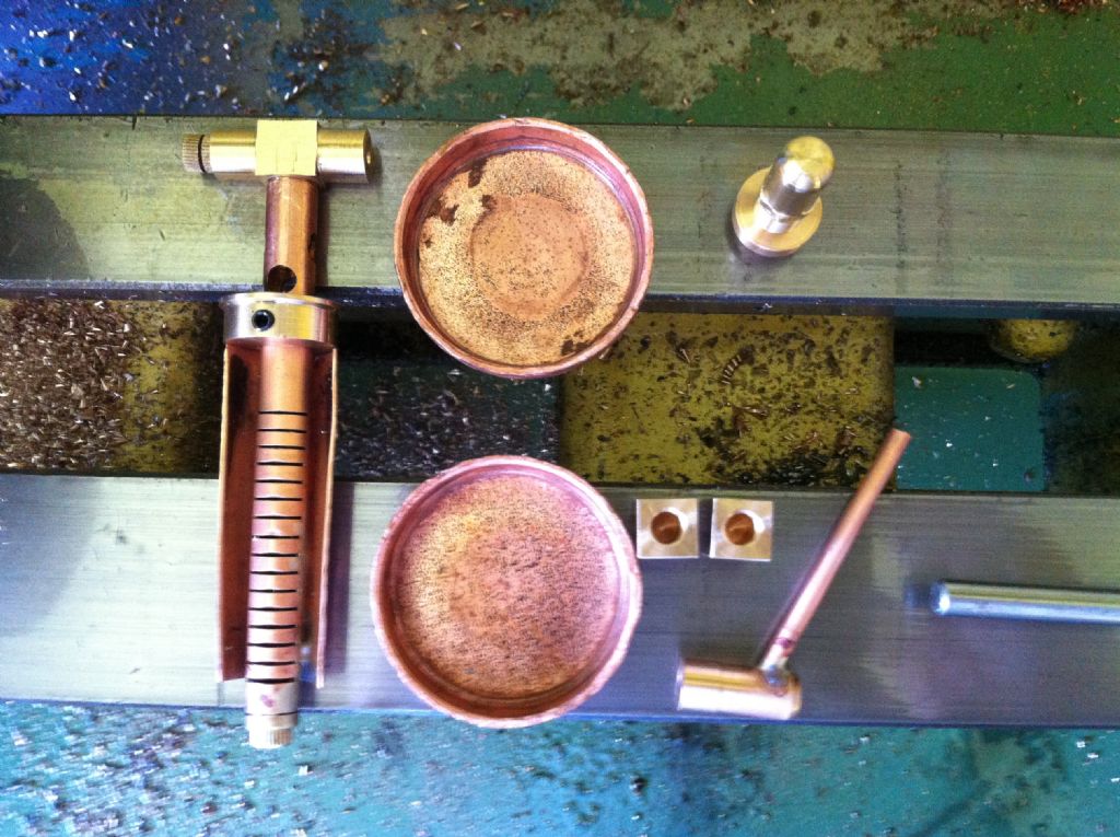

                                        Taps n Dies turned up yesterday .
                                        I made a clamp to stop the (now soft from soldering) copper tube from expanding as I threaded it.
                                        Put the Gas Valve back in the 4 jaw. Drilled and tapped the Gas Jet. Tapped the outside to fit the tube.
                                        At the weekend I made the formers for the End Caps and made the 2nd end cap tonight.
                                        All looking rather good.
