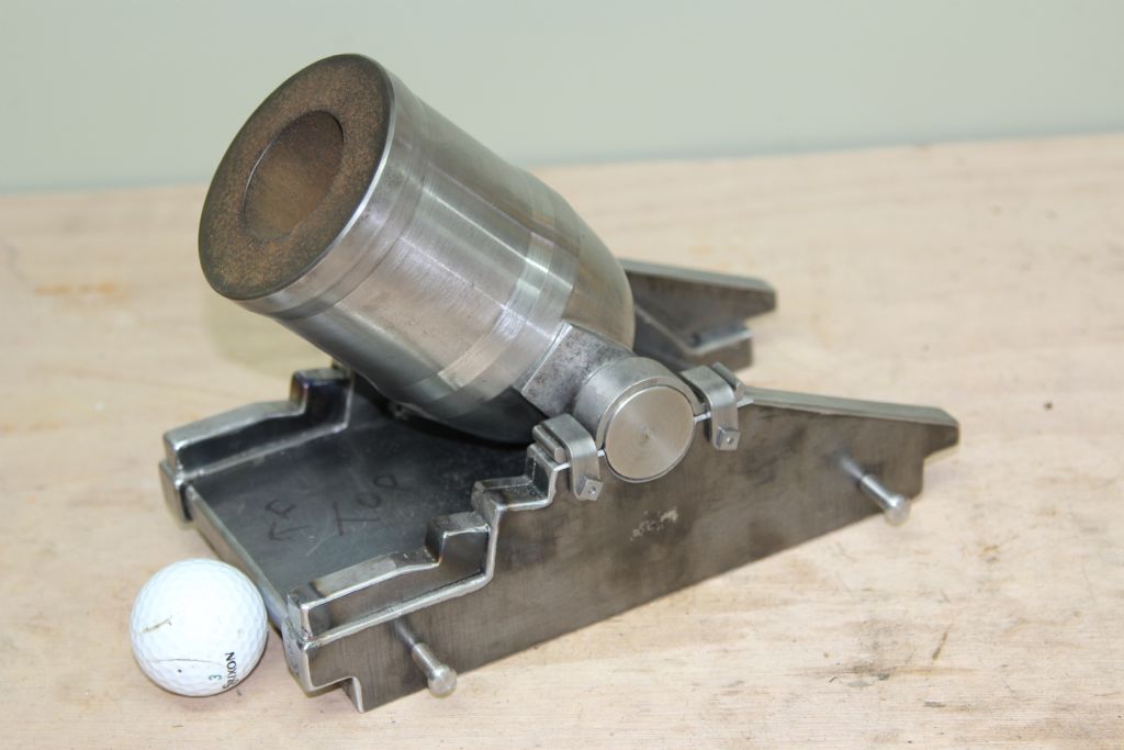

      Having not seen nearly enough artillery models built I thought I would post a picture of my first model. Its a fairly simple scale model of a 10 inch Mortar from the Victorian era. If anyone is interested I can put up a few more pics as it progresses.
      Is anyone else building this kind of thing?

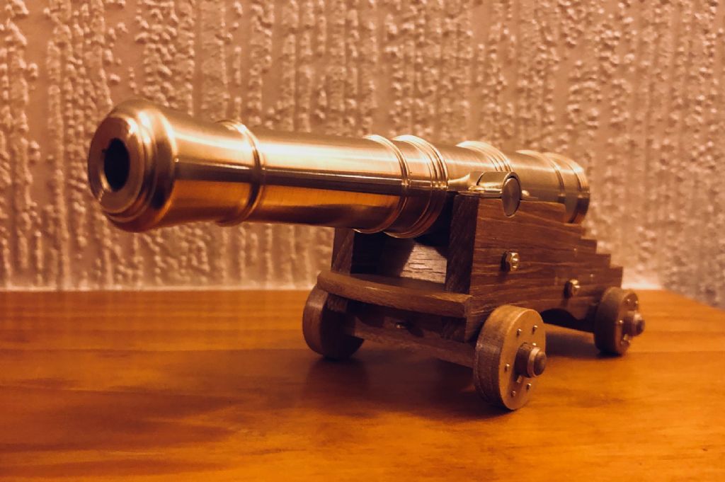

            Well, I made this 1:10 scale C18 24-pounder from plans by he late Jerry Howell of the USA.cimg0024.jpg
            I had a go at anglicising the more obvious American design aspects, Looking at Muller's 'Treatise Of Artillery' from 1791 I noticed a number of differences that I suspect are inaccurate simpifications, but it still looks OK on the windowsill.
            I would like to make something more modern, but haven't yet found any suitable drawings.

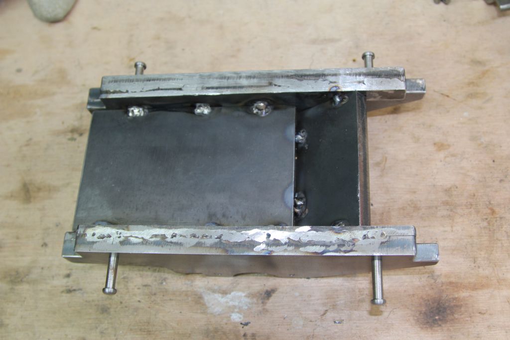

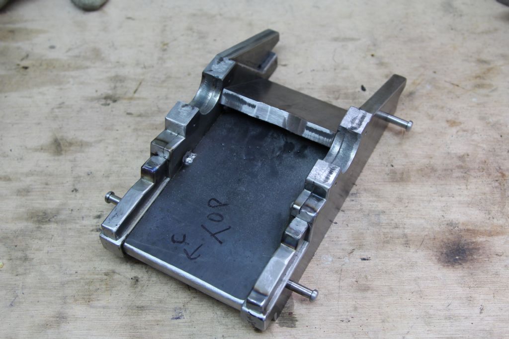

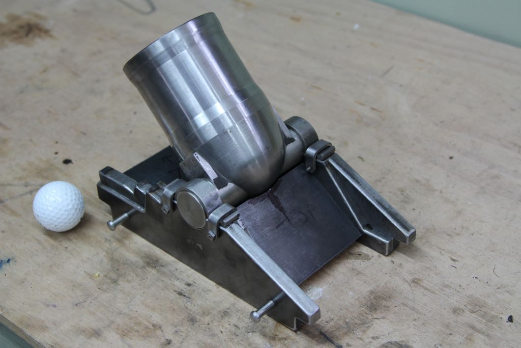

                  Richard,
                  That's a very nice model. I'd be very interested in more photos showing how the bed goes together and how you made/fitted the fillets next to the trunnions, these look very neat in the photos.
                  I am part way through a build of a 1;16 scale model of a 13 inch Victorian era land service mortar which will utilise a slightly later design of bed than yours. It's in brass as it's just a mantelpiece project (non-firing):-

                  Buffer
                    @buffer

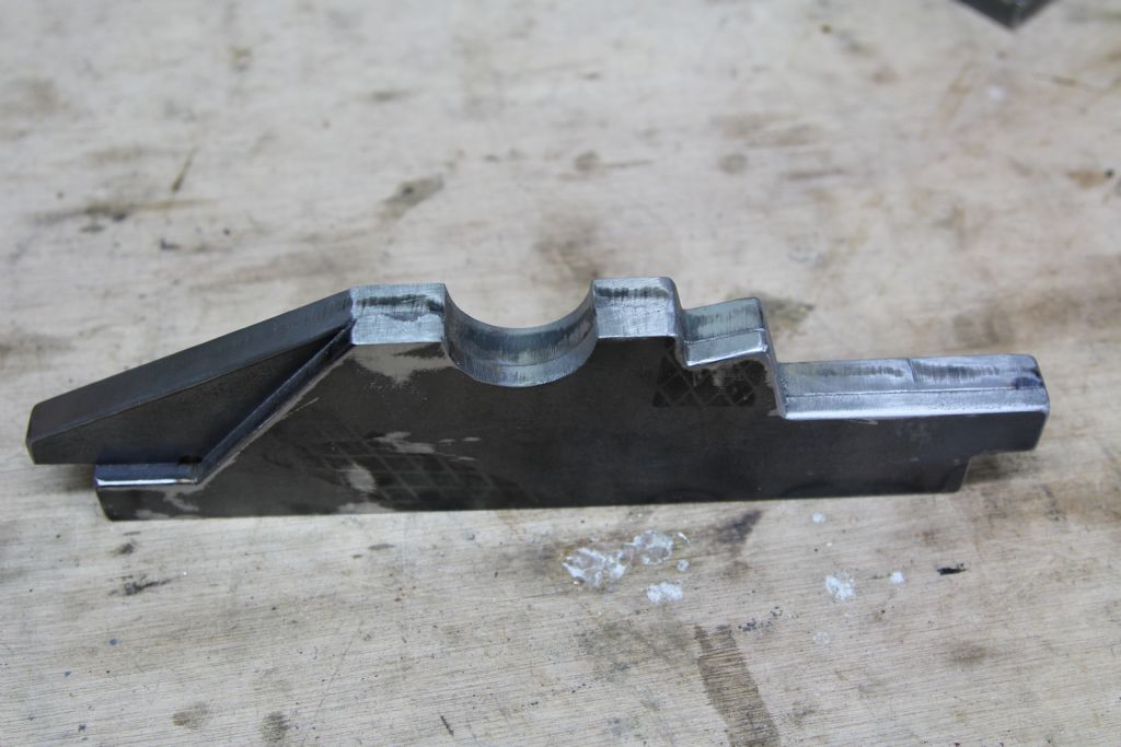

                    Clive
                    Many thanks, I like your models a lot too.
                    The bed was drawn on autocad and is made of 8 pieces of steel. I then sent the files to Malcolm at ME Laser who cut them for me. I then tig welded it all together. It was the only way I could think of other than screwing them together which seemed a lot more work. As I was painting this model black I was not too concerned about using welds.
                    The fillets were a real pain in the bum. As you know they have curves in awkward directions and seemed to me to be impossible to machine so I filed them. I first bored the hole for the trunnion into the fillet. I then pushed blutac onto the barrel and made a blutac filet. After carefully taking this off it gave me the shape I needed to file. It was very tricky but I did get a half decent fit in the end. They were then attached with an epoxy metal from b and q and a small amount was needed to fill some small gaps. I doubt this would be any good for you though as you are probably not intending to paint your brass model but I am going to paint mine.
                    If you do find a way let me know, I can only think of casting a complete barrel but thats not much help.

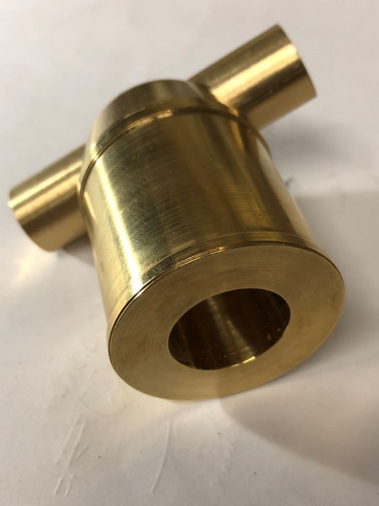

                      Some of you may find this of interest.

                        Hi Rich,
                        Thanks for the additional photos. I'd like to see a photo or two when it's finished and painted. I intend to screw the parts of the bed together on mine. I am sure there must be a way to machine the fillets for the trunnions – I just haven't figured out how just yet!

                        Buffer
                          @buffer
                          Vic
                          How will he clean up the bit of barrel between the trunnions and get it as nice as the turned bits at either end?

                          #346198
                          Vic
                            @vic
                            Posted by Richard brown 1 on 14/03/2018 10:33:42:
                            Vic
                            Rch
                            Very good question, to which I don’t know the answer. I’ve contemplated building a civil war canon before and always wanted to construct the trunnions properly but this is one of the aspects that put me off the project!

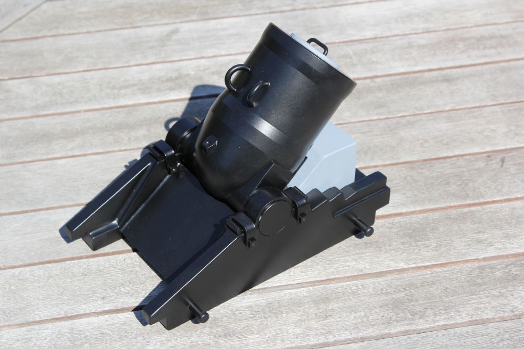

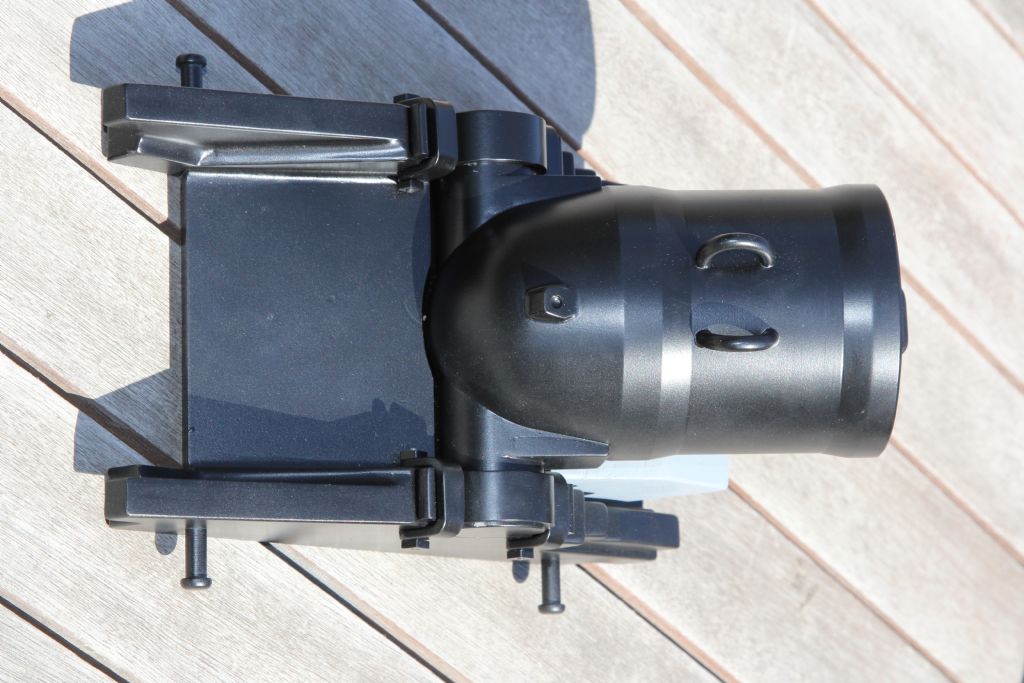

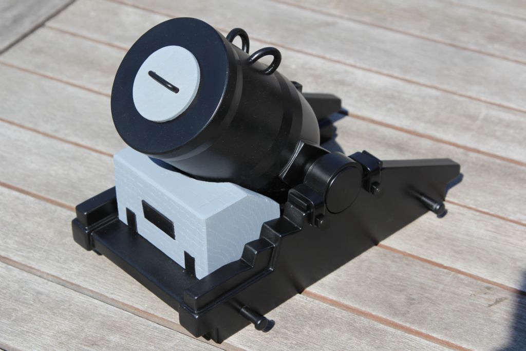

                              An update on the mortar, its now finished so I have uploaded a few photos. I hope you like it!
                              Next will hopefully be a Victorian Rifled Muzzle Loader on a pivoting carriage.
                              #350739
                              Mick B1
                                @mickb1
                                Very nice piece of work, and well photographed. Congratulations.
                                #350769
                                  Thanks for sharing, it's a fine model.
                                  #350774
                                  Jeff Dayman
                                    @jeffdayman43397
                                    Well done Richard! it looks great.

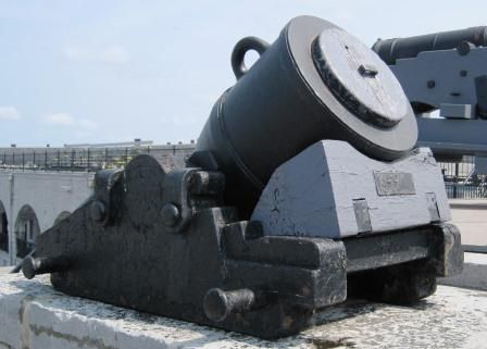

                                      Excellent job Richard. Where was the picture of the original taken? Looking forward to some pics of your RML.

                                              Posted by Clive B on 22/04/2018 08:49:52:
                                              Clive
                                              Clive
                                              I got the picture from a google search I think it is Fort Henry in Ontario. I have actually only seen these mortars twice. One was in the army museum in Lisbon and one in Guernsey. The drawings I made were from scaling various photos from google. There are so many different variations of the same piece that its difficult to make an exact scale model unless you visit one with a tape measure. That's why the grey block looks different as I would have copied that from a different picture.
