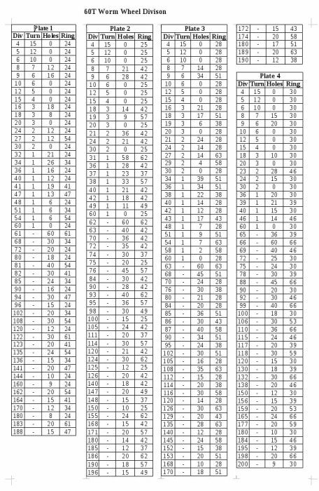

    I used the application I linked to and produced this via a word processor. I copy pasted the apps output into it and used find replace to change it to a coma separated list and then used a wp utility to put these into tables.
    I've checked several out manually and all have been ok so then did another page from 200 divisions that went up to the max divisions the plates can give – a bit short of 4,000.
    Later when I have time I'll do a spread sheet as a check but using fractional arithmetic or maybe some variant of pure integers that does the same thing and can't have rounding errors and use this to check the application.
