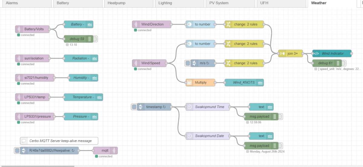

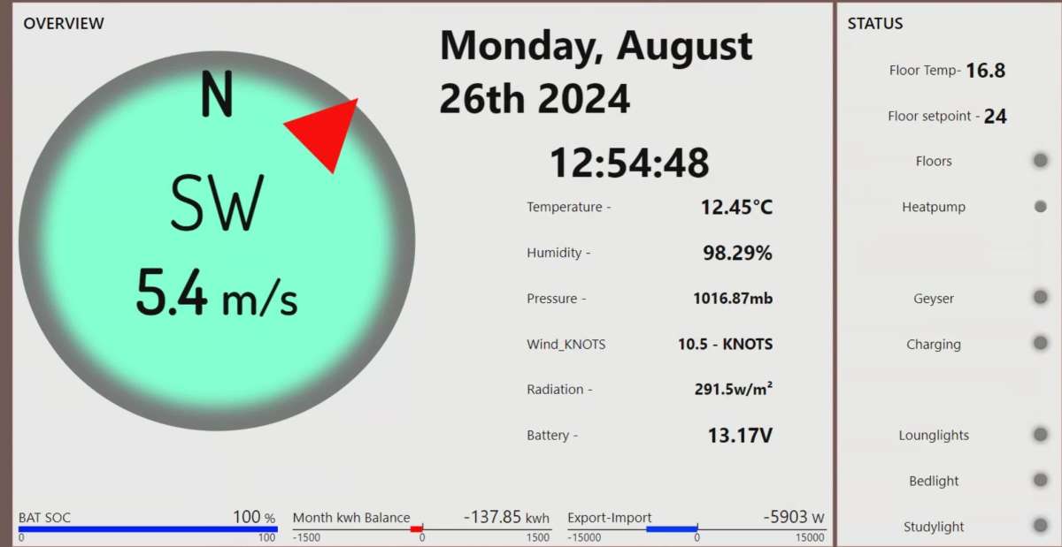

A very quick way of doing this is to use Node-Red – a free install on PC and Linux, which is a graphical programming tool. There are thousands of user written ‘nodes’ which you can download and use to create the flow diagram for your application. You then place display nodes ( gauges, graphs, bar charts, etc) on a display page, and the data is displayed as you want. You don’t need to know C, Python, Cobra, or any language if you don’t want to, although Java script can be useful but I don’t need it..My house automation, solar system, weather station, underfloor heating and Alarm is all controlled via node red. I use ESP32’s all over – they link via wifi, using Mosqitto as an MQTT server, running on the same pc as the node red. Coms tween esp32 and node red is very easy and there are dozens of open source nodes out there to do anything you could want. Very powerful and very simple.
This is a sample image of the display page of the weather station – also shows the status of the lights in the house – they are automated to turn on/off randomly at night when away, etc
This shows the node red nodes that implements the display page above
Of course you have to write the code for the esp32 itself, and I do that all in the Arduino IDE using the esp32 extensions – easy as pie ( NOT PI)

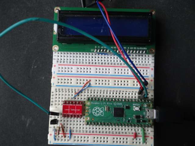

Haven’t been able to get Pico to read a DS18B20 yet!
Just to add, I found this yesterday:
I have just followed the procedure there to install the Pico 2040 to the Arduino IDE and it was trivial. Not tried programming yet but looks promising. Being pretty familiar now with the Arduino this looks a good way forward.
Success.
In the Arduino IDE I set the connection to ‘Raspberry Pi Pico’, and then installed the library ‘NonBlockingDallas’. (Others available: I tried this one because it’s non-blocking, that is the program asks the sensor to take a reading and doesn’t wait for the reply. When the reply arrives it interrupts the program, which reads it, and then carries on with whatever it was doing when the reply arrived.
I loaded the program TemperatureReading.ino from File->Examples->NonBlockingDallas. (Most Arduino libraries come with example programs showing usage.) It prints output to the serial port.
Didn’t work:
I’d also forgotten the Pico has to be forced into program download mode by unplugging the USB cable, holding down the button labelled BOOTSEL on the Pico, reinserting the USB, and releasing the button.
In the photo, the DS18B20 is bottom left, connected to GP02 with the long green jumper wire.
The red unit is a 3.3 to 5V level converter, needed if I add the LCD display to the set-up. The LCD is a 5V only peripheral. The DS18B20 runs at either 3.3 or 5V. The red and blue wires trailing across the LCD go to my oscilloscope so I can watch what GP02 is doing. Nothing seen unless a 4K7 pull-up is connected!

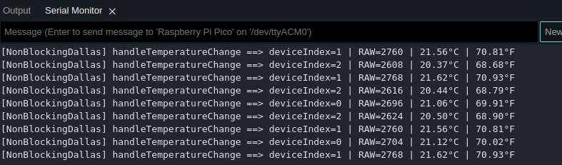

Further to my DS18B20 experiment, I connected three sensors in parallel to see if the library detects that automatically. It does. DS18B20 sensors have a unique address, that the library presumably detects by scanning the bus when the program starts. The example program prints results like this:
The program identifies particular sensors by ‘deviceIndex’.
Oh, and Mark’s warning about fakes might explain why my device 2 consistently reads a degree low! Hmmm…
