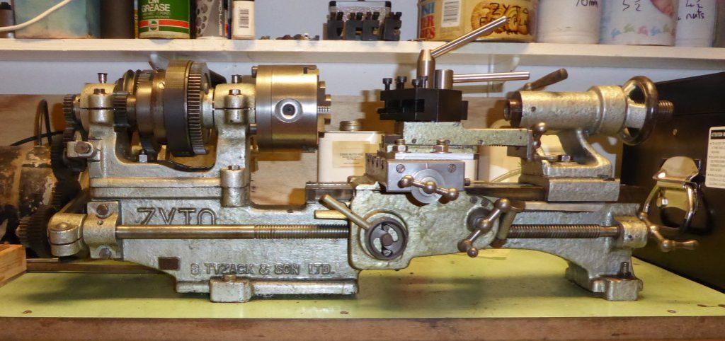

      I saw a very unloved barn find Tyzack Zyto lathe today, i can't tell you which model exactly, but it has the cast ally gearing guard.
      are these good machines, are they the same quality as a Drummond which i plan on getting hold of, what would i look for to get an idea if it's worth restoring ?

          From reading old MEs the Zyto were mid-range machines for those who wanted a reasonable size lathe, but didn't have the deep pockets. A sort of 1940s mini-lathe.

            I had a Zyto. many years ago. It was fairly basic but it did what I expected of it until I could buy something better. It didn't have any graduations on the feed dials, but I made some cardboard ones "until I could make some posher ones" – but I sold it before I could get round to it. The flat leather belting was a bit of a nuisance, lacking in power transmission.
            A great many excellent pieces of work have been turned out on similar equipment in days of yore, but I would say it would be hard work churning out anything that needed rapid metal removal or accuracy. There just isn't the metal around the headstock in them for rigidity – and check for cracks in the headstock casting!

                Hi Guys . I have a ZYTO LATHE .

                    I have had the Zyto for some 35 years. I have a larger Warco lathe that is my usual workhorse, but the Zyto is still used for some smaller stuff, particularly when I am disinclined to change the chuck or other setup on the Warco. The Zyto + 3 jaw chuck certainly used to give better runout (centering accuracy) than the Warco, but it seems a bit more 'loose' now. I probably should readjust the bearings, but I am nervous about tightening them up too much – not sure about the degree of danger of cracking the cast iron if overtightened

                      The usual recommendation for setting the headstock bearings correctly is rather long winded but it does save the castings.
                      Adjust as normal to get a satisfactory running clearance on the spindle and measure the gap at the bolting point with feeler gauges. Make an spacer, aluminium is a good choice, slightly thicker than your gauged value, drill it for clearance on the bolt and lap it down, fine sand paper will do nicely, to close to gauge thickness. Fit it and test the spindle clearance when pulled down tight.
                      Repeat the lapping until that is correct and then do it all again for the second bearing.
