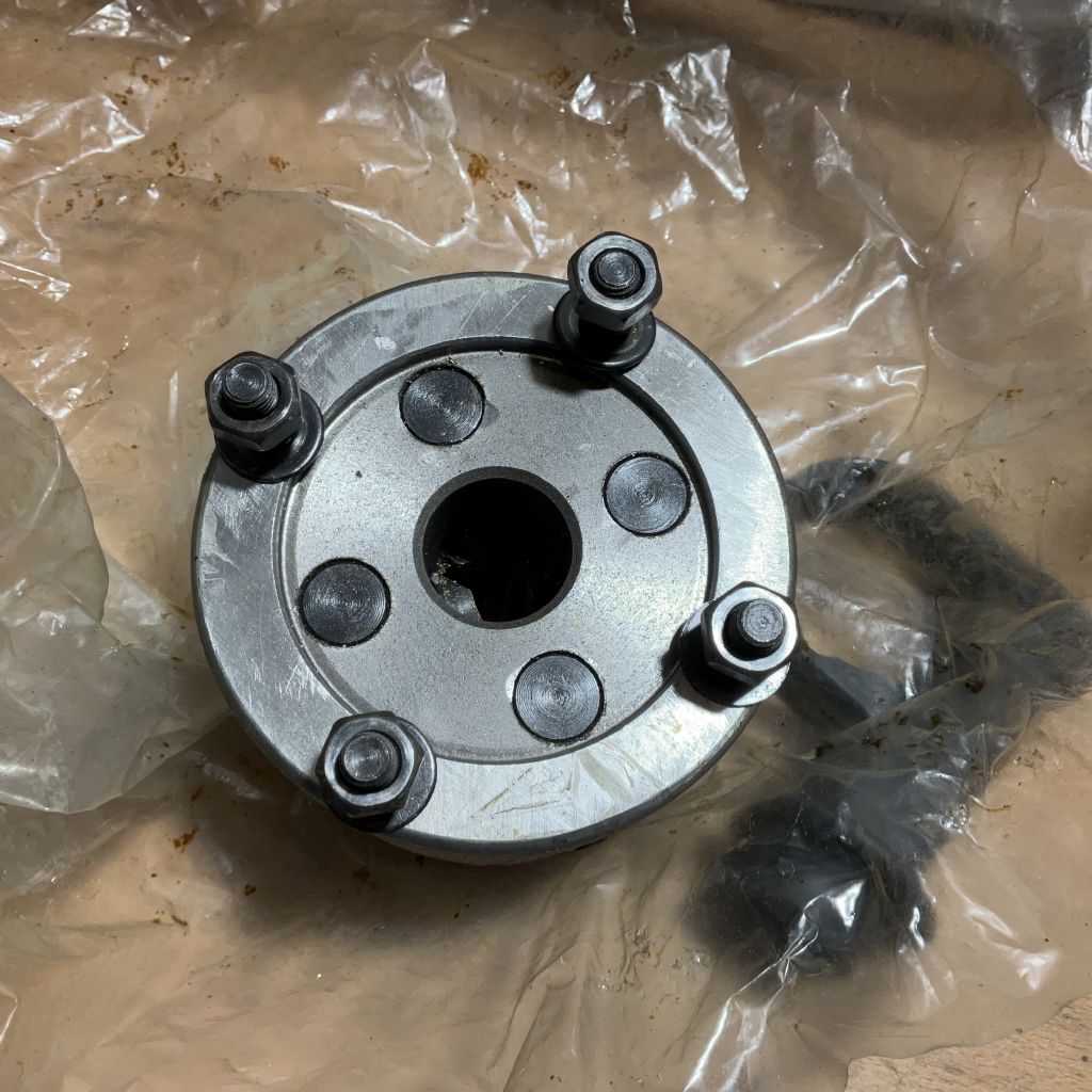

      Hi all,
      I've just bought an as-new WM180.
      It came with all the standard bits, including a 100mm 3-jaw and "Sanou" 4-jaw.
      The 3-jaw bolts directly to the spindle nose but the 4-jaw has a back plate to convert from 4 M8 holes in the rear of the chuck to the standard 3 M8 studs.
      I unbolted the back plate from the 4-jaw and the recess on the rear of the chuck is an exact fit over the register on the nose.
      Assuming I can drill and tap 3 holes in the chuck, is there any reason why I shouldn't eliminate the back plate and bolt the 4-jaw on directly?
      On the rear face of the chuck, the pegs are visible (which retain each jaw screw). I held the chuck in soft-jaws in a vice, gripped a piece of stock in it and heaved the jaws v tight. There was no discernible movement of the pegs. I had worried that, without the backplate, the chuck might try to eject the pegs rearward when tightened hard but seems not.
      Is anyone running such a chuck with no backplate?
      The plate is approx 18mm thick and saving that space on such a short lathe would be great.
      Thanks
      Gareth

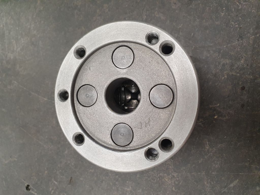

          On my WM180 the spindle flange is drilled with 6 holes, so it will take my 3 jaw (three holes) and my 4 jaw (four holes) directly, so no backplate is involved. My collet chuck is the same. However, the irregular spacing of the six holes is probably the reason for the vibration at high speeds.

                This is my four-jaw:

                  I think the objection is what happens if you make a mess of drilling the holes and/or find in the future that another new chuck has a different bolt spacing. And each hole drilled in the spindle flange reduces it's strength, and messes with the balance slightly.
                  Backplates are less painful to replace than a botched spindle.
                  What's the advantage of doing away with the backplate? The extra 12mm of space is rarely needed in my experience but maybe that's just me.
                  By all means do it if there's a good reason, otherwise seems a risky job for little benefit.

                        Dave – I would never attempt to modify the spindle nose for the reasons you stated. I was only contemplating drilling the chuck body.
                        David – fantastic! Great pic. It looks the same as mine so if you run that mounted direct on the spindle, I can too. Or at least I hope so, because I've just done it – I'm on a nightshift and workload is light fro once, so I had time to set it up on the mill. Clocked the existing 4-hole pattern square and then used DRO's pitch circle function to add a 3-hole pattern. The PCD on the spindle nose is 83.9mm – 84 seems more likely but that's what it measured so that's what I drilled.
                        Another upside is that I've now got a spare backplate, with fixings and register to suit my spindle. Might be useful for oddball one-off fixture plates or whatever.
                        Thanks everyone and especially David for the info I needed to make my first mod' (as attached)
                        Gareth

                          Hi Gareth, too late now, but I don't know why you drilled three new holes, as you could have used one of the original four holes, and just drilled two new ones, that way the two new holes wouldn't be so close to the other original holes.

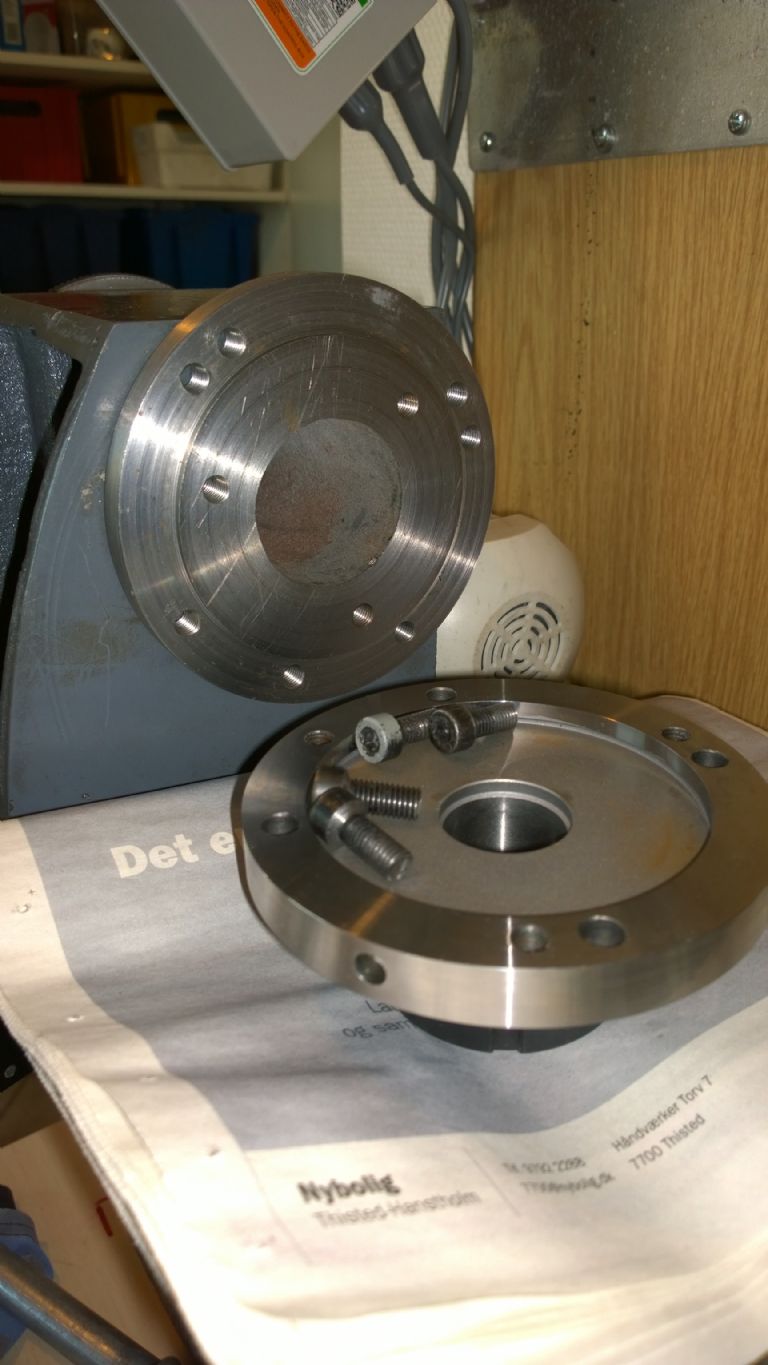

                            A lathe made og 180 and 210 parts and a homemade 48mm hole spindle is shown here
                            Chineese upper class
                            and the chuck mounting shown here
                            Front mounting

                              That's a mighty spindle on a little lathe. Very impressive. I'd been thinking about front mounting the chucks but I haven't examined them to see if it's possible (pretty sure it is). Might look at a ring/plate to run behind the spindle flange, with the three M8 threaded holes to accept long cap heads from the front of the chuck. That's for another day though as I haven't even run the lathe in anger.
                              Re drilling/tapping 2 extra holes versus 3 – I knew that was an option but the existing 4 holes in the chuck weren't on the exact same PCD as the 3 on the spindle. They were very close (and there's plenty of clearance in the spindle holes). I chose to centre over the register on the rear of the chuck and set the existing 4 holes square to the mill's X and Y. To re-use one of the 4 I'd have had to pick up that hole and a Chinese (or any) threaded hole is not ideal for accurate location. If I was drilling a 4 and 3-hole pattern on the same PCD, together, from scratch, I'd likely use one hole twice and drill 6 in total. There's actually plenty of meat between old and new holes. More than it looks in my pic.
