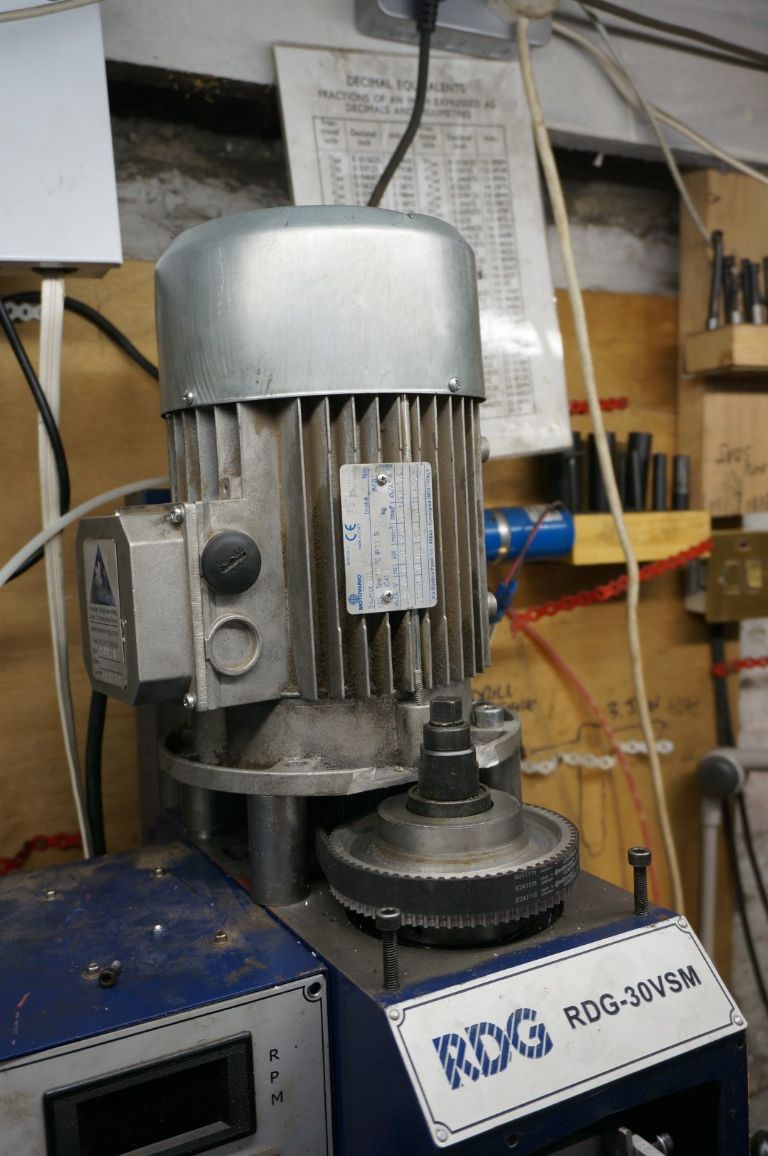

                        Ian Parkin
                          @ianparkin39383
                          Nick

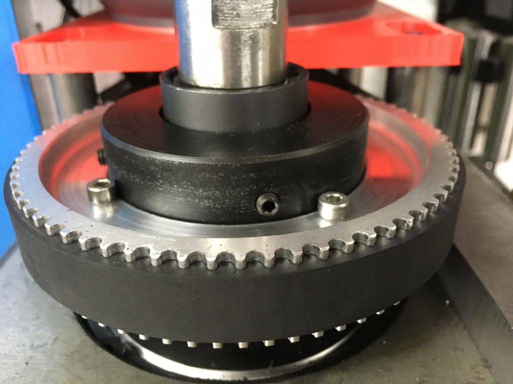

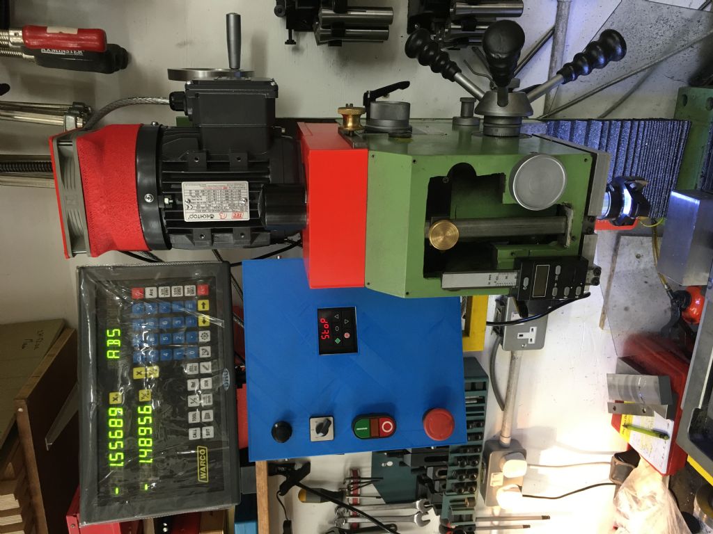

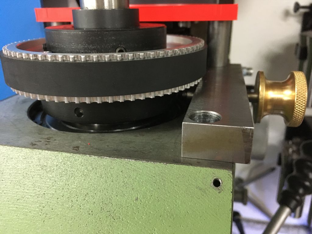

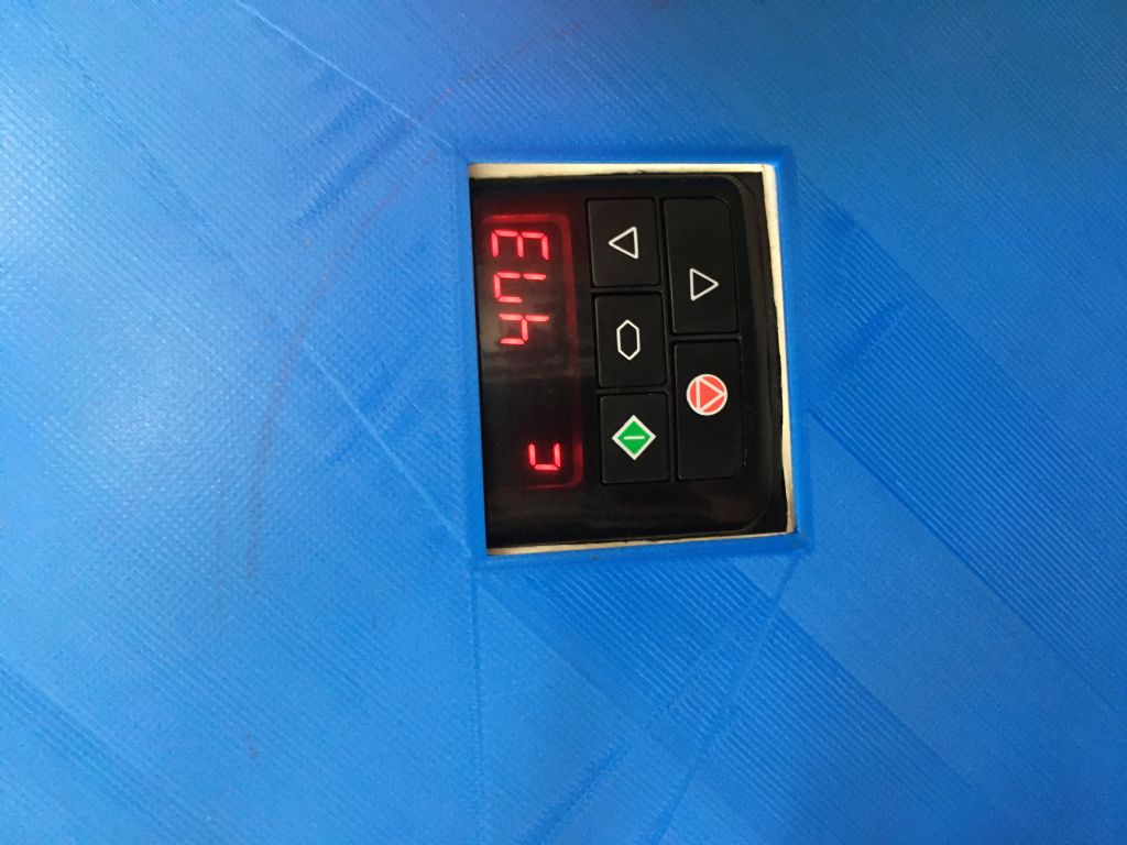

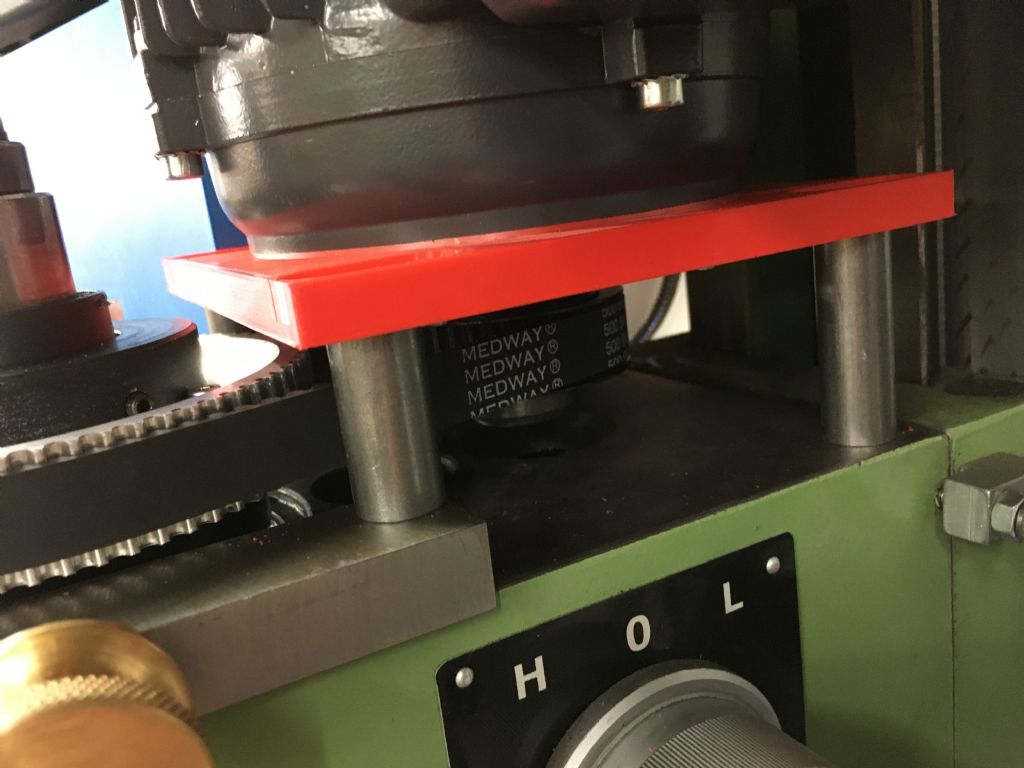

                                                Nick Webb 1
                                                  @nickwebb1
                                                  I decided to go down the route suggested by Ian, using a VFD drive and a 1.5kw motor (80 frame (reduced) B34)
                                                  The controls are taken from the original box, and I used the contactor to supply the place of an NVR, and do some of the interlocking. There is a 12v fan on top, controlled by the VFD, which runs while the motor is at low revs to provide extra cooling.
                                                  The drive is via 36 and 72 tooth timing pulleys and a 500mm long belt. The larger pulley is mounted on the spindle via a collar, drive being transmitted by 4 dog point grub screws which locate in holes which were already in the spindle.
                                                  I used to use those holes for my spindle lock, so have made more in the lower section of the collar, and moved the lock there.
                                                  The motor mounting plate is currently 3D printed, so the first job will be to make a replacement in aluminium. Let's hope the plastic holds up long enough to finish that.
                                                  The VFD shows the spindle speed (scaled from the motor speed) when the thing is running.
                                                  For those who are interested, the motor and VFD came from Inverter Drive Supermarket, the belt and pulleys from Bearing Boys. The fan is a Noctua 140 mm 1200 rpm Quiet Case Fan. I have no link with those companies except as a customer.

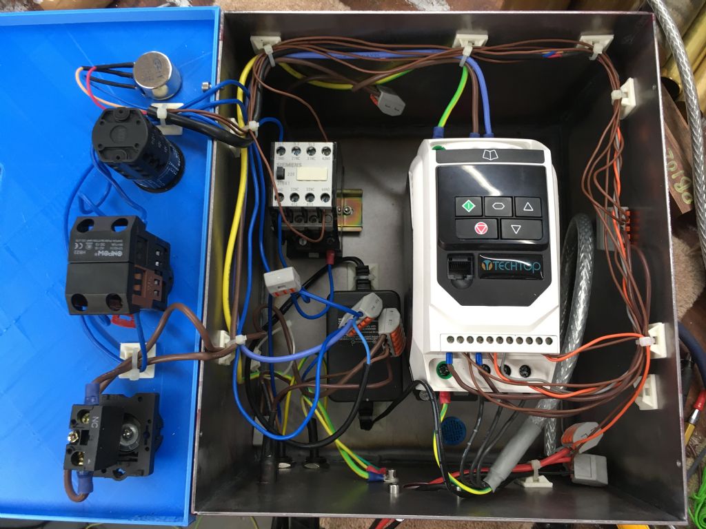

                                                  #531915
                                                  Nick Webb 1
                                                    @nickwebb1
                                                    This is what the inside of the control box looks like.
                                                    #531918
                                                    Ian Parkin
                                                      @ianparkin39383
                                                      Nick looks a fine job you have done there
