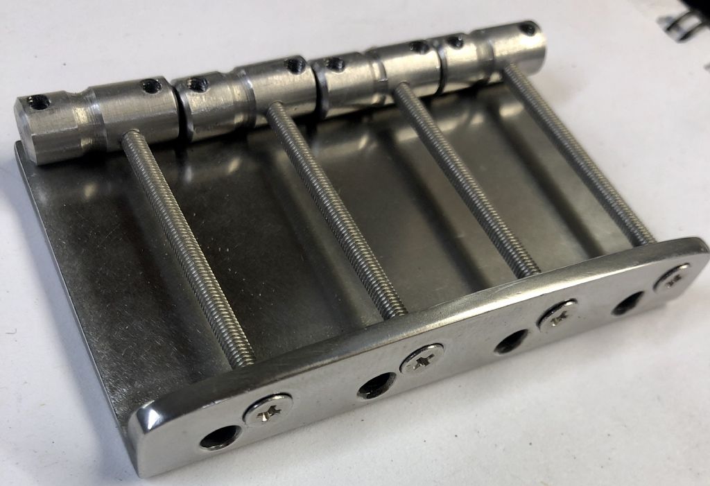

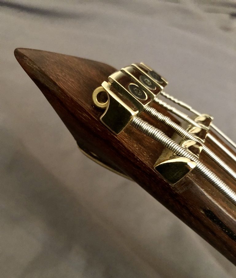

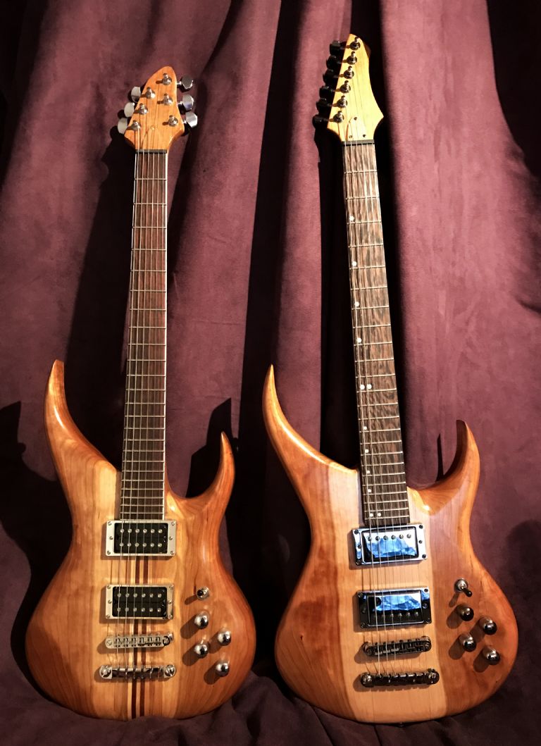

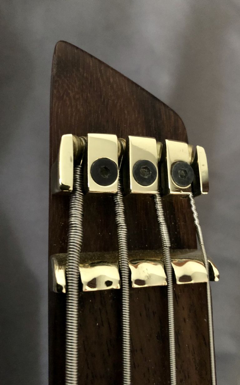

                                            I know i've posted this before but this is what i'm after with a mill – i'm a luthier (i make guitars – well, basses mainly as i am a bassist of over 35 years playing experience) and the mill (i hope) will be the difference between a professional finish & hand finish – mainly on the bridges i make, and heres one i made earlier;
                                            I want to be able to mill the edges after cutting them with a hacksaw so they're straight, its all hand files at the mo which is taking a stupid amount of time & i'm never satisfied with the finish. Also i want to be able to skim a few thou off the surfaces so i can either leave the machined finish or whack it in the sand blaster then polish to a mirror or brushed finish. The round bits which are called the saddles need the holes drilled to a greater degree of accuracy that i cannot get with my Clarke bench drill & compound cross-slide vice, I drilled these by printing a plastic sleeve with my 3d printer that had the holes placed where i needed them to be, then inserted the stainless bar & drilled following the template, even this had mixed results and wasn't very consistent.
                                            Plus the fact i want to make my own tuners so need the accuracy and ability to machine a block of aluminium to take the worm gear & drive – all small stuff really.
                                            I do charge a bit of cash for a build – anything from £600 to £1600 so a professional finish is paramount, which is why i need the mill, don't get me wrong, if it allows me to obtain the finish i'm after then upgrading will be next on the list (hence why i'll grab a micro mill for the right money), and judging by what i've seen going on the auction sites i'll only need the proceeds of a couple of basses to upgrade to a real serious piece of kit, plus i have the luxury of being single so the only voice i need to heed is the one coming from my wallet.
                                            Heres a couple of previous builds if anyone may be interested, it will give you some idea of what i'm trying to achieve – basically i don't want to buy any hardware such as bridges, tuners, pickups, i want it all made in house.
