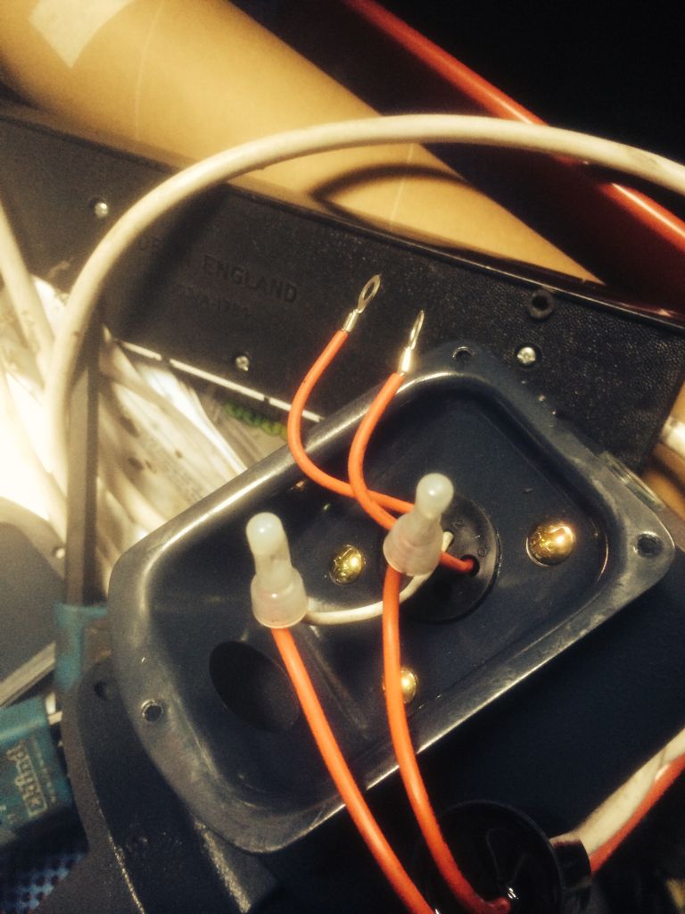

      I purchased a new coolant pump foor my manual milling machine because the old one went mental and blew up a few weeks back.
      Today I got the new pump which is obviously a generic Chineese/Tiwaneese make because it fits directly onto the tank I have, using the same hole spacing and it is physically the same size and shape as the old one. I thought that it would have a nice simple terminal block with obvious positions for live Neutral and Earth wires however it doesn't.
      Here is a picture of the wiring facing me when I took the terminal cover off.
      There are six holes numbered 1-6 in the back of the terminal box. No.s 1 & 3 are both red wires that have a crimped terminal on their ends. N's 2 & 5 wires are both white and are crimped to the two wires that come from the Capacitor.
      I presume that it doesn't matter which of the two red wires with the crimped terminals are connected to, either live or neutral and also I presume that the earth wire is terminated under one of the screw heads that holds the terminal box to the pump motor body.
      I am of the firm belief that wire is used as a conduit for smoke and other than that have no idea how it all works but would appreciate some help prior to blowing myself up.

          My first suggestion would be to contact the vendor for wiring instructions. You presumption is most likely correct though, but if any doubt I would recommend contacting a qualified electrician to check it over. Given that there are six wires, I suspect that it is a 3 phase induction motor, with a motor run capacitor for the 3rd phase, but no guarantees.

            I'm sure your assumption is correct. As I see it swapping the two red wires around will only change direction of rotation and on this type of pump with straight impeller blades makes no difference to the pump output.

              From your picture it looks like the two white and the two wires from the capacitor are all connected together. Is this the case. I would have expected one white wire from inside the motor to go to one side of the capacitor and the other white wire to go to the other side of the capacitor. I don't think it is a three phase motor as there are only four wires from inside the motor. A slightly wider angle shot would help as it does not look like the terminal box is on the side of a motor. Also what are the thick white wires around the outside of the terminal box ?

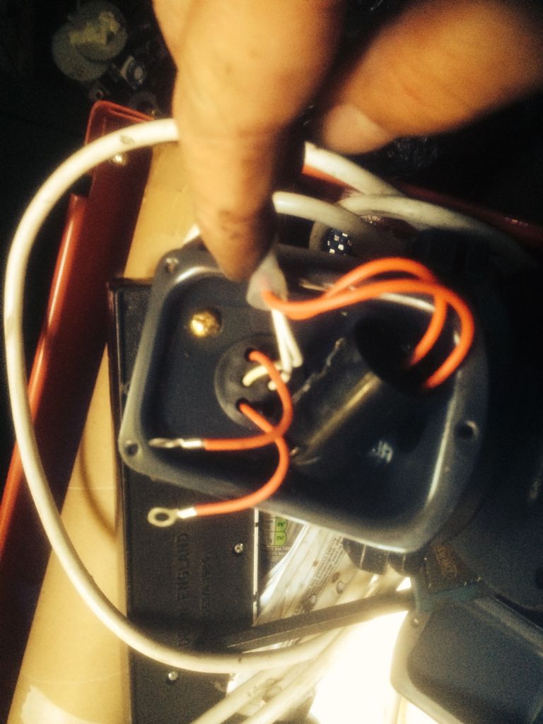

                Hi Les here is another picture and as you can see both the white wires are connected to the capacitor.
                It is not too clear which wires go where even from this picture, it looks like two red wires are joined at the crimp connection to the right but this is not the case there are definitely a white from the motor and red wire from the capacitor joined together at these connections.

                  I forgot to add, the thick white wire on the photo's is some 3 core power cable from the original pump.

                    To avoid any confusion here,
                    There are two RED wires with ring lugs attached……yes?
                    There are two WHITE wires each crimped/joined to the two RED wire coming from the capacitor yes?
                    There are no more wires coming from the pump unit yes ?
                    A standard configuration for a permanent  cap motor…..
                    In that case the mains L/N goes to the two RED wires with the ring lugs and Earth- green yellow to the metal casing……

                          I agree with John that the two red wires with the eyelets will be live and neutral. It does not matter which is live and neutral.
