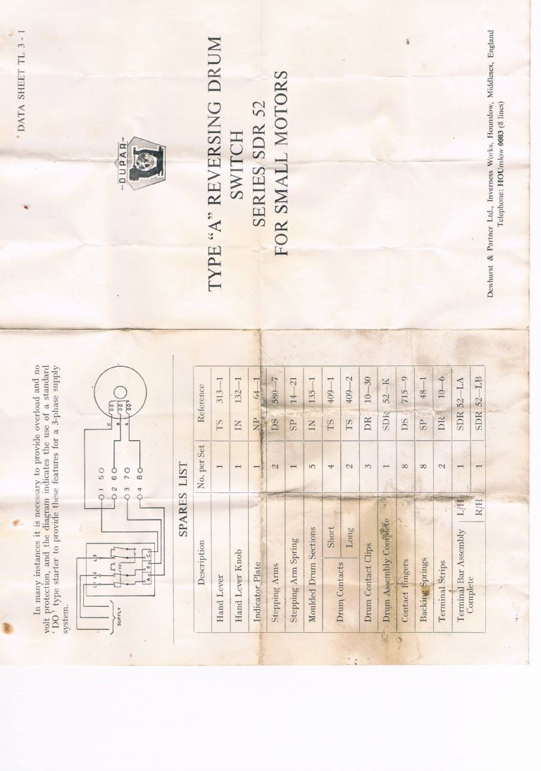

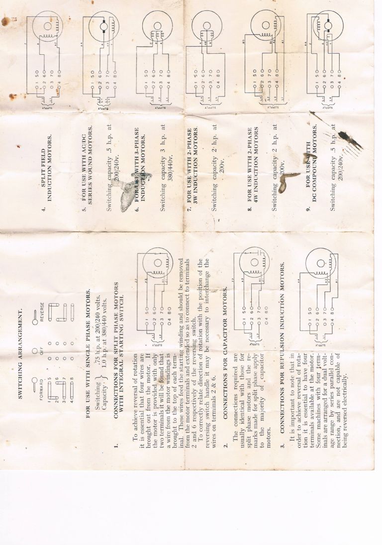

              dewhurst 2.jpg dewhurst 1.jpgHere is a copy of the dewhurst data sheet which you might find helpful.
              Peter

                    I find the terminal markings very hard to see, and not familiar with a Tyco motor which took over Brook and several other British makes. If you have access to a multi meter then you can locate/decide which pair are the run and which pair are the start windings, then wire the motor a per Steve's diagram.
                    Remove the two links and using the multi meter on the lowest Ohm range measure the resistance of the lower pair of terminals, then do the same on the upper pair. The run winding pair will have the LOWEST resistance, maybe 4or 5 Ohms, obviously the other pair will be the start winding which has a short time rating. Don't forget the EARTH wire and if the motor is a resilient mounting type, a link between the base and motor body. Let us know how you get on. John .

                        Hello Brian, you are only concerned with those four terminals ( those connected via the two links) which i mentioned, disregard all the others. Connect the 240 volt supply to 1 & 3, Run pair to 5 & 7, start pair to 2 & 6 as shown in Steve's diagram and know doubt in Peter's leaflet. May i suggest your friend get himself a proper motor starter fitted with No -volt release and use it to stop and start the lathe motor, and only use the Dewhurst switches for changing direction of rotation when the motor is switched OFF.. John

                          You need to use the No.1 schematic drawing shown on the Dewhurst leaflet.
                          Emgee
