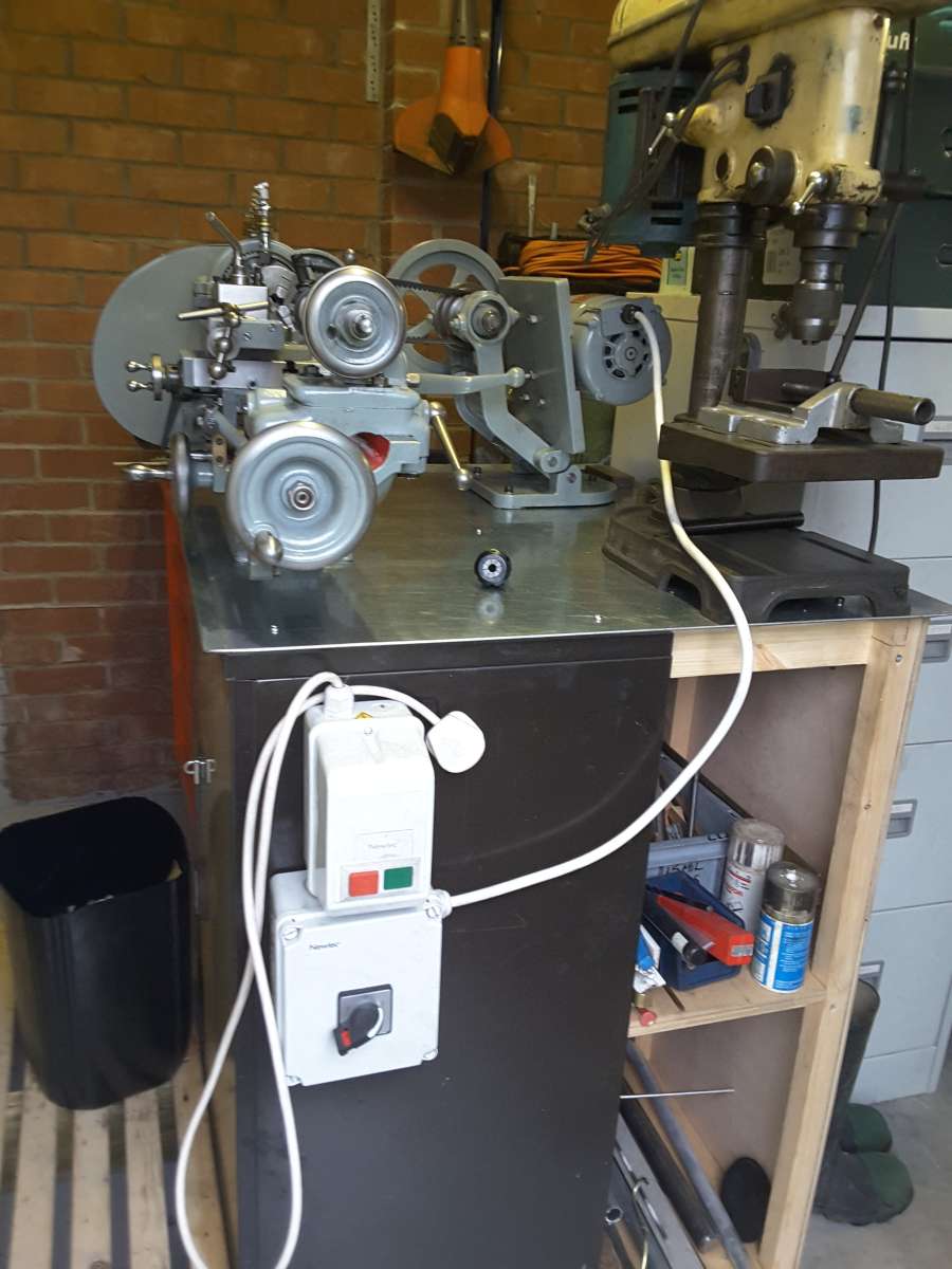

              I have a DOL starter on my lathe and have fitted a reverse switch as well. It is straight forward just follow the diagrams supplied. always switch live side and this set up cuts power if there is a power supply fault and wont start untill the button is pressed after power is recovered.

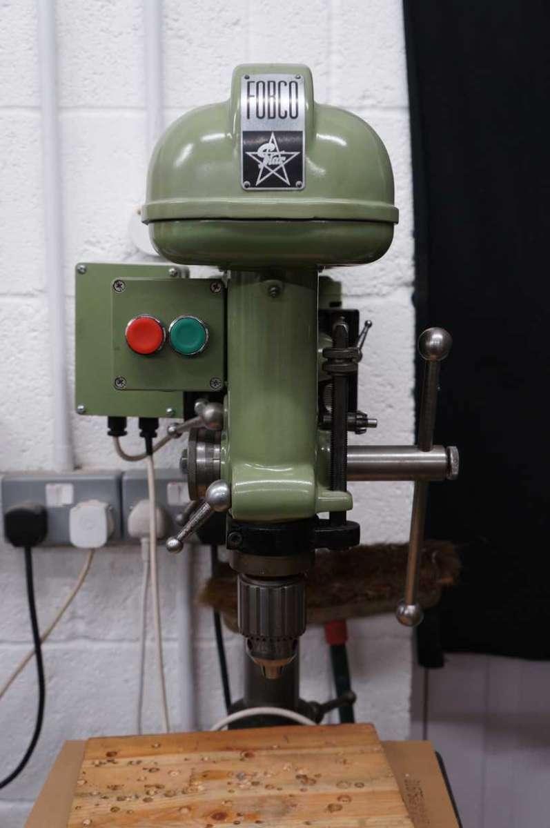

                      David, even with buttons on the neutral side, power loss would drop out the contactor solenoid, and the solenoid circuit would not be restored until the normally open start button was pressed. BTW, I did my Fobco Star a few years ago, after the rotary switch packed up (and repainted it at the same time).
