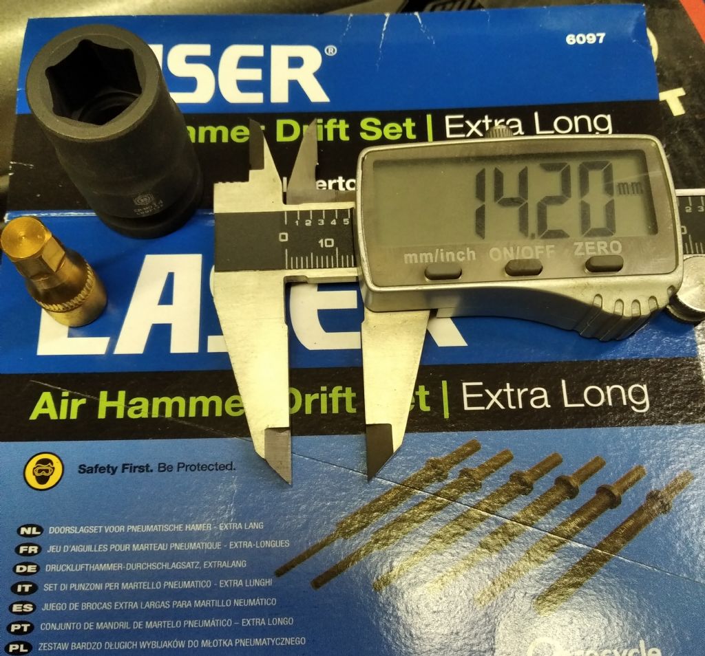

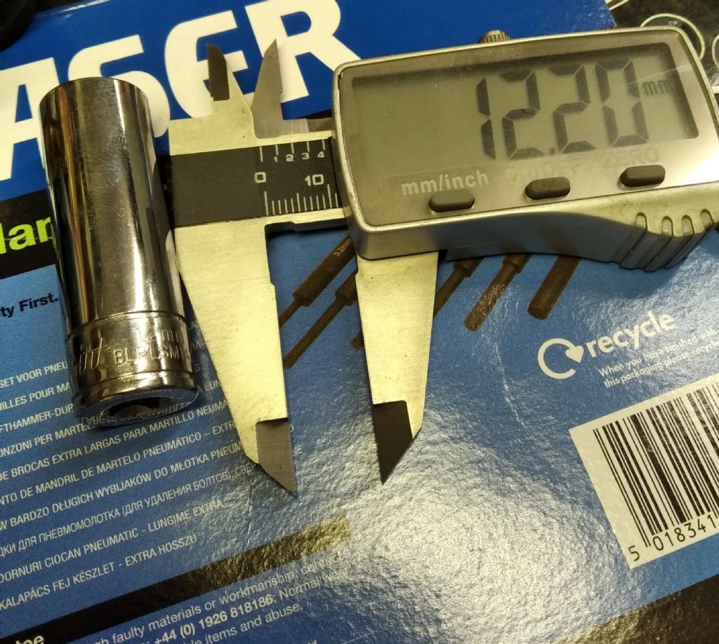

            Pete.
              @pete-2

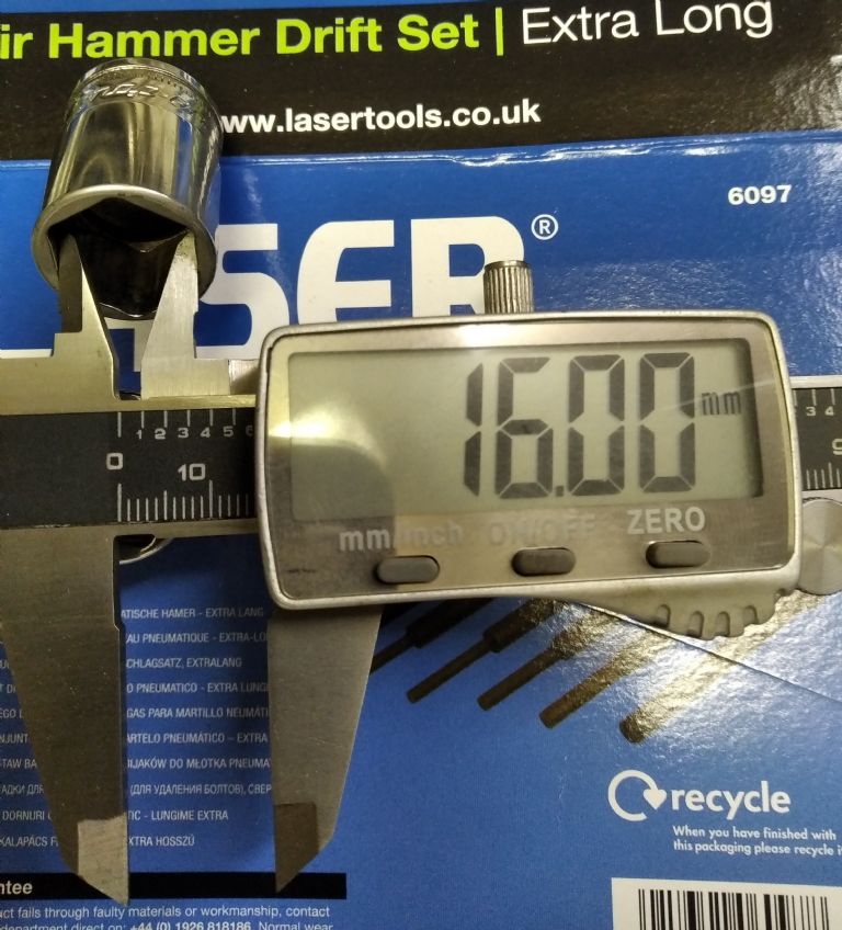

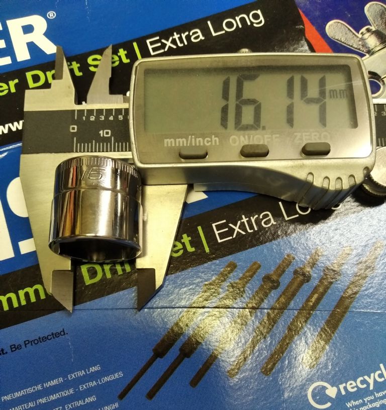

              Torx Plus (IP) not the 5 sided are quite simply the best internal fasteners, they're amazing, there's probably a long list of reason manufacturers haven't switched over to using them as a norm, hex fasteners are decided by manufacturer quality and the quality of sockets used on them too, I've given a few of my sockets a rough measure.
              The top photo is a Snap Flank drive FDX 16mm socket, these are made to precise tolerances, and show exactly 16mm.
              The second photo is a middle of the road 14mm impact socket that shows 14.2mm
              The third photo is a 12mm Taiwanese blue point socket showing 12.2mm.
              The fourth photo is a standard snap on flank drive 16mm showing 16.14mm

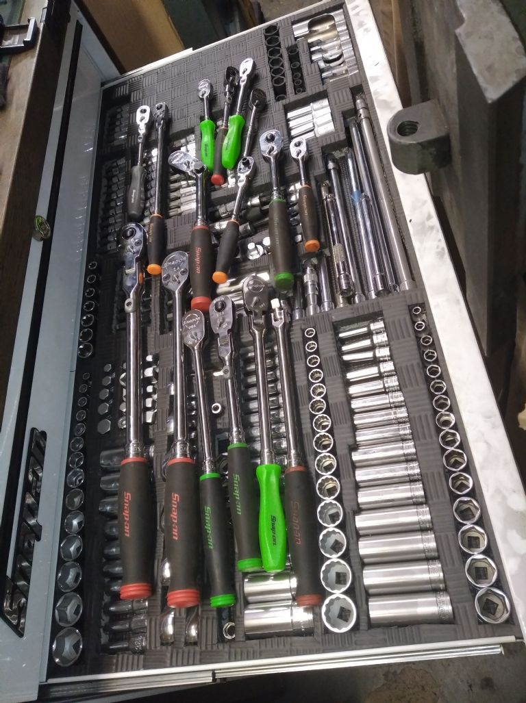

              #654356
              Pete.
                @pete-2

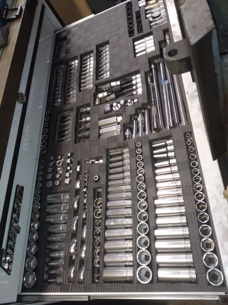

                If you're even semi serious about mechanical work it's best to keep every possible fastener type socket to hand, a good selection of Snap On ratchets never hurt anyone either.img_20230729_231244.jpgimg_20230729_230733.jpg

                          Bazyle
                            @bazyle
                            You don't really want a 16mm socket to be precisely 16mm or it won't fit on a bolt head that had a little more plating.

                            Pete.
                              @pete-2
                              Posted by Bazyle on 30/07/2023 12:54:22:
                              Never had that problem with them fitting, they're designed as specialist socket to stop rusty fasteners rounding off, after rusting they reduce in size slightly, they also do less visual damage to bolt heads that are aesthetic like motorcycle fasteners that you don't want looking marred up.

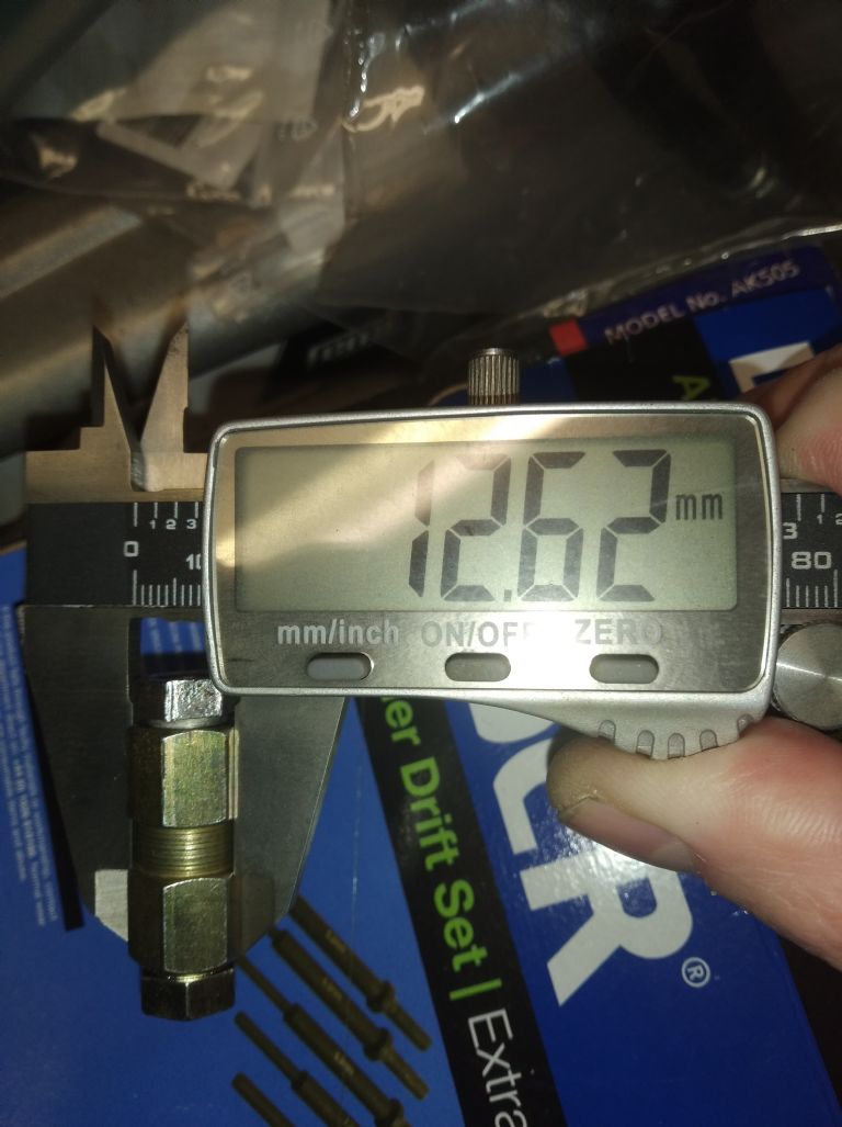

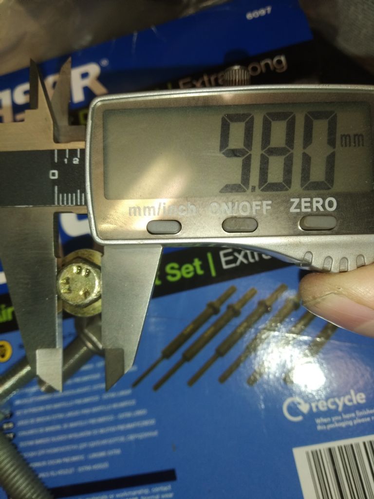

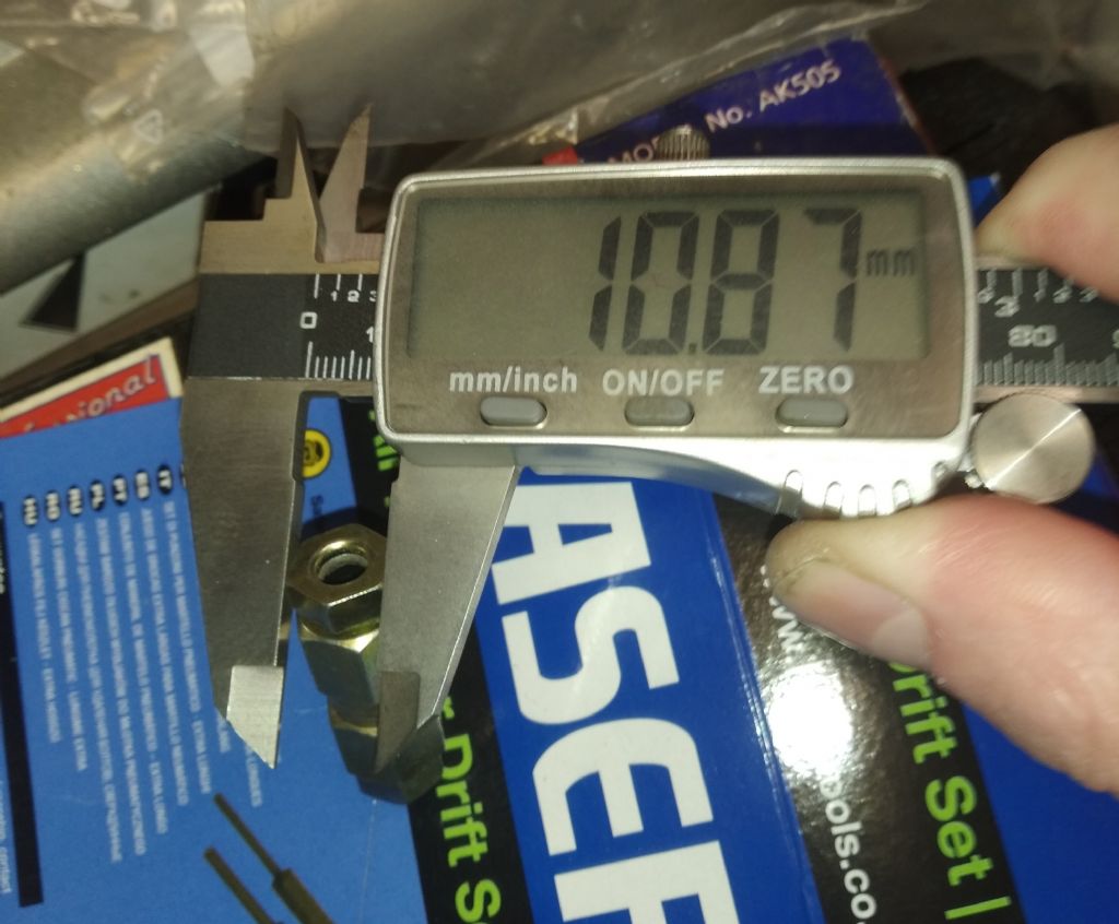

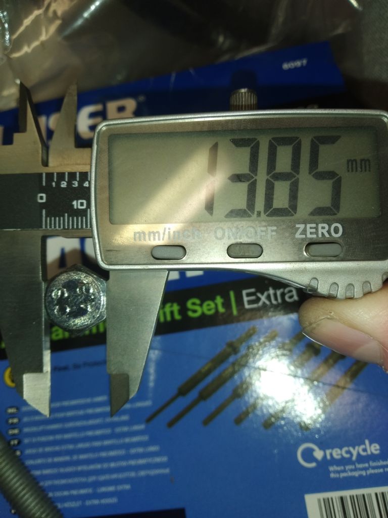

                              #654488
                              Pete.
                                @pete-2

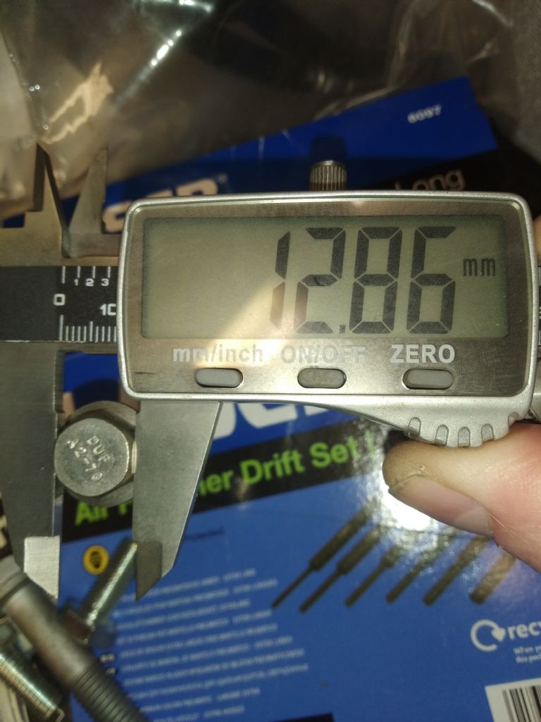

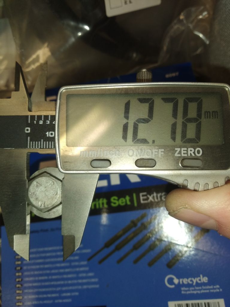

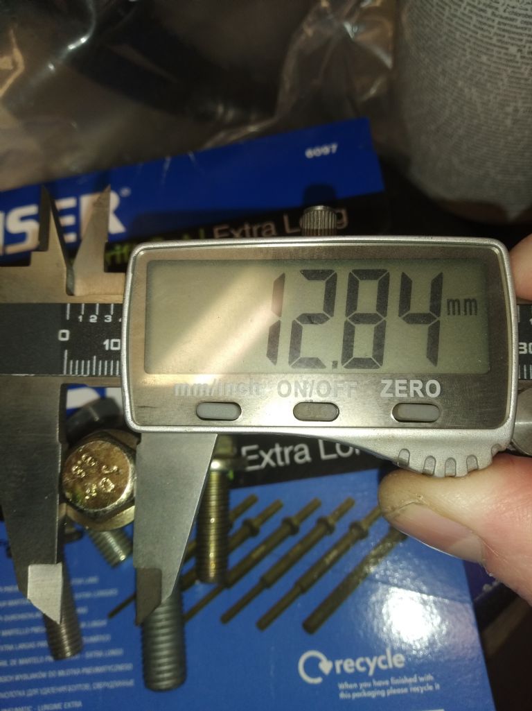

                                So a sample of plated and stainless fasteners
                                Photo 1, 13mm plated bolt
                                Photo 2, 10mm plated bolt
                                Photo 3, 13mm stainless bolt
                                Photo 4, 14mm plated bolt
                                Photo 5, 11mm plated brake pipe union
                                Photo 6, 13mm plated brake pipe union
                                Photo 7, 13mm OEM bolt from BMW if my memory serves me.
                                Believe it or not, Snap On as a tool manufacturer knows what they're doing.
