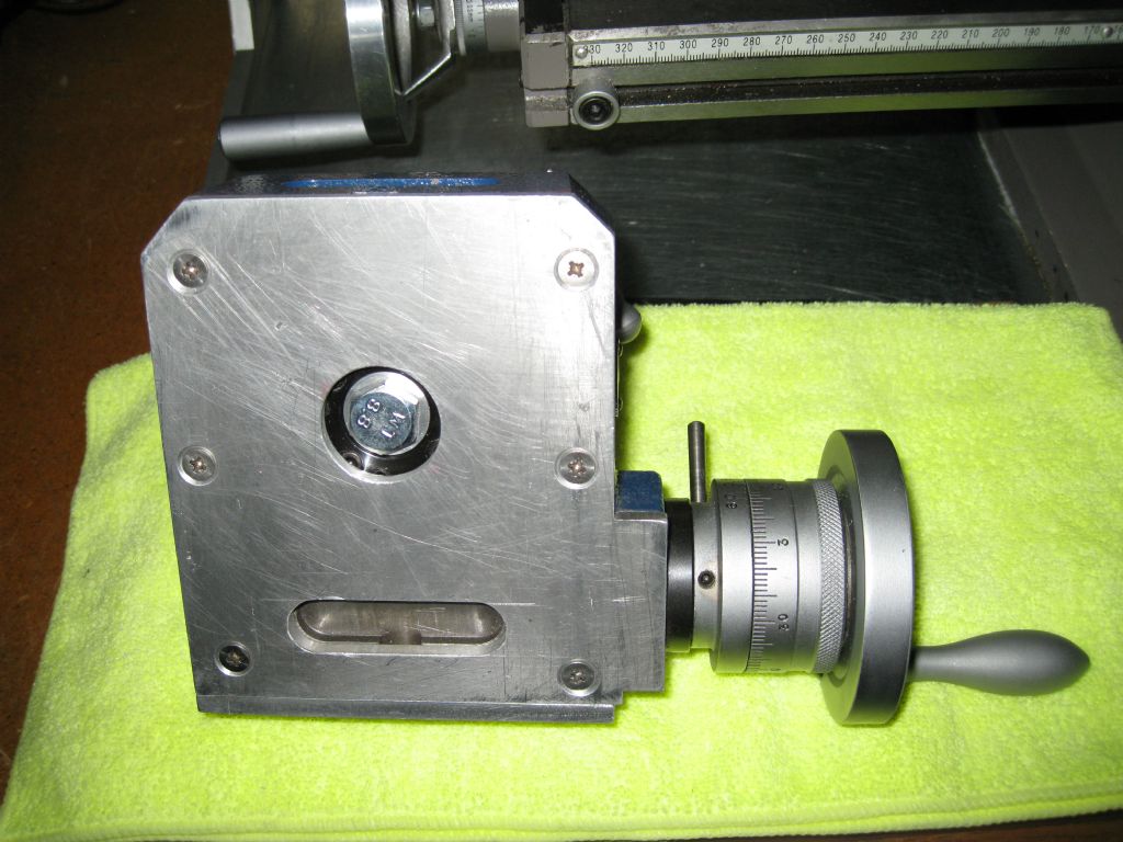

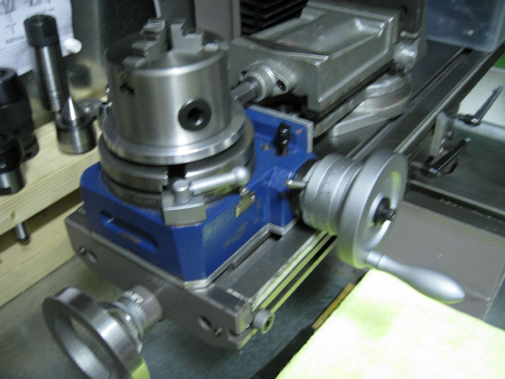

            Apologies in advance for a bit of a hi-jack, does anyone use a rotary table on a Unimat 3?
            I've been looking at the 2.5" & 3" offerings of (dare I say it) RDG, plus Chronos!
            Neither of them are very expensive tables at under £60, so not sure what quality will be like, then again, they're not going to get a lot of hard work as regards heavy cuts!
            Would appreciate opinions on them!

                      John,
                      Probably not what you are looking for, but:
                      I rather like Fig.1 here

                        MichaelG, Nice rig that but too big for me to lug around, I just pack up my Uni 3 in a neat plastic toolbox! I've just sold all my unimat SL stuff anyway as my Uni 3 already has a milling pillar and head, so was looking at small rotary tables that would fit it, I've already bought the table and 'T' nuts for the topslide!
                        I'm getting a bit cheesed off with crossing out clock wheels with a saw and files!

                            John,
                            Some useful ideas here
                            The modified table looks more at home on the Unimat.
