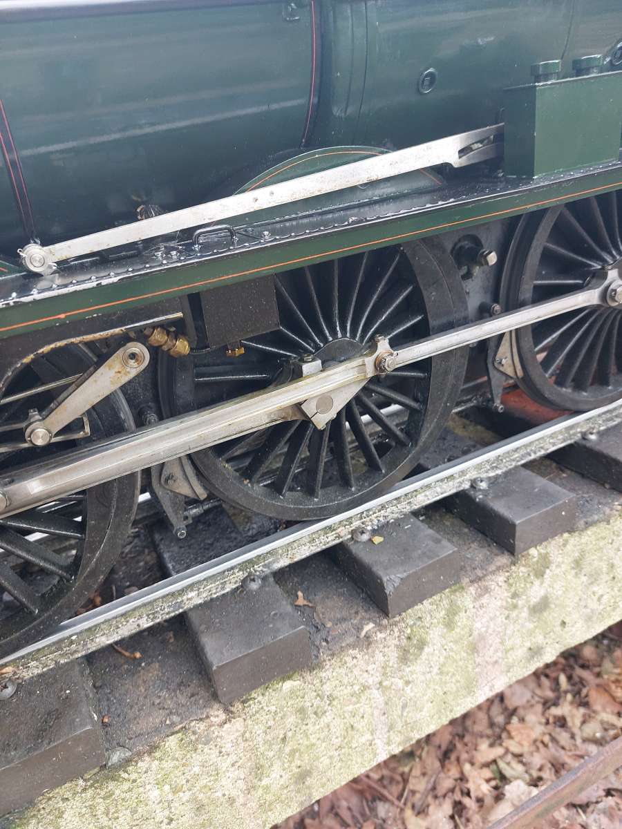

      Hi, I am at the position of needing to find and fit a lubricator to the running board of my 5 inch gauge royal Scot. However I am at a loss which lubricator I need and the best way of fitting to the running board. If anyone owns a royal Scot with the lubricator mounted in the running board, can they please let me know which one to buy and how it’s mounted. Thanks

                @duncanwebster1
                This isn’t going to help. He has the lubricator under the running board on thd left side. Not prototypical at all. Next time he brings it to track ill get a photo, but he has a fair few locos, so dont hold your breath

                  Thanks Duncan. The lubricant or position on mine is mainly under the running board with just the lid above. But all the ones I have seen for sale don’t look like I am able to mount them under the running board. And the drawings like always are total rubbish .

                    Here’s a picture

                      Thanks, looks just like the one I need.
