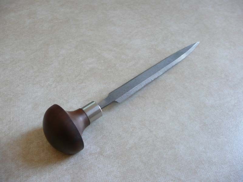

                ega
                  @ega
                  For small files I favour the kind of handle fitted to gravers – a truncated mushroom shape which fits nicely in the palm and whose flat stops the file rolling off the bench.
                  This is a Stubs. No doubt someone can give the correct name for the shape.
                  #219972
                  Roderick Jenkins
                    @roderickjenkins93242
                    It's a barrette file. I have no idea why it's called that or, indeed, why I know the name – I haven't got one. Why can I remember that and not what time I've got to go the dentist? frown
                    Rod
                    #219976
                    ega
                      @ega
                      Roderick Jenkins:
                      Thank you! That certainly looks right. I can't answer *your* question but the human memory is a strange thing and doesn't always do what it is bid.
                      In trying to locate a reference to barrette (without resorting to the internet) I came across the "fusiform" or "cigar-shaped", a double-ended triangular file which would definitely need a handle!

                                Barrette:
                                I finally ran this down in a Simonds (American) catalogue where the description reads "Used to remove burrs from gear teeth and for filing corners and flat surfaces. Double cut on the wide flat side and safe (uncut) on the narrow beveled back." It is, of course, of Swiss Pattern and is trapezoidal in section.
                                Surprisingly, not listed in my similar-vintage Sandvik-Öberg catalogue.
