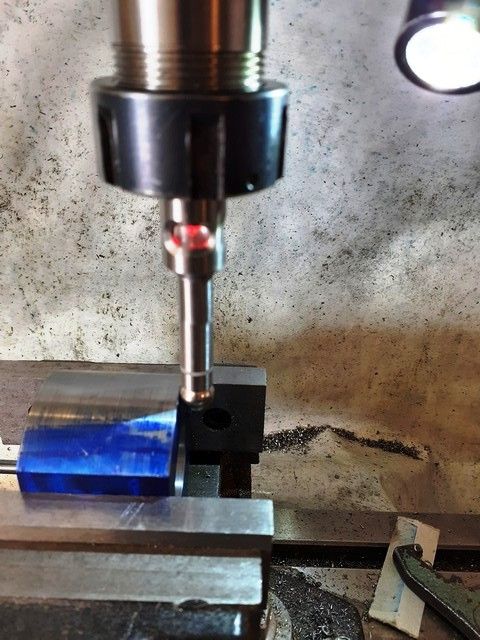

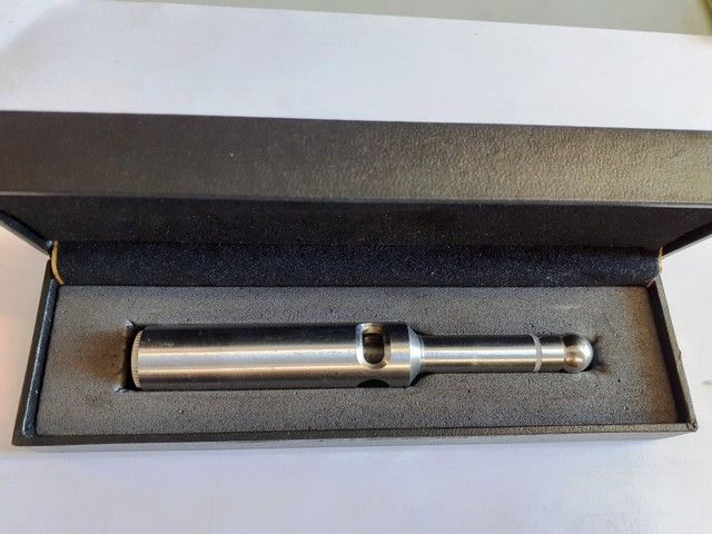

                  Having received an electronic edge finder this week I searched for any comments on their efficacy & usage hence this post. It seems that there are varying views, &, as others, I have a wiggler set & the disc set which both have seen plenty of use but I am one of those 'nice to have ' guys so went & searched on Ali express & found this one. All the others I have seen have a 20mm shank which is too large for my ER25 collet or drill chuck but this has a 16mm shank which suits fine.
                  On initial trial it's very sensitive, lights up & gives a 'beep' on contact, which does require a very slow 'creep' to the edge of the object. the ball at the end is 10mm, & is spring loaded should you 'push too far', so you do have a ref. for setting your spindle on edge if you have DRO's . very economical price too compared to some prices.Usual disclaimer applies.
