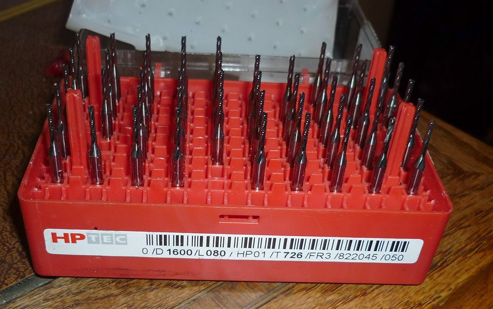

                                            mark smith 20
                                              @marksmith20
                                              I bought these off ebay by HP Tec 1.6mm (no idea where they are made) but i use them for drilling sterling silver . Ive had them around 5 years and use regularly and only have had about 4 breakages in a manual Proxxon mill. I got sick of the carbide drills breaking ,so use these router bits instead . They seem very good quality.
