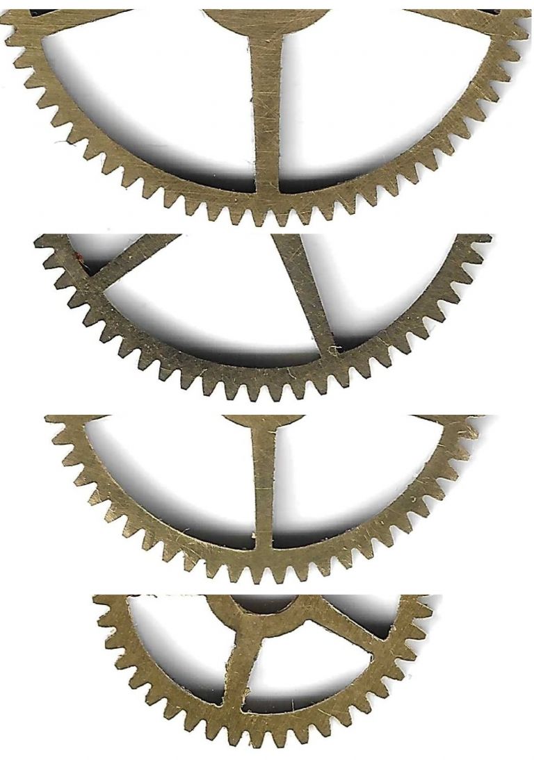

                        Hi Martin, with my project, it's going to be mainly pinions driving wheels for a calendar and a lunar train.
                        I am wondering if my tooth profile is ok.
                        I put my wheels on the scanner and set the dpi to 1200 and got quite good results. Here are 4 different wheels, 73, 64, 60 and 48. All but the 48 crossings are part filed to shape.
                        Can anyone see any fault with the profile?
                        Steve

                          They don't look deep enough to me. I would like to see one depthed with a pinion

                            Posted by roy entwistle on 12/09/2022 12:48:29:
                            Roy
                            I'll try to take a photo.
                            Ivan Law quotes a DoC of 0.65mm for Mod 0.3. Other sources told me 0.675mm. I went for 0.67mm.

                              I suspect that the pinions might be part of your problem … especially if they are low count
                              A detailed photo or two would help a lot

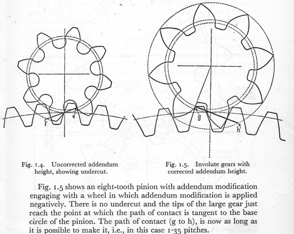

                                          This … from ‘Gears for Small Mechanisms’ well-illustrates why I was interested in the profile of your pinions, Steve
                                          Note: __ I find it a little disturbing that figs 1.4 and 1.5 are presented at different scales … must get around to doing a proper overlay sometime.

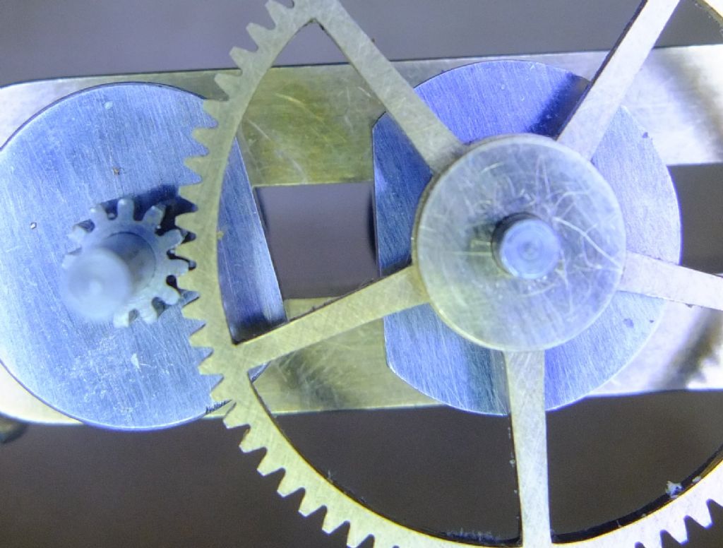

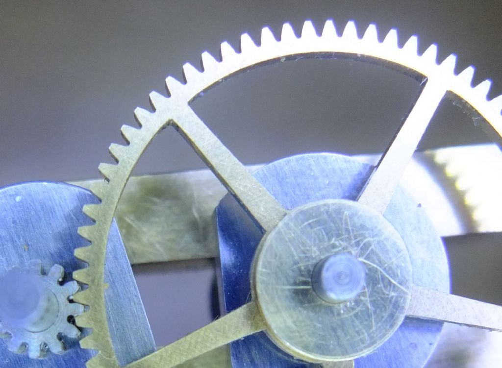

                                                Ok, I've took some meshing pictures. It wasn't easy. I had to take dozens to get two adequate pics.
                                                These ar at the tightest mesh that still allows free running. In practice, I'd probably increase it by a couple of thou.
                                                By the way, 12T pinion, 73T wheel.
                                                Steve

                                                  This close up photography does not flatter the finishing on my tools!
                                                  For scale, the runners are 2mm diameter.

                                                    By the look of those photos the wheel tooth form is all wrong for a clock
                                                    A good reference book is Michael Wild clock wheel and pinion cutting, it's expensive but the definitive book on the theory and practice of cutting wheels and opinions for clocks.
                                                    Good photos though !
                                                    Regards

                                                      Good photos, Steve … but I don’t like the look of that meshing
                                                      If you send me your eMail address by personal message here, I have a PDF of chapter1 of Gears for Small Mechanisms, which you might find of interest.
                                                      The book is excellent, but rather dated … grab a copy if you see it cheap, but I doubt you would need most of it.
