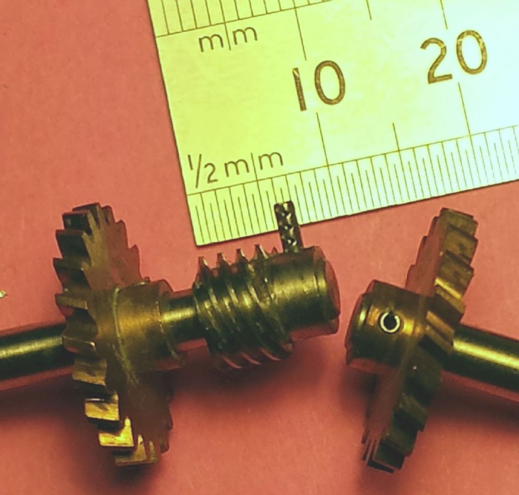

        Some sort of shear pin from my milling machine, anyone know it's name?

          Looks to be a variation to a standard roll pin….
          You could replace it with a piece of brass if the shear forces are not too great…..
          Why has it broke? What did you do/what happened for it to break?

              A very common type of Roll Pin, often used in instruments to keep collars in place and also used where there are plastic parts. A bother to remove and I use a stepped punch specially made for each size I deal with.

                It was on the drive shaft on a milling machine. The handle from the X axis hit a piece of wood that protects the Z axis DRO from splashes. Usually it just knocks it out of the way but this time it didn't!
                Yes it was a right pain to remove, I'll probably just use a standard roll pin, would this be ok?
                #165022
                  It did it's job, what would have broken if you had used a solid pin?

                        My opinion? No! It is a sacrificial pin and is designed to shear ….I'd recommend you use brass….defo not Silver Steel…..
                        Look at it this way, if the pin doesnt break, something else will ! …..and it could be expensive and could contribute to you being injured….

                          Most shear pins I have come across were Aluminium and very soft! The end having been knurled with a straight knurl to make a tight fit. Emco Lathes use an Aluminium pin on the leadscrew on the Maximat 11.I would not use a steel or brass roll pin on any drive shaft as a safety device.

                              If the function of the OPs pin in his picture was as a shear pin then it not a well made/designed machine. The pin shown is quite hard steel, possibly spring steel or maybe stainless. Unless both parts of the drive that the pin passes through are hardened the odds are they will be damaged when the pin shears. On reflection since the pin shown has not sheared then maybe it is NOT a shear pin after all.
                              Aluminium or copper are probably far more suitable, brass might be ok too.

                                          If the roll pin is definitely an original fitment I would be surprised if it was intended to shear, as previously mentioned a hardened roll pin can make a mess when it shears. As it has sheared I think I would replace with a soft material and if nuisance shearing occurs work up to tougher materials or larger size. Some shear pins are steel but waisted so a weak point is defined. The waisted section can be increased in diameter until nuisance breakage does not occur but it is still the weak point that we want to break first.

                                            As for shear pins, I used to have to work on big stuff (snow ploughs etc.) and these had shear pins in the plough drive shafts. These pins are solid steel with a head at one end looking like a clevis pin on steroids with a machined annular groove at the shear point to provide a weak point in the pin. Try google for the term "shear pin" and look at the pictures! Brass, copper, steel – it matters little what you use as long as it will shear before deforming the associated parts and at the correct shear load. i suppose you also want it to shear clean rather than have a brittle fracture leaving debris all over the place!

                                              The pin had broken, it was originally 29mm long.
                                              As the shaft it is in has two universal joints there as a further three of these pins in the same shaft. I didn't explain this at the beginning.
                                              Where can I buy these pins, has anyone seen them for sale in the UK?

                                                According to google it is probably known as a "stainless skew proof spring pin" and comes from anzor.com.au
                                                there are two or three images on google of this style of pin but I dont see any UK stockists.
