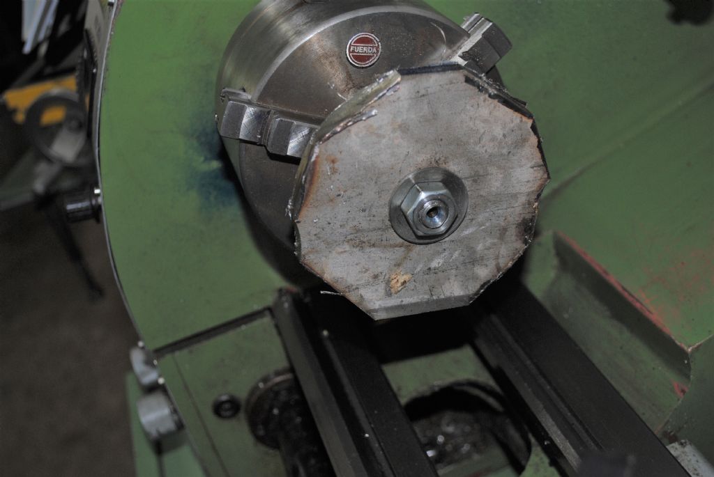

      I have a Warco 240MV lathe & have removed the topslide. The 4 jaw chuck is permanently mounted on the cross slide for better rigidity. I have a variety of cutters (HSS, Brazed carbide & indexible)& because I have several of the following pieces to make, I might consider buying the right tool based upon advice received.
      I am making a rope cutter for a prop shaft of a yacht out of 316 stainless steel. I am starting with 13 mm * 100 mm plate which I have cut to a rough shape with an angle grinder. then mounted it in a 4 jaw chuck, bored for the shaft. then mounted on a mandrel in a 3 jaw chuck.
      I am now faced with a piece of stainless with a very rough hit & miss turning problem. I tried taking a piece off whilst still in the 4 jaw & it vibrated like h..l.
      So my problem is what is the best toolbit -Type, end size, radius etc then lathe speed to get a reasonable cut & get it round.
      Having done that I am going to turn it to 85mm diam & the cutting part will be 6mm the ( the boss is the 13mm) chamfered to a sharp edge.
      In this edge will be 6 No semicircular notches 8mm diam ( so they will be 4mm deep) to aid cutting when it spins. So when i get to diameter I will drill 6 holes on the circumfrence then machine the edge . Once again I will have an interupted cut.
      This may preclude my usual lightweight cheepo chinese disposable tips
      So can anyone please suggest the best tooling for the job & if they added some idea of speed that would be great.

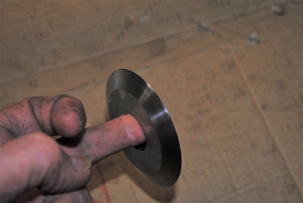

      I am enclosing a picture of the disc in the lathe ready to go & a picture of a cutter that does NOT have the 6 notches to give an idea of what it might look like

          could you start with a SS cutting disk and then add the boss
          eg as part of a parcel of bits I wanted I have maybe 8 or so 80mm dia 1mm thick sharpened to a cutting edge as used for meat slicing of those lumps of cooked mince seen in many takeaway establishments

            Hss to start with but the tool MUST cut ! If it rubs it will almost instantly harden the 316 and be a real problem. As to the design, I would query the wisdom of notches in the periphery, They will catch the rope and pull it round the shaft ! Look at the shape of the blades on a No Weed Propellor, fitted to the DUKW. A far better plan is to NOT to rortate the prop whilst a rope is in the water and ALWAYS have a very sharp knife to hand to cut away any rope or net ! Noel

              Take the blank out of the lathe and using the angle grinder knock off the corners so it's 'rounder'
              That will make your choice of lathe tool less critical because it doesn't have so much to do.

                A plate mounted on a small spigot is an open ended invitation to Mr. Chatter, whatever tooling you use. The ratio of OD to finished bore doesn't look too bad.
                I'd mount the rough plate in a 4-jaw chuck held on the OD. Face off and drill/bore the centre hole. Turn it round in the 4-jaw and face to width. It wouldn't take long to knock off more of the edges on the rough part. Finally mount on a spigot, with a thick washer (not a thin commercial one) and machine the OD and chamfer. In my experience 316 turns very nicely with insert tooling. I'd mill the peripheral slots after machining to avoid an interrupted cut and allow one to form a better shaped edge for cutting.

                  I started with it in the 4 jaw to bore the shaft hole. I then tried taking off some of the outer edge but with only 6mm held in the jaws I felt that i was in fro a piece of plate flying out across the workshop. Taking tiny cuts with a brazed cutter was just work hardening the material. So that is why i decided against leaving it in the 4 jaw. At least in a mandrel it is securely held. Perhaps I will cut the notches in the mill afterwards. I have to work out how to get sharp edges on them as well, so a ball cutter may be needed.

                      Have you tried setting the tool angle for face cutting and then advance it like a boring tool. If that doesn't work a carbide milling cutter tip will withstand the interrupted cut.
                      This is one of those times when the £80 Lidl Parkside plasma pays for it's self.
                      I don't see why the commercial rope cutters are just plain blades if notched was better? You may end up with a rope catcher cum propshaft bender.

                        Yes definitely round those corners off with the angle grinder. And please, please grind or file off those razor sharp grinder cut-off burrs while you are at it. What you have there is a visit to the emergency room waiting to happen. Ouch! Fingertip injuries really hurt. Lots of nerves there.
                        A tailstock centre in the end of the mandrel might help rigidity and make cutting easier. And a beefier washer as already suggested would help stop slippage too.
                        I would use a HSS toolbit ground with a bit of a radius on the end to minimise chances of the point being knocked off.
                        Spin at 50 to 80rpm for a HSS tool bit at that diameter on stainless. Or double that if you use good tough indexable tooling with a radius on the corner.
                        And don't let the tool rub on stainless steel lest the work-hardening fairy does bless your job.

                          Posted by Sam Longley 1 on 18/02/2021 12:09:25:
                          That's why I didn't say machine part of the OD in the 4-jaw chuck. smile
                          A disc supported only at the centre is a ………. cymbal! Good in a drum kit but not so useful on a lathe. For the spigot I'd make the diameter of the backing surface about half the OD of the part, say around 50mm barstock. Same for the washer at the front, and I'd use a SHCS instead of a nut. Making the diameter of the driving surfaces a good proportion of the part OD means that the part is less likely to slip when taking proper cuts to avoid work hardening.

                                  Tightly trapping an intermediate plate of reasonably thick "improved wood" (Mdf, osb, flooring board or whatever you have) firmly between the plate and ends of the chuck jaws will give better support and help dap out any ringing. Hafta accept a bit of dust if you cut into the face of the plate but generally its not going to be silly messy.
                                  Most of the improved woods are remarkably flat too so contact is good. Waterproof chippbard underfloor is my favourite as the surface is slightly rough for a better grip.
                                  As my lathe takes 5C collets direct in the spindle I'd fix the backing plate to the faceplate and grab the work holding spigot in a collet using the tailstock to push job and backing plate into really intimate contact.
                                  Maybe consider a bit of threaded rod as a drawbar to pull the job hard against the backing plate before finally tightening the chuck.

                                        I would cheat and profile the diameter very close on the mill/rotary table.

                                                  Stainless 316 is on my avoid list because it work hardens. That roughly shaped octagon causes difficult interrupted cuts likely to break carbide, which is otherwise a better bet than HSS. 316 conducts heat poorly causing HSS to overheat and blunt quickly. The web recommends flood cooling HSS and 316 and also making sure the HSS stays sharp throughout the cutting. About 60 RPM for 85mm diameter.
                                                  Before turning it, I'd round the blank more with an angle grinder and remove the hangers on. Then very light cuts with carbide at about 200 rpm until the circle is formed, at which point go in a bit harder. I'd expect the disc to work harden as the tool rubs either side of the peaks, but carbide should cope without breaking provided it's not asked to chop metal too quickly.
                                                  Holding the blank is tricky too: it needs to be rigid with no chance of coming loose. Not sure what to suggest. I would try super-gluing to a fat mandrel as well as bolting. A problem with bolting as shown is shock loads tend to loosen the nut.
