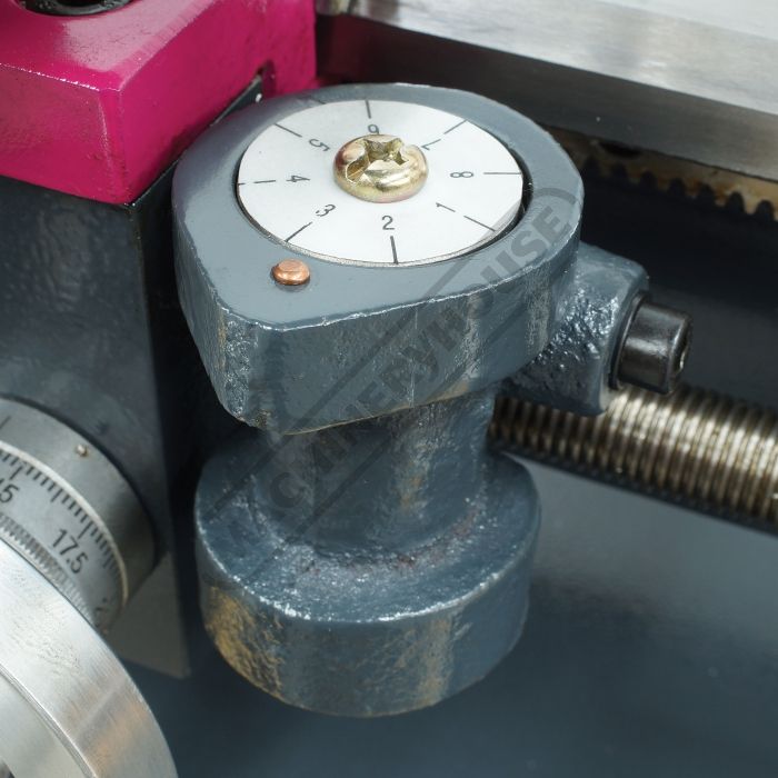

      1. What does this control do ? This is a photo of an Optimum TU-2004V lathe ; it is the big brother of the small lathe I have now.

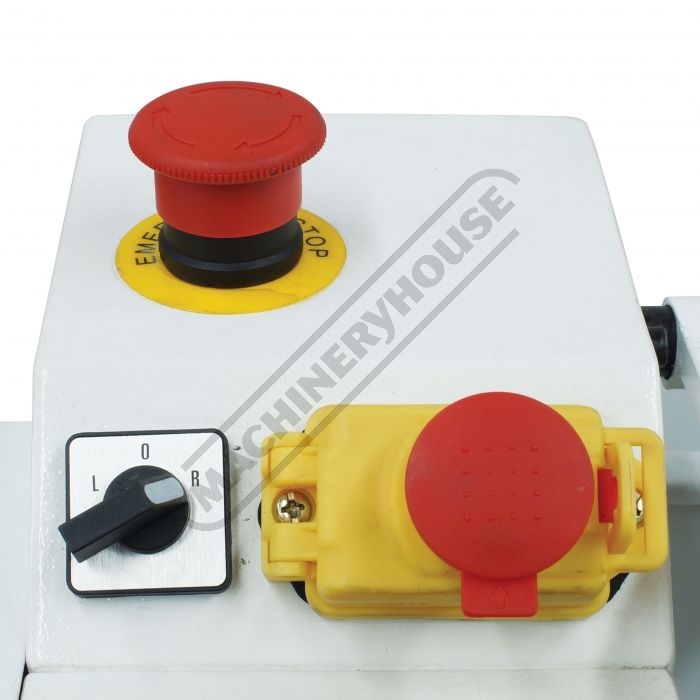

      2. Do you think having two emergency stop buttons is really necessary ?

        This is from an Optimum TU-2004V lathe

          1) Is a thread dial indicator, used in screwcutting, to determine the engagement point when returning to the start of the thread after the initial and successive cuts….
          2) The requirements for the number of controls is driven by some European directive for machinery, there is an Emergency Stop button at the top, then there is a No Volt Release switch below it, which just happens to have a Manual Stop associated with its functionality…my guess is these controls are in place due to the requirements of said directive….My big lathe has the same controls, yet my Chester 9 x20 nor my Sieg mini lathe dont….
          #246101
            The original design probably didn't account for many NVR switches coming with a 'e-stop cover' these days.
            I expect they would do away with the one on top, except it would leave an embarrassing hole…
            All explained here (clear as mud…)

              Either that or they would need to fit a blanking plate, which would only add to the mystery i suppose.

                Posted by Neil Wyatt on 10/07/2016 12:41:47:
                I think its the other way around, they originally fitted the NVR switches with integral emergency stop but as they are a bit of a pain to lift each time you want to start the motor people took the E-stop cover off.
                I have one of the first 280 lathes which has the E-stop integral with the on/off and no separate e-stop, they later added a separate E-stop and now have open NVR switch and the E-stop on the top.

                  I have taken the E-stop cover off my drill press because it just became too much of a hassle to use it. I really could not see the point of it because I can hit the red off switch just as quickly as I can hit the red button on the cover. I do not remove safety features lightly but when they interfere with the smooth operation of the machine then something has to be done. Others may have a different opinion.
                  I think the larger separate emergency stop switch is an excellent idea and should be installed on all machinery. The E-stop cover is a lazy solution.

                    If you look at the link In gave, the NVR one is better because it works fast irrespective of how fast you hit the button and will stay off. The other switch only works as fast as you press it, plus it isn't latching off – it only works like this because its in line with the NVR switch and trips it when its pressed.
                    There are arguments for both. The cover-type switches do mean you have to clear the e-switch before being able to turn on while you can attempt a start with the other type of e-switch pressed in.
                    The fail-safe or not nature of these is different depending on whether they are directly wired or controlling an inverter, for example.

                      Posted by Neil Wyatt on 10/07/2016 17:25:46:
                      The other switch isn't latching off –
                      Well I can assure you that on my Toolco lathe (same as the Warco WM290V and other clones) the Emergency Stop button does latch….
                      Neil, If you have an example of a machine where this not the case but is upstream of the nvr switch then it is of no consequence I guess…
                      My only gripe is that the ES is badly placed…..it ought to be within easy reach of the operator without having to reach over a rotating machine …….
                      #246133
                        Yes if you look closly at the top of the E-stop in Brian's pic you can see the arrows where it has to be turned to unlatch.
                        I actually prefer the covered type NVR as your hand is used to going to that position to switch off the machine so in an emergency you don't have to think about where to hit as you instinctively go to teh usual off button but hit the cover rather than lift and use the stop button.

                          NVR switches have been a must for a long time. Good reason too. The kludge cover to make it an emergency stop switch as well was just done on many things for cheapness. Most people take the cover off. The nvr and stop button has been used in industrial environments for a long long time.
                          A stop switch is a different animal. They are forced rupture switches, or a least that's what I call them. The force on the button is directly applied to the switch contacts. The design lends itself to having a sensible latching mechanism and a nice big mushroom top that is hard to miss for if it's needed in anger. Also because the contacts are driven pretty forcibly they can have rather high current ratings. NVR's are often some form of latching relay set up so don't switch directly like a stop button can.
                          It's all similar to isolators using knife switches really. The same reasoning applies.
                          All that may have happened recently is that the same thing has been applied to hobby type items. Good idea too really as the cheap kludge method is a pain for people to use so the cover is very likely to come off.

                            Good example of how following safety rules and regulations actually makes things more dangerous due to the inherent confusion. Can't say that I approve of the latching type E-Stop switches as they effectively act as a disconnector once latched and appear to remove power from the machine. Bad on two counts:-
                            Firstly there is no clear indication that the switch has latched and is off. In the latched position the button is typically around 1/8" or few mm lower than normal. Not something easily noticed during the usual faff around working towards panic "Why won't the poxy thing go." situation.
                            Secondly without detail information on the circuits you cannot be sure where the power break of a latched E-Stop switch actually is so its quite possible for hurried folk to diagnose power loss due to internal problems and start investigating with power still on. Yes I know you should make sure everything is off before digging in but flustered folk can, and do, make silly mistakes doing things which normally they would know not to attempt. Even skilled help bought in to do the job can do silly things it not given all the information on the basis of wrong ASSumptions. Both places I've been in somewhat different situations. Regulations say that microswitches should be included to interrupt power if panels are opened but such things are regularly disconnected or otherwise circumvented by folk who just want to get on with the job.
                            The red stop button cap on the NVR switch raises the concept of kludge a little further towards an art form.
                            The rule framers seem to think you can inconvience people into being (theoretically) safe. A dubious proposition if ever I saw one. Unless the intention is to make folk think that using a lathe (or whatever) is just too much trouble.
                            Hard to beat the set-up on my Smart & Brown 1024 VSL. Proper disconnector on the main power feed. Big red lever on yellow background so On – Off status is visible from right down the other end of the workshop over 20 feet away. Machine has NVR relays on all controls with shrouded pushbuttons to select forward or reverse drive and a big red mushroom headed non latching stop button. Stop button is over 2 inches diameter and falls easily to hand. Simple, straightforward and sufficient. Each control does one thing in exactly the manner you expect.

                                        The reason for the nvr latching kludge is the manufacturers not the rule makers Clive. They would have argued that the correct solution of keeping a master stop panic switch separate to the nvr switch was too expensive for consumer items or needed to be introduced slowly. There is also a chance that there was a hole in the rules but I doubt that.

                                          Clive makes some good points.
                                          I caused posts by confusing the mechanical latching of the E-stop with the electrical latching of the NVR.
                                          As John points out the mushroom E-stop can potentially be used to interrupt the supply without being depressed fully so it fails to latch if it isn't hit hard enough. This operates the NVR but then leaves a machine that someone can restart without having to 'clear' the e-stop by twisting it.
                                          The combined NVR/Estop can also fail to latch, but at least the red button covers the start switch.
                                          Of course with a big machine you will only have one NVR but may have several e-stops – many lathes have one on a foot-rail.
                                          The drill I'm trialling at the moment has the e-stop positioned so you can operate it with your forehead, which has its uses
