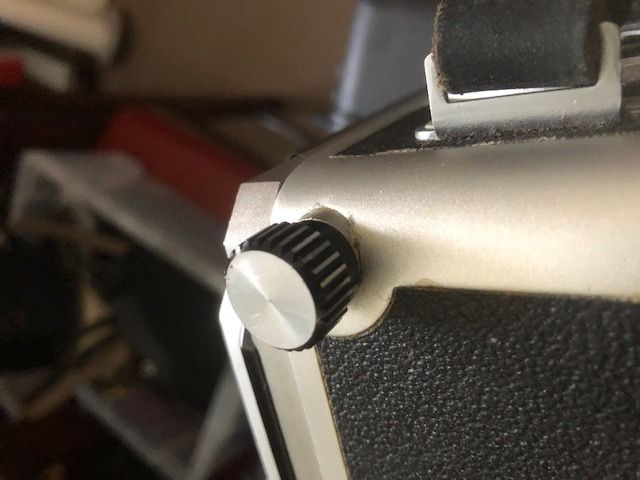

        I keep on seeing this term applied to mainly aluminium parts saying they have been "diamond turned"
        what does this mean?
        Mpp cameras have DT parts last made in 1988 so its not a new thing

                So going back to a simple MPP camera knob why would you use a diamond tipped tool rather than a normal tool?
                in the 60's to 80's

                  Posted by Ian Parkin on 02/03/2020 08:48:34:
                  in the 60's to 80's
                  To give that lovely multi-coloured reflection … perceived quality !
                  … Compare iridescent beetles, Compact Discs, etc.

                          It is possible that actually they are referring to an "engine turned" pattern on the knob in the shape of diamonds – what we could also call knurling. Such patterns can be produced on a "straight line" machine. A/k/a guilloche. Ian asks in the 4th post "why would you apply this to a simple camera knob" – well, to make it easier to grip!

                              Ian Parkin
                                @ianparkin39383
                                John H
                                the knobs in question were supplied as lengths pre knurled and then diamond turned
                                I was just surprised to learn such an expensive process on a lowly camera part

                                  But as Micheal G said you can see an iridescence in the top….would you not see that with any other type of cutter?

                                      Decorative "diamond turning" leaves the surface like a record and the grooves catch the light and give a holagram rainbow coloured effect as you move the item in the light. Common on some alloy car wheels etc. Not always cut with a diamond.
