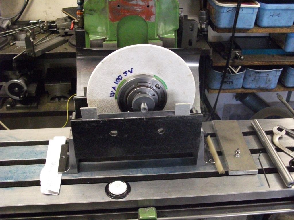

        Been doing a bit of surface grinding of late and although I'm fairly pleased with the results, I thought it could be better. I did some research, being a newcomer to grinding, to see how I could improve the "rippled" finish. It appears that the most likely cause is an unbalanced wheel, so, having slightly damaged the wheel supplied with the machine, I obtained a new Norton Abrasives one through RS Components. I tried balancing in my usual manner, that is, putting two 1-2-3 blocks on end on the mill vice and laying the balancing mandrel on the top. Inevitably, it tried to roll off! Long story short, I set to at the computer screen and drew up the balancing jig below in Atom 3D, using measurements that would enable me to build it with material I had in my scrap boxes. The vertical side pieces were machined and drilled while clamped together to help retain alignment and the ball bearings were ones bought as a job lot on eBay.
        Balancing fixture
        Finished it this morning and going to try it out this afternoon, after re-dressing the periphery. Luckily the wheel hubs are ones with three balance weights incorporated in the rear face.

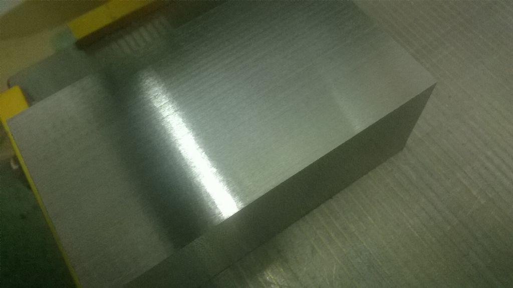

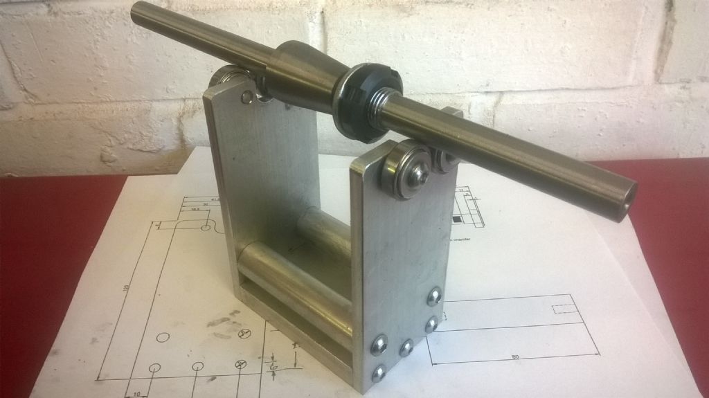

          Well, that was a bit of a failure and a bit of a success!
          Failure – the balancing jig didn't work as I expected. Either there's too much drag in the bearings and/or too much contact area between the bar and the bearing outer surface, or the wheels is perfectly balanced! It didn't move, no matter where the wheel was placed. I even taped a 10mm nut to the periphery of the wheel and it still wouldn't swing!. Back to the drawing board.
          I did, however make some improvements to the finish by altering my technique by dressing the wheel quite aggressively (I thought) and then taking the X-axis movement more slowly than before, making sure that each pass "sparked out".
          I'd really appreciate any further suggestions from those more experienced in surface grinding as to how I can further improve the finish.
          Here's what it looked like before my improved? technique:
          The photo quality is not the best as I only have an old smartphone, no dedicated camera, but I think the improvement, though slight, is distinguishable:
          Perhaps, on reflection, this ought to go in a separate thread, rather than clutter this one?
          Mods feel free to do that.

            John, try making some knife edged "tyres" that are pressed on to the bearings, that should reduce the friction. Also get any lubricant out of the bearings then put a tiny bit of WD40 (or similar) to lube the bearings.
            #474845
            HOWARDT
              @howardt
              John, as John MC said, make the rollers for the bar knife edge and larger in diameter with almost dry bearings. Balancers I have seen have rollers at least 75mm in diameter and rotate easily.
              #474851
              John P
                @johnp77052
                Here is what i made to do the same job ,this balancing frame made from
                pieces of old steel channel bolted together some slots milled in each side
                for some hardened pieces of gauge plate.Fitted on the machine and
                ground flat some pieces of aluminium at each end to stop the wheel rolling
                off ,three jacking screws to level the frame .The edges should be ground to
                knife edge but the balancing shaft is soft so i left them square.
                Simple and little to go wrong just have to keep the edges clean.

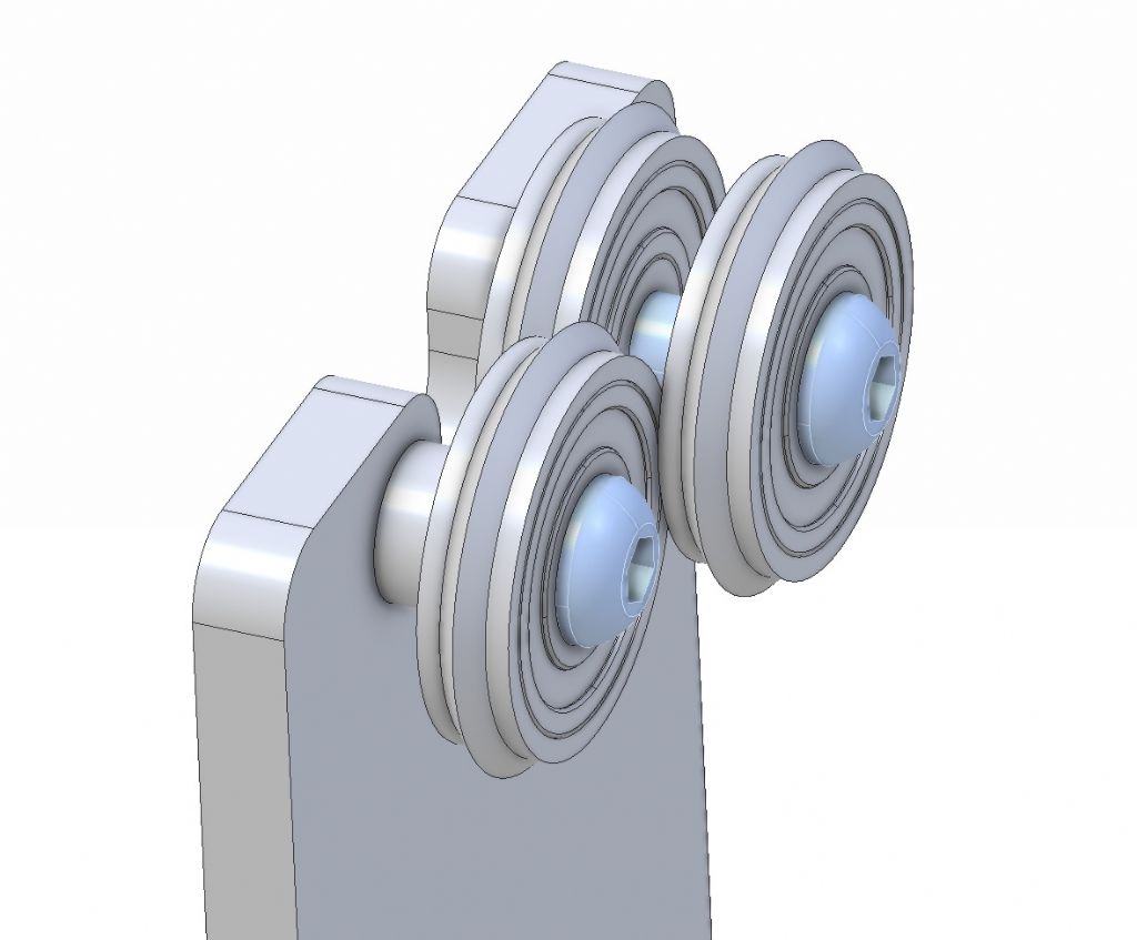

                  Thanks for the input, gents. I'd pretty much come to the same conclusion about the bearings. I'll try to make up some knife-edge tyres and see how that goes, but I fear I'll be severely restricted on diameter if I use the same bearings. It's not like I haven't got enough time, though, is it? I'll have a play with the CAD model to get some idea of how big I can go. Another thought has just occurred to me – I could doubleup the bearings with a spacer and run the other between to gain more space. Like this:
                  I'll let you know how I get on. (But not today.)
                  Thanks, again.
                  Edit:
                  John Pace:  Just seen your posting while I was away 3D-CADding.  That's the sort of thing I should have made, but didn't have the material required.  Something to bear in mind, though.  Thanks.

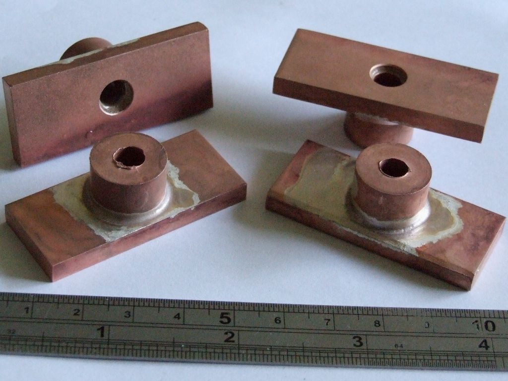

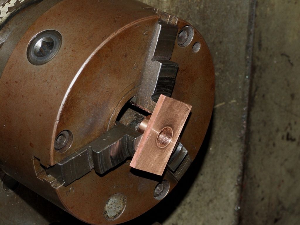

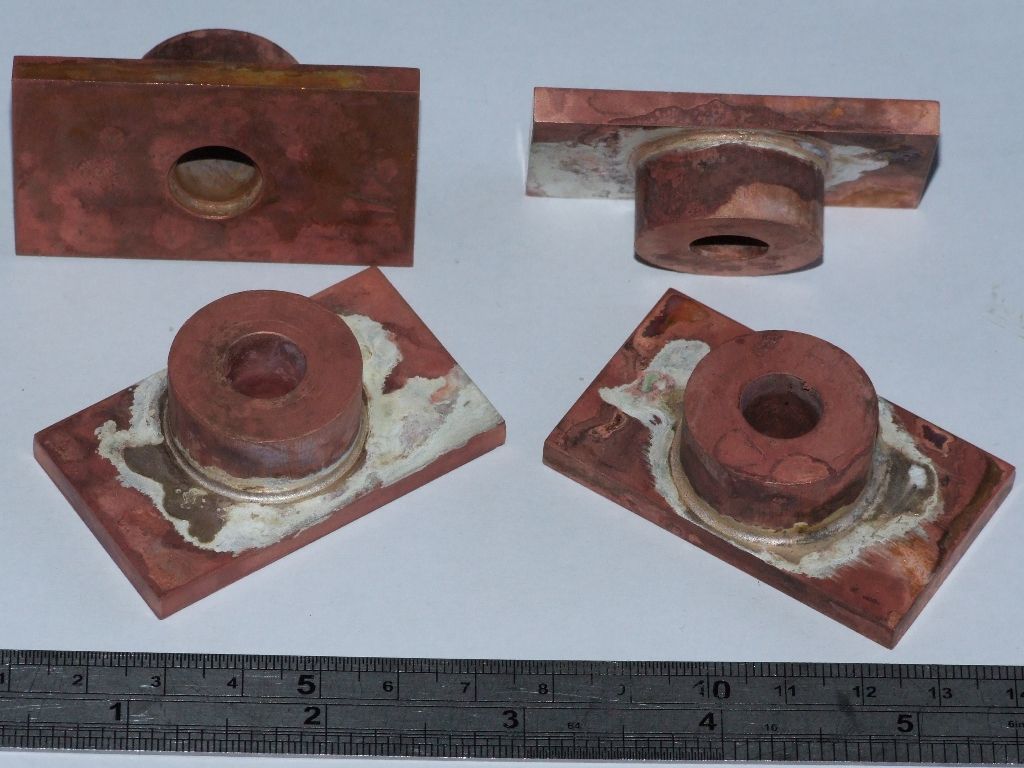

                      Woohoo! Did some silver soldering this afternoon, and it went waaaaaay better than it has done in the past:
                      They're a bit untidy but I hope to improve on that. I centre popped the bronze plate before assembly so that there would be a gap. In retrospect the gap was larger than it needed to be, which was wasteful of solder. Eventually these parts will become the piston rod glands on my traction engines. Before anyone points it out the boss is not centred on the plate. The final elliptical outline has one side cut off to clear the slidebars.

                        This afternoon I did some more silver soldering, on the valve rod glands:
                        This evening I started machining the previous silver soldered parts. The sequence will be:
                        In the 3-jaw chuck face one side of the flange and bore/ream the hole.
                        Use a split mandrel to machine the other side of the flange, bring the boss to thickness and to the correct diameter, using a micrometer. smile
                        On the mill centre on the hole and offset to drill the holes for the studs.
                        Finally mill the outside profile.

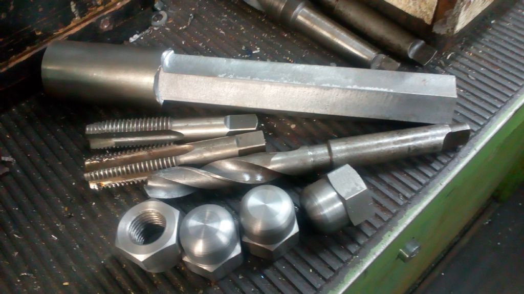

                            Some 1 inch x 8 TPI Whitworth dome nuts for the railway's S160s (US-made WW2 locomotives). I had to chop 2" steel round bar down to 37mm hexagon on the Bridgeport clone. I cheated a bit on tapping size with a 7/8" drill, which is 15 or 16 thou larger than nominal Zeus tapping size, but that'll make hardly any measurable difference to thread strength.
                            Tapping manually was still hard work. The taper tap was already reasonably sharp, but I had to visit the bench grinder with the plug. The drill was already sharp too – I don't know whether it was me that ground it, but it uses the same grind I was taught in the Government Training Centre in the 70s, with a thinned web and point. Started with a BS No.4 centre drill, I could go straight in with the 7/8" drill on the Colchester Student, and the hole measured .876", which is pretty good from the solid without a pilot hole. Fashions change, but I doubt a 4-facet or any of the new-fangled profiles would've made a significantly better job.
                            The dome form comes from a 9,5 rad (3/8" ) carbide router cutter with its shank clamped in a mild steel block in the toolpost. Neither I nor the railway have any bigger rads that I could find, and the loco fitter was quite happy with that. I do that bit, plus some prettying up, at home on the Warco. I've got 2 to finish at home, and will do the remaining 2 tomorrow or when I feel like it – 8 in total, for the fireboxes or something – the railway don't think they'll be running public trains till July.

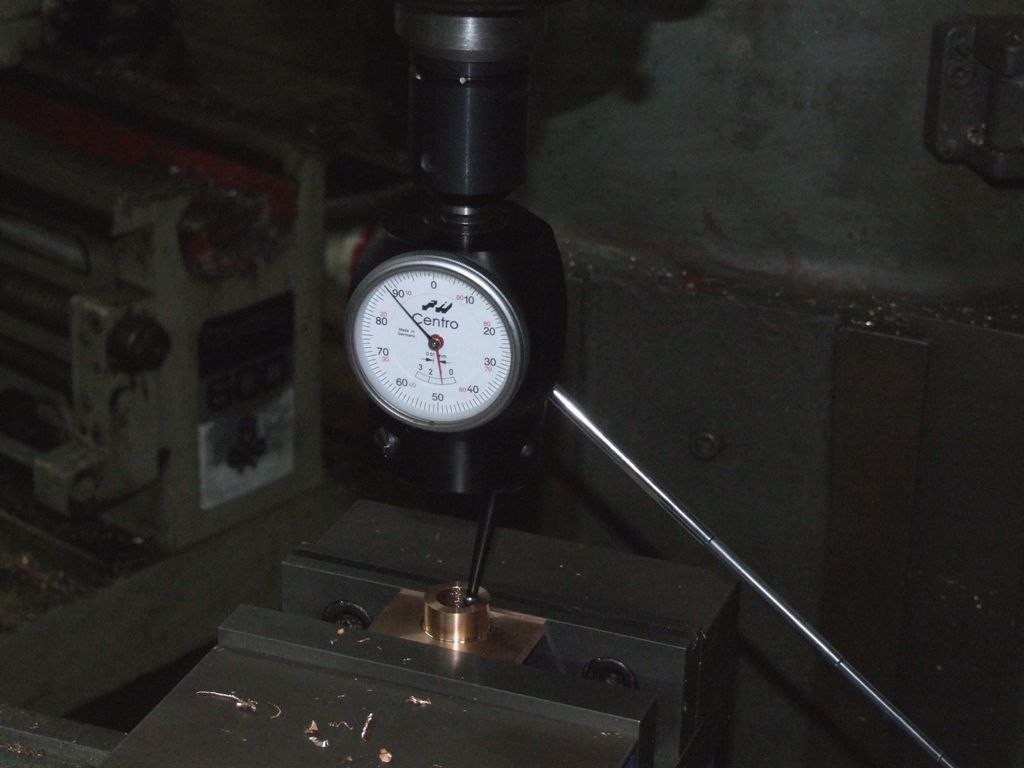

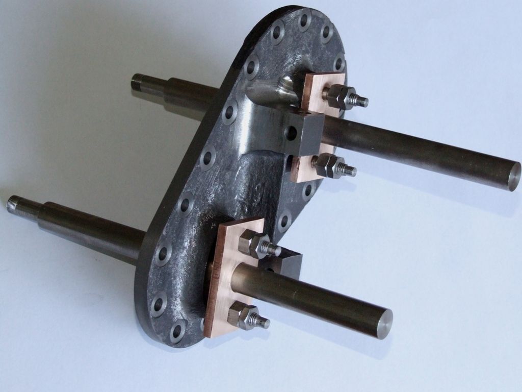

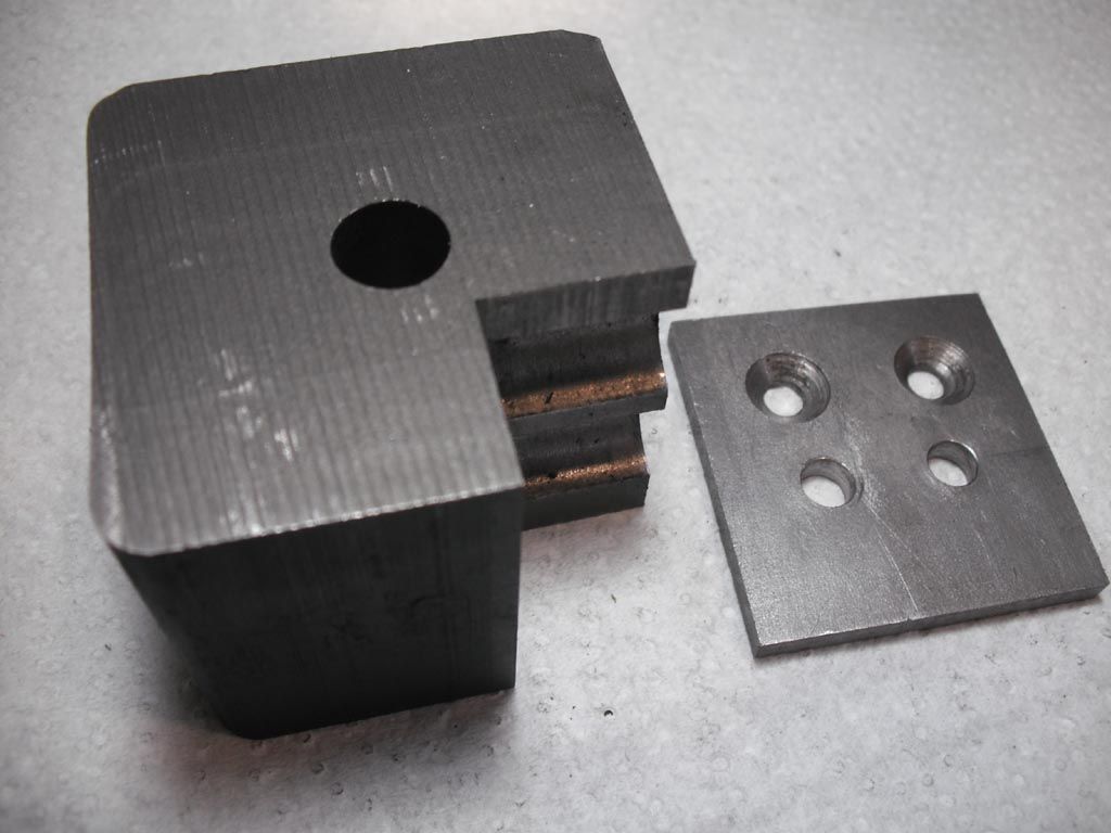

                                  I'm making progress on the piston rod glands, just the CNC profiling left to do. Given the recent post about inconsistent micrometer readings, and the dismissal of micrometers and comments on fitting, I thought I'd expand on how I machined the glands. First, the front face was cleaned up and the hole bored and reamed:
                                  Next, using a split bush, the boss was brought to the correct diameter and length and the back of the flange cleaned up. The width of the flange is not critical, so I didn't measure it but just took enough off to clean up the surface. The nominal width of the flange is 3/16" and the flange was made from 5mm plate so there's some meat to play with anyway. The length of the boss is also not critical so it was measured with a rule.
                                  For the diameter of the boss I first measured the recess in the cylinder cover. The recesses were 'bored' out with a 7/8" endmill but have come out a bit oversize, measured as 0.892". I turned the boss to 0.891" using a micrometer and the lathe cross slide dial, with the number noted. A sanity check with the cylinder cover confirmed that the boss fitted with slight play, as I wanted. The bosses on the remaining three glands were turned to the same diameter using the same cross slide dial number, and sanity checked with the micrometer. All four bosses are within a thou of each other with no great effort on my part, other than remembering a number.
                                  Finally the centre of each hole in the boss was picked up on the vertical mill and holes for the studs drilled using the DRO to position them relative to the central hole:
                                  The holes for the 1/4" studs were drilled 6.5mm. So in theory there should be 3 thou radial clearance, although bronze has a nasty habit of closing up slightly on drilled/reamed holes. Here's the cylinder cover and glands assembled:
                                  All glands fit in each location with the piston rod running smoothly in all cases. So basically the glands are interchangeable and I don't need to mark each one for a specific location.
                                  It took longer to write about than do. My point is that with some thought and proper measurements it is possible to make parts that fit without each part being specific to one location or needing post-machining fitting. Which is good for a lazy bones like me.

                                    Andrew,
                                    Good method, just as an example though to save machining a fixture / bush and with my blanks being castings I held them on the flange in the 4 jaw, machined the back face of the flange and the boss and drilled / reamed the holes to have everything concentric at one setting and then held the machined boss in the three jaw to skim the front, just another different way of doing it for the same result.
                                    The important bit of your post though was the measuring and the decision process. I can just imagine some on here when considering previous discussions on measurement and micron accuracy will have palpitations reading you didn't measure the flange thickness and machined the boss length to a rule! The fundamental thing to take from your post is the step where you consider which dimensions are important and require reasonably close tolerance and those that are really unimportant in the great scheme of things. Also the choice of machining operations and work holding to make sure the parts that need to be concentric are.
                                    It amuses me greatly reading some posts where the underlying importance of having a tolerance and what that tolerance should reasonably be is lost under a fixation of making something exactly to a size shown on a "drawing". If you took most model drawings to a machine shop to have a part made they would likely show you the door or at least have a detailed discussion on what the intended outcome is and agree some tolerances to be applied. Take for example a weighshaft bush and weighshaft, on a 'normal' set of commercial drawings the shaft and the hole in the bush will be dimensioned as exactly the same size – clearly if manufactured as such you will not end up with the intended fit! Thus with model "drawings" the maker needs to consider the intended result, decide which dimensions need close tolerances applied and which are of no real consequence.

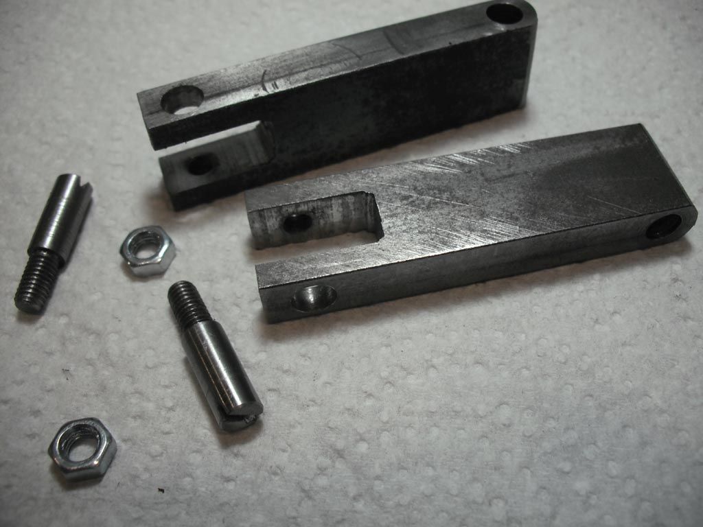

                                    Anthony Knights
                                      @anthonyknights16741

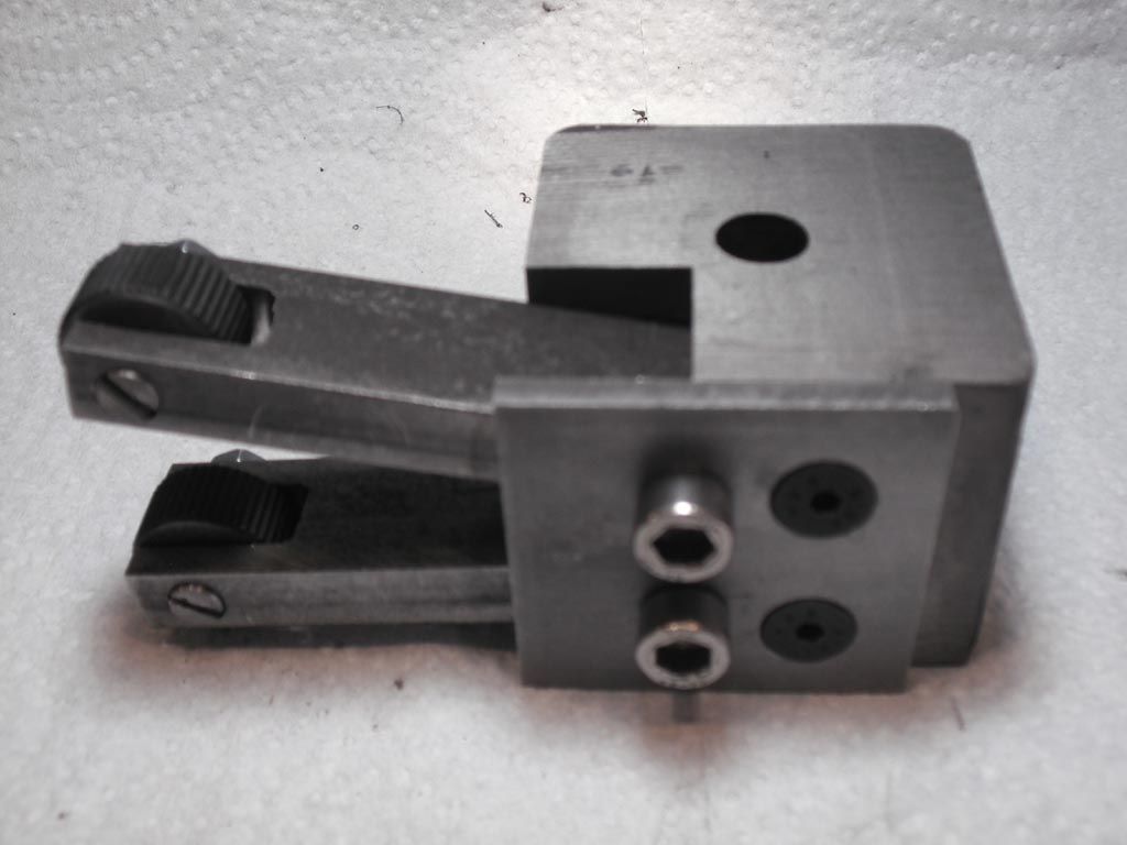

                                      I have had these for a few years. In fact I think I bought them at the last Harrogate Show. I have finally decided to do something with them.wheels.jpg
                                      I made some arms and retaining pins/axles. I decided to make them removable (unlike my bought one) so I can change the wheels if needed and also replace the pins if they become worn.
                                      Assembled them to see if they fit properly.
                                      I decided to make a Quick Change Tool POST to fit them to. No flimsy, hanging in the air gadgets for me.
                                      Trial fit looking good. Just need to make the clamping assembly now.
