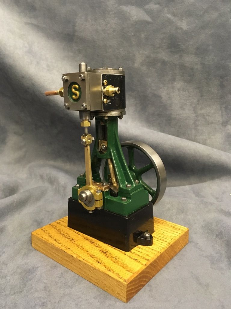

    Oxymoron
      @oxymoron

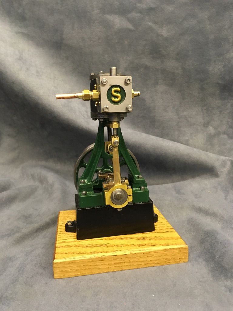

      Finally complete my first engine. It's far from brilliant, learnt loads whilst building it, especially about machining sequences and checking the plans are right before drilling holes. But it RUNS
      And hopefully Ive worked out how to post photos. Now a video is the next challenge!

        You should be very proud of yourself with that, Dave, well done!

            Thanks Brian, yes, very pleased its a runner but feel could have done better. On to another project I think.

              Well done Dave; always a nice beginners engine, always gives you that 'chuffed' feeling when it runs for the first time.

                Well done Dave – making a 10V truly is a rite of passage.

                  Well Dave, a runner is a runner, and it looks terrific. You have achieved something many others have not. I'm sure you have learned all manner of new skills and improved others you had already. Great job! Onward and upward.

                      Oxy, well done! it looks great and has inspired me to make some time to get on with mine, also my first go at an engine. If it turns out as well as yours I'll be a very happy bunny!

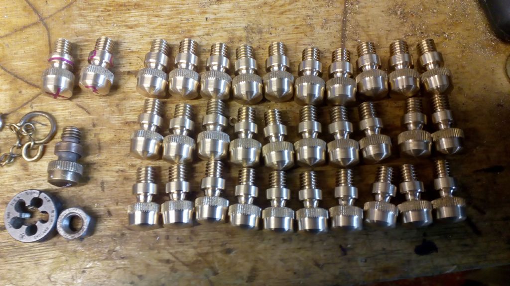

                                  Nice 10V Oxymoron! smile
                                  If built to drawing, running it fast exposes the lack of counterbalance to the crank, and it's hard to find a solution that justifies pulling it to bits again.
                                  I just delivered 30-off carriage window sash locks to the local steam railway, for whom I do volunteer machining. This has made me think more seriously about getting a QCTP, because the 4-way on my WM250V can only really take 2 tools of normal length. I could use a single tool to turn the parallel and thread diameters and do the undercut behind the thread, but was still left with the knurl, the radius undercut for the chain hook, and the the domed end on the 2nd op after parting, and the changes inside the cycle got a bit tedious.
                                  A small capstan would've come in 'andy…

                                    Mick B1… nice bit of batch production there.

                                      Mick, nice work, a small cnc lathe would be a simple solution,

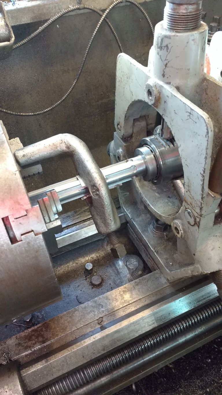

                                        A few years ago i was given most of a horizontal mill, I have the space for it so rather than see it go to the scrappy I gave it a home. The intention was to convert it in to a surface grinder, but after some thought a second mill would be far more useful, particularly a another vertical.
                                        Eventually I acquired a suitable head to adapt to fit the machine, specifically one from a Chinese lathe/mill. This had a 3MT taper, I need 4MT so the tooling is interchangeable with the other mill, so made a new spindle with a 4MT.
                                        But how to get the taper running absolutely true? I've done this in the past by finishing the taper on the mill by angling the head over at the right angle with a boring bar clamped vertical on the table , that is to say finishing the spindle off its own bearings.
                                        Problem is that the head does not have the tilting facility. The attached photos show how I did the job. I borrowed a second fixed stead so I could "clamp" the quill to the lathe bed and used a cranked carrier to drive the spindle, (from a chuck jaw). I was pleasantly surprised at the rigidity of the setup.

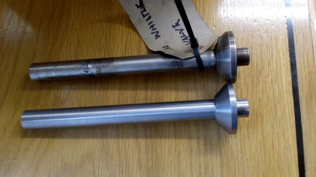

                                            Mick B1
                                              @mickb1
                                              Made a new whistle spindle for the S160s – big WW2 American locos, of which our railway has 2.
                                              There were 2 questions I had to ask the top loco fitter – was the 13 thou back taper on the shaft of the original meant to be there? and is that approx. 1" spherical radius on the valve seat surface critical, or can I just offhand-grind a form tool and finish with emery wet-and-dry?
                                              Answers were that the taper's spurious, so I turned it parallel within about a thou, and the seat's supposed to be a 45 degree cone, so that's what I did. They'll soon let me know if there's an issue – but I've seen that loco fitter practically rebuild one of the S160s, and he's in the middle of an 8F now, so I'll not be arguing with him! smiley
                                              I can hear the S160s whistle from my house on a quiet day, so it'll be nice to hear it work as and when it's fitted.

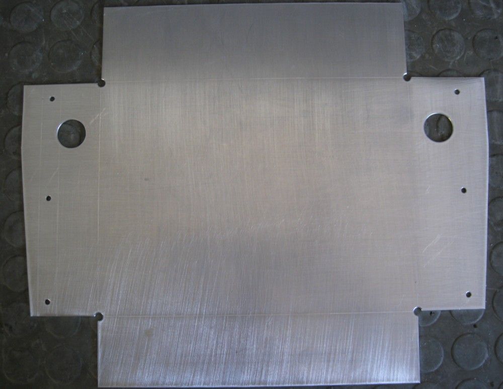

                                                    Had to make a new housing for it – the last ( nice) plastic box was all used up and I could not find more..
                                                    Ready to bend..

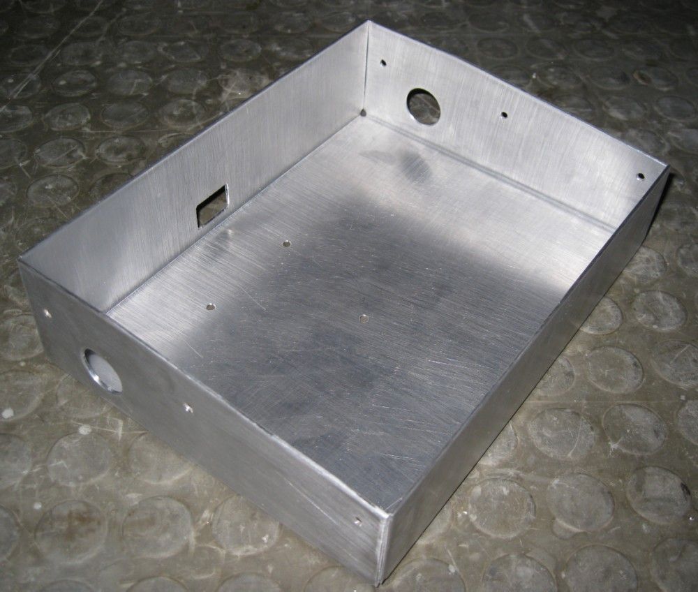

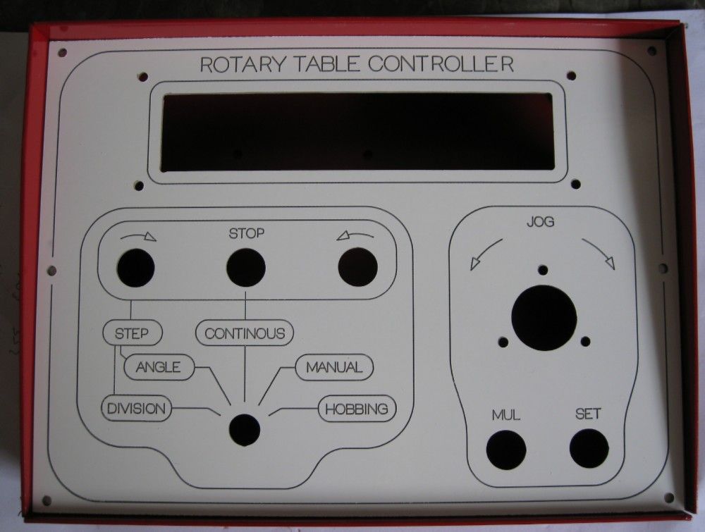

                                                    And the new front panel engraved and routed.

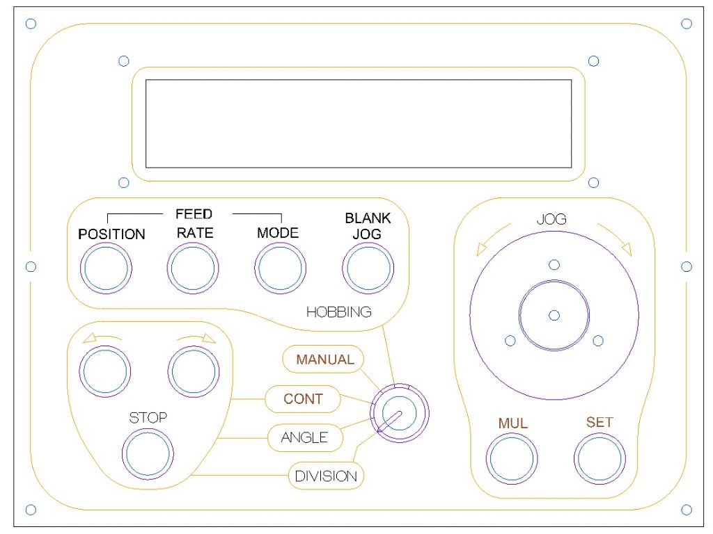

                                                    Paul White ( also a fellow forummer) iis going to built one as well, but with some added features – he has two rotary tables , one small, one large, with different gear ratios, and a gear hobber with yet a different gear ratio and autofeed on the hob.
                                                    Also a few more controls..
                                                    So Paul's panel functions are so:

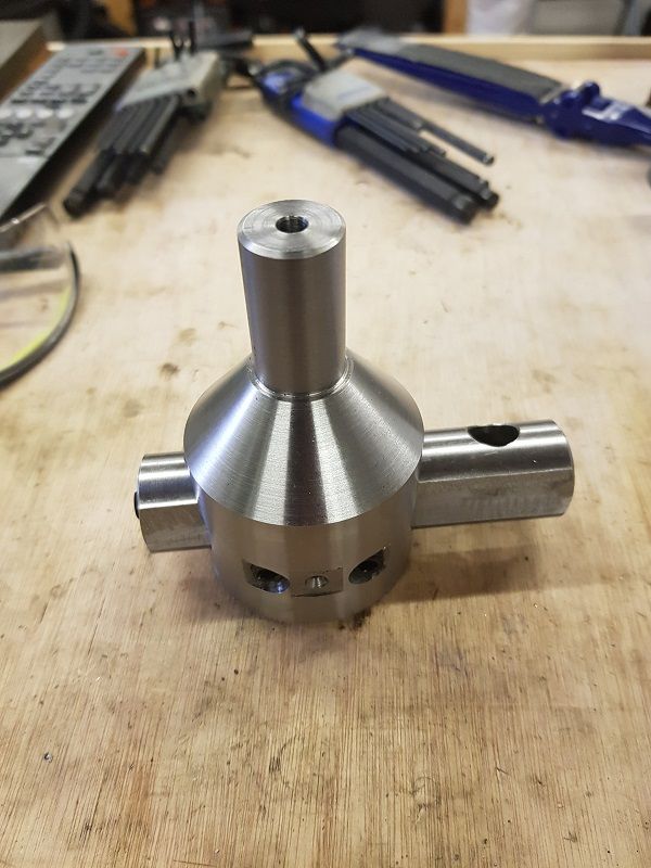

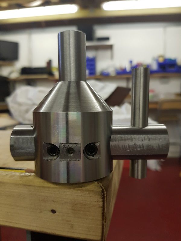

                                                    Ian McVickers
                                                      @ianmcvickers56553

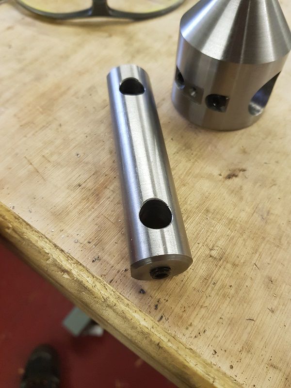

                                                      Decided that I needed a more robust fly cutter so dug out a bit of round bar and got to work. Ended up with a decent looking fly cutter which fits into a 19mm collet. The cross bar is 25mm diameter and drilled to accept a 12mm Hss bar. Now I need to learn to grind the Hss bit correctly and get some test cuts done.
