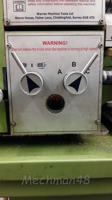

          Spent a couple of hrs modifying the gear change handles on my WM250V-F, have had the idea from seeing the handles on the 280 / 290V-F handles some time back & put it on my 2duit list… today was the day 2duit. Carefully removed the roll pins from each handle as there were a double ball set up for the detents ( I quickly found out ) whereas the manual shows only 1 ball bearing in ea. knob so be careful if you decide to do this mod. Had to remove the drive / change wheel guard from the headstock to allow better access to the forward/reverse knob roll pin. Once the feed rate knob was removed it was drilled / tapped 5mm for a depth of 8mm at an appropriate distance from the edge, in my case 6 mm ( this is arbitrary ) a 6mm silver steel rod was machined & threaded 5mm to fit, then Loctited in & the knob replaced. The same procedure applies to the feed rate knob, ending up with a much easier manipulation of either knob with this mod.

            Rather glad you followed the instructions on the panel – and stopped, or at least only removed the knobs while the machine was running slowly!smiley

              face 20 … difficulty in translating… Google doesn't have Chinglish in its repertoire.

                That's a very interesting mod. I have an old WM250 (Circa 2005) with the same gearbox and find the knobs quite hard to use at times. Also the pointed arrows on the ABC knob on mine dosn't line up very well.
                A couple of weeks ago I decided to change the gearbox oil after looking at a thread by Journeyman. Since the drain plug is no where near the bottom of the gearbox you have to take the front cover of the gearbox off. Fortunately you dont have to remove the knobs which remain fitted to the front cover with the detent mechanism. I was thinking of taking the knobs off, but as you said, they have roll pins and I could not see any easy of moving them round just a bit.
                The oil was like thick brown treacle! Managed to clean up the oil sight glass, which is a push fit with an o-ring, which had become so dis-coloured that you couldn't see the oil level. The gearbox had also been leaking for a long time making a horrid sticky mess in the splash tray. After a good clean up it went back together quite easily with some silicone gasket and ptfe tape on the drain and filler plugs. I have still got a small leak from the sight glass however. Would have liked to replace the O-ring but didn't have one the right size to hand. You know how it is, you have a great big box full of O-rings but never one in the size you want!! In hind sight I should have put a smear of silicone around it.
                To get at the gearbox front cover screws you remove the four small hex headed screws and the alloy front cover lifts off over the knobs. The four deep holes allow access to the screws that fix the gearbox to the headstock, so don't touch those!!.

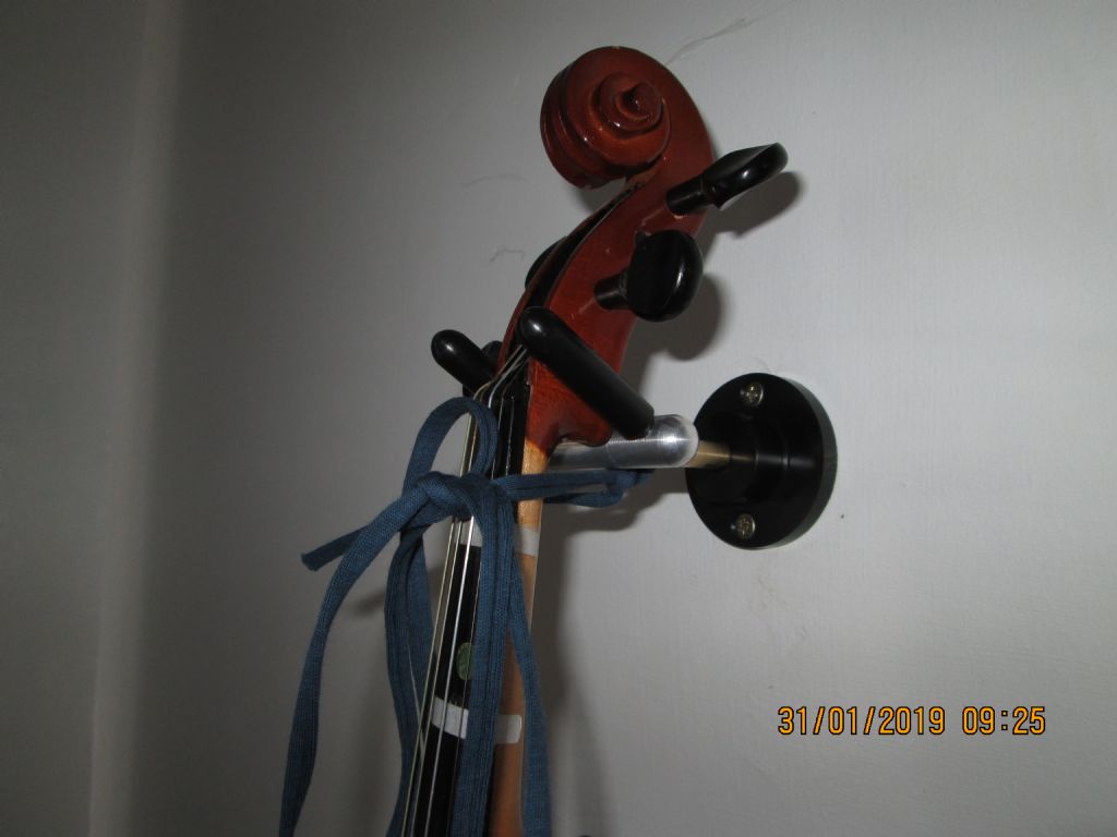

                      Carol's got a 1/4 size violin to teach the grandkids, and wanted a hook for the boxroom/cello room wall, so I made this outa Delrin, brass and alli offcuts I had lying about, all done on the WM250V.Violin Hook 2

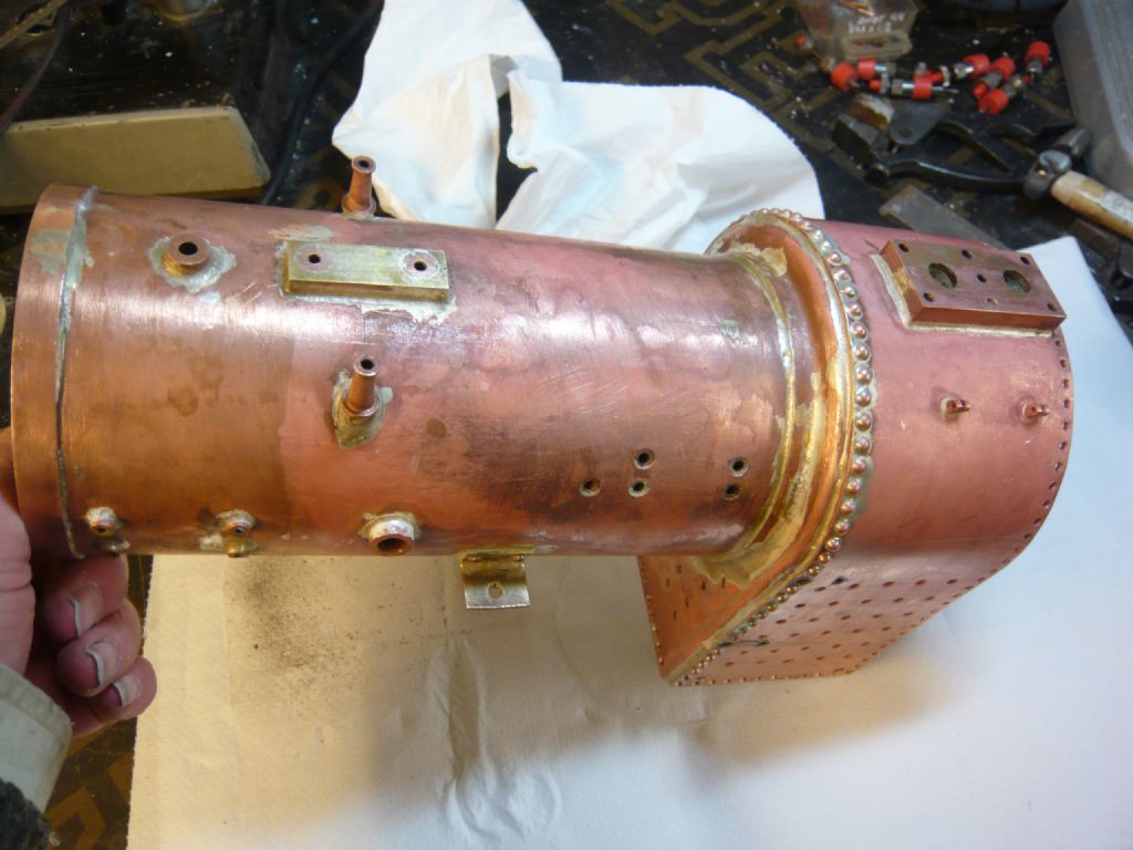

                                              As promised (or threatened! earlier) here are some pictures of the boiler for my Burrell-Boydell engine being assembled.

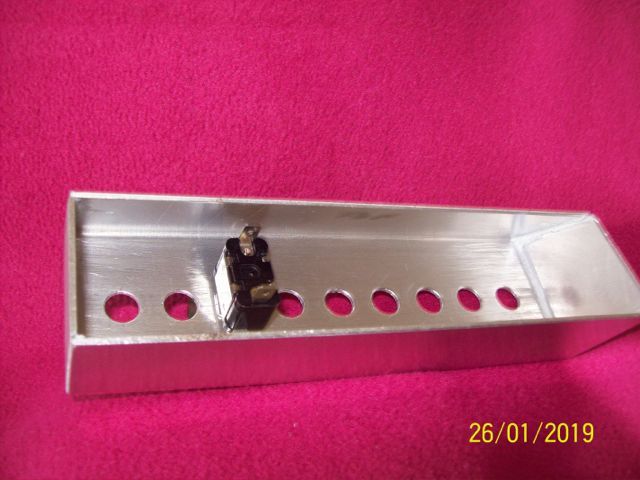

                                                    Just posted off a brazed aluminium switchbox for a client who wants an additional NINE lightswitches mounted on the dash of his Landrover !! It was my first time using this brazing process, and I must say I was mightily pleased with the ease of use and the results. The box is 205mm long, 65mm on the switch face, and approx. 50mm deep. Material is 2mm L.A. sheet. As you can see, one bend is acute, and one slightly obtuse …

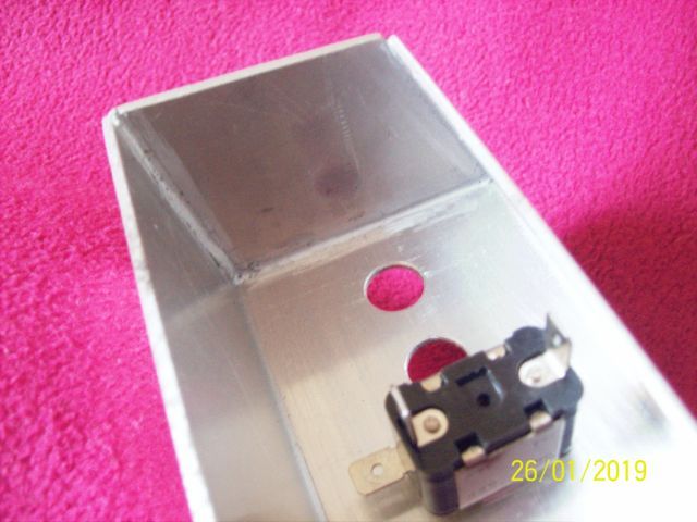

                                                    The switch holes were punched with a home-made screw type punch and die set before folding ( the above photo is of a trial piece ). Endplates were cut to fit neatly inside, and were then brazed internally …
                                                    and externally too. External beads were dressed down and showed good penetration ….

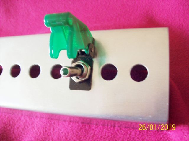

                                                    Here are a couple of views of the finished box, complete with sample switch, safety cover up ……
                                                    Result !! I'll certainly be using this brazing process again.

                                                      Hi ken, can you give us a bit more info on Aluminium brazing, the filler, the torch and what thickness was the metal, did you use any bricks etc.
