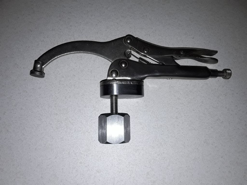

        I've had one of these table clamps on my drilling table for some years now and a very useful feature it is for securing jobs whilst drilling.
        Sometimes the arm is too short to reach the job that requires holding, so I bought the next size up which has a longer arm. Unfortunately this one is secured to the table with a 12mm stud and the slots in the drill table are only 3/8", nevermind I think I'll make a smaller stud to suit. After more closely examining the way the stud is attached to the clamp assembly I concluded it was a lot easier to cut the stud off and make a new sub base with a smaller stud screwed into it. This is the result of an afternoon's work delving in the scrap boxes, I know it will never win any prizes but it now does what I want and to my mind that's all that matters in this instance.
        By the way if anyone is wondering what the ropes are at the back of the table, they are part of a crude and simple counterbalance to offset the weight of the table when raising and lowering it.
        Phil

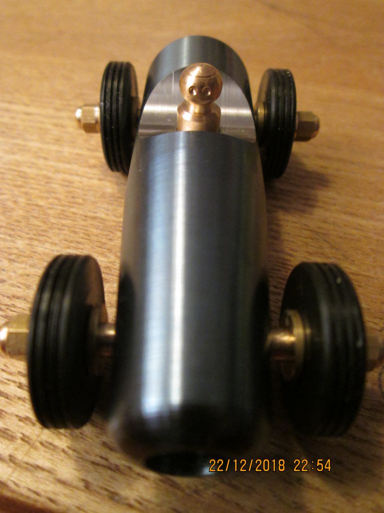

                  Not today, but 4 days back … finished this little racer to go with the 3-year-old grandkid's little garage set. It's titanium, brass and delrin, 22mm track by 67 long.
                  #387733
                    What a lucky 3-year-old !!
                    Nice job, Mick yes

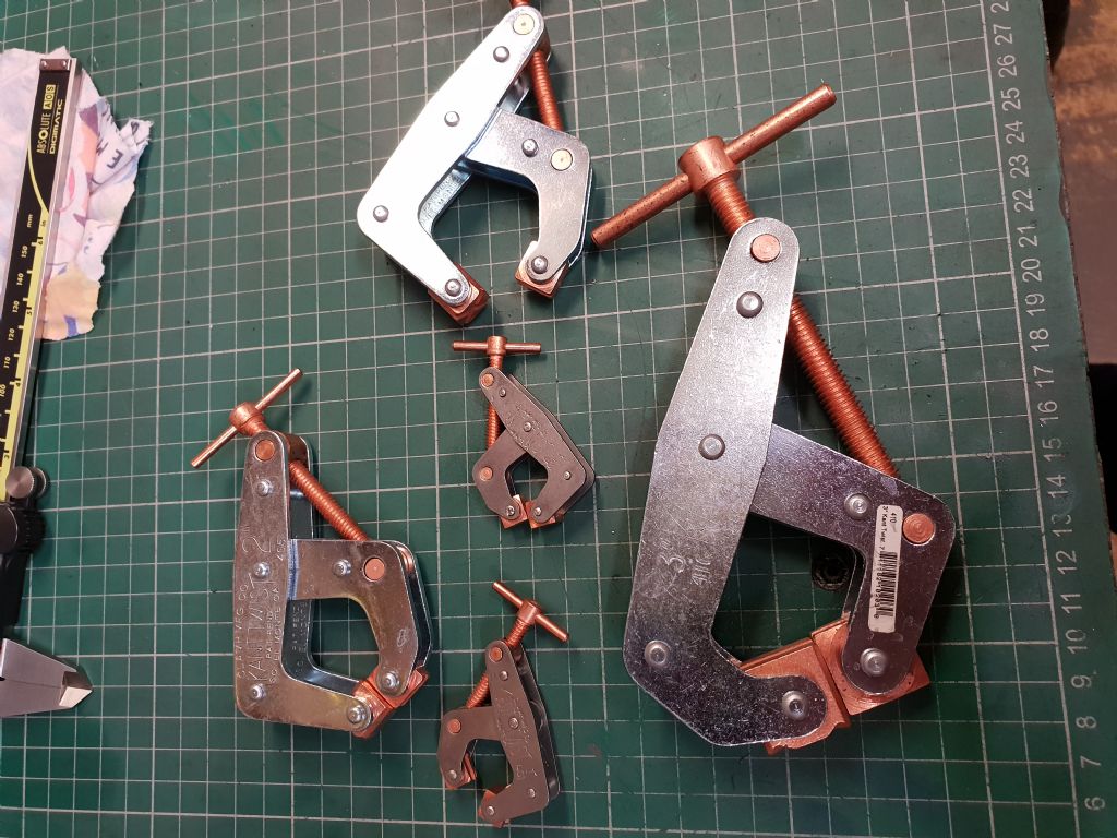

                                    Treated myself to some new clamps!
                                    These are the first set of Kant Twist clamps I've had. Just like the look of them!
                                    Jim

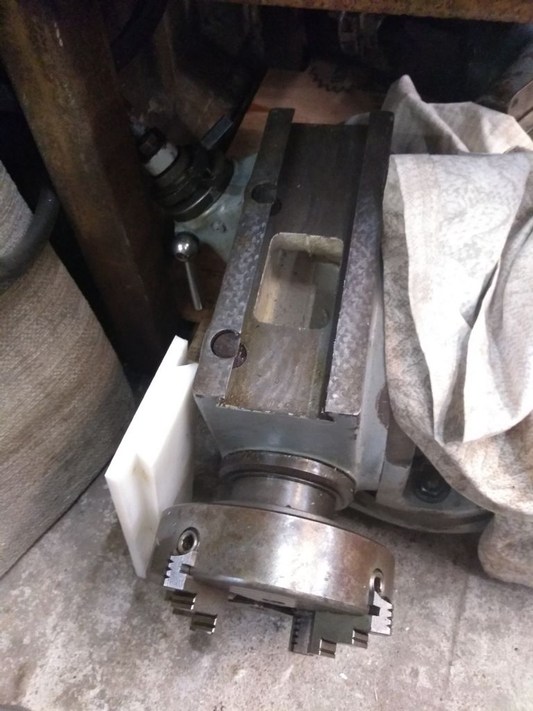

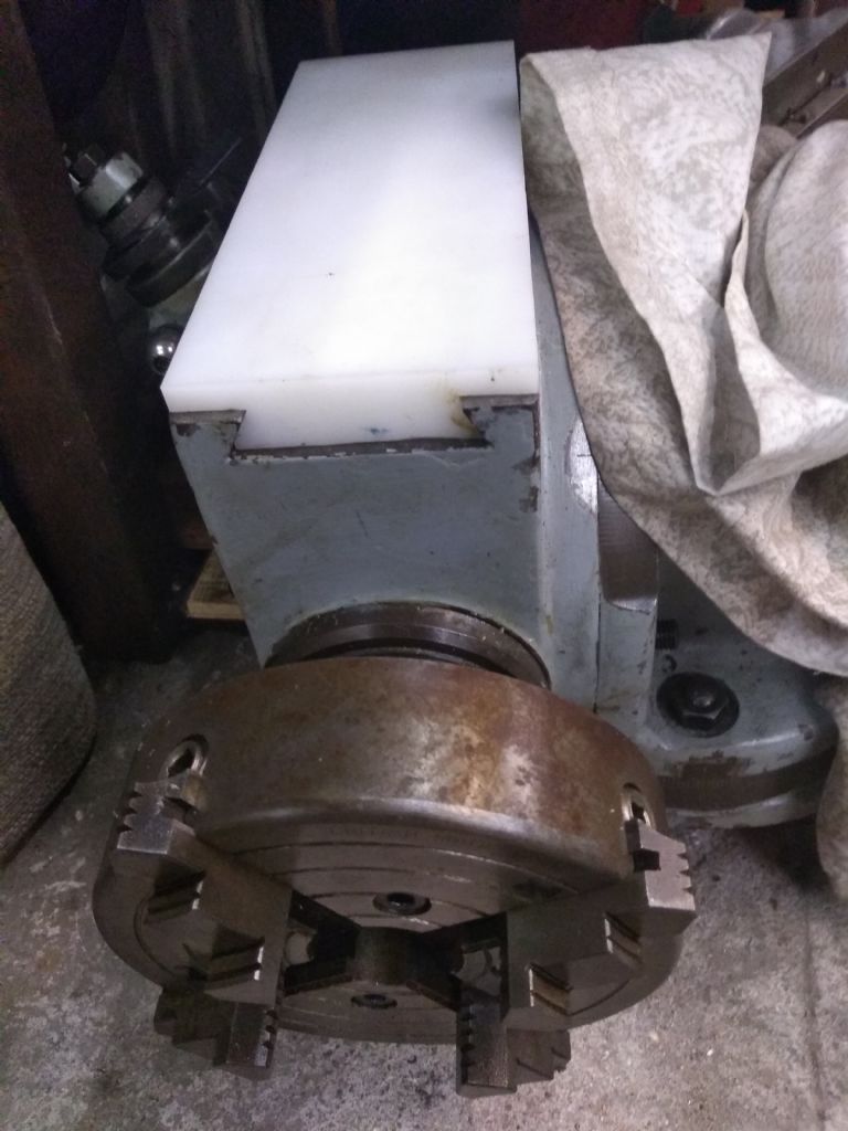

                                        Made a missing Dove tail cover for my George Alexander Master Toolmaker dividing head.
                                        Happy New Year!!

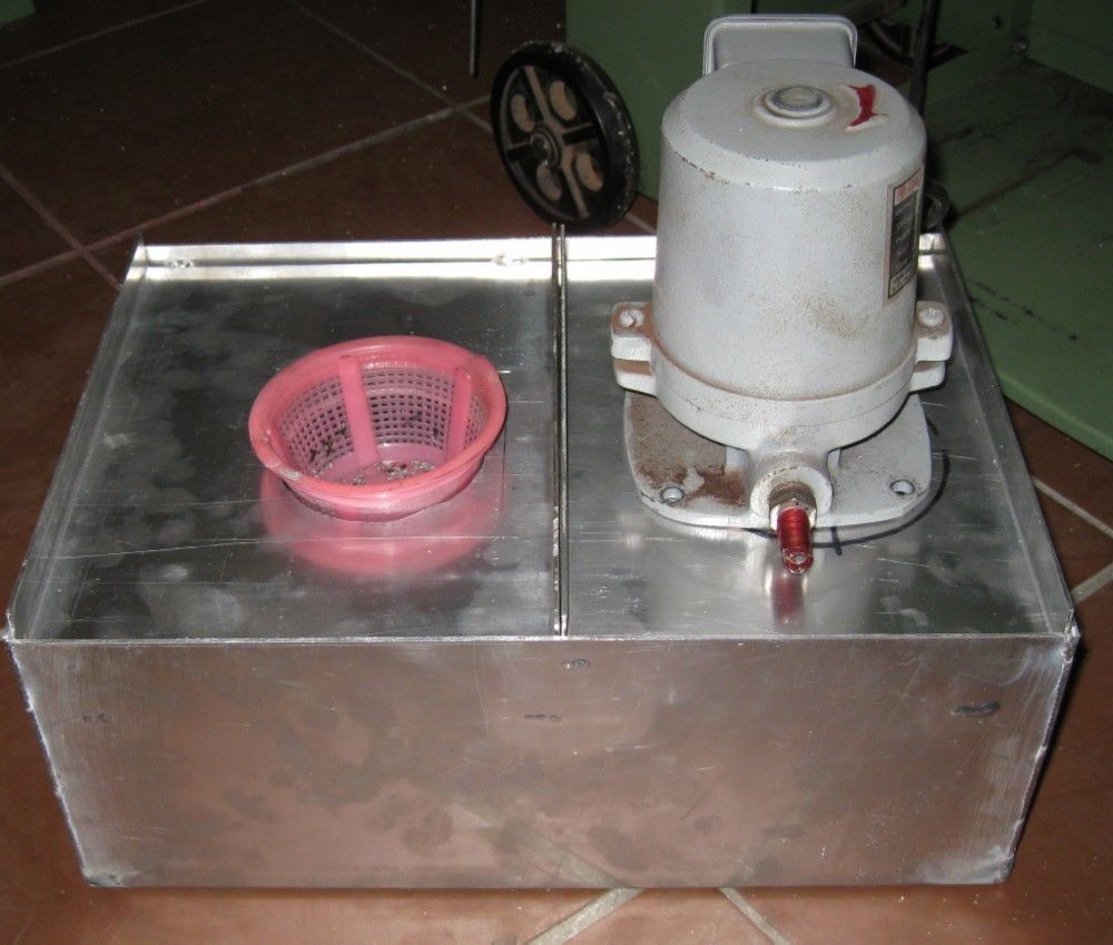

                                          Made a new coolant tank to replace the miserable plastic 'generic' tank that had perished cracked and leaked all over the floor for far to long..
                                          Pump mounting cracked right out of the tank!
                                          Corner cracked and leaked out…
                                          Ali Fabricated tank.
                                          Becoming good at TIG welding Aluminium..
                                          Joe
