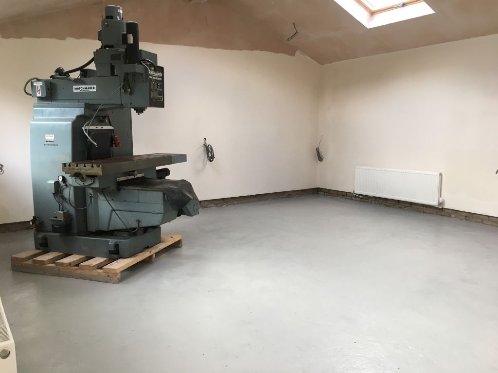

                  Sealed the floor yesterday using oil-based polyurethane sealer (looks like French onion soup without the cheese), then this morning I applied the gray polyurethane paint (also oil based). That followed hours of sweeping and vacuuming Thursday – Friday to get most of the dust off the floor. I even used the Miele HEPA vacuum with carpet beater head (wife was at work!). The place stinks of white spirit but I've managed to keep most of it out of the house by ensuring good ventilation and taping up the connecting door with masking tape.
                  Floor painted
                  I'll leave it to its devices until Monday or later, then the acid test will come when I go about moving the equipment back through. Although my engine crane has rubber wheels, the Bridgeport clone weighs 1000kg. If it starts to lift, I won't be enormously happy. Have to say, I'm not overly impressed by the concreting. Although it was mixed by pukka machinery outside the house and raked in by experienced concreters(?), the result isn't an exhibition example of concrete technology.
                  Back into the house in the meantime while the stink prevails, doing the second fit electrical and plumbing. Damned fiddly in places. I've lashed up a 110V CTE site transformer to power up the garage consumer unit. That allows me to power up the wiring without killing everybody and use a volt stick, as much of the first fix wiring is unmarked. The MCBs and RCDs should function properly in this mode but I'm not planning on finding out accidentally.
                  Still to resolve the toilet soil pipe. The cunning stunt with the bendy pipe didn't work out, as it isn't bendy enough and will be going back to Toolstation. Back to plan B ie the tight solvent bend if I can locate one nearby. We'll be OK unless somebody lays a cable in the new karzi in the meantime….

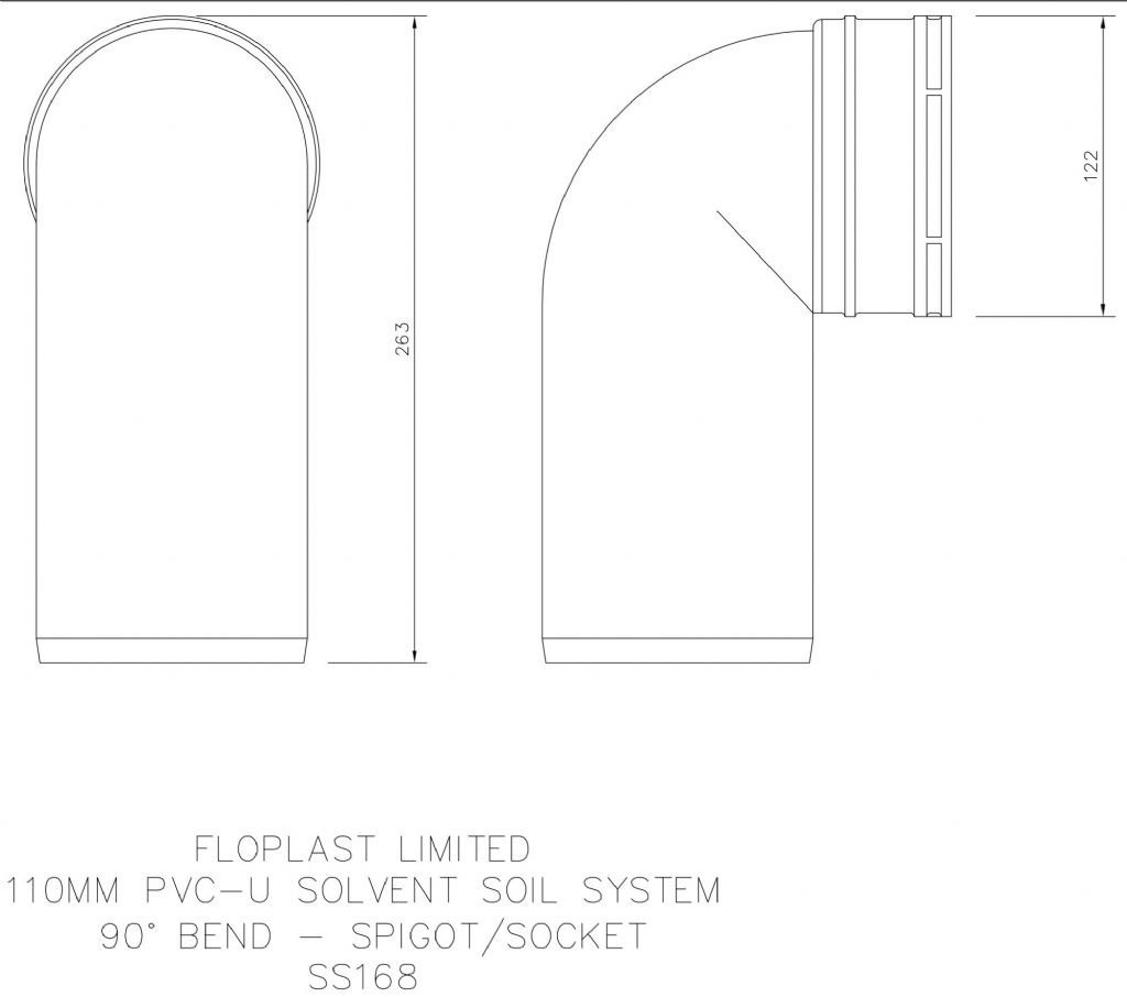

                                  The problem is that it's a nice red brick wall in full view of the rest of the house, so butchering it isn't the ideal solution, otherwise I'd have taken an SDS chisel to it a long time ago. Given that most core drills around this size are a nominal 120mm (and given that the hole was already made at great effort and can't easily / tidily be increased), the flange of most push fit couplings won't fit into the hole. On the other hand, solvent weld flanges will fit into the hole.
                                  Here's a "CAD drawing"(??) from Floplast (actually little more than a basic Autocad line drawing), showing a typical solvent weld bend. This will fit the bill, as I will be able to get the flange into the hole in the wall.
                                  From a building control POV, you have either need an access cover on the bend, a dismountable push fit connection, some other means of rodding – or accept that the coupling will have to be replaced if access is required. In this instance, the indoor side is easily accessible (remove the toilet connector) and there is a gully immediately adjacent. Not ideal but the alternative would be to lift the blockwork and start excavating the pipework. As I said, I have a life to live and swarf to make, so we can forget that idea.
                                  As you say, Alan, it's not unusual to have the soil stack close to the wall. Often the toilet connection hits the stack from the side, some way from the exit – giving you an inch or two to accommodate the bend flange either inside or outside the wall.
                                  Murray

                                                      Regarding soil stack ventilation, you don't need a vent on every stack. I already have one vented stack (out of a total of three) on the same sewer and that is considered adequate.
                                                      I would suspect / hope a power float would achieve a better finish than what I have. Note that some of the advice warns against certain types of paint on power floated concrete, presumably because the surface finish is much better.
                                                      There's a lot of info at buyfloorpaints on floor prep and the various paint types. Incidentally, they advise against oil based polyurethane floor paint so I won't go crying to them if my floor is a flop. I bought my paint from paintmaster. Good price but the website is pretty light on advice.
                                                      I can't imagine many floor paints are going to stand up to heavily loaded cast iron wheels. I'd suggest getting onto ebay or Aliexpress and finding some rubber faced wheels to replace the originals. As well as making them more easy going on the paint, they will be easier to move smoothly, assuming you don't have any vast chasms to negotiate.
