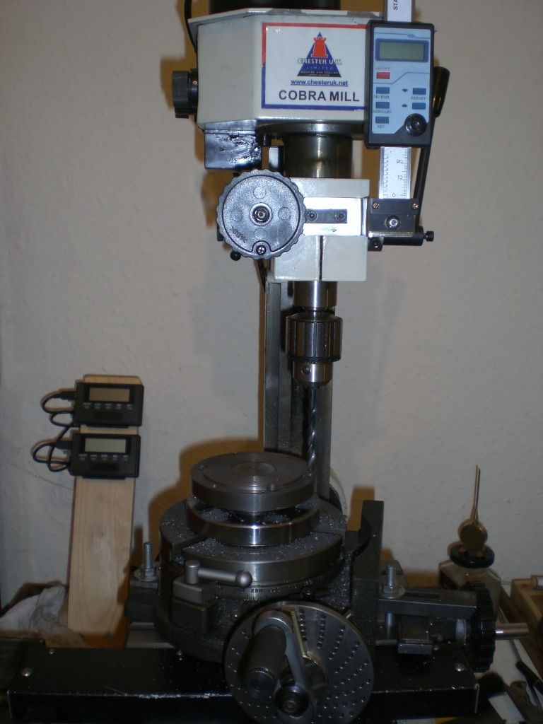

      Hi, did this yesterday.
      This is my 6" Vertex RT on my Cobra mill, with a Boxford backplate chuck adapter and index attachment, drilling the bolt holes in a Boxford backplate, to fit a 100mm TOS three jaw chuck. Had about 12mm of spare headroom on the mill head.

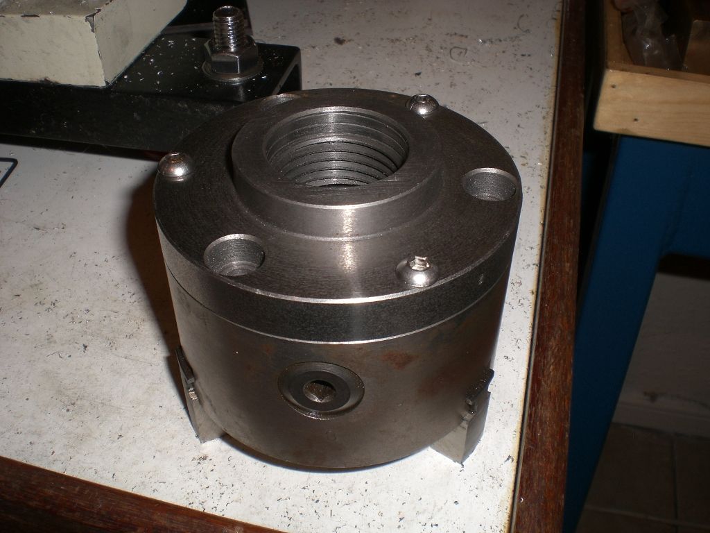

      Backplate fitted to chuck. Just need to fit some rubber plugs or something similar, into the original Boxford chuck fixing holes, to stop swaf, dirt etc. ingress between the backplate and the chuck.

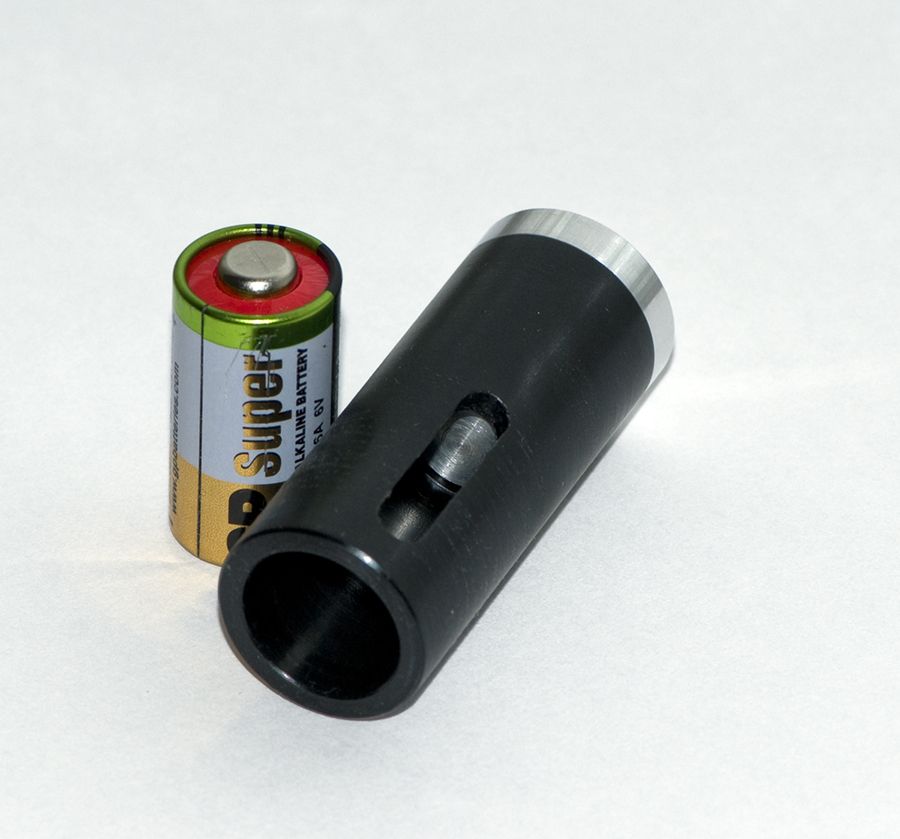

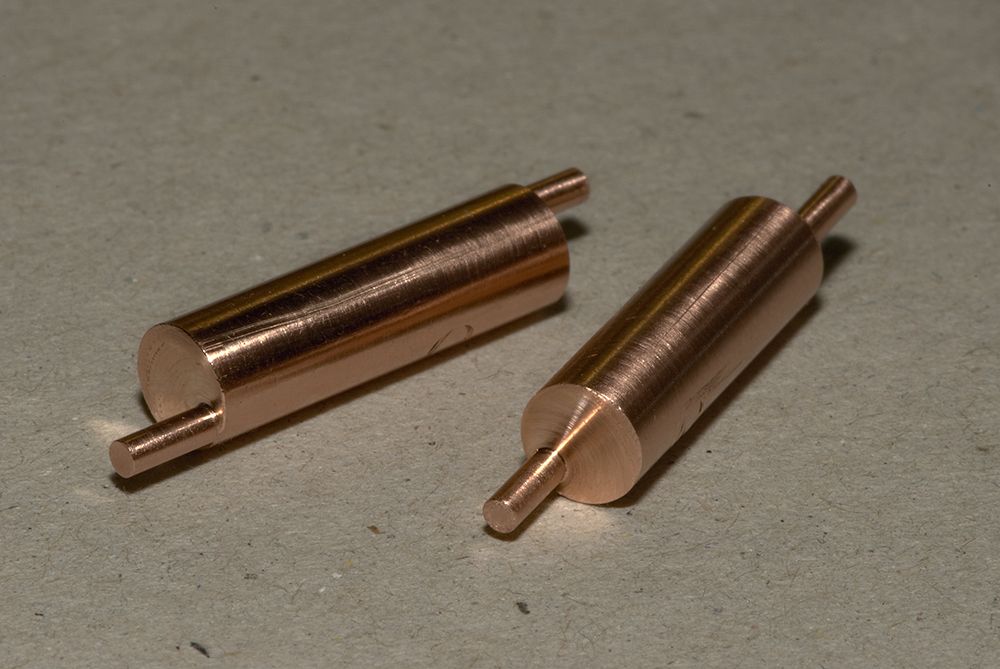

                  Did a small job today on the WM180 lathe (Saturday). Turned a couple of electrodes for a benchtop spot welder at work, using a very basic eccentric clamp in the 3-jaw chuck. These are 6.0mm dia copper bar with 5.0mm x 1.75mm dia tips. This is the second time I've sharpened these 'pencils'. Strange stuff to turn is copper!

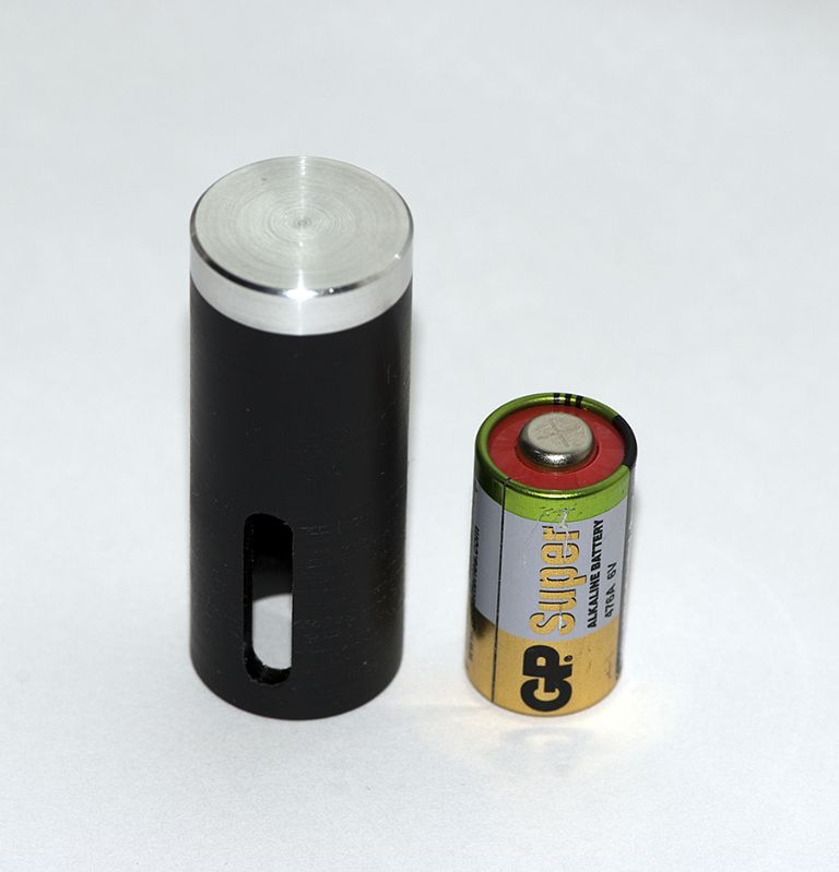

                  …and a few days ago made a battery adaptor for an old film camera, a Yashica Electro 35G which originally used PX32 mercury batteries. Acetal and ally were turned for a press fit together and a slot cut (down the middle for once!) for easy extraction of any snug fitting 4LR44 batteries.

                        For finish cuts on copper have you tried a vertical shear tool? See 3:30 into this video.

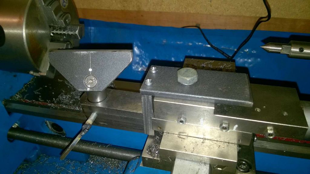

                            Today I finished off a wood lathe rest for my metal lathe (if you see what I mean).
                            In an earlier post someone suggested a trolley token as a 'thing' to make to impress her indoors. It actually did and now she wants samples for her friends.
                            The above is to make the handle for an engraving chisel. The samples so far have been engraved with a dremel which doesn't leave a nice finish.
                            Iain

                                    Hi, thanks Steve, I have tried a VS tool before, but unfortunately it wouldn't have worked on the geometry of those welder tips. The finish is ok for the purpose of the parts, at least to my eyes and flash photography usually enhances the appearance of machining as you may know. yes

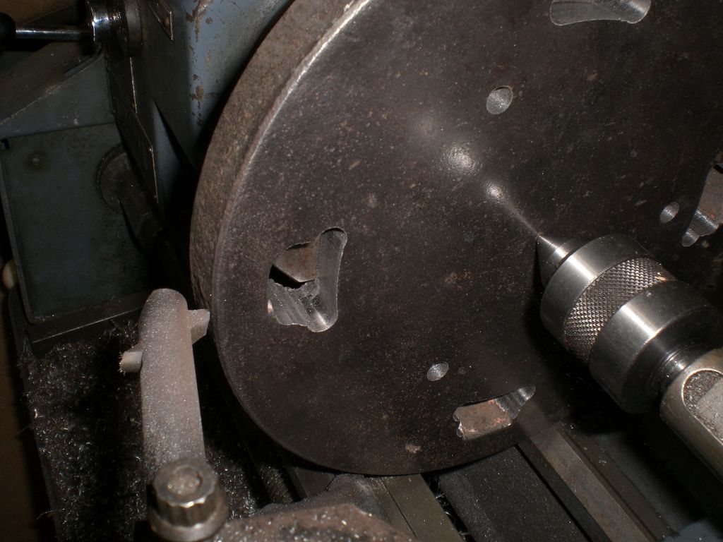

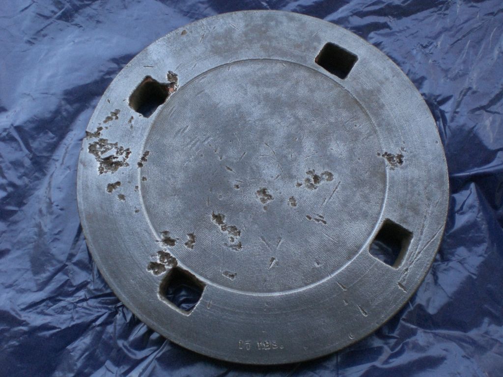

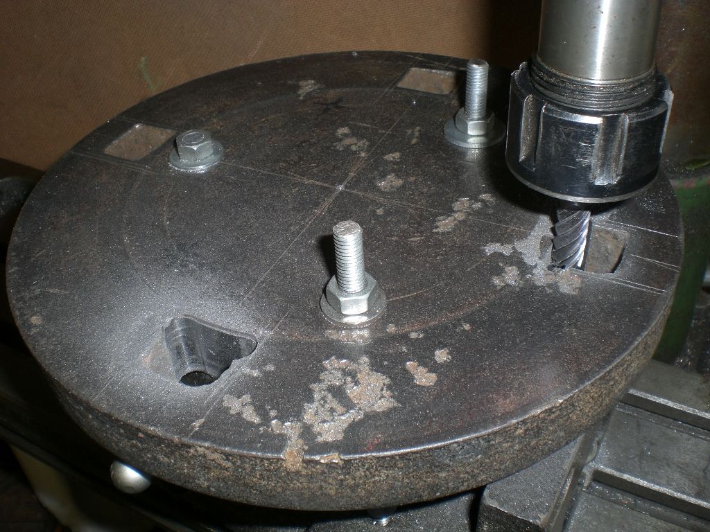

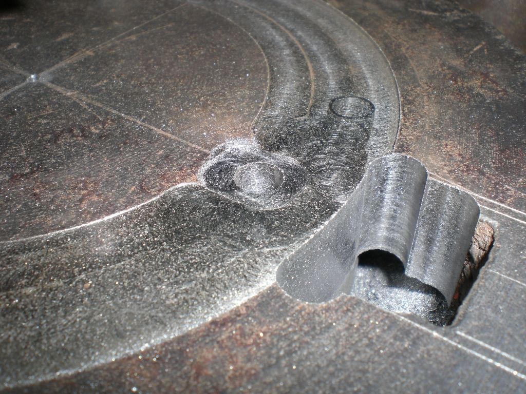

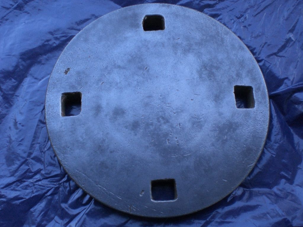

                                        Hi, well today I started to make a backplate for my slim 6" four jaw chuck, so that I can mount it on my milling machine table. This is a bit of a challenge, as I need at least one dimension to be about 8" for the bolts that will hold it on the table to clear the chuck. The problem being that the biggest chuck I have will only hold 6" in diameter. I've had this cast iron disc, which is 9" in diameter and about 1" thick, which has four square holes at about 90 degrees to each other crudely cut into it and the inside edge of them is about 6" diameter. No idea what it was for, but on the side that has had machining, it has 17 lbs stamped on it. I'm just guessing it was a blacking plate for a pipe.

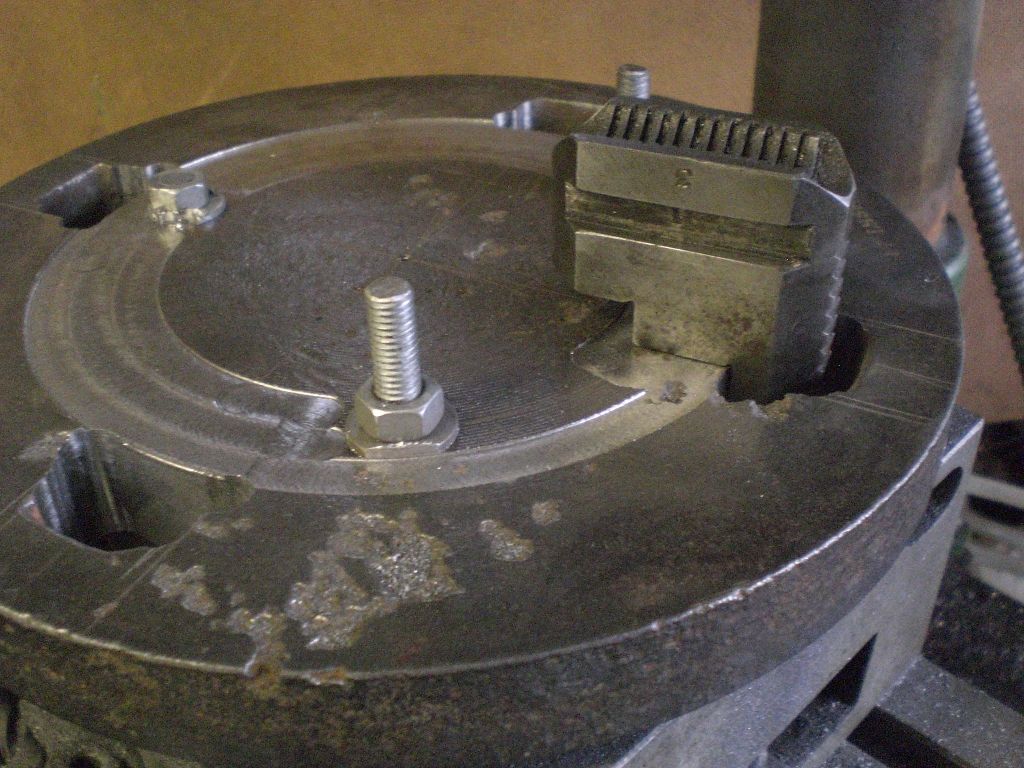

                                        Here's where a light bulb moment came to me, but it would require a bit of work. First of all, three 8.5mm holes were drilled 120 degrees apart on a 60mm radius, to be able to fix it to my rotary table. It was then fixed and centred with a washer between the disc and table on each bolt. I then began milling the inside edge of each hole wide enough for the jaws of the biggest four jaw chuck to fit in.
                                        Once these were all done, the milling machine table was moved to the left and each side of the holes where widened a bit more and when they were all satisfactory, the top of the disc was milled where the flats of the jaws make contact and a jaw was used to make sure all was good.
                                        One of the holes that were used for holding the disc to the RT, came right in line with one of the square holes and I had to mill the top around this, but when all the milling was finished, this bolt was removed and the area around the hole was slightly undercut with the miller.
                                        Next step was mounting the disc on the four jaw on the lathe.
                                        Regards Nick.

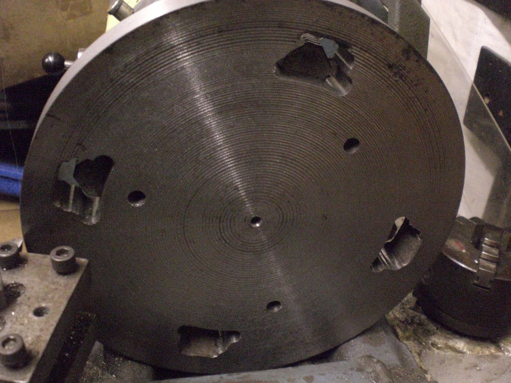

                                          Hi, my new backplate disc was mounted on my four jaw on my Boxford lathe, however the apron fouled part of the outside edge, so before I could face it up, I had to skim the outside edge using a boring bar to reach it, which made it a bit of a slow process, as only small cuts could be made due to the boring bar flexing, plus this as cast edge was a little tough to get through the skin and I had re-sharpen the tool a number of times to get through it. When the diameter was small enough for the lathe apron to pass, a normal tool was used to finish tidying up the edge to a true circular shape, which will make re-centring easier when machining the other side.
                                          The first light facing of the disc, showed that it was quite flat and true.

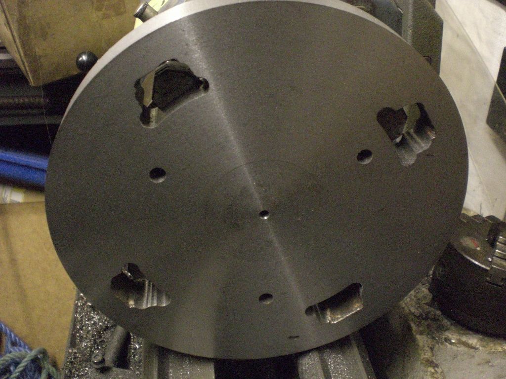

                                          A couple of more cuts across the face made a satisfactory finish and then approximately 70mm of the middle was very slightly undercut.
                                          The disc is now ready to be flipped over in the four jaw, for facing and the register for the slim four jaw to be cut. one or two PCD's will also be marked for the holding down bolts on the table.
                                          Regards Nick.

                                            That's an elegant solution Nick.

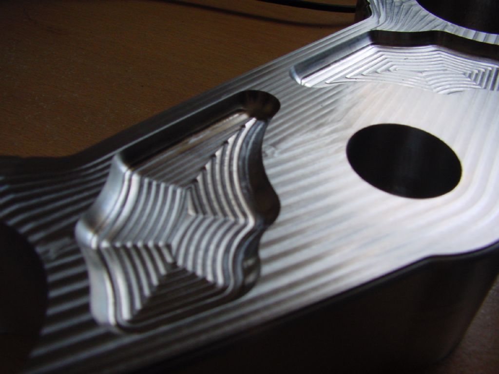

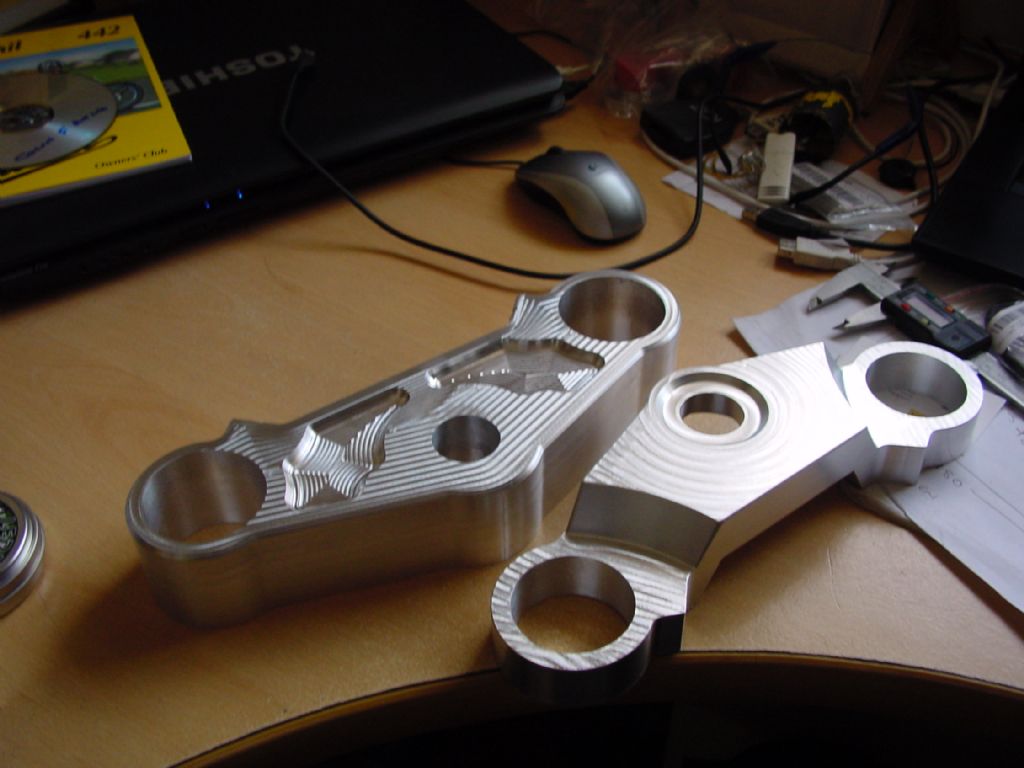

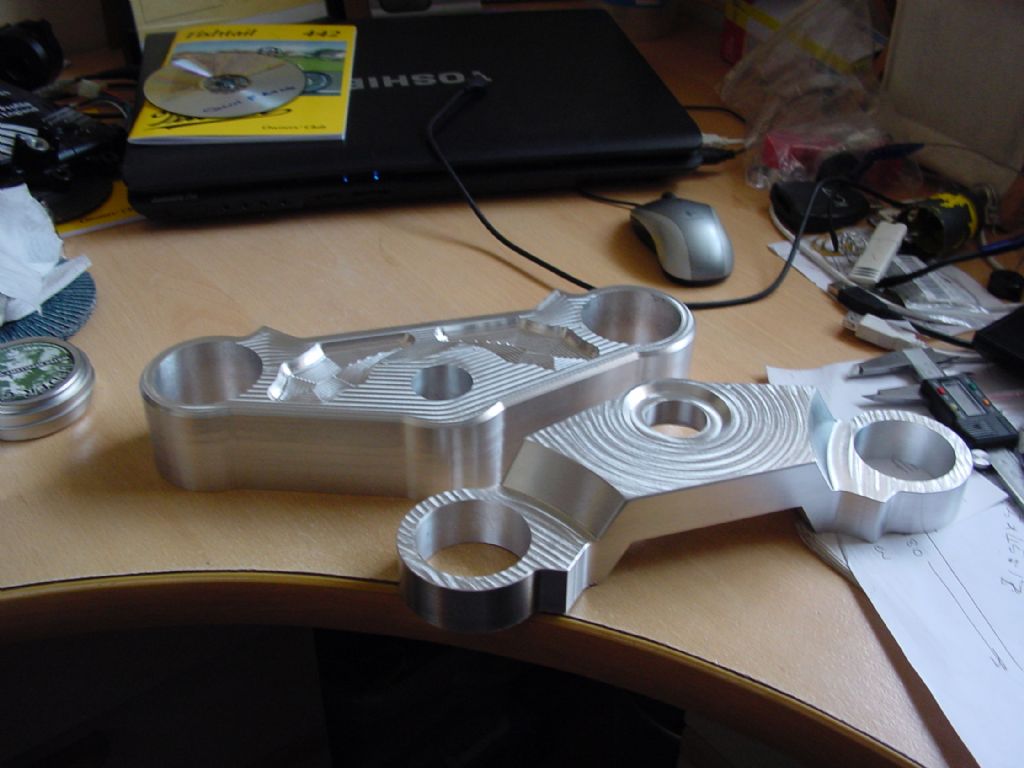

                                                  Got up early this morning and machined these fork yokes for a mates Triumph, I should get them finished in the morning with a bit of luck………
                                                  Shaun
                                                  Edited By Involute Curve on 12/03/2017 15:28:46
                                                  #288456
                                                  richardandtracy
                                                    @richardandtracy
                                                    Shaun,
                                                    You can't give them to your mate in that state. He'll be so fascinated by the machining marks, he won't ever look at the road…
                                                    Regards
                                                    Richard.
                                                    #288458
                                                    Involute Curve
                                                      @involutecurve
                                                      Hiya Richard
                                                      I actually leave the machining marks on my own bikes parts because I like the look, I bet he polishes them out………….
