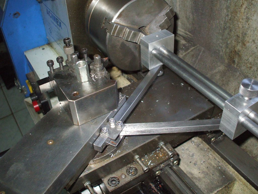

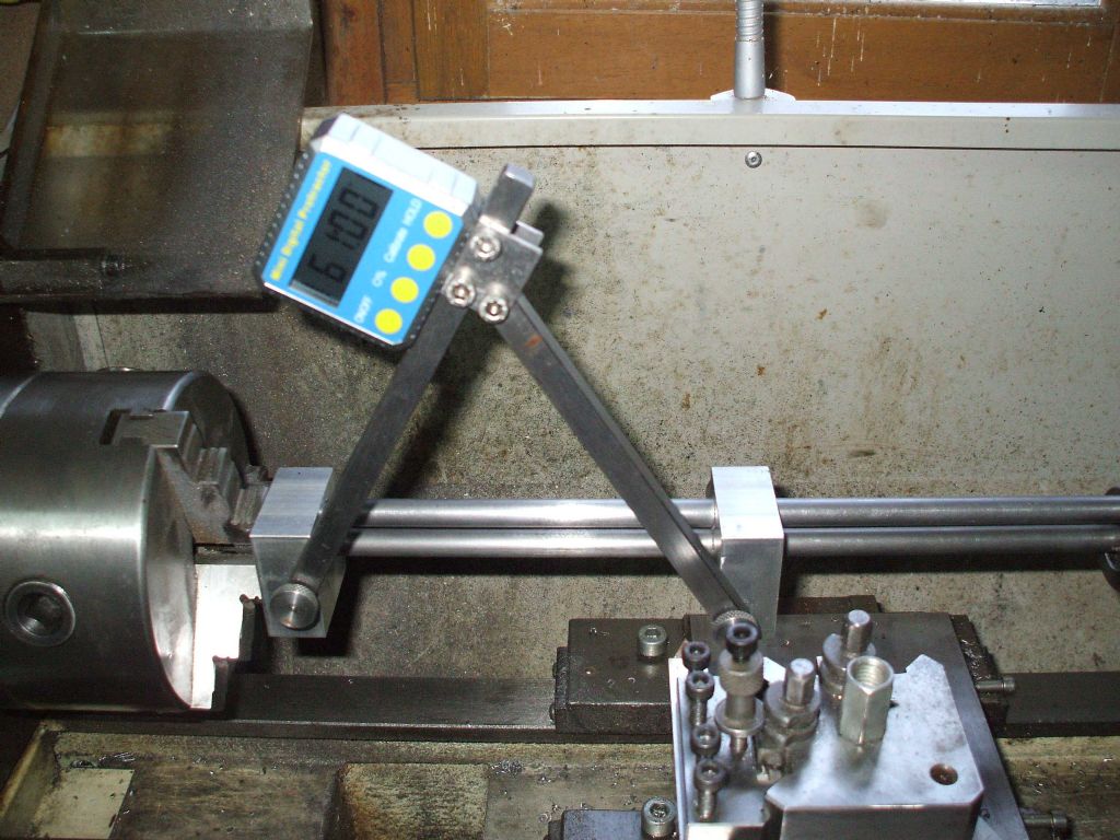

                                      I've been working on a Mark 2 version of my compact toolpost spindle. This time, it's going to be a two-speed, geared version with a revised layout to give improved accessibility on the lathe. Also, I've decided that I'll draw it all up in CAD beforehand, as the design is going to be somewhat trickier that the Mark 1. I've just about completed that part – lucky I did because I found that the bearings I'd intended to use wouldn't fit, so I ordered new bearings and they arrived today. This spurred me on to a bit more metal munching with the result that the spindle itself is finished – all except for the nose thread and the collet bore. I've only done a couple of threading operations in the lathe before, so I'm hoping I don't jigger up all the effort I've put into the spindle already. Hope to do the threading tomorrow after "The Archers" omnibus. In the meantime the lathe has been readied by setting over the compound slide to 29° using my home made gauge.
                                      Preparations for setting the compound.
                                      Then rotate the angle gauge 90° and align the compound with it:
                                      Transferring the angle to the compound.
                                      Tighten everything up and set the tool 90° to the work and away you go! This will be the first time I've tried screwcutting with the compound set over so that should be fun. If all goes well, I'll post a picture either here or in my album. If it doesn't go well, I'll own up, after I've stopped crying.
                                      All being well, however, I shall be using the same piece of kit to set the compound over to 8° to bore the collet taper and I'm going to try using the Mark 1 spindle to finish it with a light grind – also a "first" for me. Wish me luck!

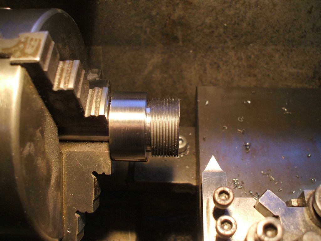

                                                With the Archers finished for another week, it was out to the garage to cut the thread. Easy does it and I must say, for a beginner, I'm quite proud how it's turned (no pun intended) out.
                                                spindle nose thread
                                                Just got to bore and finish grind the collet bore and I can get onto cutting the gears.

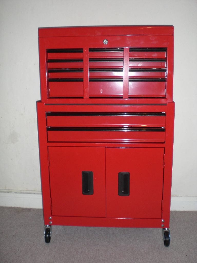

                                                      Hi, today I bought a new tool centre. I need a new tool box for my spanners at work, but was unable to find anything that I regarded as suitable, I hate those cantaliver type and I didn't want anything plastic. I have a nice two draw one for all my nice clean spanners that I keep indoors at home, so I bought the new tool centre from a well known high street retailer whose name begins wirth H and sells car parts and push bikes ect., which they are currently selling for £79.99 instead of £150.00. It's not a pro one, but for the money it is really good value IMO and not flimsy like some of the cheap ones that are available. I hasten to say I have no connection with this retailer, other than giving them money when they have things that I need.
                                                      Once it was out of the box, the bottom had to be removed from the bottom unit and the top unit taken out of the area where the two doors are and then the bottom was put back on and the castors fitted and the lifting handles on both sides of the top unit were also fixed on.
                                                      This one will stay at home indoors with all my nice clean spanners ect. and I can use my two draw one for work.
