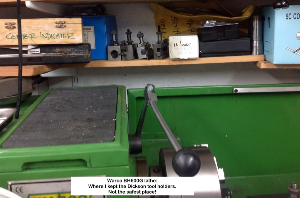

                                    Friday, decided it was high time I sorted out the storage position of the QC tool holders.
                                    NOT very convenient or particularly save to say the least!
                                    QC Tool holder storage

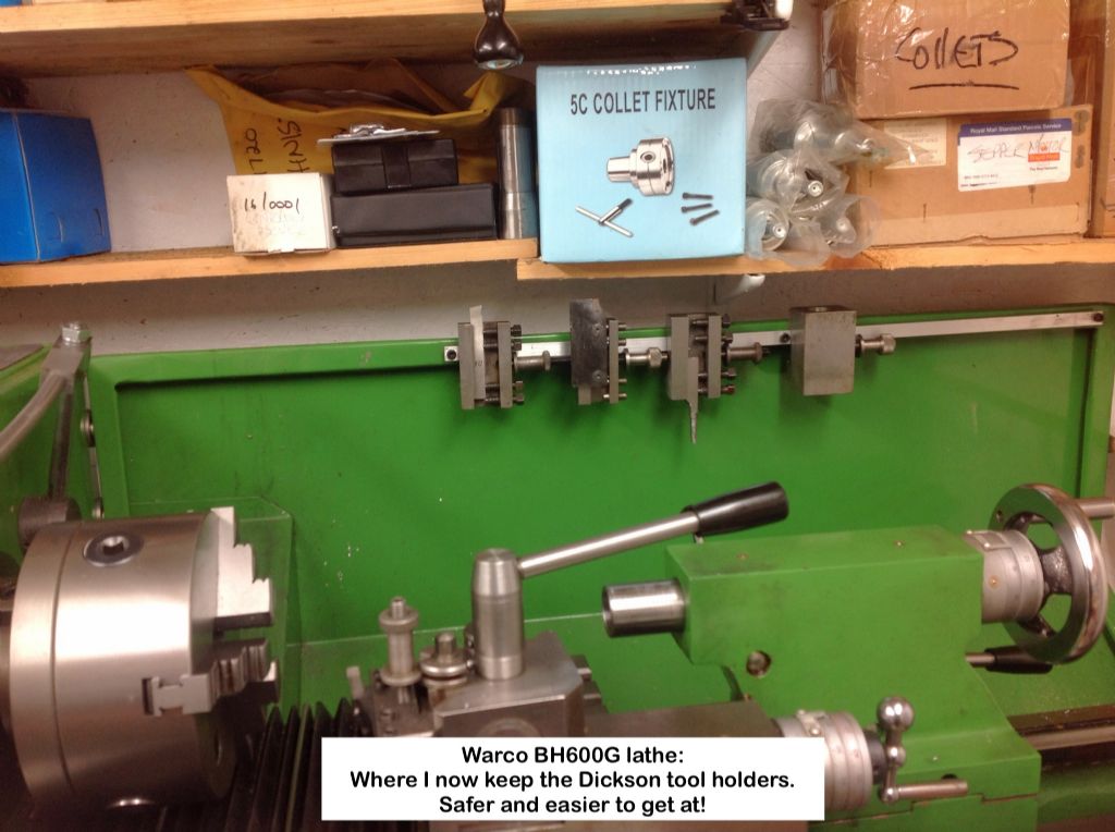

                                    So after scratching the old noggin for a while, whilst studying one of the holders, I suddenly realised that they have the perfect hook machined in them.
                                    A bit of drilling and tapping and the solution is a below. The holders clip over a piece of flat bar secured to the splash back.
                                    Geoff – Clever am I not!?
                                    PS: I'm not one to boast, BUT by heck it felt good coming up with that solution!
                                    Someone is now going to deflate me by saying it's been done before. I don't care!

                                      Yep! it's been done before… wink 2 used a couple of shelf brackets for mine off the back shelves…
                                      Sorry to spoil your day… embarrassed … have a nice one …. tea

                                        I've worked out that a strip of 1/4" by 1" wood with a 45-degree bevel on the top will happily store all my QCTP holders.
                                        I just need to find a bit of bare wall…

                                              Duly deflated, thank you so much, but I still DON'T care though
                                              I don't remember having seen the peg method before, but will definitely use it if/when those holders multiply.
                                              I needed something quickly done, just to make then easier and safer to get at.
                                              Every time I reached across the spinning chuck I would castigate myself for being stupid.
                                              Geoff – Nothing new there then.
