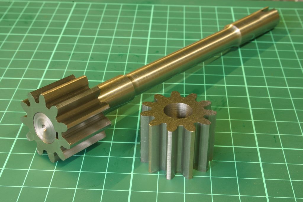

                      This took me a bit longer than a day, but I finished today
                      Gears for the oil pump on my Morris 8 engine.
                      The gears are 11DP 25 degree pressure angle in EN8. They were generated using my shaper with a rack-form tool and a fixture based on an article by "Duplex" in ME many years ago. The gear blank is rotated as the rack tool is moved laterally, using a wire drive onto a disc of a diameter equal to the pitch circle minus the wire diameter. This generates the correct involute, none of that compromise shape that you get with a shaped gear cutter. The calculated pressure angle from measurement of the old (worn out) gears was 30 degrees but this gave unacceptable undercutting of the tooth root, a problem often found on clock pinions.
                      11 teeth, 20 cut-increments per tooth,50 strokes per cut, X2, plus several experiments made for about 25000 shaper strokes. I made an abacus to keep track. Good job I'm retired!

                                Jim: Excellent work, lovely looking gears. It's not a method I've used, so I have a question. Presumably the teeth flanks are actually composed of a series of straight lines, the fineness of which is dependent upon the linear/rotary increment per stroke of the ram?
                                Intuitively I would have expected the issue of undercutting to be less of a problem as the pressure angle increases; have I misunderstood?

                                  Posted by Andrew Johnston on 26/08/2014 23:08:18:
                                  That's my understanding as well. When I made the cam drive pinion for my 10cc side valve aero engine I made 30° PA gears to minimise the under cutting (all knowledge gained from Ivan Law's splendid book). Perhaps the wear on the original gears had changed the apparent PA. 25° is still greater than the normal 20° , or maybe even 14.5°, of the original. Whatever, the effort was definately worthwhile: they look terrific. Very nice photography also.
                                  Actually, thinking about it, perhaps a bit of undercutting may not be a bad thing if these gears actually drive the oil – a bit like the vanes on a Rootes blower?

                                                  Geoff; the original article was in ME September 14th 1950. If you don't happen to have that issue to hand (!) it is reprinted on the website of the New England Model Engineering Society (neme-s.org)
                                                  Russel: I wish! My gears were chewed up, I think it had been run with no oil at some point. The engine now has a rebore and crank grind (not by me, Hargreaves Engineering in Carmarthen, excellent old fashioned Engineers sadly now defunct), but I did the rest including reground camshaft bearings, line bored bronze camshaft bearings in block, head reground, new valve guides, crankshaft rear seal etc. You may know that the camshaft centre bearing on these engines was prone to wear, was the first port of call for the oil from the pump and was machined in the block, not lined.
                                                  Andrew, Roderick: I think you are right, looking back at my notes (from over a year ago when I started experimenting), it was the 20 degree angle that gave root undercut for gears with low tooth count, 30 degrees gave teeth that were too narrow on the tips and in the root. Gear pumps have different tooth form requirements to transmission gears, needing a good volume in the root area to carry the oil around, and a wide tip to minimise leakage from tooth to tooth, but the stresses are low so no requirement for a large root radius. My try-outs were just three teeth and axially short so not too time-consuming to do. The rack-shape tool is very easy to make and modify.
                                                  Andrew: Correct, the tooth flank is a series of flats. Each flank had about 25 increments of cut (final strokes were three repeats of same cut) and feel very smooth. Under my low power microscope you can't see actual flats, just longitudinal planing marks. The gears rotate smoothly and no doubt will improve with running.

                                                    Further to my gear post, the ME article title was "Gear Cutting with the Shaper" and the author was "Base Circle", not "Duplex"
