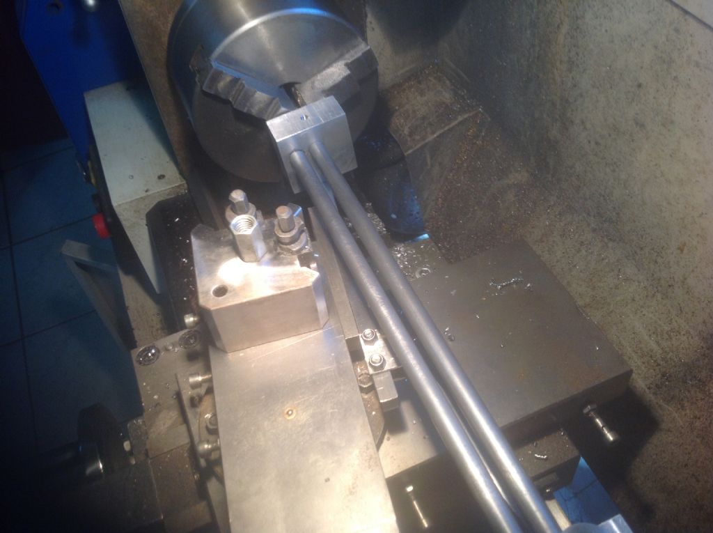

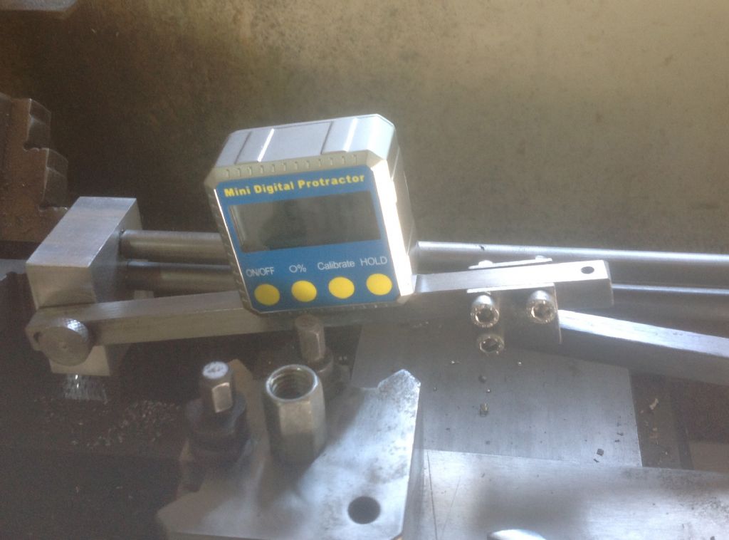

      Finally got the topslide angle setting device finished! Quite pleased, as it gave a maximum deviation over an ER25 collet length of 0.002 inch. Good enough for my purposes. A couple of photos from my album below:
      Setting the angle
      Setting the angle.  Not easy to see in this photo, it says 9°.
      Yes, I know an ER25 collet has a taper of 8°, but my lathe is 1° off level!
      Setting topslide angle
      Rotate the device 90° and adjust the topslide parallel with the angled part. Hey presto, angle set!
      More photos in the album.

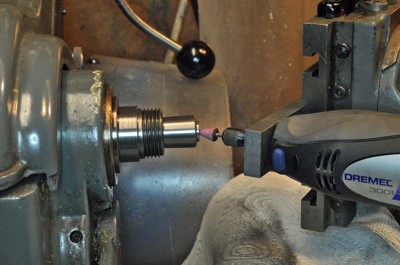

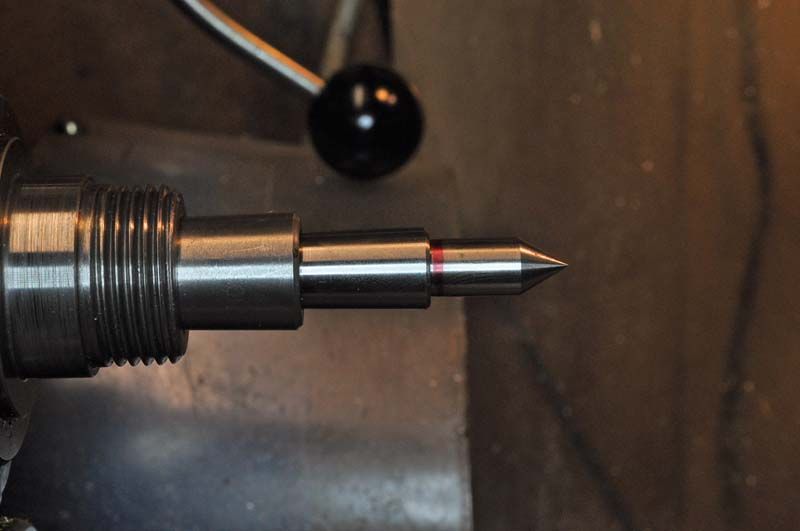

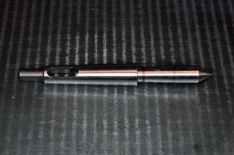

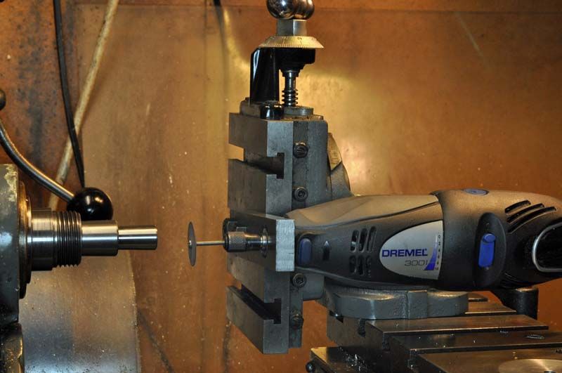

        I'm fiddling about with an old Flexispeed lathe that uses short MT0 centres in both headstock and tailstock and I'd like to use my Myford to make some stub arbours. Ketan sells Standard MT0 to MT1 adaptors, which together with a 1-2 adaptor will allow me to fit a MT0 in the Myford spindle.
        Standard MT0 is far too long for the short MT0
        So I needed to cut down the MT0 socket. I've not tried using the Dremel as a toolpost grinder before but, with some trepidation I decided to try using a one of the Dremel cut off discs. (Incidentally, the Dremel nose thread is 3/4 BSF which I screwcut then tapped in the BDMS bar)
        With the lathe and Dremel contra rotating, it turned (!) out to be spectacularly successful.
        Flushed with success I dressed the corners
        And I now have a short MT0 to MT1 sleeve.
        Please forgive my enthusiasm, I had visions of the disc immediately smashing into shrapnel, I kept well out of the line of fire but no drama at all. smiley

          I suspect that the secret of your success was the rigid fixing for the dermal and controlled feed of the slide. Any slight sideways pressure on these discs is invariably fatal for the disc. ( Believe me I know!) Always a good idea to wear some eye protection when using the Dremel but I've found that a bursting disc is annoying rather than traumatic!

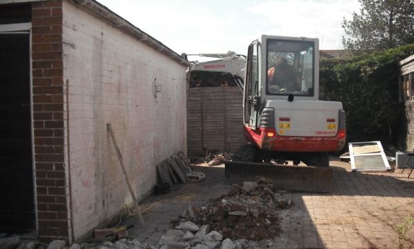

            Made a start on the building of new garage/workshop, will probably end up more workshop than garage but hopefully both.
            Building new one around and over the old one, foundations should be dug out tomorrow with building inspector booked for Friday am. day 2.jpg

                    Ingenious to say the least!
                    As usual, it took me some time to figure out, even with your description. Par for the course.

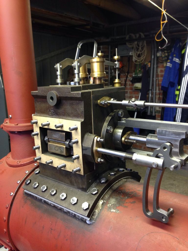

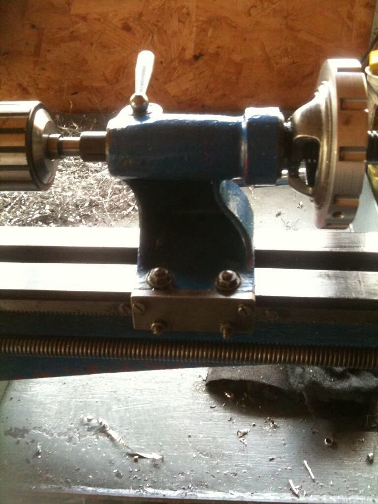

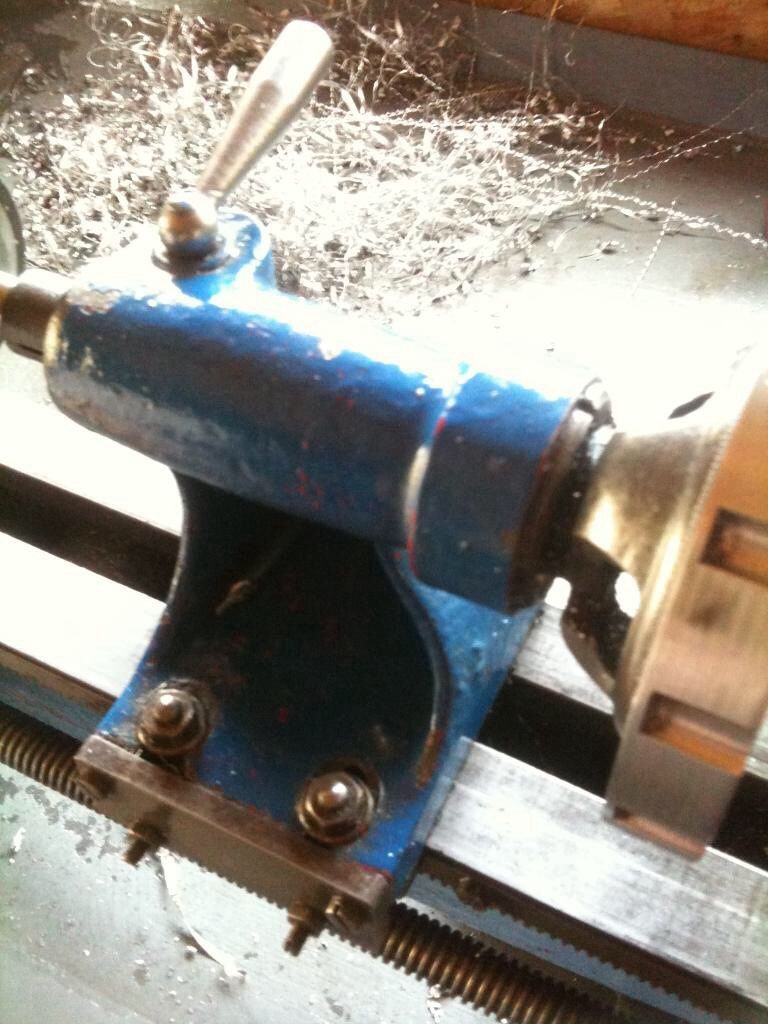

                          image.jpgFinally fastened the cylinder casting to the boiler and started putting the bits on. In the end I took Jason's advice and put a full face gasket on.
                          Soon be time for some heat beneath it?

                                Thanks for that, been meaning to make a couple of these for a while now. Really useful on the Taig for grinding plastics/urathane but it would be – the Dremel that is – better held in a dedicated holder and not just my knuckles jammed against a toolholder

                                  A slick setup to say the least. The reinforced cut off discs that are mow available for mini grinders seem to be quite durable even when hand held. **LINK** Not like those bonded discs that you had to buy by the hundred and waste by the dozen.
