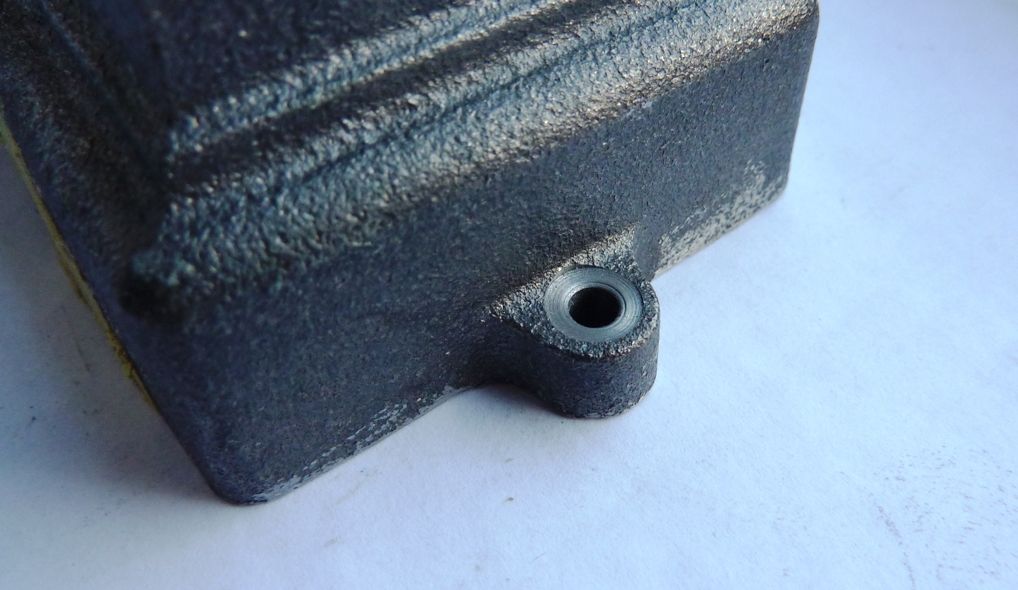

                                            Day off work today.
                                            I hardened and tempered the spot facing tool I started yesterday. Honed the cutting edge and then tried it on the S50 casting. I'm reasonably happy with the results considering it was a first attempt and I didn't really know what I was doing. Slippery slope this making tools – that way madness lies. surprise
                                            Gary
