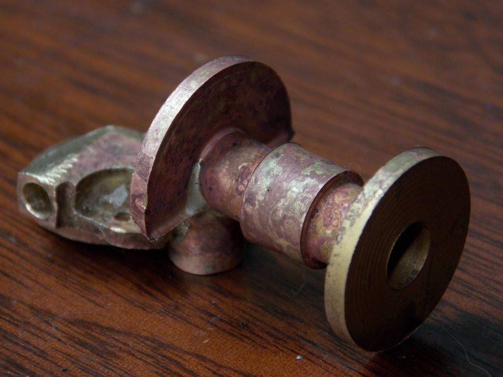

            I fabricated the upper part of my carburettor, it will be a simplified version of the original with just float chamber, a single jet with needle control, a simple throttle and butterfly choke. No idle jets etc.
            I figure that if the float doesn't work, I will just have to adjust the position of the fuel tank,
            The part in question is in four bits that took some creative thinking to jig together without any screws. Used a toolmaker's clamp to support the top tube by its mounting flange, lined up the rest of the bits and leant part of a broken ball race on top to hold it all steady.
            That was a great idea, as when it cooled down the ball race was firmly soldered to the lid of the float chamber and the 'bit that goes on top of it'.
            Fortunately, I was pretty generous with the heat, and teh ball race was fully annealed and I was able to saw it off – VERY carefully.
            Now soaking in descaler overnight – I'm beginning to think it may be possible to do this. Pic below shows the original carb at left before I cleaned the black paint off and unblocked the holes.

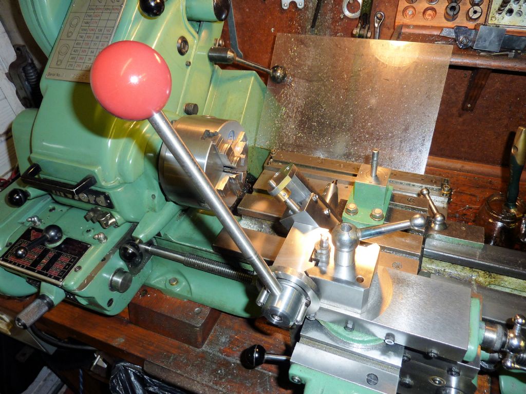

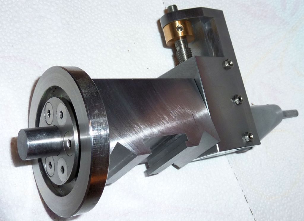

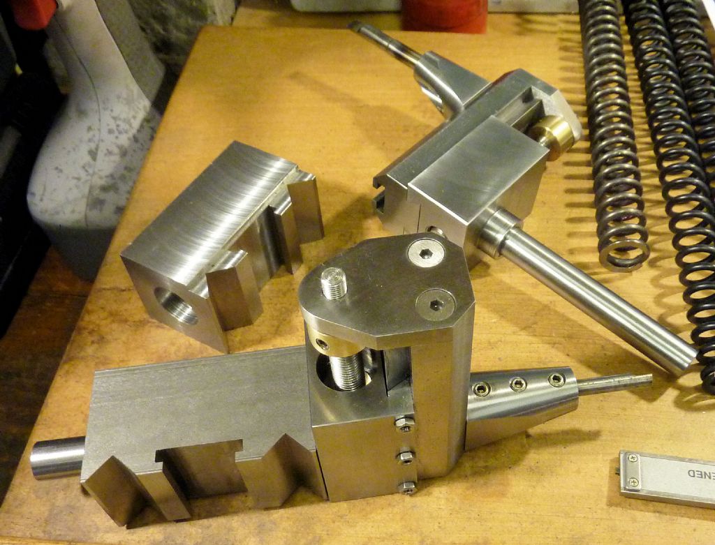

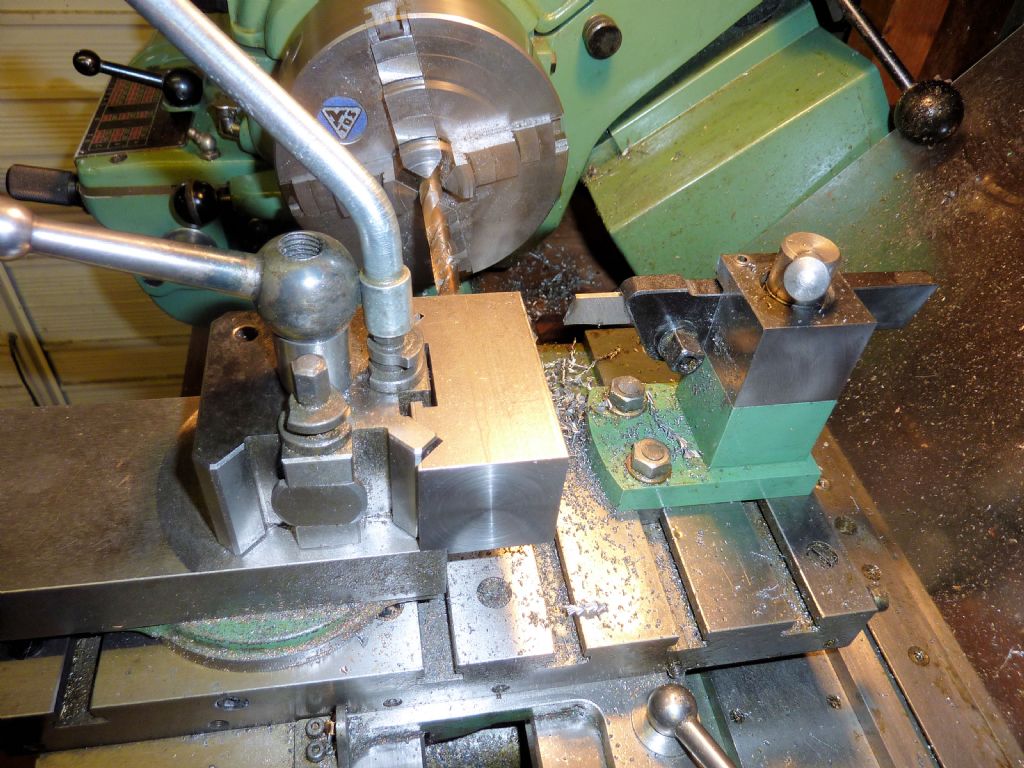

                    Spent the last 2 days trying to fix my computer. Looked like a HD failed but in fact appears to be the SATA controler that broke. In between watching restore processes on the computer I managed to make a little more progress on the ball turning tools.
                    Milled a couple of blocks to fit my Dickson-type quick change toolpost
                    These were then drilled and reamed 1/2" to accpet the pivot shaft.
                    The ball turning head fits in these blocks, something like this:
                    #119648

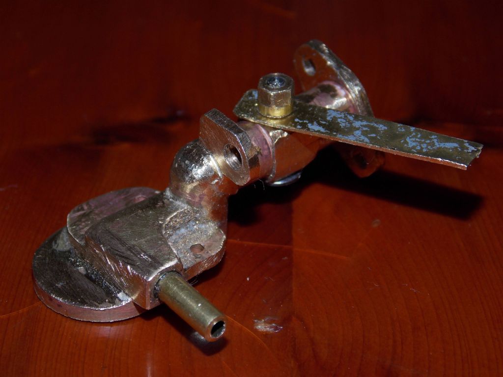

                      Carburettor progress, four-part fabrication:
                      Top of carb Fabrication
                      Top of carb after hand shaping, drilling and fitting throttle and fuel tube. Nut is 8BA:
                      Top of carb after shaping

                                Hmm. Don't know really. I've been at it nearly 2 weeks now but I haven't been in the workshop every day. Maybe 20 hours so far.
                                .oOo.

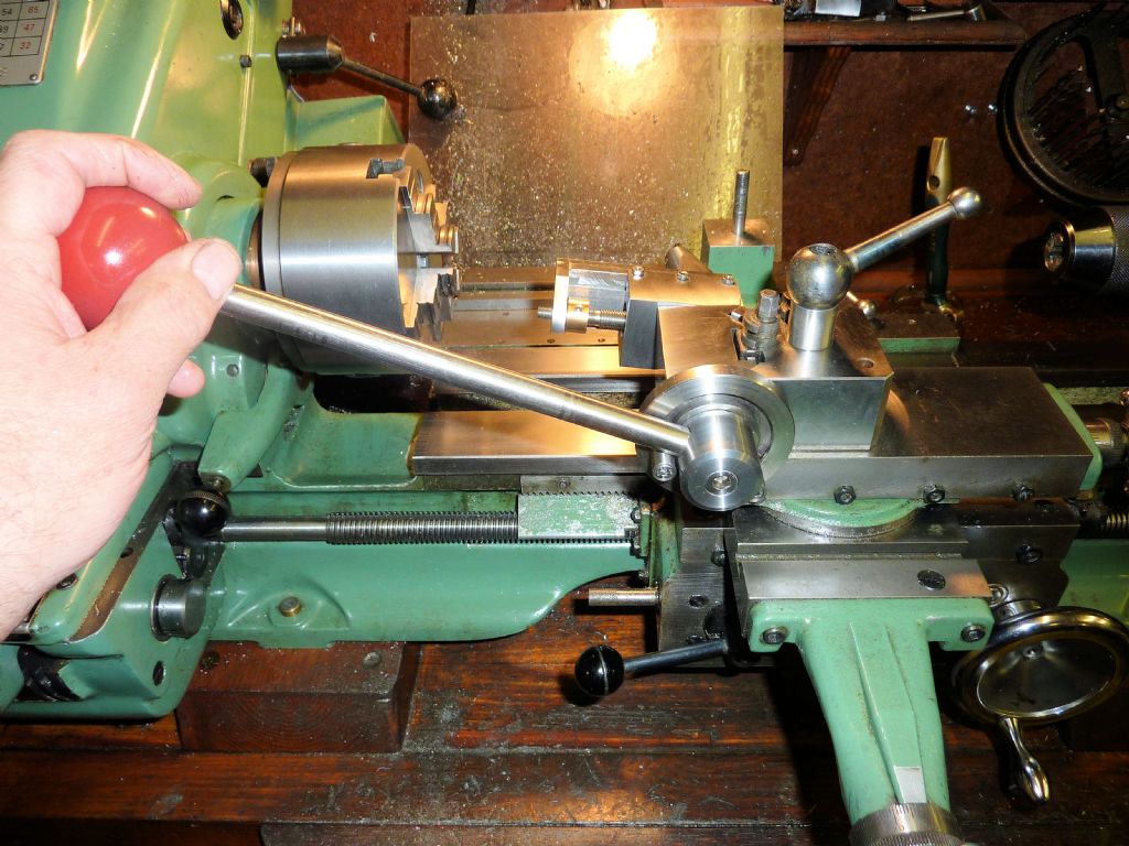

                                I made part of the adjustable limit stop, this fits on the end of the block and allows you to set where the cut starts and ends. Several ways of doing this occured to me and I fancied a circular T-slot (so it's a C-slot?). Anyway, I was going to use a t-slot cutter on a circular blank clamped to the rotating table but experience cutting the stainless steel (formerly residing in the scrap bin) in the lathe suggested this would present a problem. The metal is very tough to cut. So change of plan – I made the thing in two parts held together by screws.
                                I need to make the captive nuts and the two stop pins yet, but when assembled the pins can be positioned at any point around the slot.

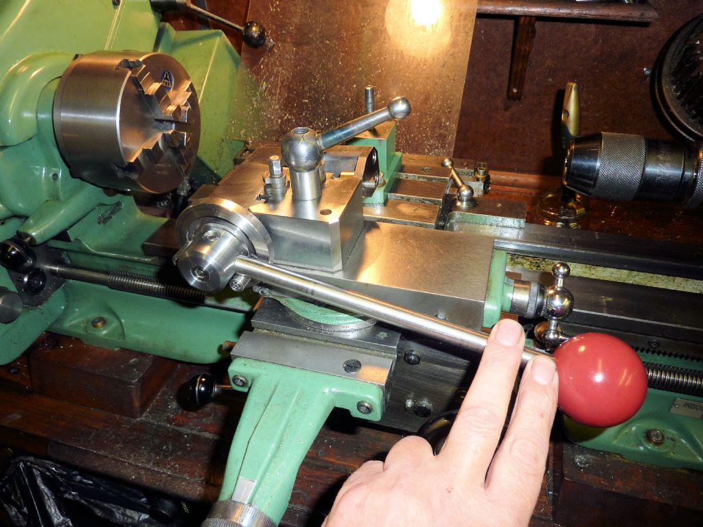

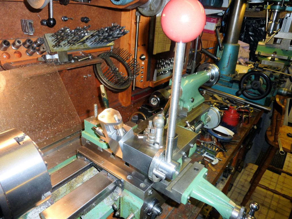

                                  Continued with the ball turning tool, not sure how it was going to turn out so concentrated on completing just one of the pair.
                                  The limit stop works fine, easy to set and effective:
                                  I knew this 30 year-old snooker ball would come in handy for something one day LOL!
                                  Not the easiest thing to hold for machining though… Anyway, I just need to make the depth of cut knob, then install an oil nipple in the main block for the pivot shaft, and the job's complete. Happy days

                                    And finally on this (honestly!) … it's done. And it works too

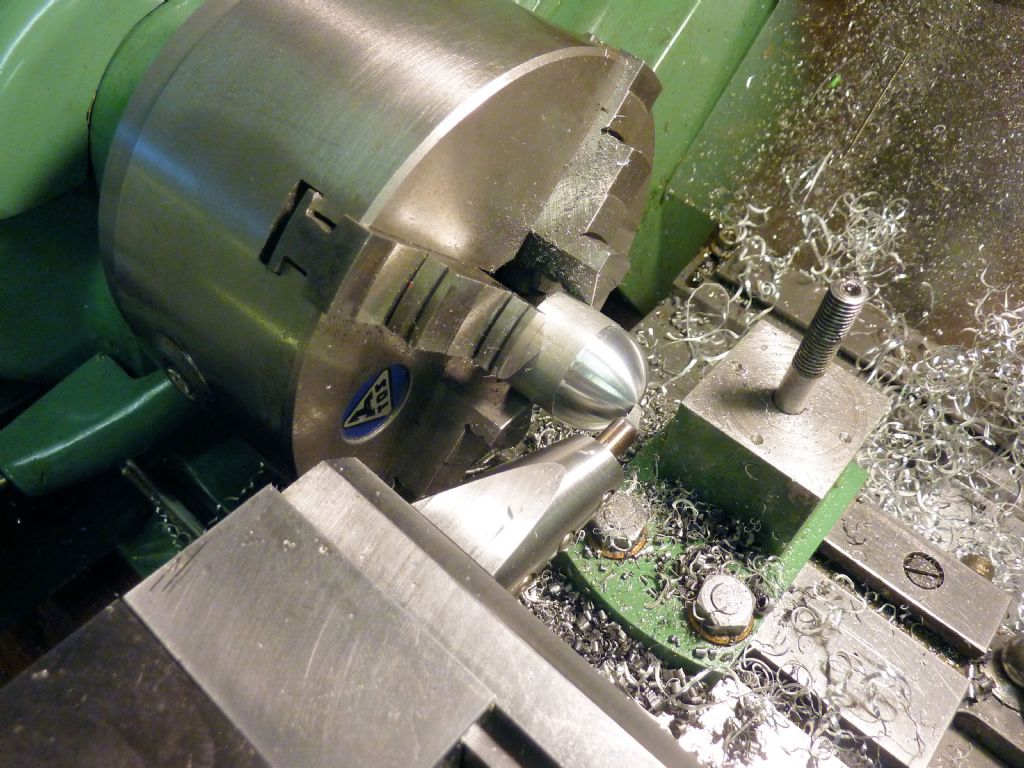

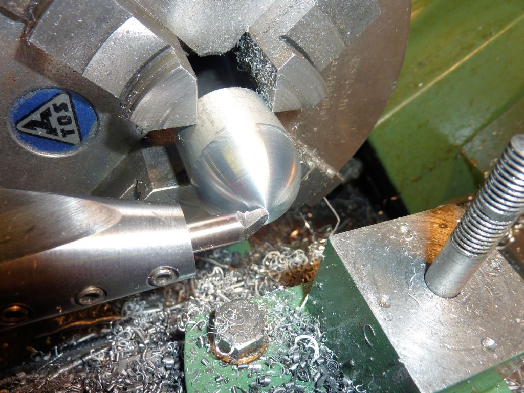

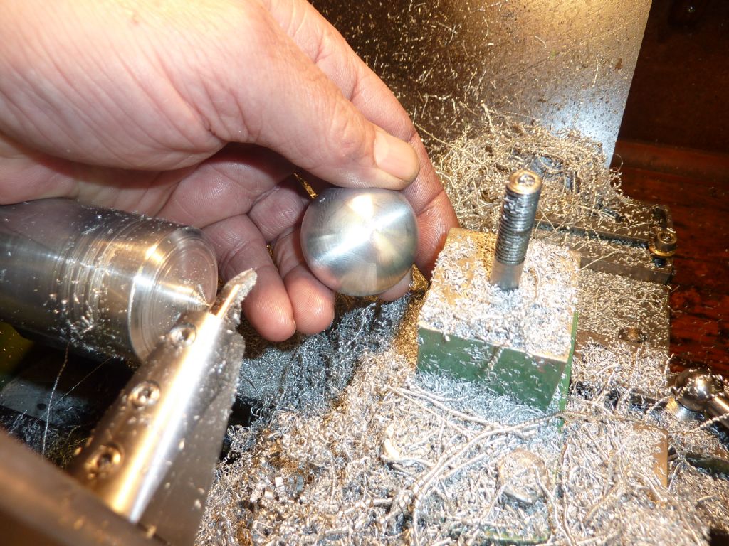

                                                Sorry, a couple more pics… just to prove the tool can make complete balls rather than just radiusing the end of a rod. Making a 1.5" alloy ball produces a fair amount of swarf!
                                                Just the last little bit – I have to hang on to it as the ball is cut off (I still dropped it later…)
                                                And there we are, no avoiding a small pip but it can be smoothed off with emery paper and a polish. There was an excellent finish until I decided to give it a final skim when it chattered a bit (there was hardly anything holding it on the stub so it was a bit stupid to try…)
                                                Bit of a polish as stated and a perfect ball is the result.
