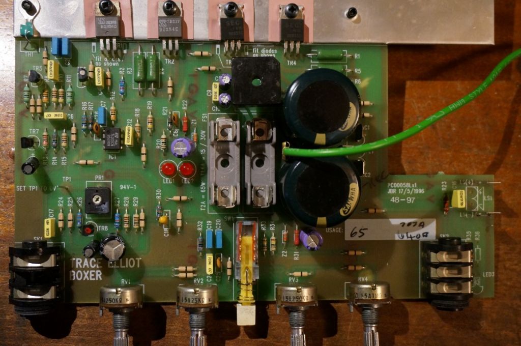

      I've never seen these used before what are they?
      the components in beige with a centrally positioned black line mainly unmarked on the board

          2 are marked as being resistors on board – possibly being what appears to be a single sided board they are cross links or removable test links

            Yes i did say they were links
            what are they called and why in a resistor type package

              Posted by Ian Parkin on 23/02/2018 08:40:15:
              they are links but why in the resistor type package?
              Basically they're 0R resistors, used in this instance as links. The black band 'follows 'the standard resistor band coding, black signifying zero.
              The resistor type package is probably used so that it can be auto-inserted by machine. A simple wire link couldn't be handled that way and would need hand insertion.
              Brian

                  well i'll be blowed i.ve never seen those before on any item of equipment i've repaired
                  thanks

                    Posted by Ian Parkin on 23/02/2018 09:04:57:
                    thanks
                    Very commonly used…

                      You also get them in Surface Mount.

                        I've never seen ones like that before, 0R SMT resistors yes, but not ceramic package.
                        Presumably it simplified manual assembly.
                        Much more interesting is what it comes from Are you a bass player, Ian?
