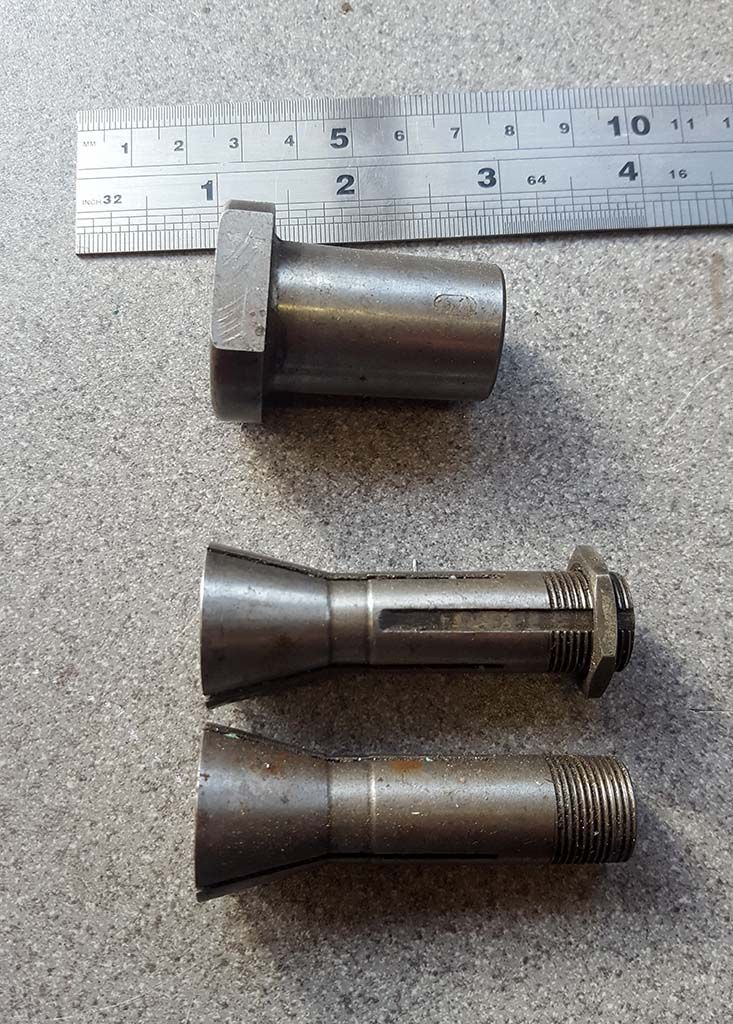

        Since selling the Emco copy I am having a clear out. I got these with the machine but have no idea what they fit and if they are worth selling on eBay

          Could they be 3AM?
          #287774
            Posted by petro1head on 08/03/2017 14:37:28:
            Could they be 3AM?
            I don't think so … 3AM are proportioned more like the small watchmaker's collets.
            It would be helpful if you could check the diameters and the thread pitch.

              This may help?
              #287814
                Nicely done, Sir
                … I may be back, later tonight

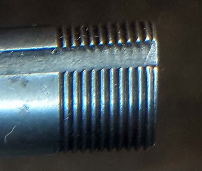

                  Are they buttress threads and is it a 1mm pitch?
                  #287843
                  petro1head
                    @petro1head
                    Don't know what a buttress thread is or looks like. The only thing I have to measure the pitch is a vernier which I would recon is not the best way, but it could be 1mm pitch.
                    Does this help:
                    Edited By petro1head on 08/03/2017 20:46:08
                    #287845
                      Lay an M6 bolt or screw against the collet thread as a quick and dirty pitch gauge.
                      Butress thread is flat one side and angled the other /I/I/I/I

                        Added a photo above. Checked against a 6mm tap and the pitch looks the same
                        #287850
                          My best guess so far is the Rivett/Hendey #2
                          Go Compare: https://goo.gl/images/3cXi1B

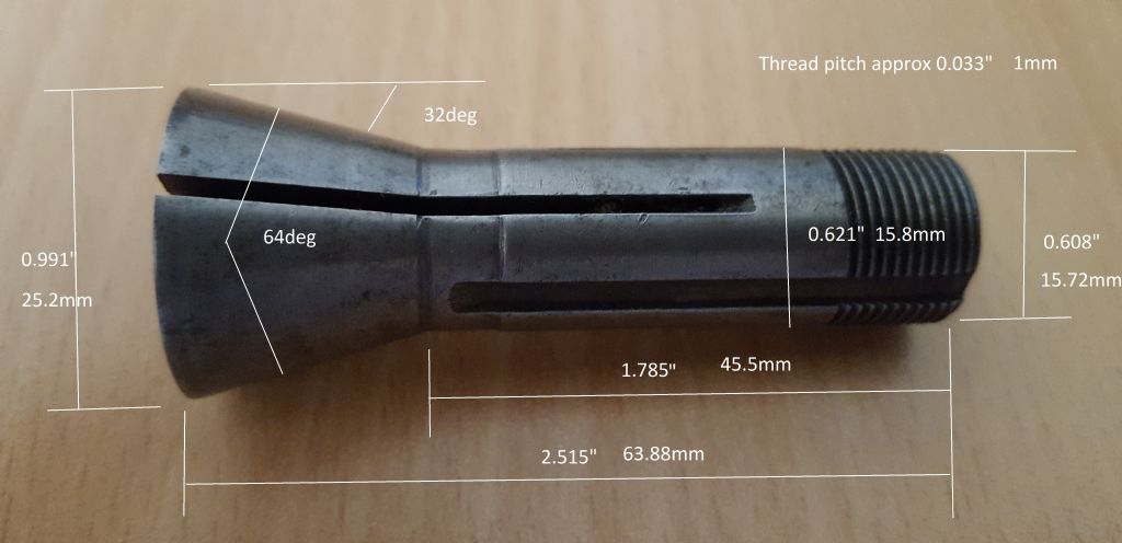

                                  I dont think these are the same.  The tapered part is longer on mine and the end is not domed
                                  Edited By petro1head on 09/03/2017 08:24:50

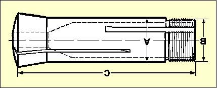

                                  #287909
                                    Posted by petro1head on 09/03/2017 08:15:35:
                                    Clearly "they" are not the same … but I don't understand why are .you are posting that sketch.
                                    Sorry, but I don't think I am capable of explaining any further.
                                    … I have already given you a link to a picture, and another to a table of dimensions.
                                          The diagram is just an indication, it applies to all the collets to show where to measure.

                                            According to the chart the Hendey No2 is 4.25" long and the body is 0.826" dia whereas mine is 2.5" long and 0.6" dia
                                            Good point Neil

                                                After my earlier faux pas, I am perhaps unworthy to mention this, but … I think you have somehow doubled the angles on your dimensioned photo.
                                                My quick on-screen measurement of your photo suggests that the included angle of the collet is about 30°
                                                #287996
                                                petro1head
                                                  @petro1head
                                                  Indeed Michael, you are correct. School boy error, sorry.
                                                  Now, if I was able to edit my previous posts I would chnage the photo, but I cant and I think there have been enough photos
