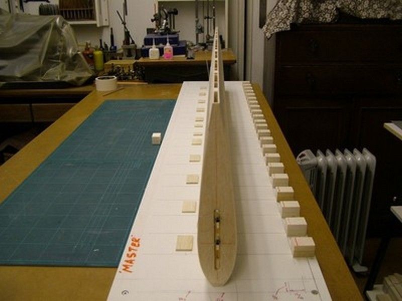

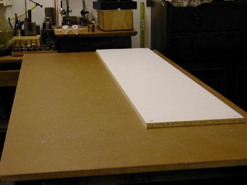

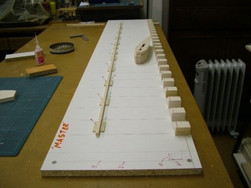

                            It seems to me that the use of JB Weld in this situation is rather a waste of the product.
                            The thing to bear in mind once this gluing of two surfaces together – to provide a flat one – is the inability to part them if it does warp. Not suggesting it will but am saying it might – too late then.
                            NDIY's and others suggestion of screwing is to me the most logical. Correctly done the screws can be equally spaced to ensure even pressure across the area and the heads countersunk enough to either be flush or filled over. The original poster does say that for most of the time it will be used under cutting matts so screws shouldn't be an issue.
                            The environment would appear to present a challenge with -5 to + 40 and relevant humidity changes – another thing to be considered.
                            I have in my workshop a very flat bench top – MDF on top of MDF on top of Chipboard – all screwed together. It is checked for flatness and warpage each time I build a model – so far the stability has remained since I placed the last layer on
                            As always the pics are to assist the recommendation but what I do does require an absolutely flat working surface – the above has proved admirably successful for me.
                            Someone suggests this is probably being over thought, yes the question was about which glue type to use but it's time to think outside the envelope perhaps.
                            Regards – Tug

                              Ramon – not overthinking at all for your purposes where you are using it as a jig/fixture base for building large complex structures that must be dead flat/straight/true, such as airfoil sections as shown. But for resting a cutting mat as the OP describes — not so much.

                                Maybe so but the principle's the same – the object is to get two pieces of board together to provide a flat surface without it warping or delaminating. My approach is on the basis of once bonded it's bonded – if a warp does then ensue it rather defeats the object – atmospheric conditions can, and will, play a part in trying to do what you want to prevent..
                                FWIW all the MDF two layer bases I make for my plastic models are screwed together for the same reason but – 'yer pays yer' money etc.
                                Tug
