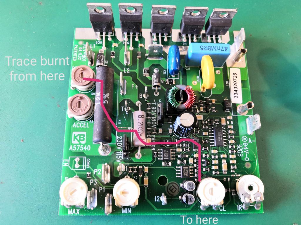

      Over the past few evenings I've been working on a new drive and motor for my Cowells lathe, I chose to go with a KBIC controller and a DC motor since they are readily available in small sizes.
      I was nearing completion and decided to check everything was wired up and running correctly before installation, which it was.
      But then with just a small repositioning of the mains cable (which seemed to want throw itself of my bench) the whole lot went BANG! sad
      Many many swear words later…

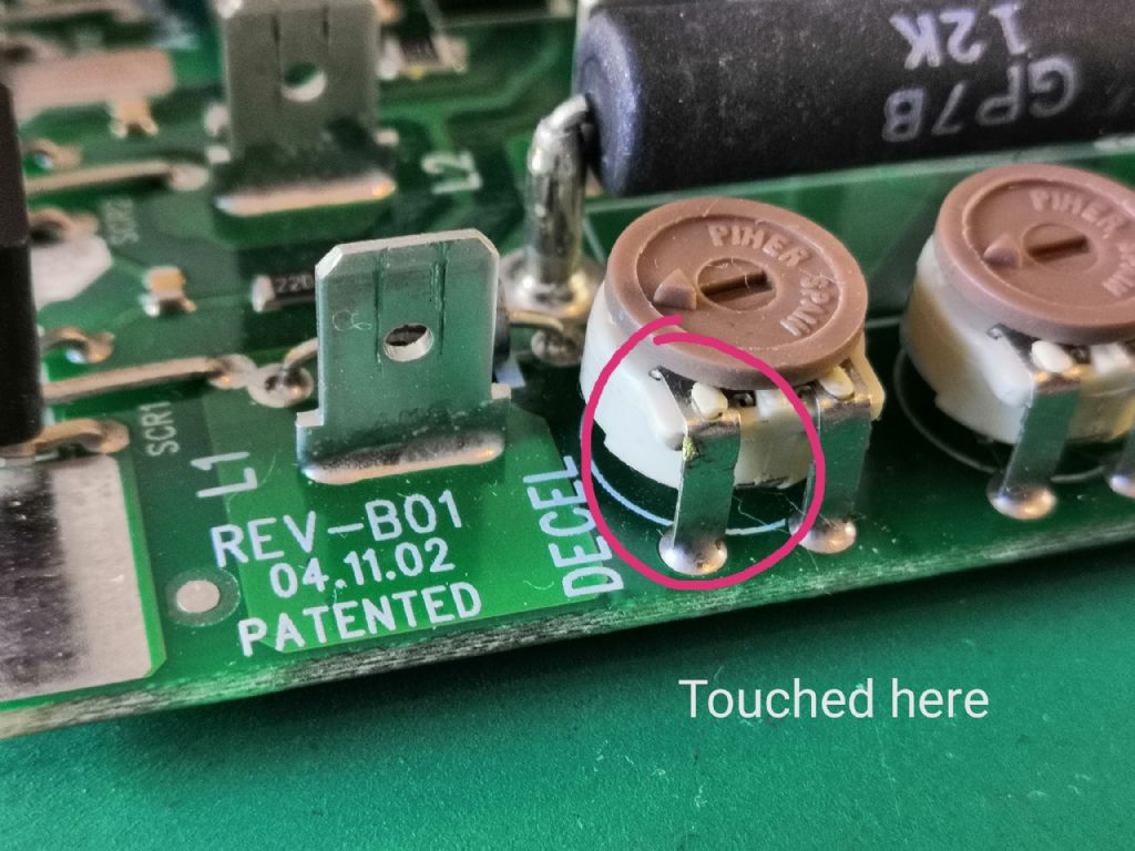

      Inspection found I forgot to connect the earth wire to anything and the ringed connector at the end had touched one of the components on the circuit board shorting it. angry
      So now I'm left with this:

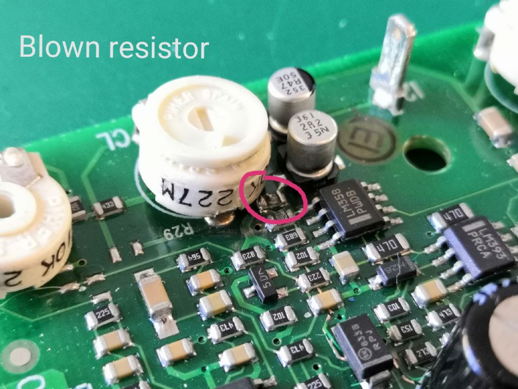

      So my question is, Do you think it is worth trying to fix? I imagine its doable but very tricky. The biggest problem I can fore see is that I don't know the value of the burnt resistor? Anyone have the same board? There is also the potential that other components are fried too.
      Should I just cut my losses and buy a new board (£100+) crying

              What KBIC board is it? There does seem to be schematics available so should be possible to id the blown resistor and any others required.

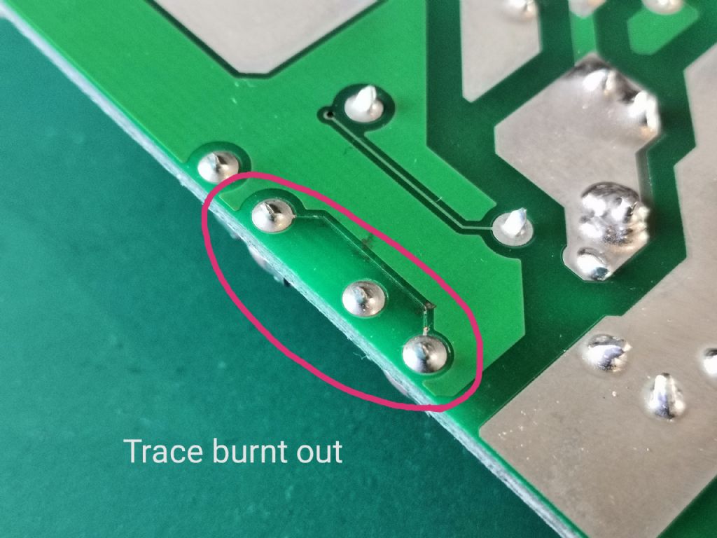

                "Nothing ventured, nothing gained….."
                I would personally:
                • replace the track with a piece of wirewrap wire – or something as fine as possible
                • replace the dead resistor with a 'full size' 1/8 or 1/4 W leaded version which should make access easier for test purposes
                reconnect, avoiding all the previous errors. If it works, great, saved $100…..if not, I would assume that the damage has propagated through other components and its for the recycle bin.
                My 2c…..good luck

                  KBIC or KBMM 240-D
                  KB A57540
                  Rev – B01
                  230v or 115v input
                  90v or 180v output
                  Edited By Hollowpoint on 10/02/2021 13:38:02

                    Anything is worth a try. but don't expect miracles. If all that has gone is a blown track and a resistor your a lucky man ! Surface mount does not always make it easy to remove or replace components. Good luck Noel.

                        Thanks for that, Lots of useful information there, Unfortunately I can't find any info about the resistor value.
                        I might have a go at fixing it in the manner suggested by Simon above. Though I suspect I will still end up having to buy a new board.

                          Maybe the manual will show what value the resistor should be.
                          Presumably yours is fried so that the colour code is no longer visible?
                          Howard
                          #526179
                          John Haine
                            @johnhaine32865
                            SMD – no colour code…
                            #526182
                            Hollowpoint
                              @hollowpoint
                              Yes no colour code, just a number printed on the top, I cant make out the number because its burnt.
